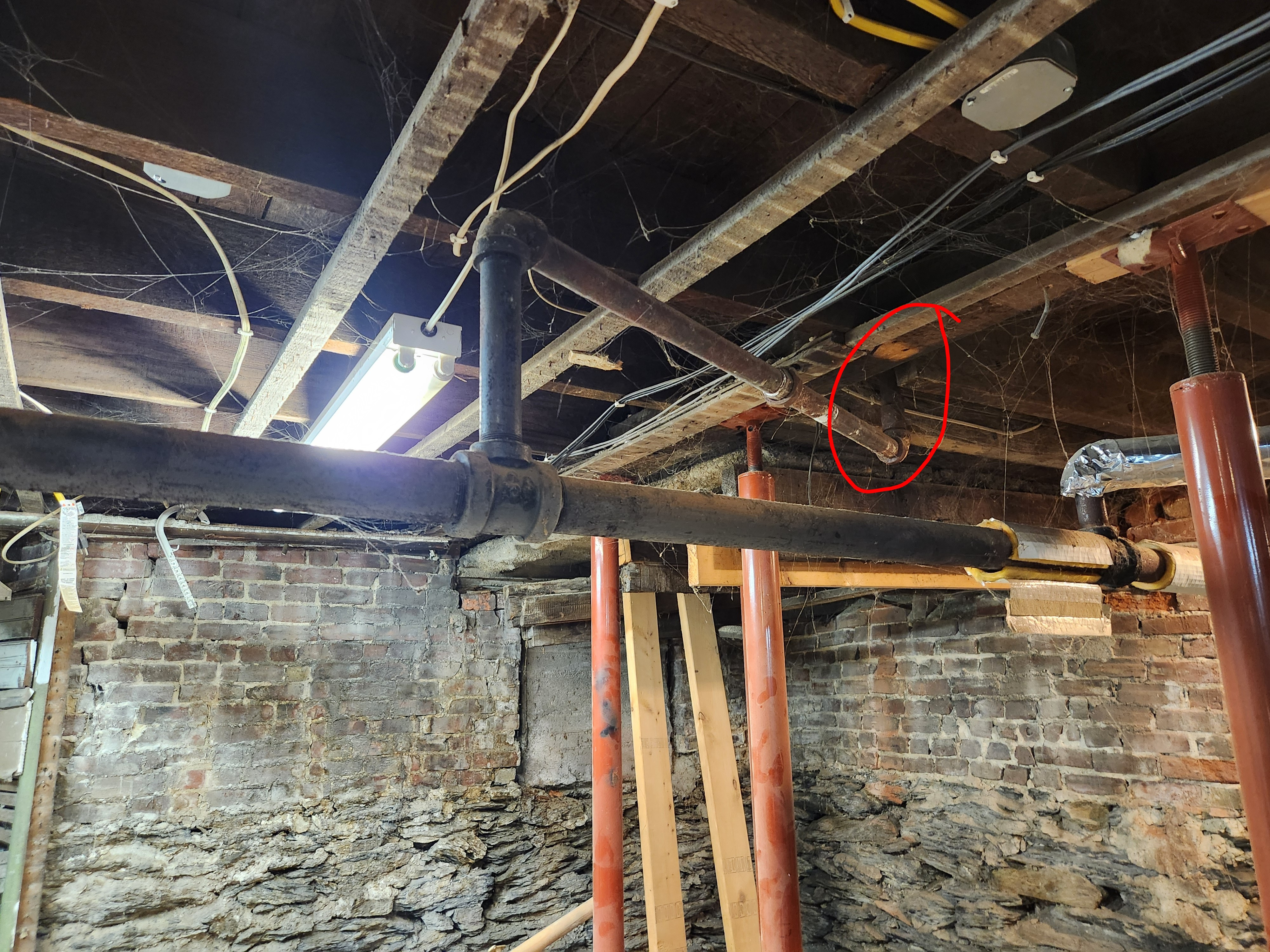

Problem: there's a supply pipe to the master bedroom radiator crossing right under the old beam. See the image below: the beam in question is the one supported by the red columns. The supply pipe comes vertically off the main, then almost-horizontally (properly graded) under the beam, then vertically to the second floor. In this photo the boiler is to the right and the main slopes down right-to-left.
To fit the new beam we need another 7" give or take of clearance here. The vertical rise off the main is over 8" between fittings, so in theory we could drop that and preserve the grade on the horizontal run. I'm not sure if the very short riser would be an issue (steam making a tight U-turn up while water makes a tight zigzag down).
Alternatively, most of the runs to the radiators come off of the main at a 30-45 degree angle out. We could mimic that here and angle the riser off the main down, so that it could stay longer without gaining as much vertical height. For an example of what I mean, here's the run to a different radiator: imagine if we replaced the vertical rise with something like this, but a bit longer, and then turned back.
The first plumber we asked about it refused and suggested taking out that radiator entirely and putting electric baseboard in the bedroom. (Ugh.) I saw the various parts of We Got Steam Heat! that very clearly warned about moving basement pipes. Unfortunately this isn't a matter of wanting more headspace in the basement, it's necessary for the structural integrity of the house.
Are either of my ideas plausible? Will we regret it? Any alternate ideas that don't involve baseboard electric?

    you can shorten the nipple and drop the lateral closer to the man as long as you keep slop on it. it would work with a close nipple or street ell or you could make a swing joint if you wanted to get fancy.
    Robert_Hharo1
    Just cut that riser off above the tee and cap the branch the riser is coming out of with a new nipple and cap.
    Cut a new tee in the main to the right (in the picture) next to the other tee and pipe the existing radiator riser into that. That should clear the beam. You will nee a cap and nipple for the old tee. A new tee to reconnect the riser, a union and 2 nipples. Find a good heating guy and its a piece of cake.

    This solution sounds great and would definitely give us the space we need. It's not clear from the perspective in the photo, but if my memory is right (I'll check tomorrow) the new tee in the main would have to be very close to the existing one, definitely where that piece of insulation is now. Is there a distance I should keep between them? Does it not matter at all?
    they can butt up against eachother. the steam needs to be able to get in and the water and air need to be able to get out, that is mostly all there is to it.

    You could also put the new tee on the other side of the existing one if you want. If it is a one pipe system you should come off the tee with a 45 if possible……like your second picture shows. The pipe should pitch up towards the riser 1/4"/foot. More pitch is ok less is not

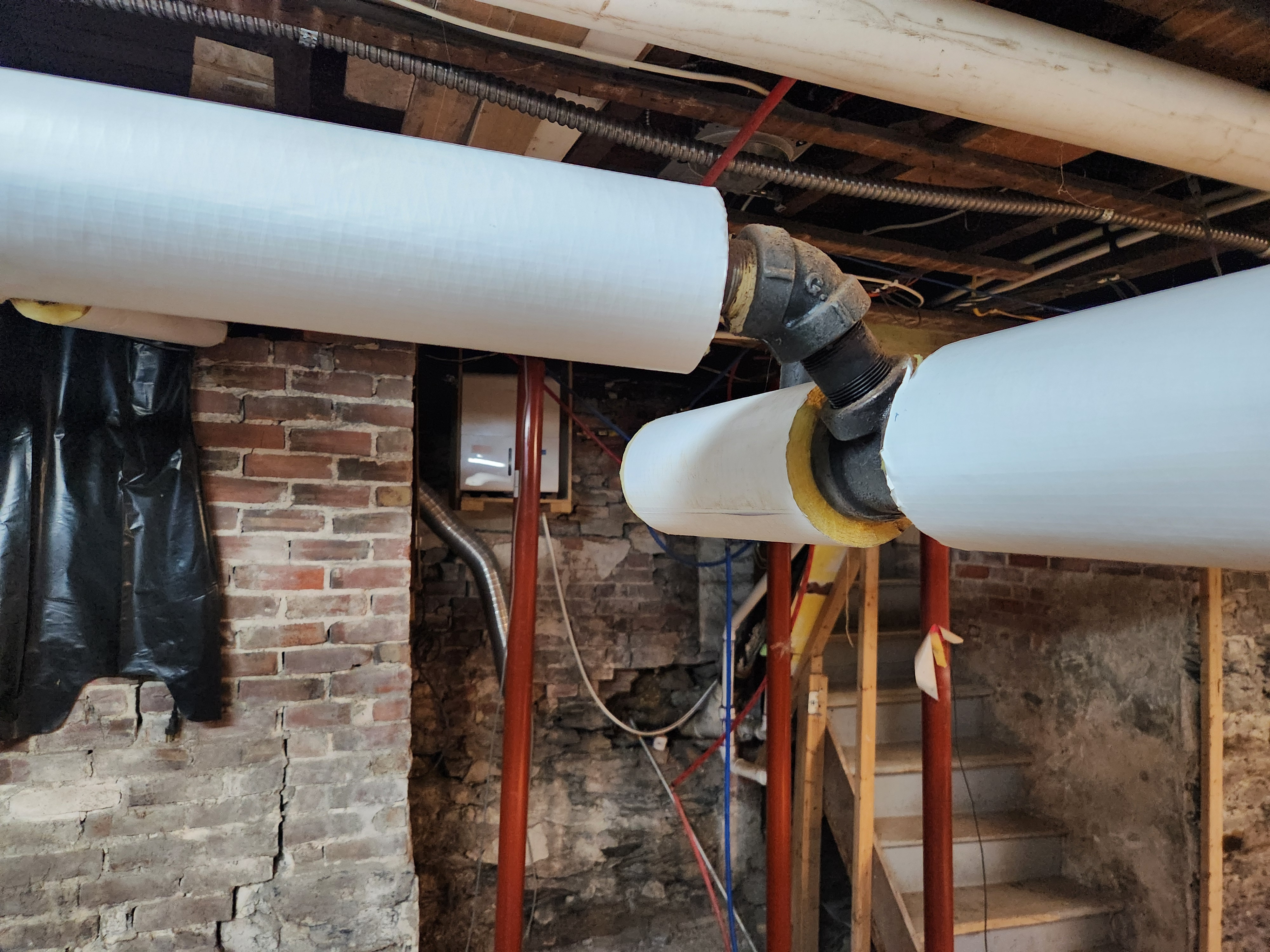

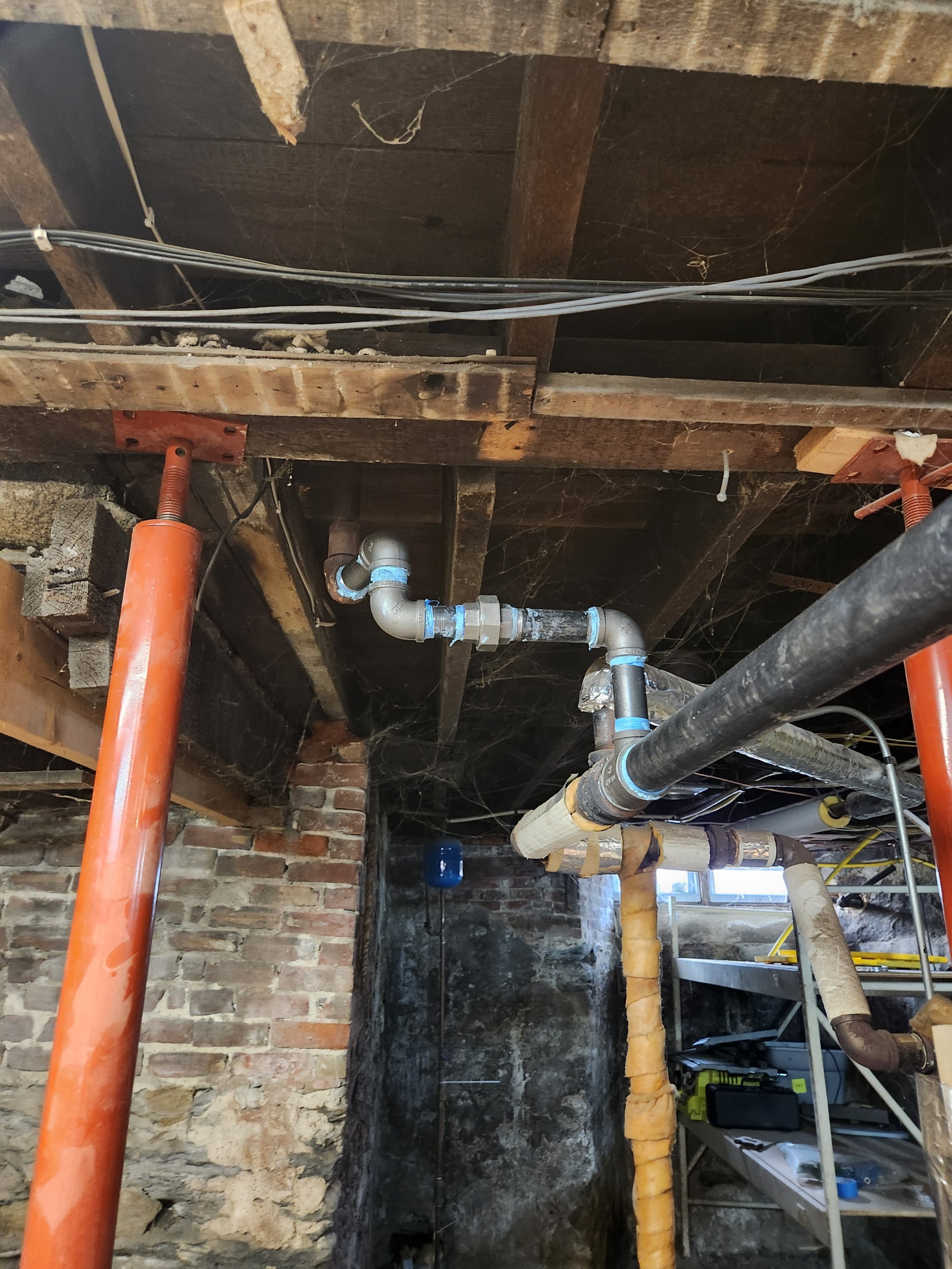

    The plumber we hired went for basically this. The path he took seems a little convoluted to me, but hey, he did it and it works totally fine. Clears the beam with an inch to spare. Thanks again for the advice.
    As long as it has some pitch and doesn't bang its good
    EdTheHeaterMan Posts: 12,946
    edited February 16
    That extra pipe and fittings is known as a swing joint. allows for expansion and contraction of the metal pieces as they steam up and cool down. After you are sure it is fine with no leaks or noise, put some pipe insulation on those naked pipes!

    Oh, that's good to know! I had heard the term but didn't know what it looked like. I put up $800 worth of insulation last month and need to go back for more 🤑
    109A_5 Posts: 4,759
    Kind of looks like a Hartford loop. What looks to be a Steam Main drip is also the equalizer, although I would have piped the Main Drip / Equalizer / Header / Hartford loop differently. Maybe the Main is partly counterflow.
