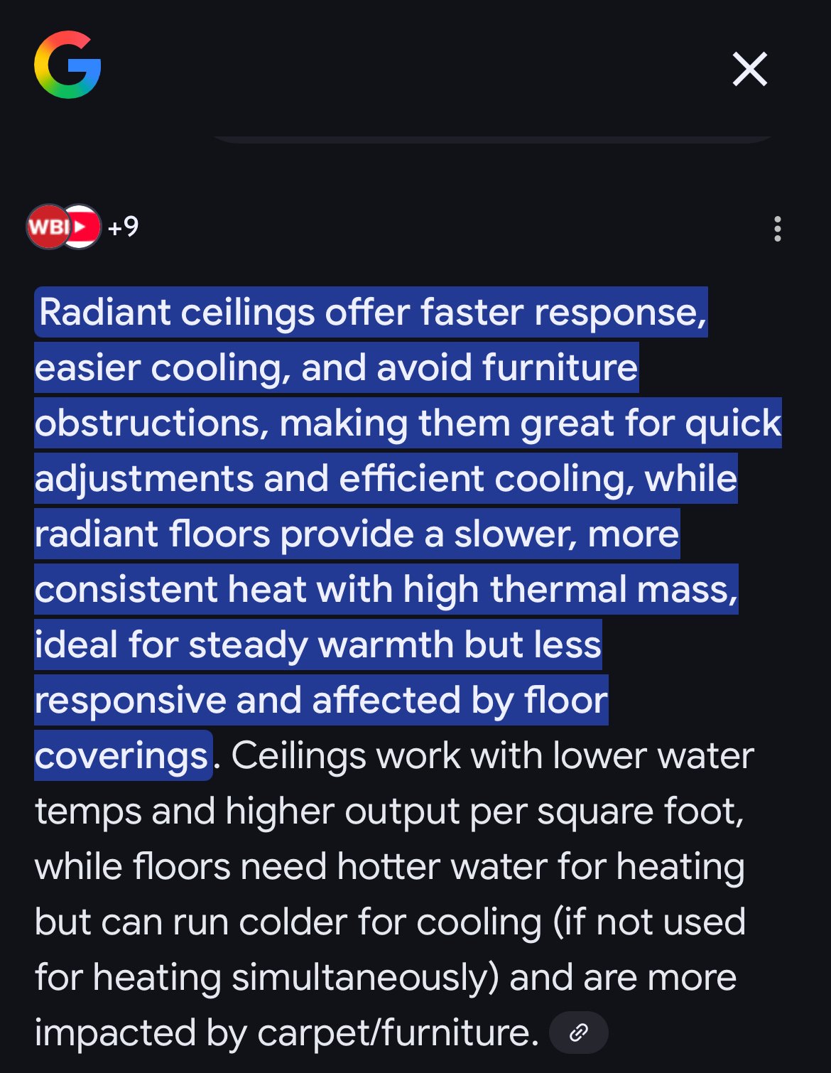

    Some thoughts from AI
  • DCContrarian
    DCContrarian Posts: 1,588
    "Easier cooling" says a lot about the quality of AI answers.
    hot_rod Posts: 28,705
    The point is the heat output with higher surface temperatures, do you agree?
  • DCContrarian
    There is so much gibberish in that clanker text I'm not sure which part you're talking about.
    Radiant ceiings offer faster response,
    Agree
    easier cooling,
    Disagree, violently
    and avoid furniture obstructions,
    Agree
    making them great for quick adjustments
    Disagree
    and efficient cooling,
    Disagree violently
    while radiant floors provide a slower, more consistent heat with high thermal mass,
    "Disagree" doesn't do it justice, it's a nonsense statement
    ideal for steady warmth
    Huh?
    but less responsive and affected by floor coverings.
    Agree
    Ceilings work with lower water temps and higher output per square foot,
    Disagree completely
    while floors need hotter water for heating
    Disagree
    but can run colder for cooling
    Utter nonsense
    (if not used for heating simultaneously)
    Wha?
    and are more impacted by carpet/furniture.
    Agree
    Steamhead Posts: 19,007
    One more example that "artificial intelligence" is a contradiction in terms.
    Semi-retired
    specifically about heat output, ignore the cooling gibberish, I’ve learned to do that with AI
    Garbage in, garbage out
    I believe
    Hot goes to cold
    The greater the delta the higher the transfer
    I think you agreed

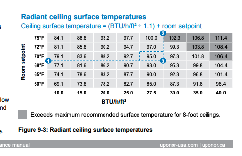

    This Radiant Ceiling output chart from Uponor runs out to 35 btu/ sq ft in a 70 room setpoint, 40 btu/sq. ft in 68° room.

    Mentioned on this page is ceilings radiant outputs up to 93 btu/sq ft from a wall, 83 btu/sq ft from a ceiling 120° AST (in a 68° room) So you can play around with ambient numbers to change the radiant panel output numbers. Uponor suggests 104 AST as their max. And their chart runs out to 40 btu/sq ft.
    I don't see 40 btu/sq.ft in a 68° space realistic from a comfortable residential radiant floor.
