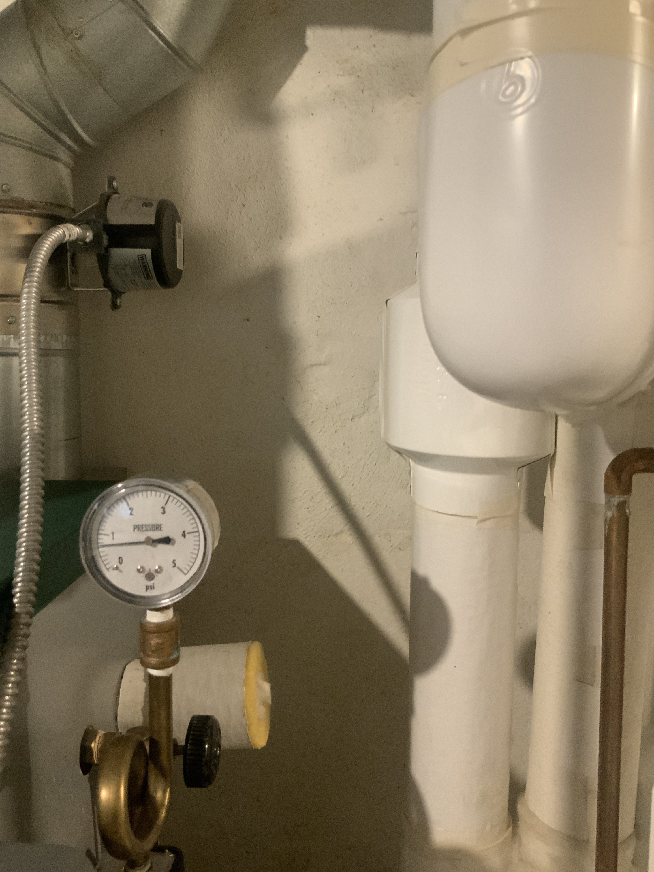

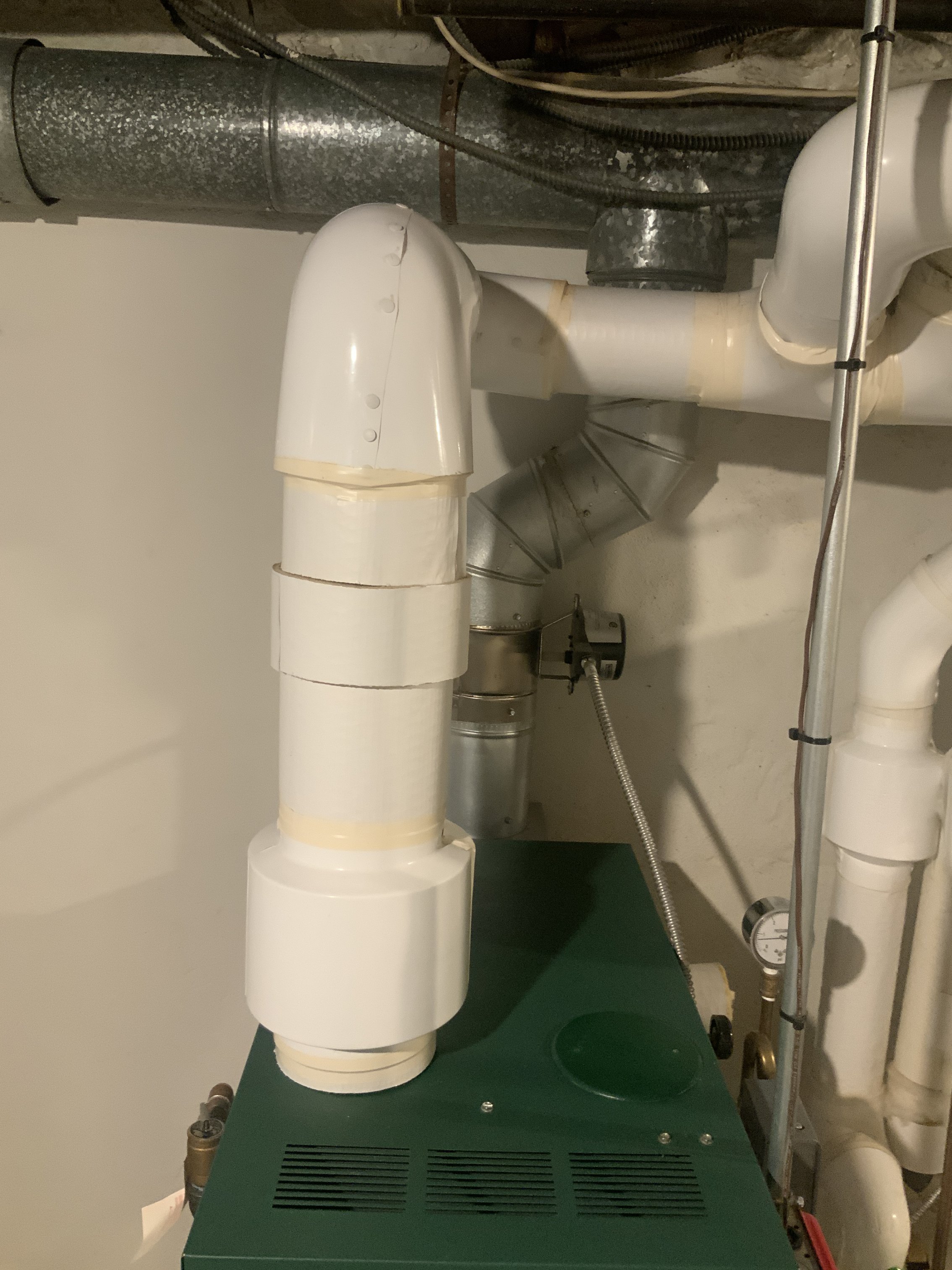

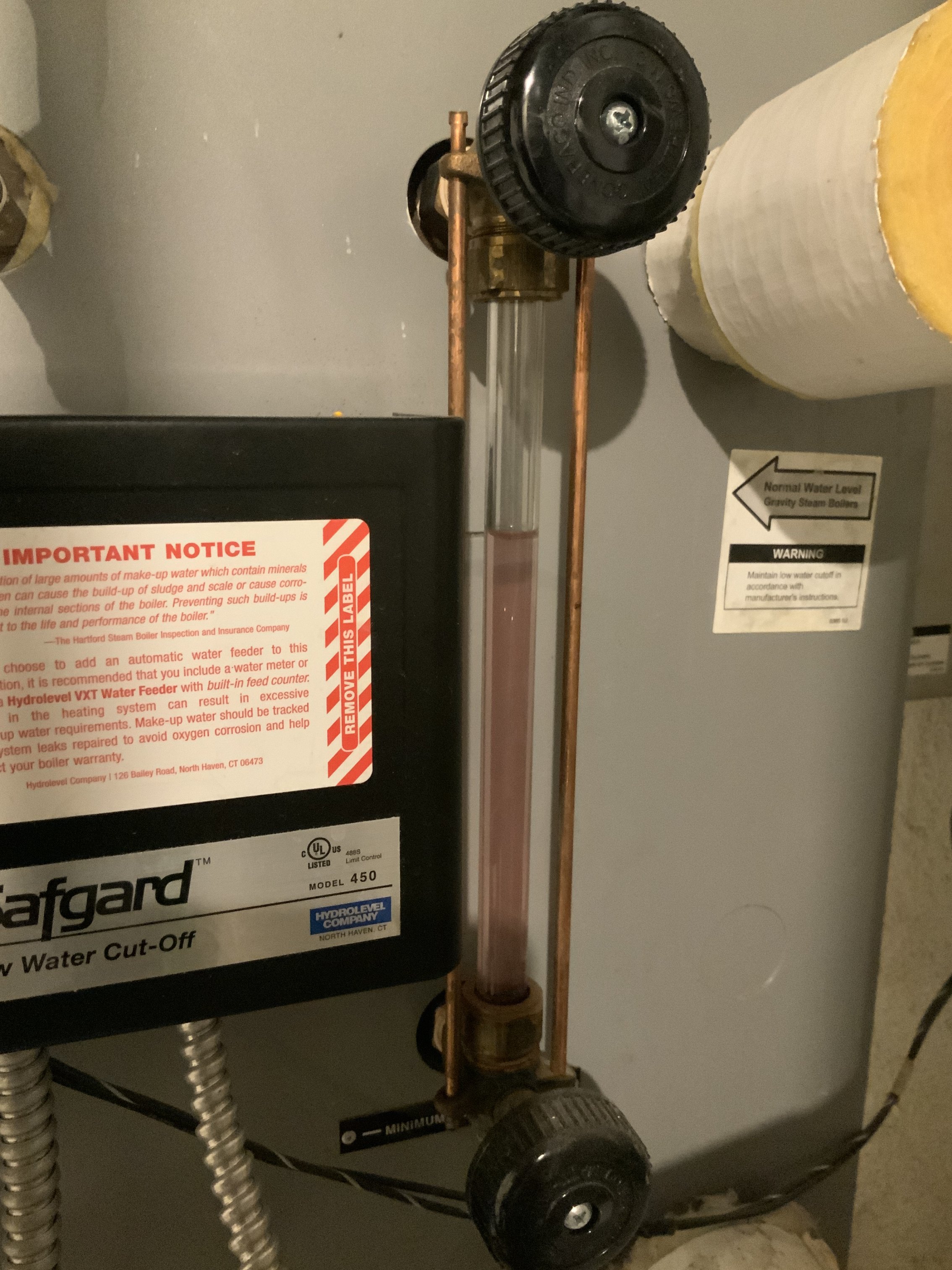

As suggested by @ethicalpaul, I have started this thread to steer the discussion from boiler pipe sizes and carryover to water quality induced wet steam.
Several standards are used to measure wet steam, among them IAPS Industrial Formulation that measures the dryness fraction of steam as a %. The ISO 5167 standard is used to correct steam flow rates by plugging in wetness correction ratios from a pressure table. Then there are inline instruments used to monitor steam dryness, a common one is a mass flow meter for that sets off an alarm when the liquid water content of steam drops below 80%.
I have attached a pic of the water level in the sight glass shortly after my main vents close. It falls another 1/2” towards the end of the heating cycle-typically 20-25mins. I have also shown my pressure reading and my 3” takeoff for my 63-03. I have one pipe steam with two headers.
Sorry but I am presently jet lagged; I will be glad to address any questions I might have missed.
How do I know I have wet steam? When steam reaches the end of my mains, my Bigmouth lets out two puffs of steam,3-5 secs each, before it closes shut. No water droplets fall out, but if I hold a sheet of paper close to this vent, I see several drops of water that are in the form of a mist. At the remotest rads. my #5 Moms will spit out water just before they shut off and a small amount after they shut off, meaning they open intermittently and will spit some water but for the most part remain closed. On my largest rad I have a #C Mom that seldom shuts off because the stat is satisfied before heating entirely, but the vent, not the rad, makes a gurgling sound.
I have a small rad in a bath that makes a gurgling sound which unfortunately has a 1/2” riser. It’s feed valve has a screw, not a knob, but is wide open. It is pitched but has a lot of water condensing in it. I am attributing this to wet steam.
Finally, I should comment about water quality. I drain the boiler to remove the crud because my vents get frequently clogged by rust particles and stop working. I get most of them to work by washing with vinegar but lose 1-2 each season. This is my 4th heating season with this boiler and I have skimmed it 6 times; 2x with washing soda. I had to skim it myself as my installer simply drained it once and added Surgex to it. When I drain the boiler for rust, I don’t see any oil on the rusty water in the pan or in the sight glass. @ethicalpauls video shows that when you have carryover the water level in the sightglass drops. In my case the drop is substantial despite the oversized takeoff.
By method of deduction/ elimination, if the water is leaving the boiler in such copious amounts, with no leaks,
where is it going? Wet steam?

    is your water level at the designated mark when your boiler is at rest?
    If so, you are experiencing carryover.
    “Wet steam” isn’t a thing you can control in a residential boiler because all the steam created is by definition wet steam.
    Your main vent behavior is just normal behavior. A small amount of condensed steam will escape just before it closes.
    all radiators condense a lot of water. If you hear gurgling it is due to something like a mid-pitched pipe or a partially closed or bad valve.

    To reiterate @ethicalpaul 's question slightly modified: does the water level eventually go back to where it was before the cycle? Or are you missing more and more water every cycle due to a leak?

    After draining the boiler to remove rust each month, I have to add 4-5 quarts of water. With each cycle I do lose some water but it only becomes evident after2-3 days of operation. I am estimating that I am drawing down 1+ quarts of rusty water and the rest is water loss from opening and closing of the main and rad vents. I have checked for leaks at the usual places but have yet to find one. During the installation of the boiler three years ago I had the installer check for leaks along the two mains and the wet returns.
    I try to keep the boiler level 1” below the factory mark to minimize the carryover. This season, I have one Ventrite that is closed shut and I am using a #4 Mom in its place. I prefer the Ventrites because they have no problem closing with wet steam while the MOMs spit water even at 0.5 PSI when installed on small rads. They are ok on big rads since they seldom have to close.

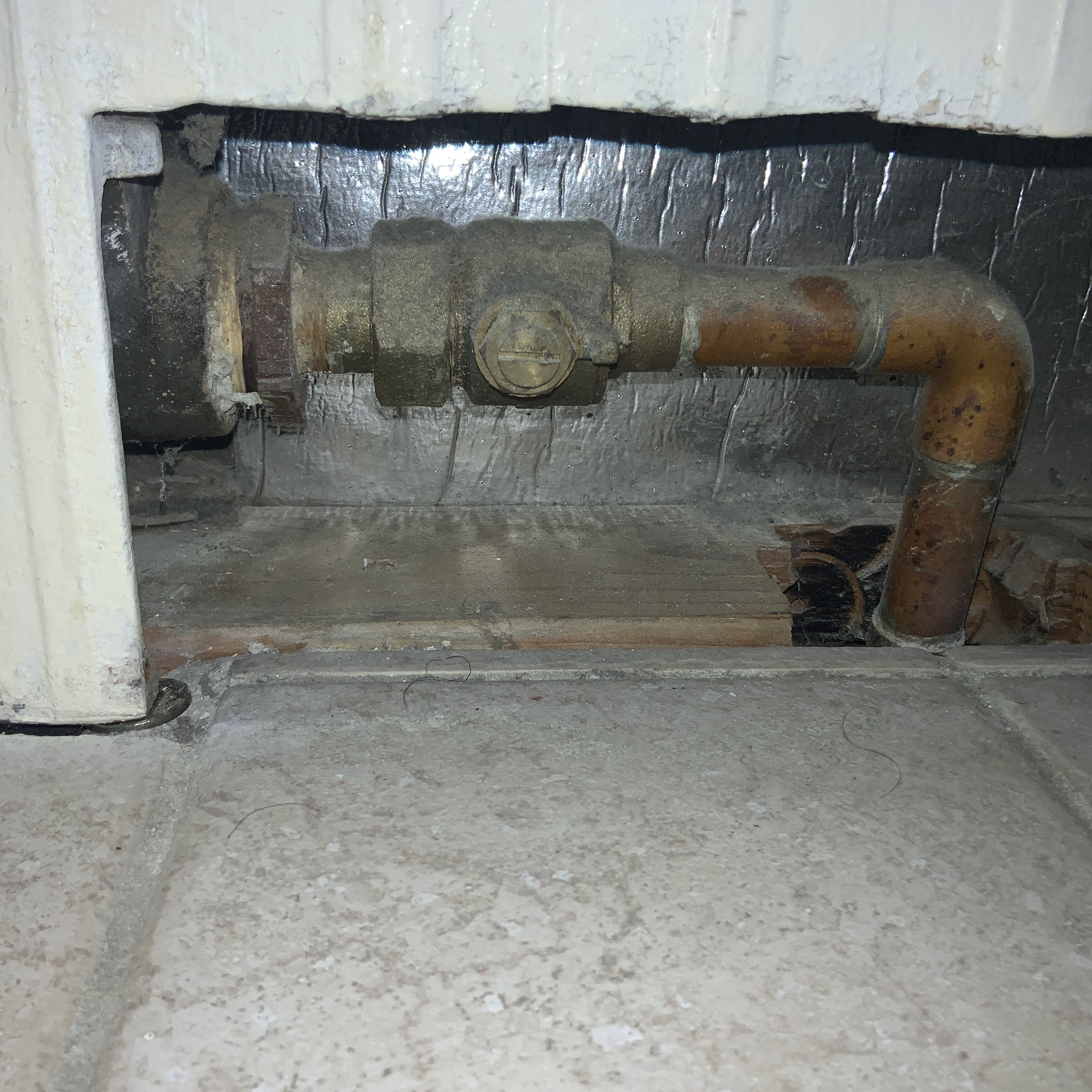

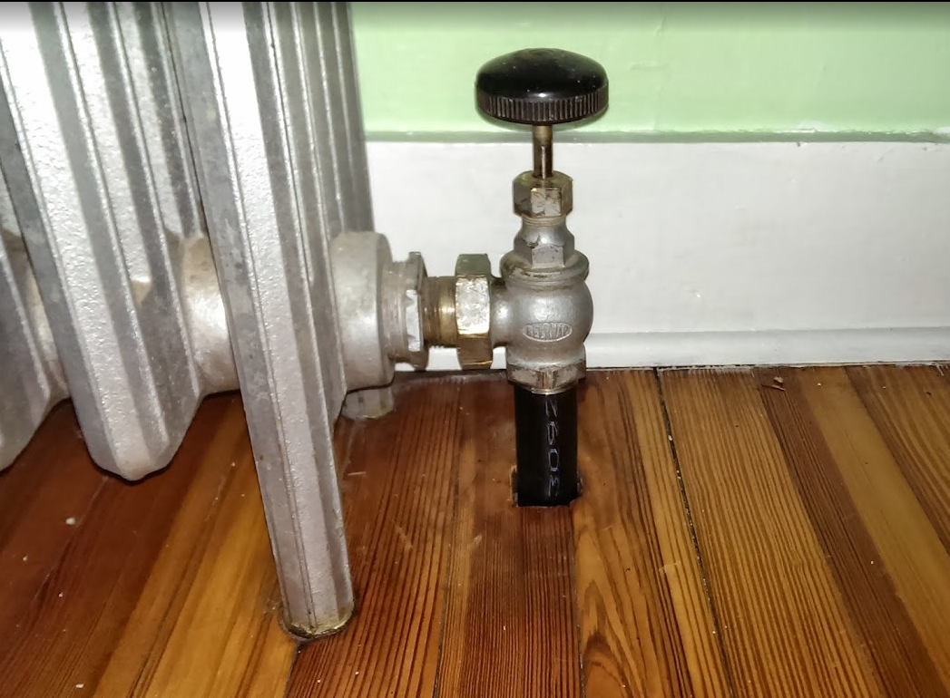

    Anyone know why my radiator which looks like a Sunrad has a port that has to be piped from the middle rather than from one side? After this post, I have leveled it and it continues to gurgle but heats ok. Not sure why it was bushed down to 1/2”. I found out that until 1976 my house was heated by a central boiler operated by the town and the stats were windows, and I am wondering if that has something to do with a small dia riser.
    109A_5 Member Posts: 4,290
    " Sunrad has a port that has to be piped from the middle "
    Can you post a picture of it ?

    Does your sunrad has a return pipe? Its not trying to drain thru the 1/2" supply i hope. If you have a supply in the middle do you have returns at either end?
  • PhilKulkarni
    PhilKulkarni Member Posts: 118
    Here are a couple of pics of the small rad-
    @pedmec, I have a one pipe steam and only one port shown with a 1/2” copper connection. All others in the system are black iron 1” except the largest which is 1.25”.

    is that pipe somewhere where you can repipe it in 1" black? you can maybe make that work if everything is perfect but a lot of things are against you there. i'd set that sunrad dead level because it will hold the least condensate that way. try to give the actual runnout some pitch if you can

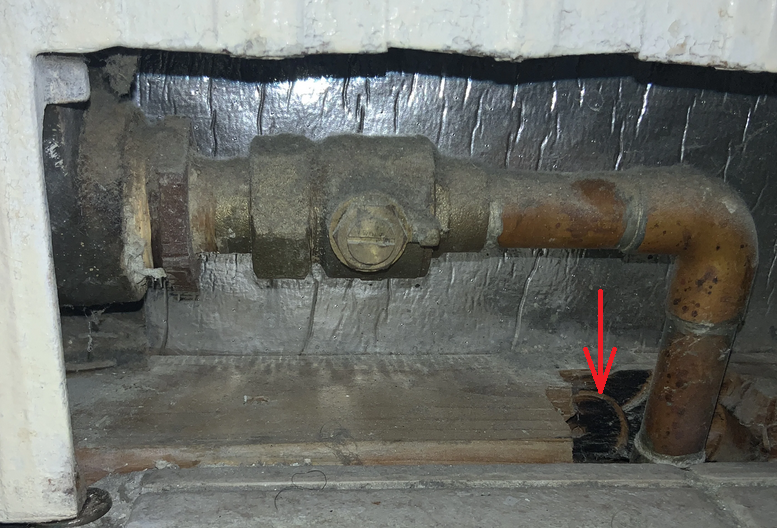

    " Anyone know why my radiator which looks like a Sunrad has a port that has to be piped from the middle rather than from one side? "
    I'd say they were designed that way to get the most radiator in a confined space (embedded into a wall).
    Is the Red arrow below pointing to a cut off abandoned pipe ? Anyway if it works well enough and you can tolerate the gurgle, I'd leave it alone, if not bigger piping and a new valve is needed.

    Don’t know what that pipe is doing there but it is not carrying steam. I will check the rad’s level closely however. Would the copper fittings respond badly if I try to bend them downwards a bit while they are filled with steam? I am thinking about 1/8”, no more.

    " Don’t know what that pipe is doing there but it is not carrying steam. "
    My point is, maybe it did carry steam at one time and it may be bigger than what is presently there.
    I don't think bending the pipe will help much, and you could break something. Depending on how that valve is constructed there may be a bunch of water trapped between the valve and the radiator.

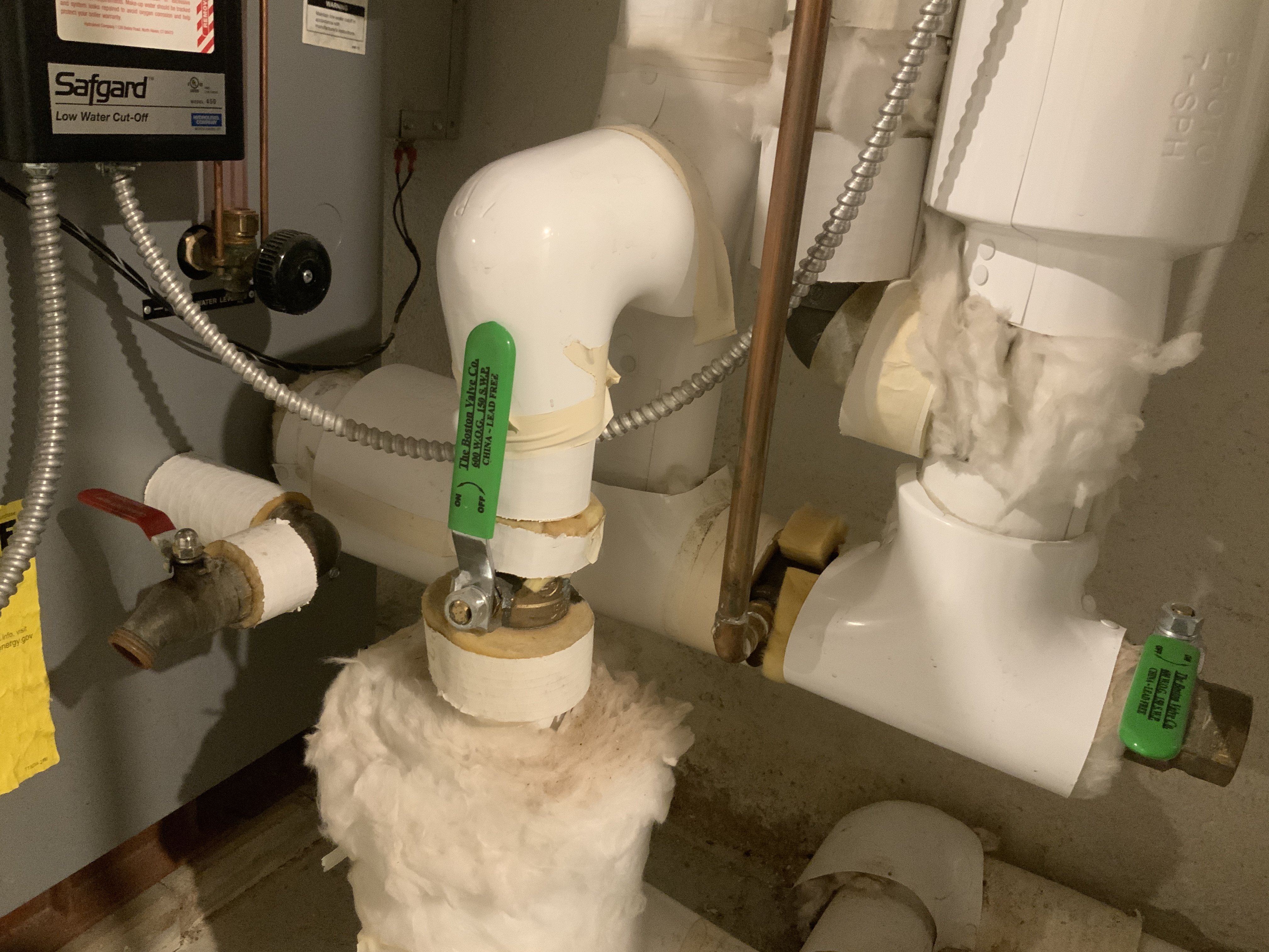

    I have a Peerless 63-04L that was very poorly installed by previous owner and I suspect it was with the help of my neighbor/plumber up the street but I can't prove that (lol). Among other things, the Hartford Loop is right at the NWL instead of min. 2 in. below, and the header is less than 24 in. above the NWL and is copper and the boiler is not level but is much higher at the flue end than the front panel end. Many more issues…. Anyway, it is very sensitive to water quality or it will carryover, sometime spectacularly to the point where one particular radiator on the 1st floor will spit water out of the vents.
    One of the first clues that it is getting to be time to flush the boiler and that carryover is starting again is that the low pressure gauge will start to show a small amount of pressure very early on in the cycle when boiling has just begun. That is because of the slug of water that is going up into the header causing back pressure. Should just see the needle bouncing slightly on zero peg when all is well. I will also see the water drop in the sight glass further on in the cycle to well below the NWL, fully exposing the Hartford Loop, which is a no no. You could calculate how much steam volume it should take to fill your radiators and mains and the water volume equivalent of that and that is the most you should ever see your sight glass go down, barring some sort of tilting waterline issues, which I probably do have with my bad install because I will see my waterline actually go up when the boiler water is freshly cleaned when boiling is imminent and before steaming (single riser used on near boiler piping and it is the one nearest the sight glass). It goes up lots more than would be happening with expansion due to temperature. When it is carrying over badly this never happens so I don't mind seeing it happen.
    I suggest installing a full port ball valve drain valve on the boiler and draining it through that. Then back flush it (several gallons maybe until it appears at bottom of sight glass) by hooking up a hose to that and drain again and keep repeating that maybe 5 times or so until the drain water is pretty clear. I then fill it with preboiled distilled water treated with 2 oz. of Rectorseal 8-way per gallon. That's more than they say on the label. I shoot for pH 9.5 to 10.0. That should give me pretty consistently excellent performance for the entire season but the pipes and radiators are 100 years old and very dirty.
    I plan to start draining 1 to 2 gallons every month or so and putting fresh preboiled distilled treated with the 8-way to see if I can improve the season long performance that way by keeping the intra season particulates down a bit more.
    Wet steam is very real and residential steam boiler systems are not somehow immune to that. It is simply saturated steam with entrained water droplets (ie. two phase mixture). The more liquid water present the wetter it is. You will get a significant efficiency loss with that happening.

    If you could, pleas post another picture that shows the Hartford Loop relative to the NWL of the boiler. The picture that shows it is not a good angle but it seems high.

    You said “When the water is freshly flushed and treated my problematic radiator heats fantastically”. This is my situation too. I had said in my earlier posts, not in this thread, that without the 8-way I have a lot less carryover and dryer steam. Allow me to summarize:
    Without 8-Way:
    Boiler pressure 0 psi. Cycles on pressure when ambient drops to 25 or below.
    Water level drops 1.5” in the sight glass
    Lot of rust in the boiler at end of the month
    Remove and clean rads clogged with rust at least once a month
    Lost 3 rad vents last year
    With 8-Way and store bought distilled water:
    Boiler pressure .6 psi. Still cycles on pressure when ambient drops to 25 or below.
    Water level drops 4.5 “ as pressure rises to .6psi but does not trigger the LWCO.
    Less rust in the boiler but more wet steam
    Lost one Ventrite early in the season. Rest of the vents are operating without any cleaning
    My use of distilled water is for the most part experimental, I will use it for the rest of this season and then decide if I want to continue. It is inexpensive, but I get your point.
    I replaced my wet returns 24 yrs ago but I see very little rust when I drain them partially each October. This might be because I have hybrid counterflow and parallel mains and some of the rust in the counterflow sections is being brought into the boiler from the two drips. Mine are black iron. I have attached a couple of pics of the piping near the Hartford Loop and the ball valves.
    My boiler is well matched to my radiation and pressure is not a problem at all. It takes 5-6 mins for the pressure to reach .6psi from a warm start and with fresh water, the boiler operates at 0 pressure for most of the winter. If you have gripes against poor boiler installs, then you are on this forum for the right reasons. Few contractors can install them correctly even when the installation schematic is taped on the wall in front of them. More fly fishermen have read books on steam systems than installers with 30+ years experience. A wise man once said “A funeral is better than a failed heating system”

    OK so it looks like the top of your Hartford Loop Short Nipple or Street Ell is about even with the bottom of the Safgard? That looks like it is plenty low enough.
    Carryover worse with 8-Way.
    What is the pH when you add the 8-Way? Alkalinity can contribute to foaming if you still have rust particles. Maybe you are not getting very much of the sediment and rust out of the boiler in your draining and refilling process? I had to back flush mine several times this year through the full port ball drain valve. Last year I did it for over an hour with a hose supplying water via the pressure relief valve nipple location, with a little pump taking the water out through the full port drain valve (a pump which I returned because they said it was the complete kit with floor strainer etc. and it wasn't….long story) and I often turned the water on and off trying to disturb as much sediment and rust as possible. I also removed the problematic radiator last year and took it outside and flushed it out. While it was disconnected I flushed water down through it's piping through the dry and wet return and out the return drain valve.

    I'm still wondering about your takeoff from the header that looks to me like it is almost horizontal in orientation and whether that is contributing to the problem.
