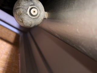

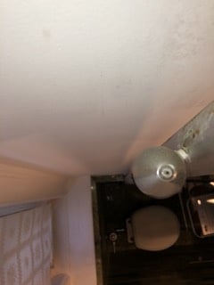

    Here are pictures I took today of the vents. I brought a ladder over and was able to use my iphone to get these images. These look like tiny vent for a small radiator- why would someone put them on a steam riser- and would having them on the riser be causing problems for my radiators? I don't really know the function of a vent on a riser and have had a hard time looking it up online.
    I forgot to add in my earlier comments- I have one radiator that is working great, buty I don't think it is serviced by any of the steam risers in my unit, as it is next to a shared wall with another unit and on the other side of the wall is my neighbors bathroom, which I am assuming has a properly vented steam riser in it. All the bathrooms in my apartment have steam risers in them.

    dabrakeman Posts: 1,038
    Most likely too high pressure on the system or insufficient main venting in the basement. If those risers were intended to be main vents for the entire 12 story risers then yes they would be too small but without pictures from the boiler room I am just speculating.
