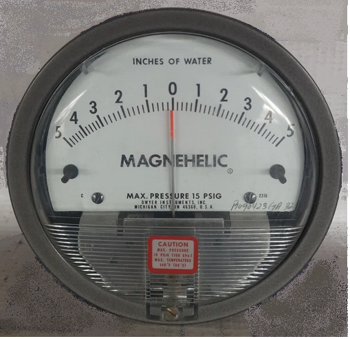

    Item 1: Low pressure is good, however if you want to see the active working pressure you may need this or the like.
