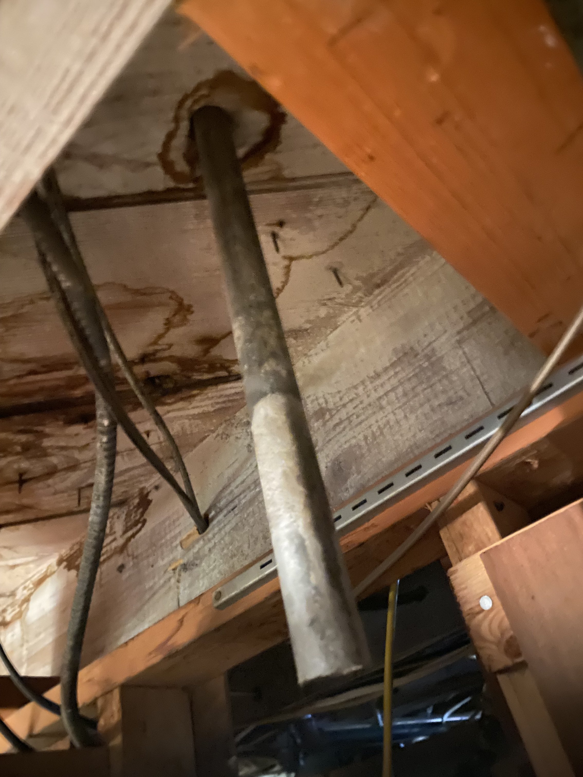

I have a two pipe vapor system that has a 76 vent on the return line to boiler. Also, there is a vertical pipe coming out below the basement ceiling about 8 inches long. It’s the same size dia as the return line to the boiler. I don’t know what it’s for if anything. Please advise.

  • unable to find the other end - the pipe is in somewhere in the wall. held a flame to the pipe end while boiler is running - flame is steady - no movement.

    that looks like an abandoned pipe. The end was cut with a hacksaw or sawzall

    You would have to envision were it may have gone to. Like a radiator that was removed, to the 2nd floor or attic, a water pipe left over from a repair or remodel.
