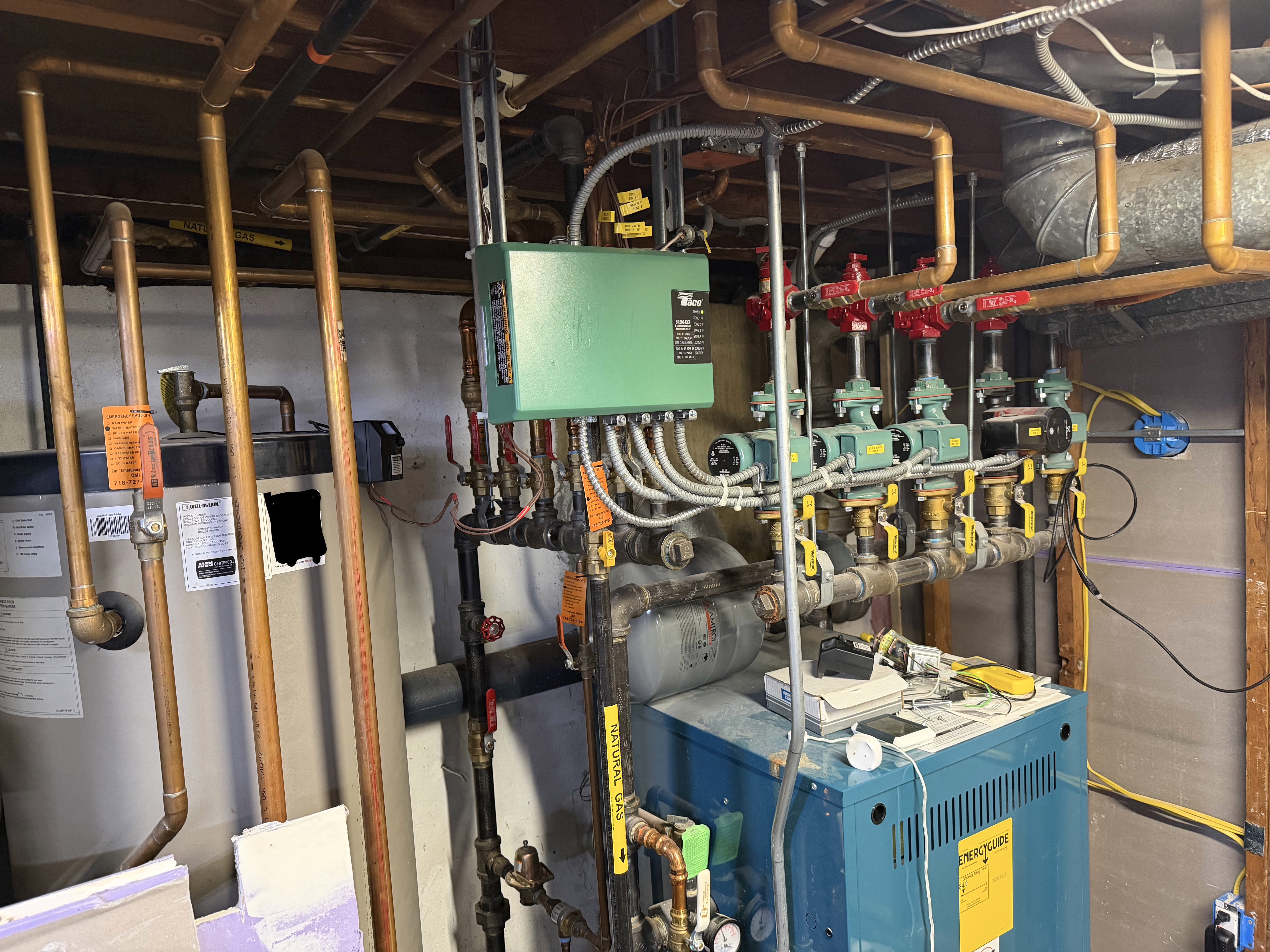

I'm struggling with a long-term problem with ghost flow/thermal migration in my hydronic system that currently has my tap water scalding hot and my boiler temperature/pressure valve dripping on the floor. As it stands, my usual plumber wants nothing to do with the problem, since he can't stand behind any solution. So some background...
About 2 years ago, I converted my oil boiler to a gas boiler. The current unit serves 5 zones. Of those 2 of them are single rooms (additions to the house), and one (the basement is never used as there's never been a need). So really, the main factors are the main house zone (that's the black circulator pump) covers both floors (which always results in a cooler upstairs, but that's the pipe layout I'm stuck with) and the water tank priority zone.
When the new boiler was first installed, we had all kinds of ghost flow issues, where hot water flowed to zones that weren't calling. This meant that even a room with the heat totally off would be 85 degrees. It took the plumber doing the install several consultations with other plumbers before they started putting check valves anywhere they could think of. Along the way, we had the transformer for the main board fail, as well as 2 of the circulator pumps — which I doubt is relevant, but figured I'd include for completeness. I'm unconvinced they understood the underlying issue(s), but a bunch of hasty valve installs seemed to solve the immediate issue of my house being a sauna, and we called it done.

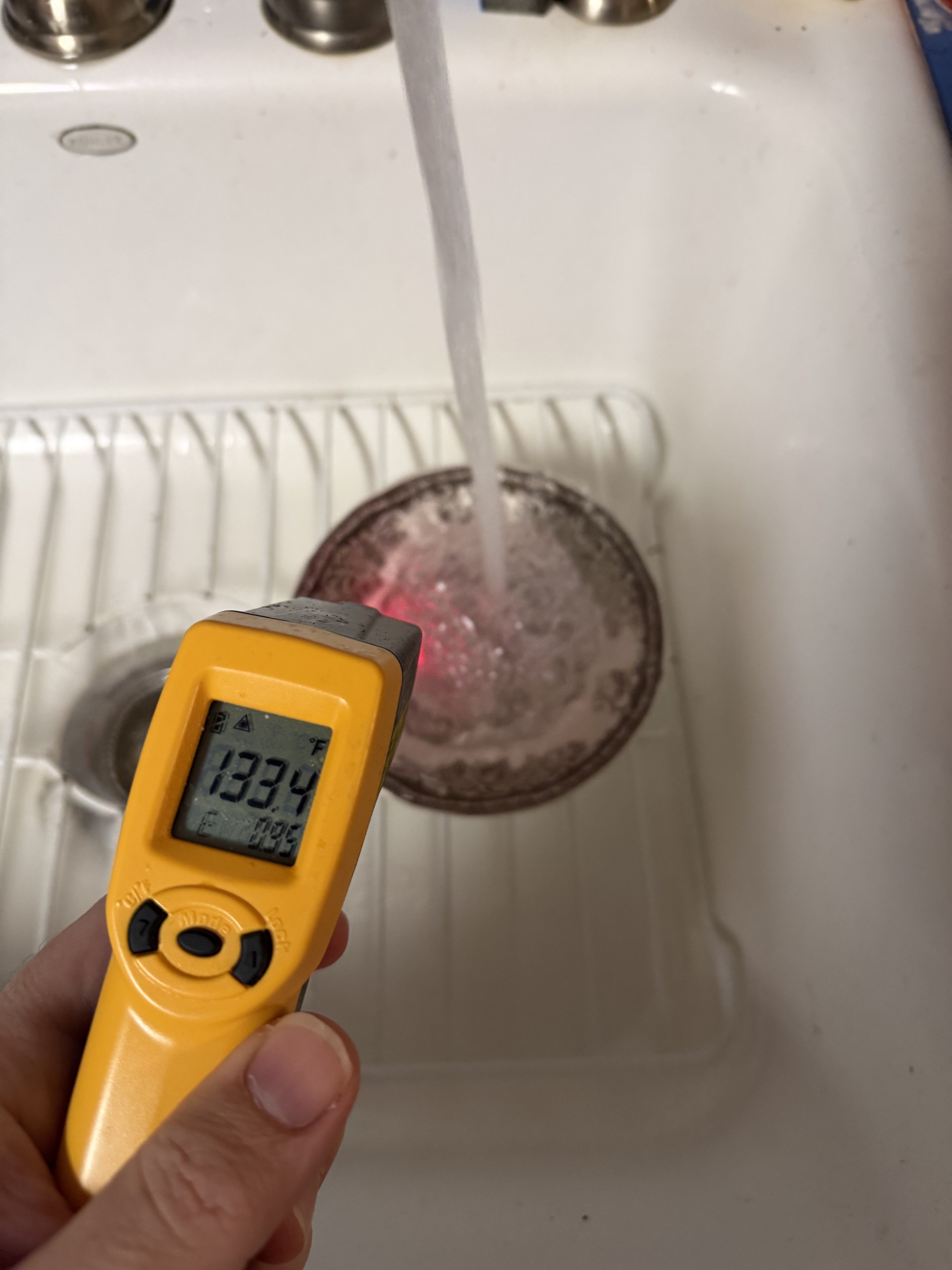

Later, I started noticing my tap water was really hot. The new system brought with it a 55 gallon indirect water tank (the prior system just heated water on demand I believe). So we measured the tap temperature, and cross-referenced with the setpoint of the aquastat on the tank, thinking it was just a linear adjustment. But it wasn't. There was no clear connection with the aquastat setting and the tap temperature (always much hotter). As you might guess from the picture, we replaced the aquastat (the old one is sitting on the boiler), though not the probe, since the way it was installed would have required a huge effort to change. This didn't change anything, and i Just resigned myself to being careful with the hot tap. The 133F reading you see is at a 118F aquastat setting, by the way.
A few weeks ago, I noticed a puddle on the floor under the overflow pipe, and noticed the pressure was right around the trigger point for that valve (30psi I think?). It wasn't a lot of water, and it had probably been leaking for some time and evaporating. But once I put that white ice bucket under it, I realized it was a fair bit of water. I had my usual plumber out, and he checked to see if the expansion tank was in good shape (it was), but couldn't find anything else. He didn't want to replace the overflow valve, as he felt he couldn't stand behind just treating a symptom.
I continued monitoring all this, and everytime there was a leak, I got an alarm. And what I noticed is that no zone was calling when the pressure climbed up around 30psi and the water release began. So after doing as much reading as I could, I can think of only 2 alternatives:
1. The probe in the indirect tank is causing issues in terms of asking for too much hot water, and therefore bringing the pressure of the system too high. This seems unlikely, given that the tank isn't calling when the issue occurs, but maybe I'm missing something on this possiblity.
2. There's ghost flow/thermal migration where the boiler water is slowly migrating into the indirect tank, heating it when no call is happening, raising overall temperature and pressure. If this is the case, I guess the solution is more check valves? But no one seems to know where that would go, if that's the solution.
I've included as many pictures as I thought might be useful. But let me know if zooms, or labeling on my end would be useful for troubleshooting. I feel like someone else must have seen this combination of scalding tap water and pressure buildup and have an idea no one here is having. Thanks in advance!

    You say you checked the expansion tank… how? What is the system pressure when the boiler is off and at least cool, if not cold?
    And where is that tank connected relative to the system pumps?
    I must admit that I have my doubts on that tank being big enough… but it might be, I suppose…

    But when I had my plumber out, he tapped on the expansion tank, telling me that a hollow sound was good and a solid thud was bad. Were there other diagnostics he should have done?
    The pressure reads about 12-15psi under normal conditions (it's never quite off here in the Northeast in December), and just around 30 while leaking.

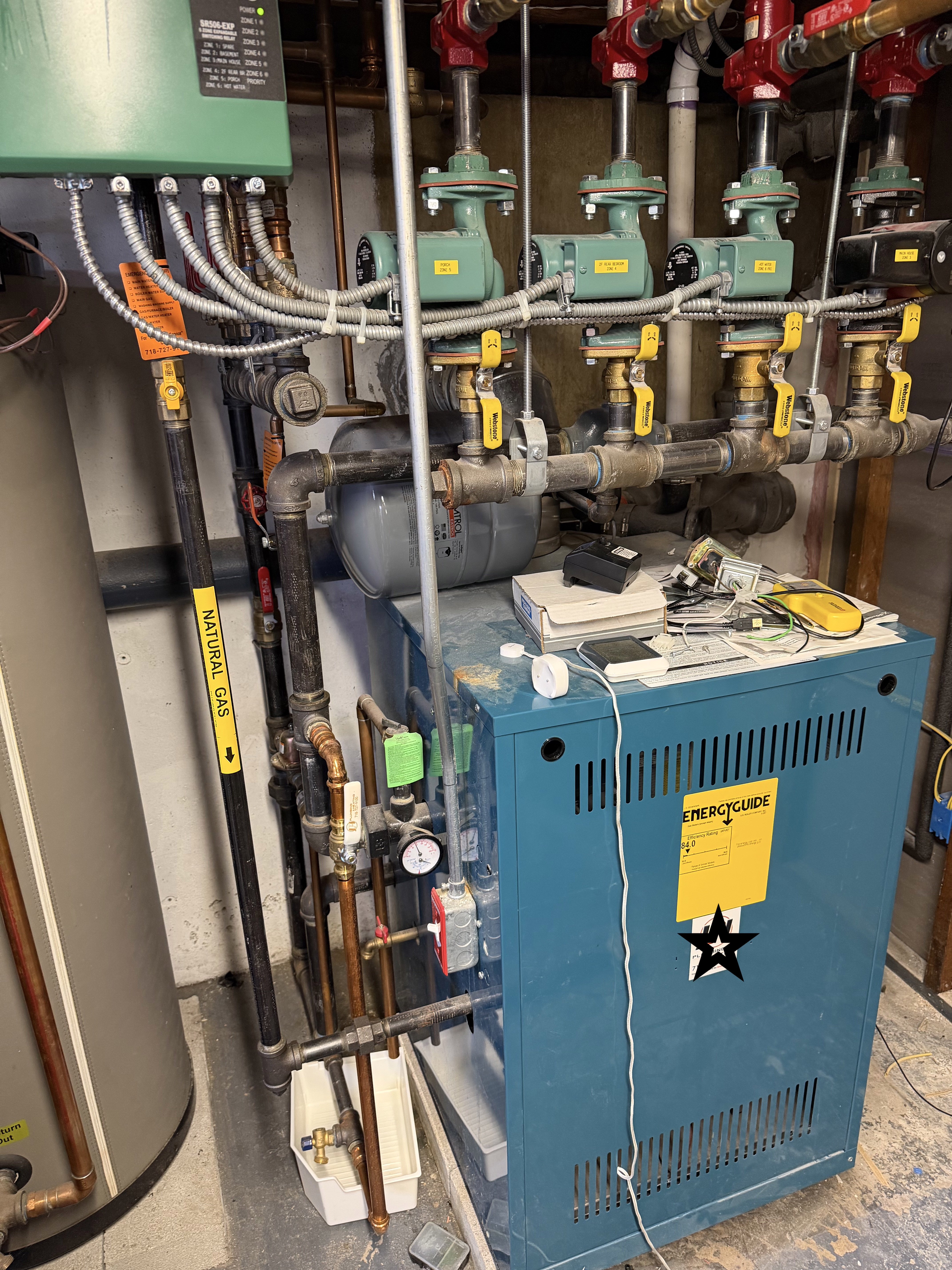

    The tank is connected around 18in to the left of the boiler and its pumps.

    btw the indirect should be set up with a mixing valve to keep the dhw at the desired temp. there are lots of reasons the tank might overshoot the aquastat not the least of which being that the differential may be 20 or 30 degrees depending on which model you bought. it is generally in the installation instructions for the indirect.

    Check the charge on the thermal expansion tank , it will be on the cold water line . They tend to loose its charge .. Set it to system pressure ….

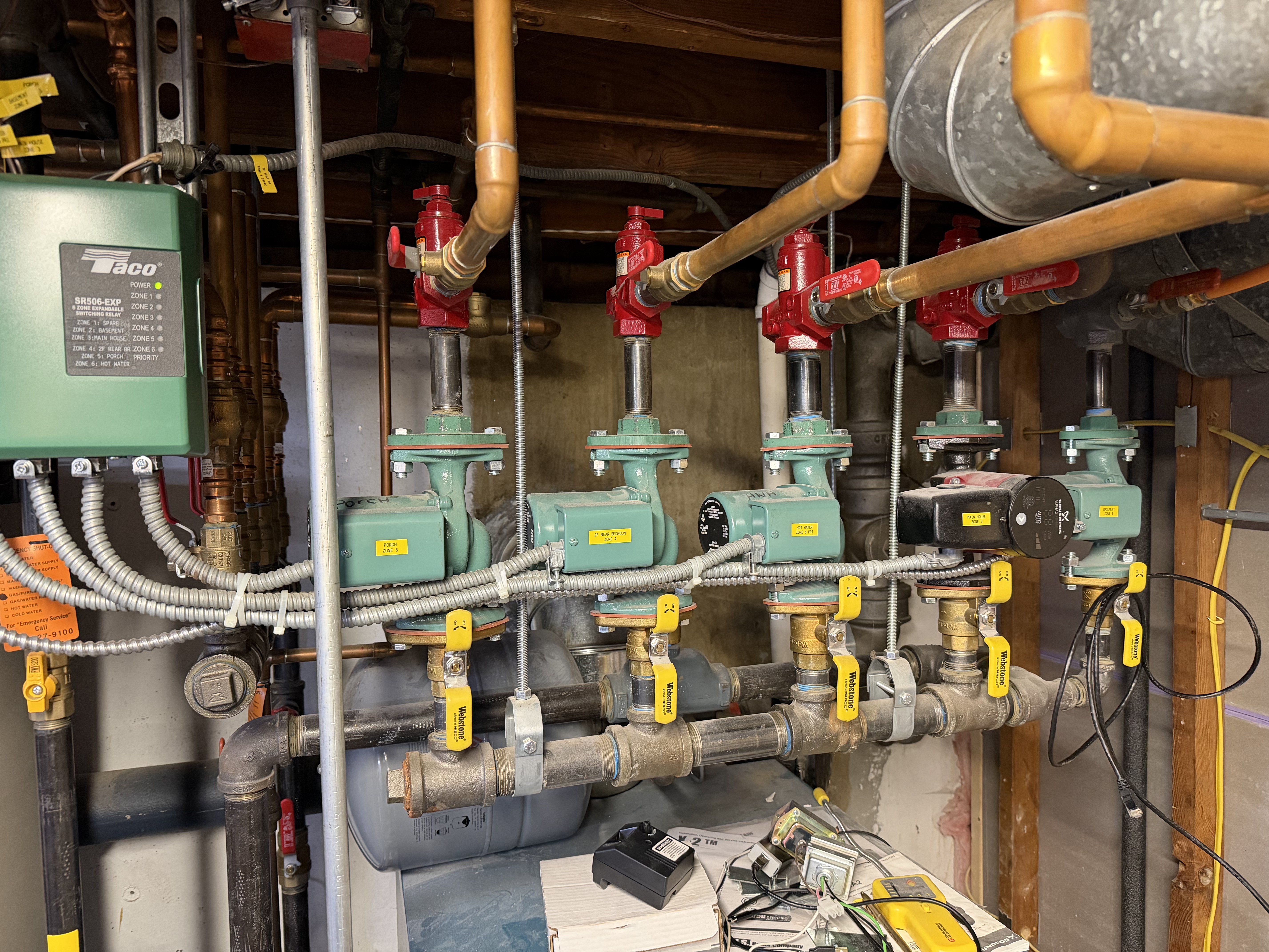

    The small lever on those red flo-checks, is it screwed all the way CW? That is the only position they work as a check.

    I wouldn't have used those B&G flow-check valves, a volute check valve at the pump and an inline check valve at the circuit return would have been my choice. That would prevent any thermo siphoning. That means a check valve on the indirect tank loop to the boiler, too.

    Looks like a job to get that tank out of there. The original installer did a dumb move putting it there. If you get water out of the ex tank air fitting its shot as @hot_rod mentioned. Even if you don't get water it could be bad but to test it it has to be removed to do that. Might as well replace it at that point. if it was me it would be in an accessible spot with an isolation valve

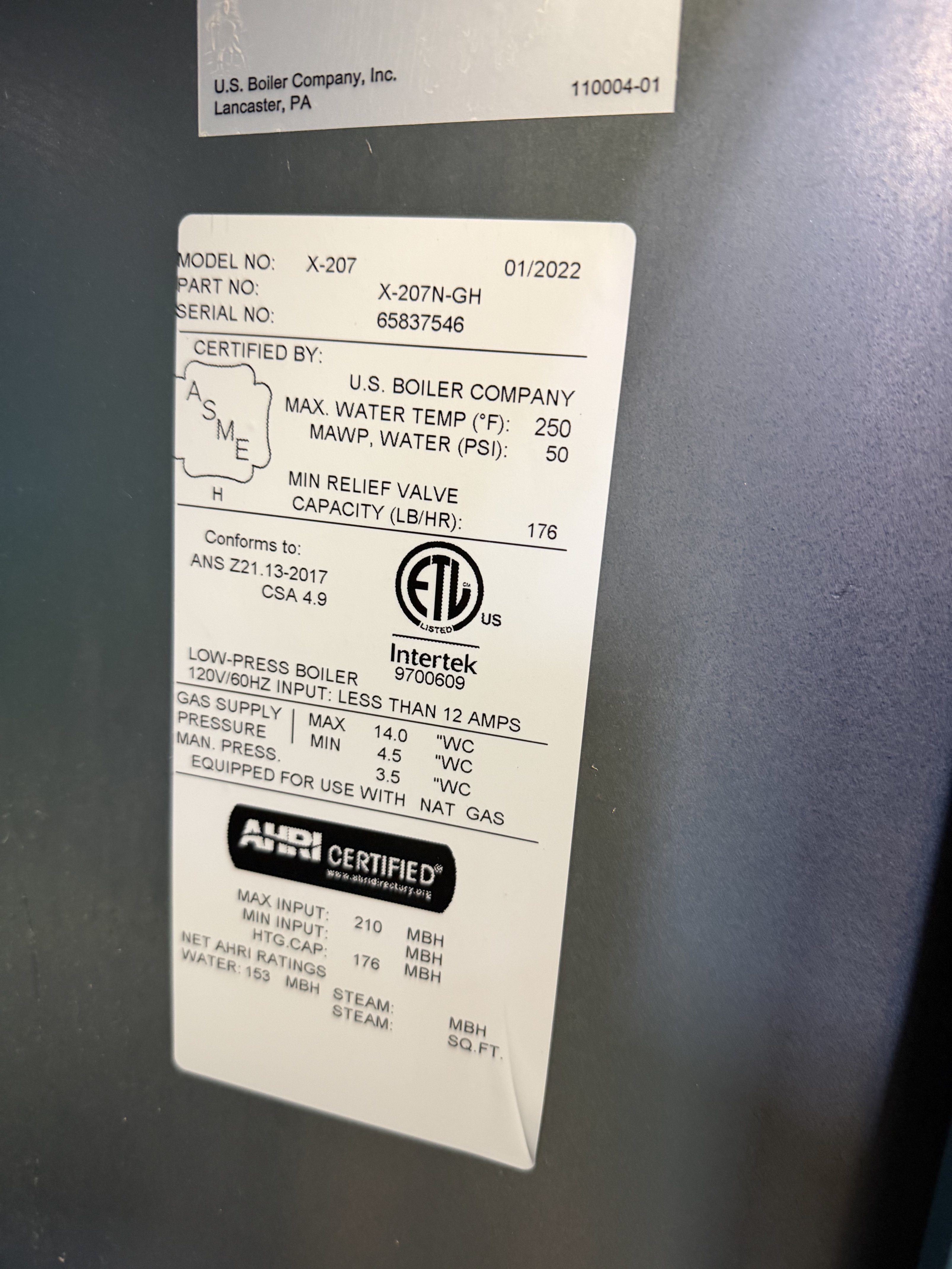

    Generally you don’t want more than 65 % of the tank being water, this is where the acceptance number comes from. At the boilers highest temperature it should be below 27 psi, that is the psi Amtrol uses in its calculator, unless you change it.
