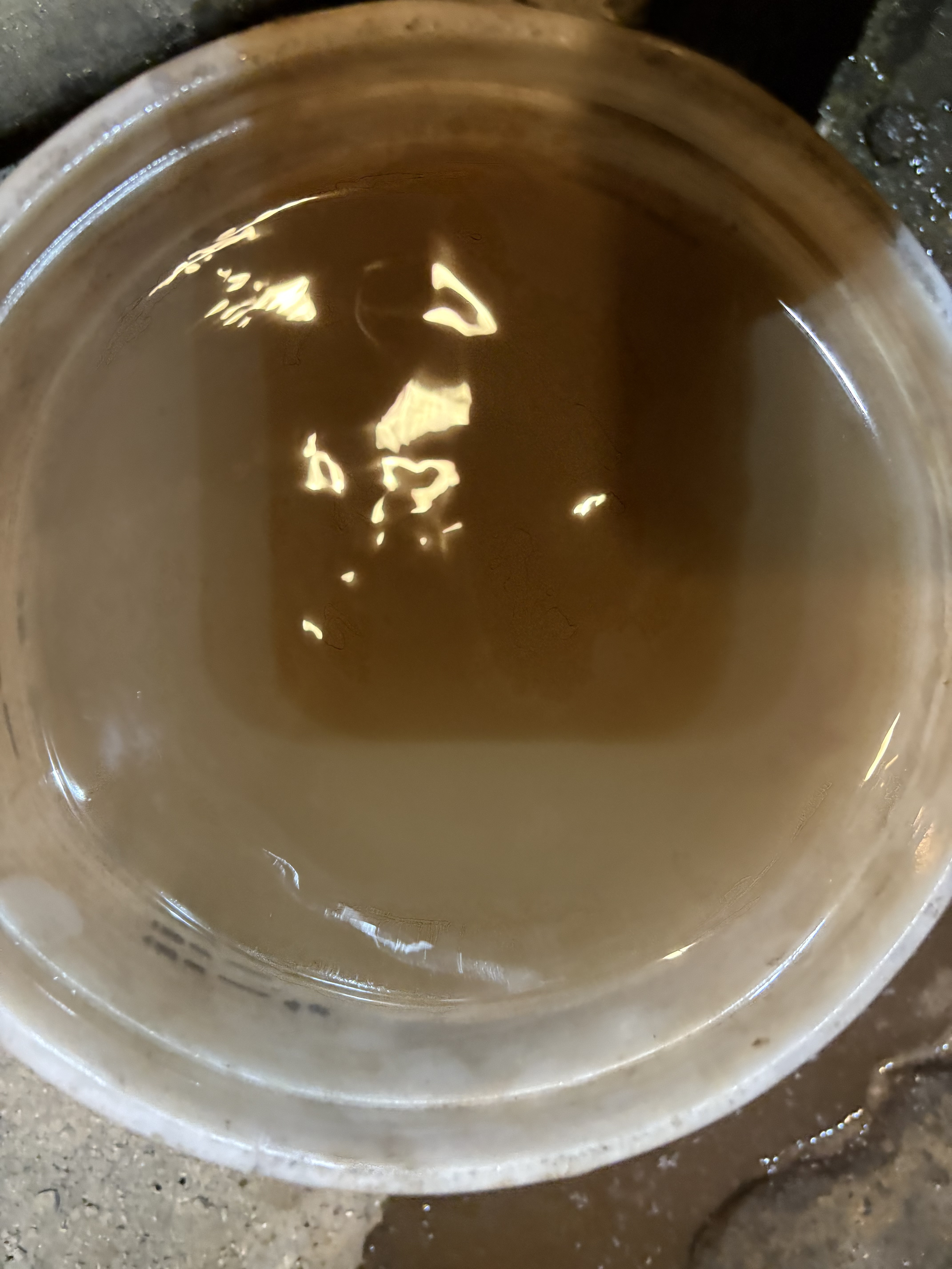

  • Sounds like the boiler needs to be replaced or the BIG gamble of regasketing it which might be a waiste of time once you get it apart. Your noted questions I suspect you already know the answers to since you have the manual on the book. You just want a bunch of people to confirm your findings to make the other installer look bad? I would open up the LWCO and look for mud for my own liability reasons and if I found some in there I wouldnt run it until rectified. You can blow it down all you want but if 100 steam guys are brought into court because a LWCO failed due to sludge then they and the jury are going to blame you, suggesting that your not telling the truth about blowing it down. Ive seen regularly blown down LWCO's get sludge in them.
    mattblaine13
  • I’ve blown down the LWCO regularly. At start of season it’s brown water. Takes roughly 2.5-5 gallons to come clean based on my bucket method. No drain in boiler room.
    during season first quart or so is dirty. Second quart is clean
    Year one the installer back flushed and cleaned the LWCOs because they were dirty.

    blowout valve water 1x a week. 5 quart bucket
