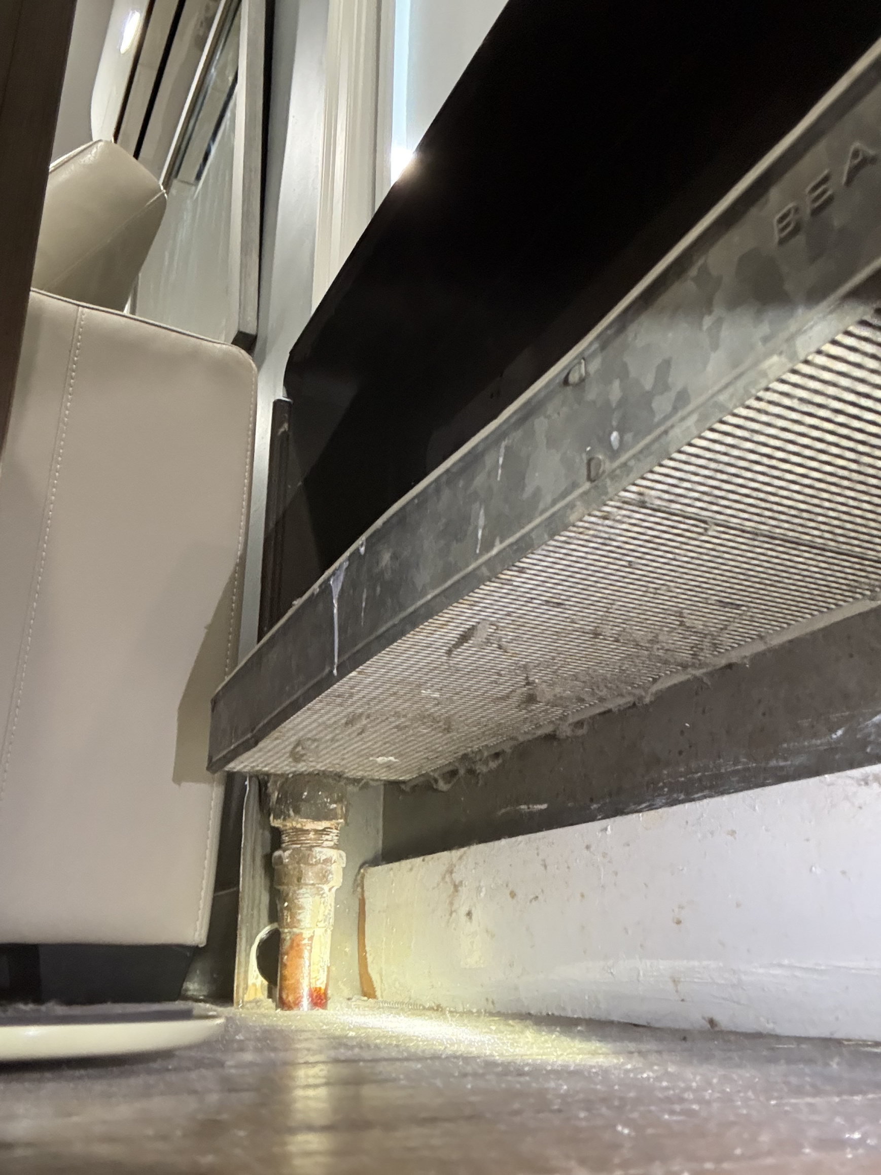

My steam convector is making some weird noise when heating starts. Here’s the video : https://youtube.com/shorts/q619q3dOlUw?si=H92irkoNFkvUZ8Nb
There is only 1 pipe connected to it, and it is pitched toward that pipe.
What could be causing that noise ?
Could it be cause by the extended height of the valve connected to it ? See pic attached .
This convector is at the end of a line of convectors. The other 2 don’t make that noise.

    it is condensate trapped somewhere colliding with the steam entering the convector. it could be in the convector itself or it could be in the piping to it somewhere. is the convector pitched toward the valve? is the valve entering in such a way that pitch toward the supply and and the valve itself are one in the same? some convectors have side connections toward the center that sort of form a u that can trap condensate

    is the valve open all the way?

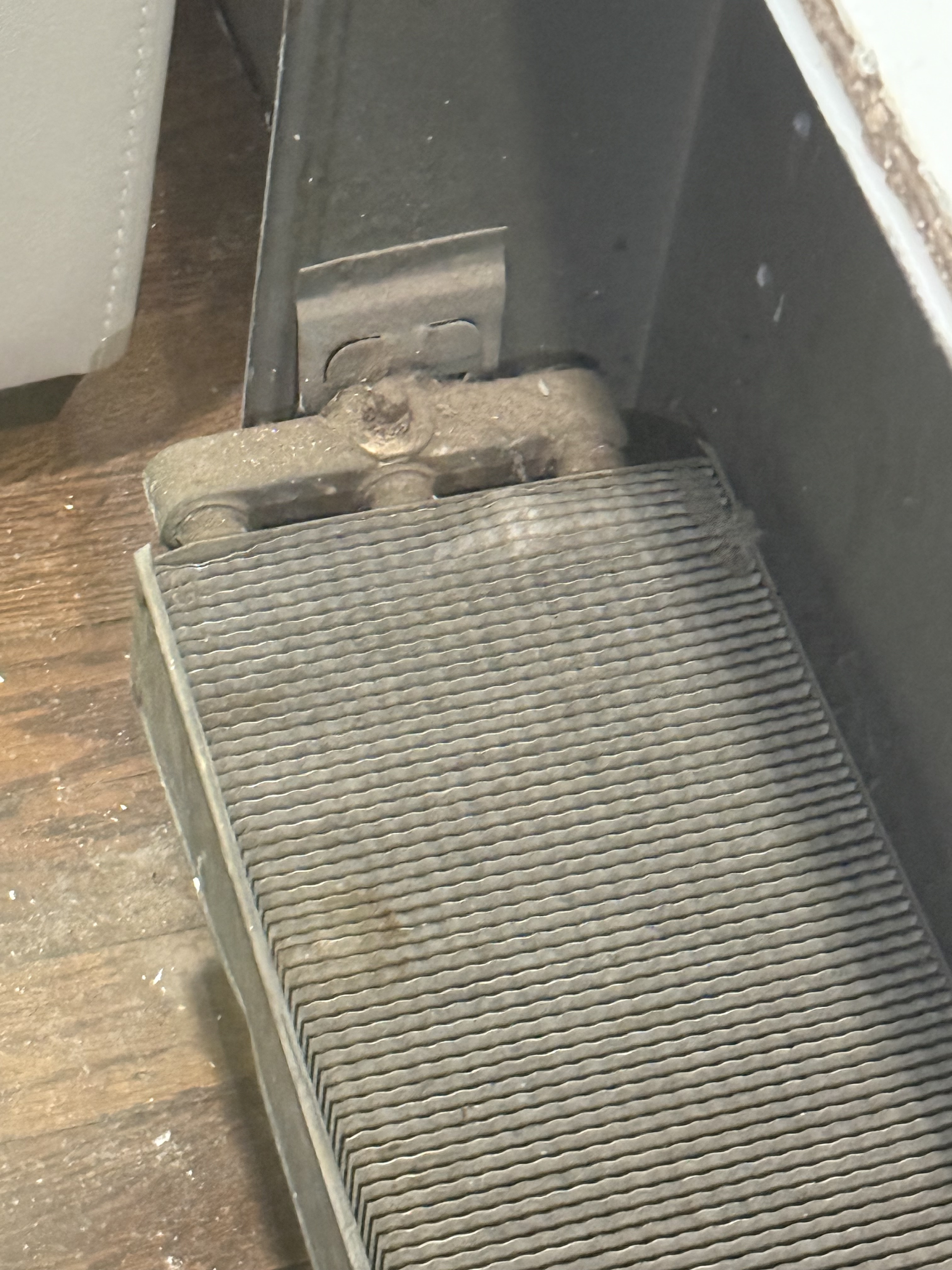

    There is only 1 pipe connected to the convector, and the convector is pitched toward that pipe.
    I don’t see a valve handle under or over the convector. See attached pics.
    Am guessing the valve handle is under the floor / hidden in the basement ceiling.

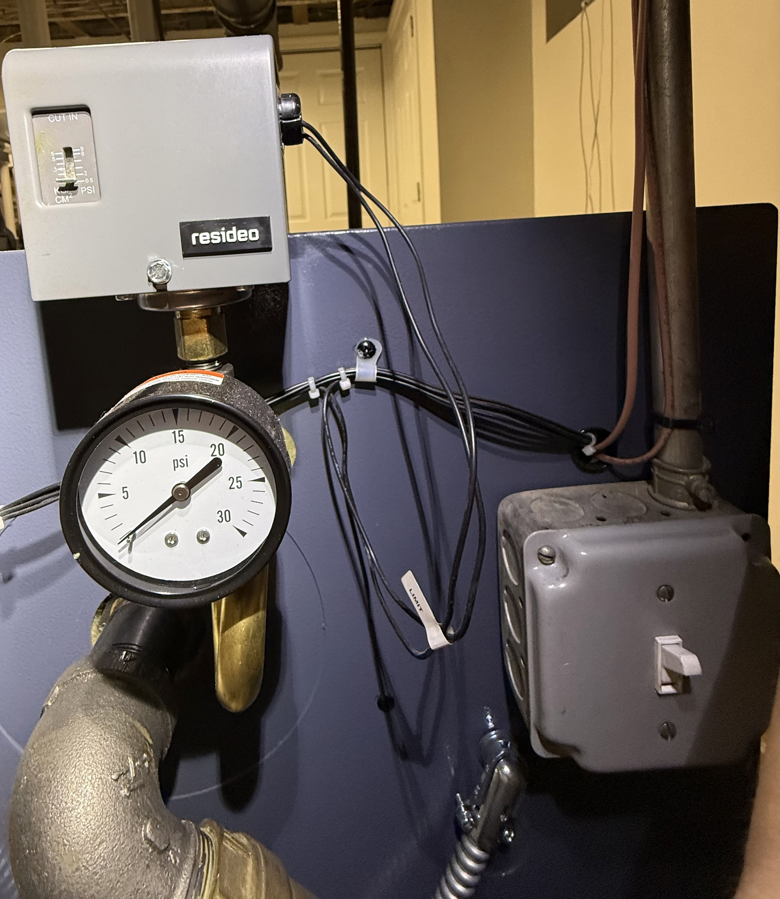

    what's the boiler doing for pressure?
    Ptrol settings, and pigtail service, show us a picture of the controls side of the boiler

    here’s a pic of the pressuretrol

    Noise has reduced since I added some pitch to the convector.
    how much pitch can I safely add to it without causing a leak on the supply connection to the convector ?
    mattmia2 Member Posts: 17,902
    as long as you don't break the pipe off but an inch or so over the length of it should do it.

    have you, or anyone serviced the pigtail?
    they get clogged up, it needs to be free breathing back into the boiler so your gage and Ptrol can see the boiler pressure,
    and high pressure could be adding to, or be your issue,
