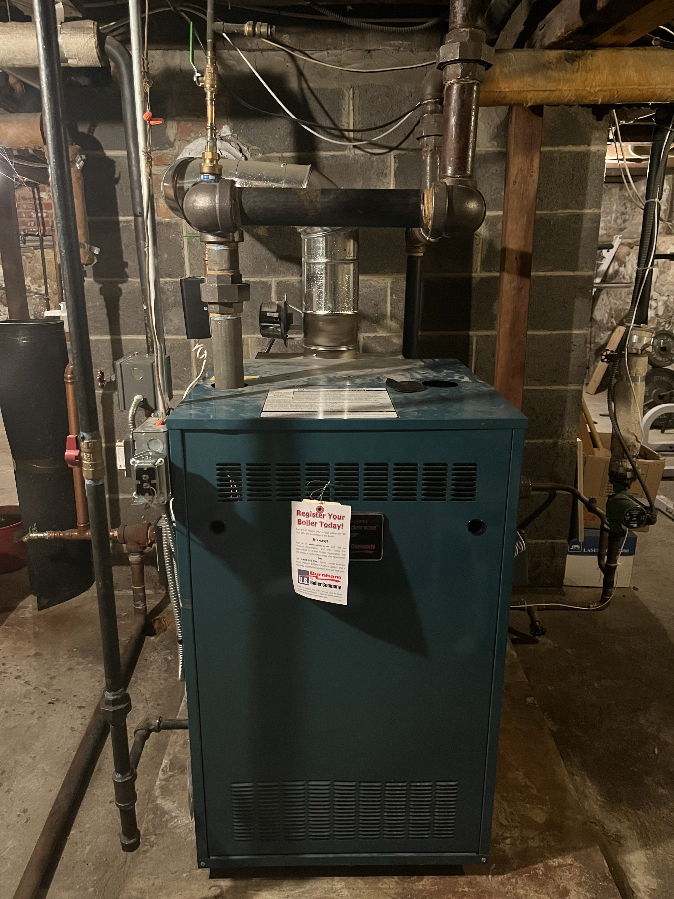

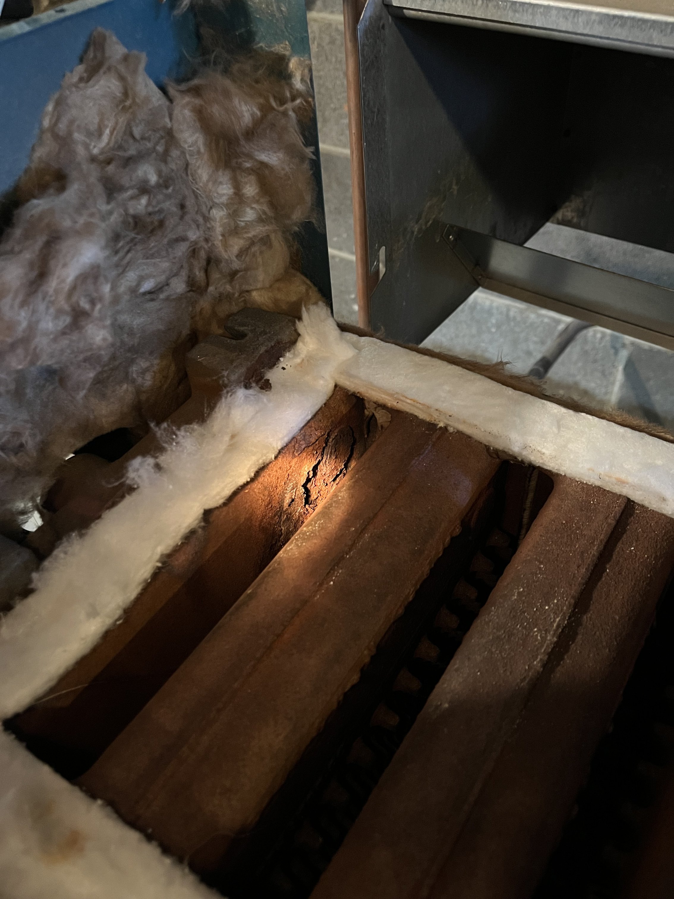

Four days ago, I’d called in a local company Heating & Cooling company to diagnose high water consumption on an IN6 gas fired steam boiler. They came out twice, checking the LWCO, feeder and exchanger (to some extent ). They diagnosed it as a cracked heat exchanger after hearing steam leak and moisture at the rear of the boiler from the hood area. I’m sure they did some other tests, but I’m not an expert, but did try to stay around the entirety of both visits to glean as much info. They have said I need a new steam boiler. I asked for a quote for which they did a radiator calculation, asked about our window and insulation as the home is older (circa 1865), but has newer double pane windows throughout and blown in insulation from the prior owner. Their quote for replacement was $ and suggested downsizing to an IN5 as they thought the IN6 was oversized. The boiler is only 7-8 years old, with a mfg date of 06/2108.
My wife asked that I contact the original installer, who has since been absorbed by another company, as the heat exchanger has a “10-Yr warranty.”
The company came out and after some Q&A disassembled the burners to look for up for any cracks. After noting nothing and no signs of water around the base, filled the boiler after cooldown and discovered the hole/crack at the top of the leftmost heat exchanger section. They proceed to take a bunch of pictures, and notes toward a warranty claim. I was close by when they called the mfg, and heard the Independence rep say that the heat exchanger was covered, but a $ core charge plus labor, or I could choose a rebate of $1,000-$1,500 on a new replacement Independence IN6 or SteamMax.
With the boiler being just under 7.5 years in use, I’m leaning towards replacement of the heat exchanger and awaiting an estimate from the original installer. I know it’ll be a lot of labor hours, so I’m wondering what the forum members who are professional heating and cooling contractors thought.
Notes about the system:
Independence IN6 gas fired boiler (spindle pipe steam) feeding radiators into (4) bedrooms, (1) bathroom, a family room, living room and front entrance hallway (approx 1,560 sqft). The boiler also has a separate hydronic loop pulling off it that feeds the kitchen, mud room and 2nd bathroom on the first floor adding approx another 295 sq ft).
Any help / input would be greatly appreciated and thank you for taking the time during the holidays to read through this lengthy post if you’ve made it this far.

    Here are some images:

    I'm sorry your Burnham Independence boiler only lasted 7 years. This story is all too common. To clarify, it is not a "crack" but it is a hole rusted in the top of a section casting.
    The one thing I would not do is to put another IN series boiler into service. You'll likely be in the same boat in 7 more years.
    Maybe a SteamMax lasts longer, but personally I wouldn't want to be the one to find out.
    These boiler warranties are just as bad as tire warranties, IMO. You could try a lawyer if you have the means, but regardless there's no easy answer here.
    On the topic of sizing, it wouldn't surprise me at all that the existing boiler is oversized, they almost always are.
    edited December 2025
    We can't post prices here on this forum but the price you quoted doe does not appear out of line.
    Many on this forum love Burnham boilers. I for one am not one of those so take everything I say with a grain of salt.

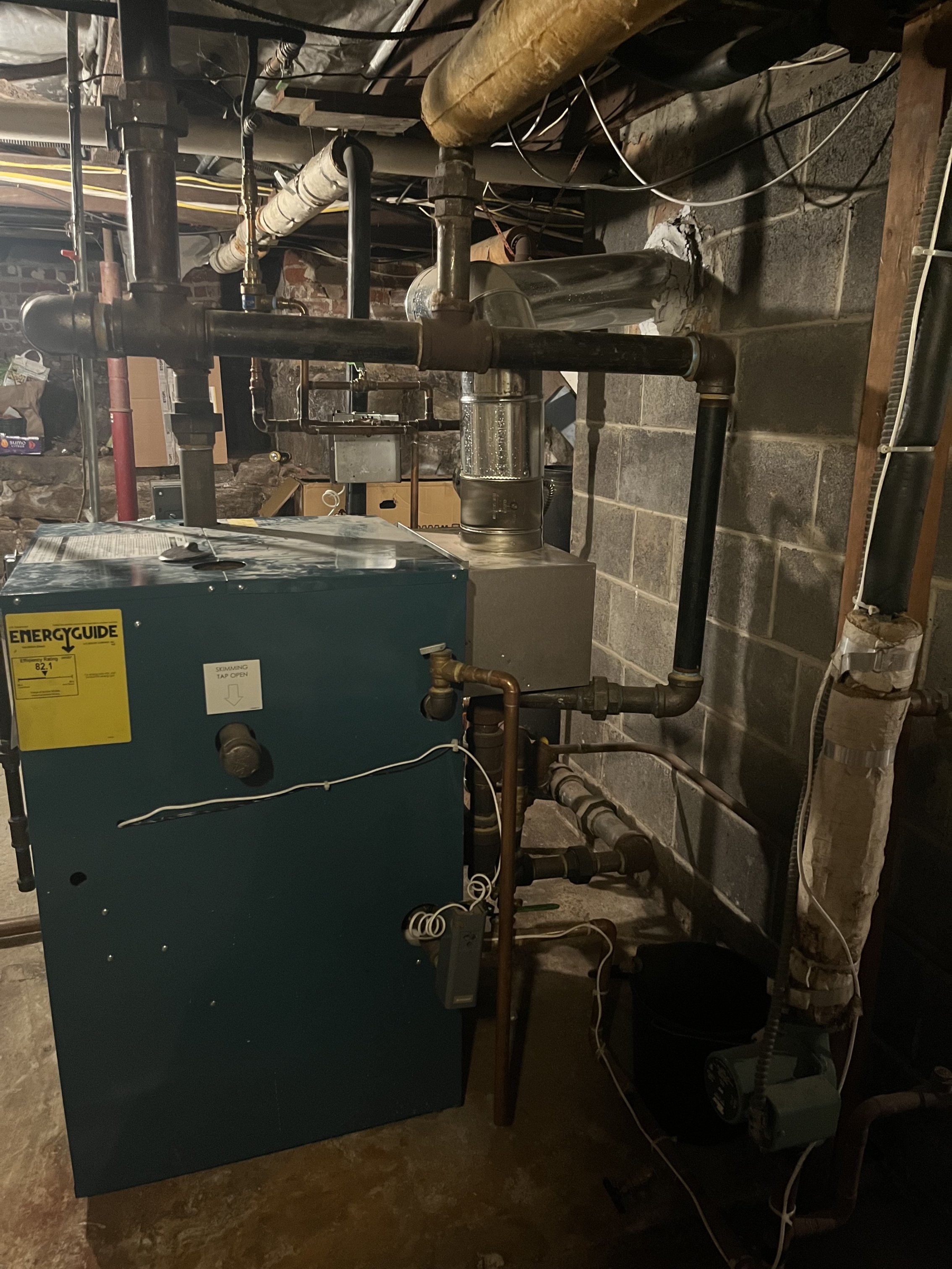

    Maybe a few more pictures of the piping above and around the boiler? The Steam Max is a whole different design which is supposed to have "solved" Burnhams problems. They blamed the issues on chlorides in the water and flue gas on one sided of the HX and steam on the other side instead of water. But who knows.

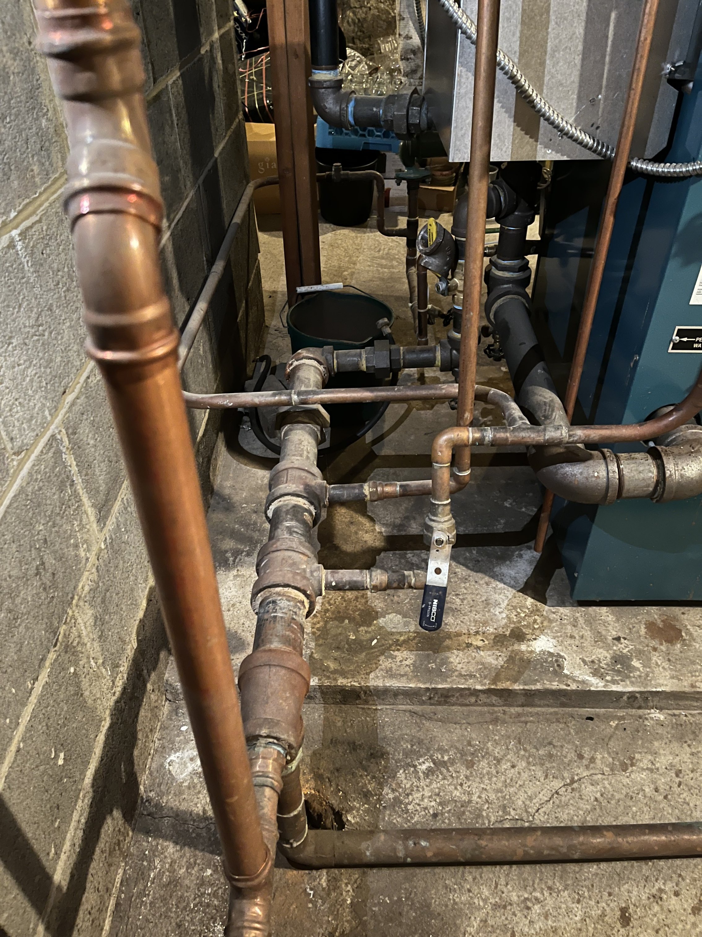

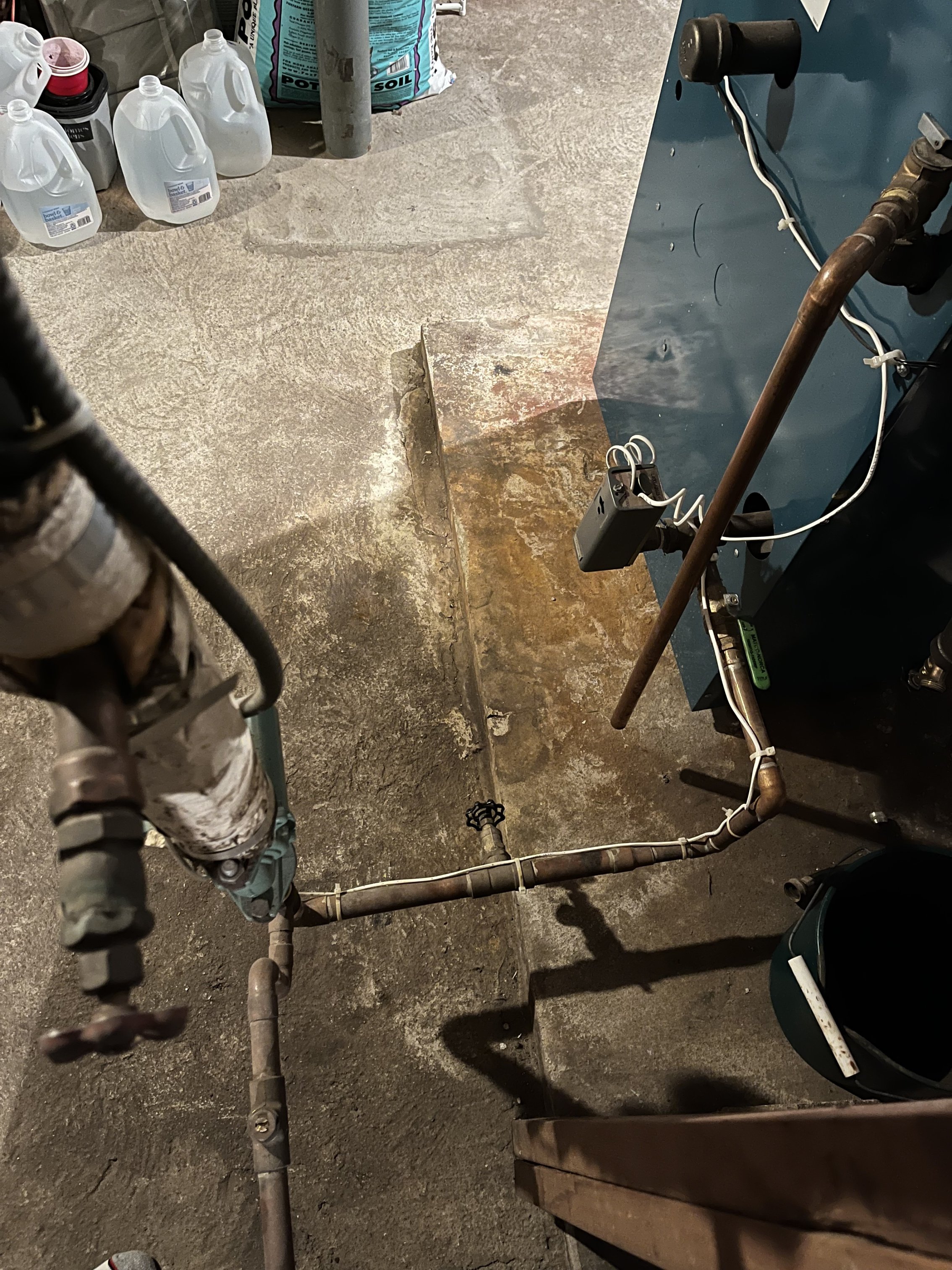

    Here are some additional images:

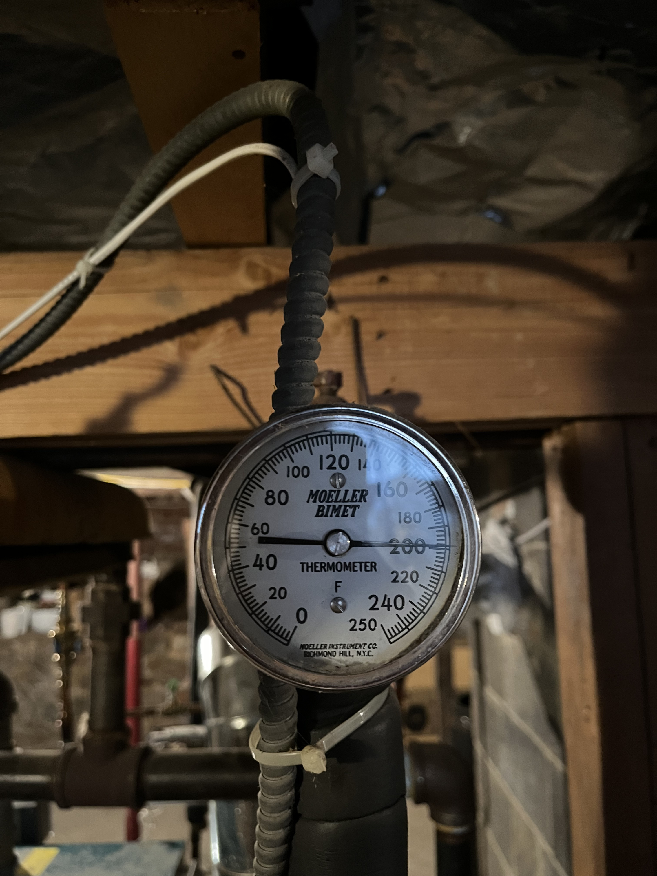

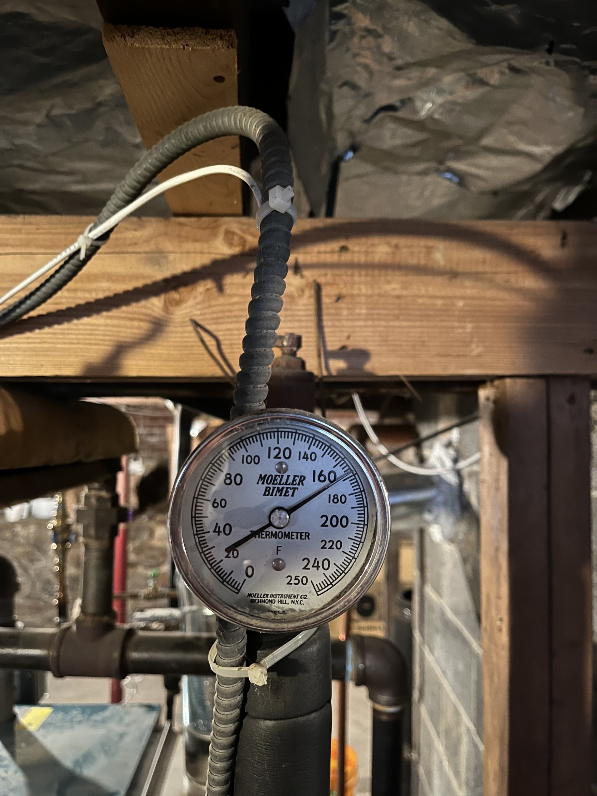

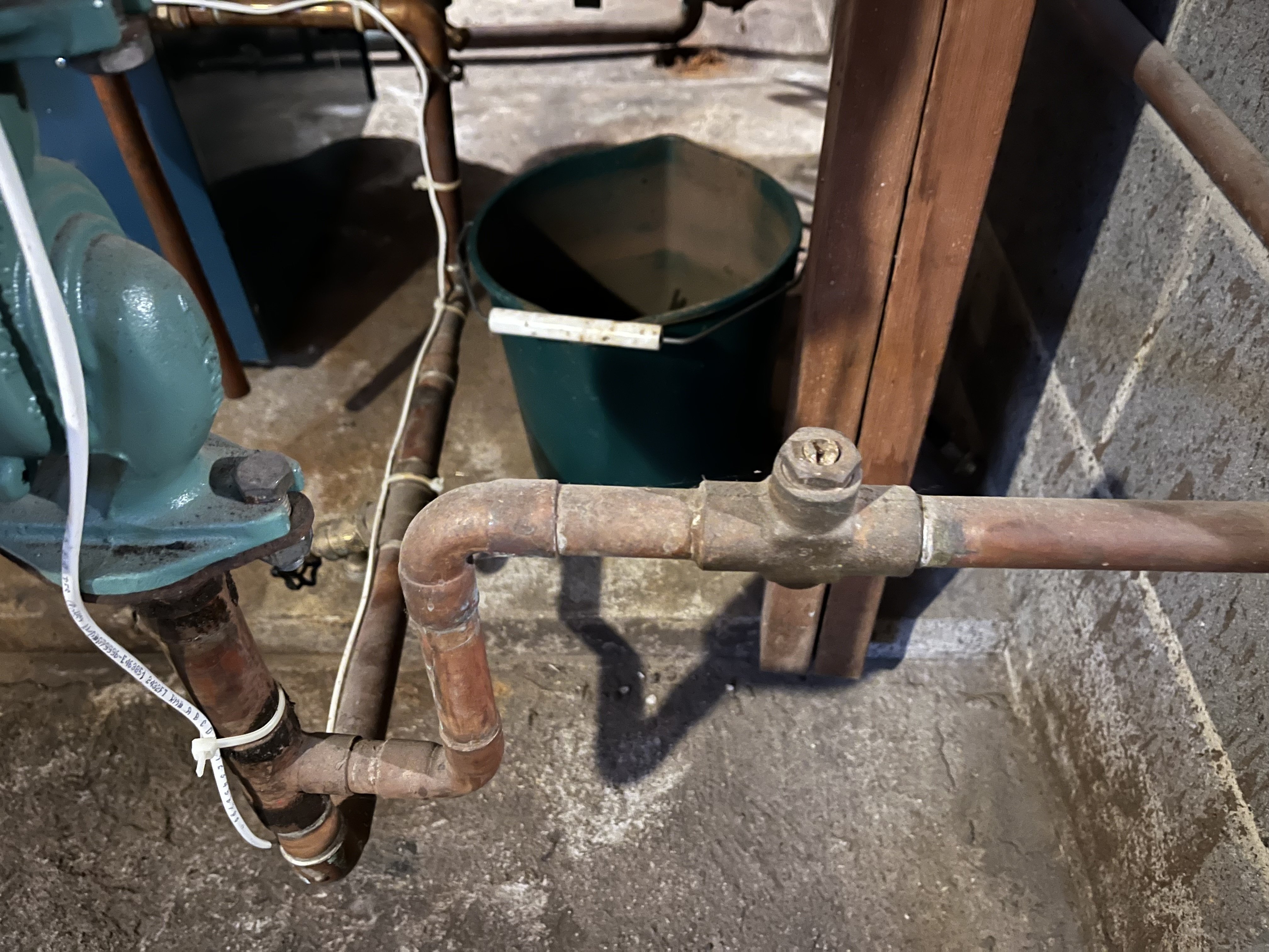

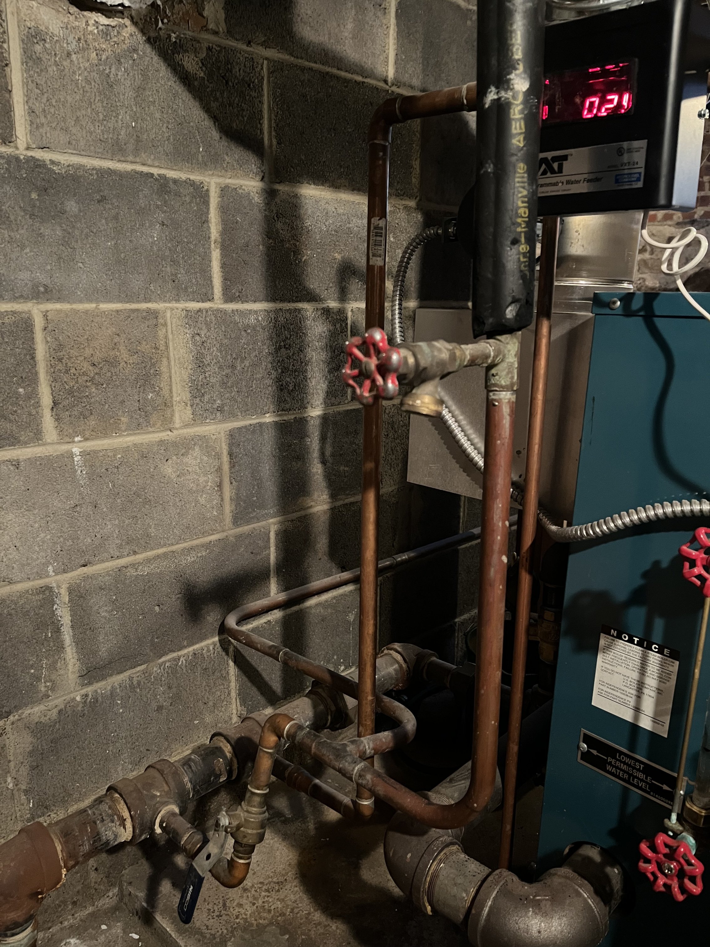

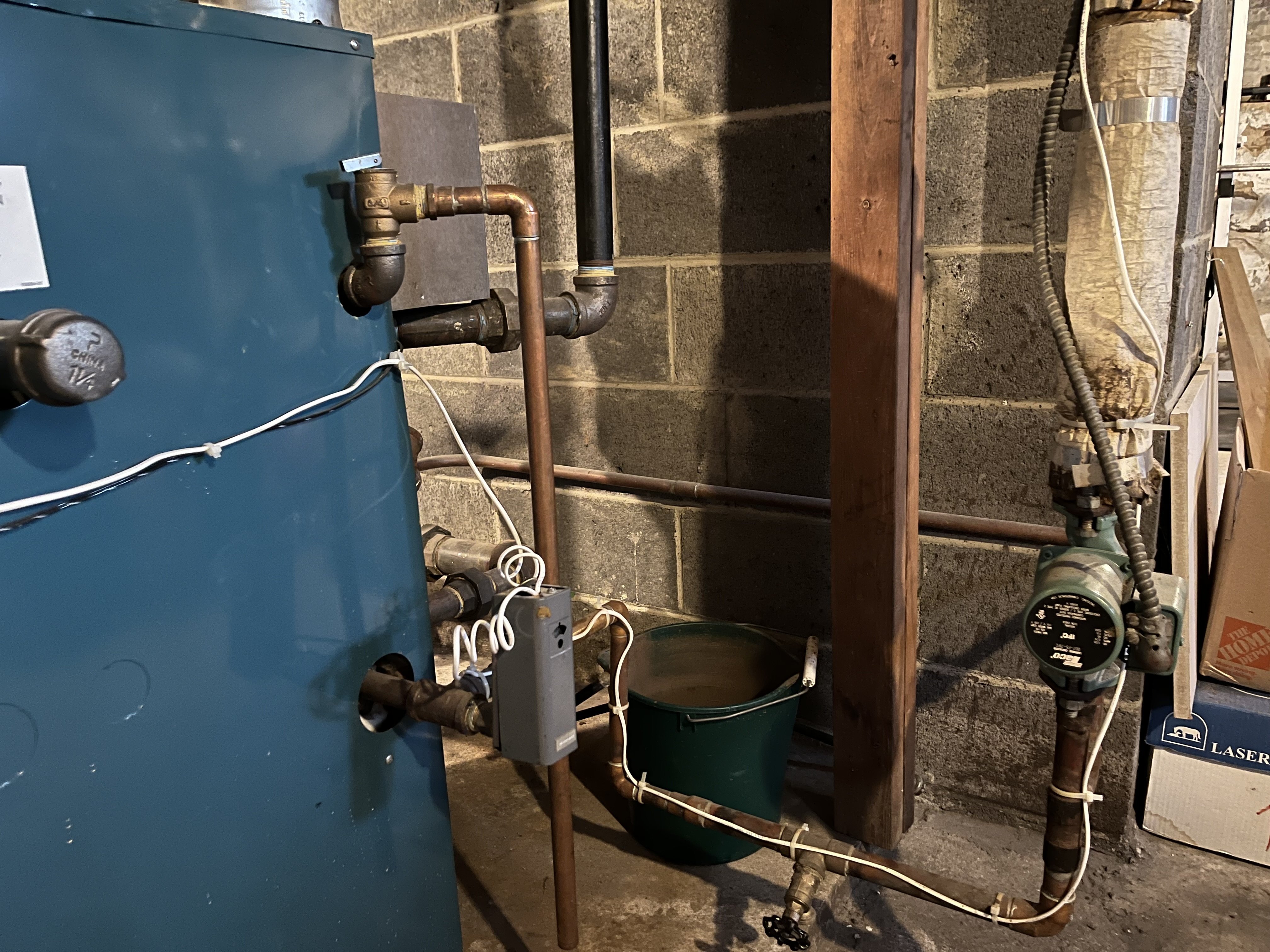

    I’m not sure why the valve was closed on the bypass loop (see pic). The bypass loop connects just below the circulator pump.

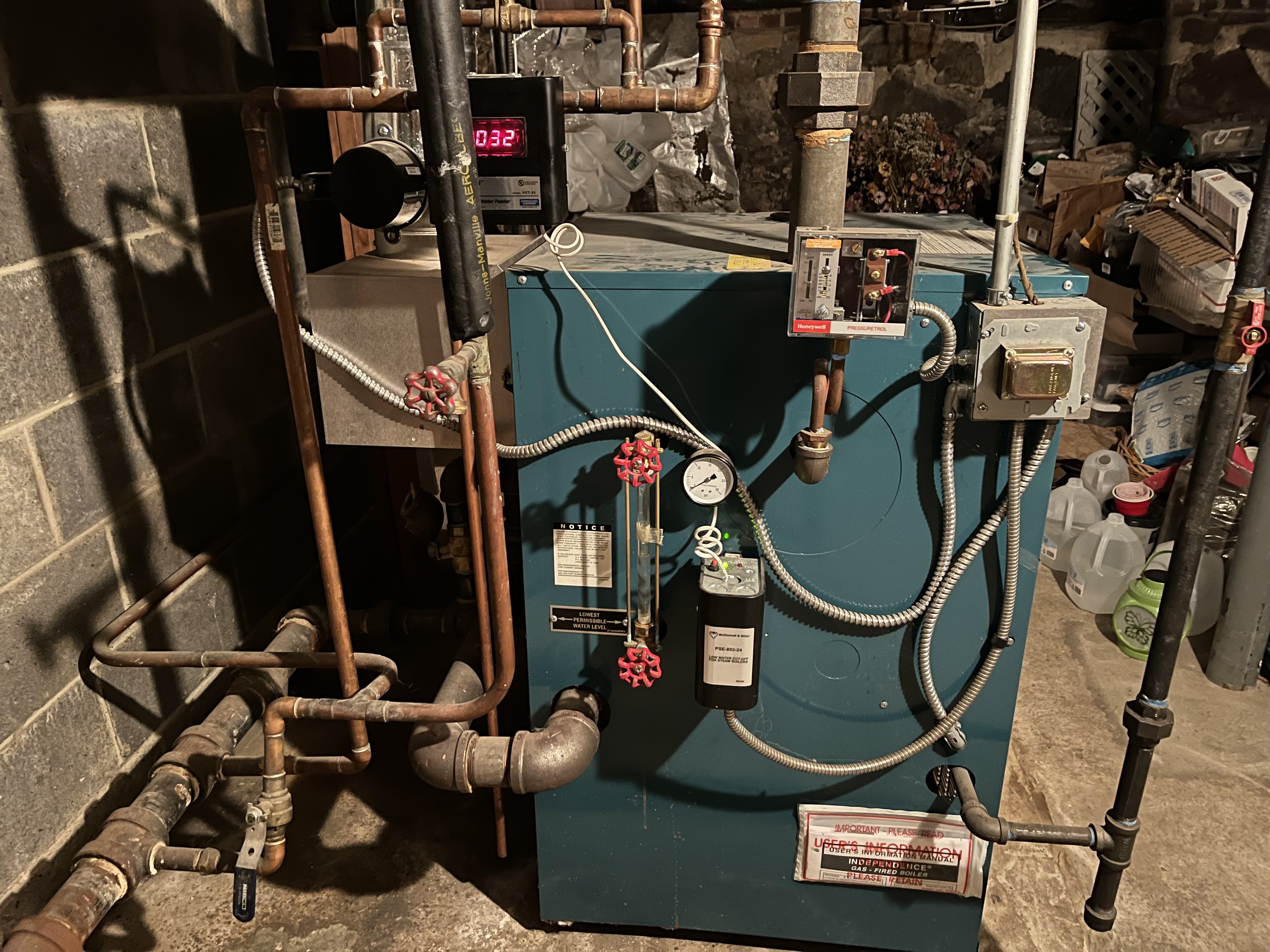

    The boiler does seem to cycle a lot when the hydronic section of the home is calling for heat. The boiler will come on for a minute, and I can see the thermometer that is attached to the loop after the circulator go from 162 degrees to 200 degrees, then the boiler shuts off. About 4-5 minutes later when the thermometer falls back to 162, the boiler kicks in again. The aquastat is set to 180 degrees. The return water from the hydronic loop goes in to the boiler wet return, and the hydronic loop is being pulled off the bottom of the boiler.
    IMG_0495.jpeg IMG_0488.jpeg IMG_0492.jpeg IMG_0490.jpeg IMG_0484.jpeg IMG_0485.jpeg
    is the bypass that pipe along the back wall? i don't even se a valve on it. if the load on the hydronic loop is small compared to the output of the boiler then it will short cycle
    Isn't the bypass in the first pic? looks like a balancing valve maybe, like a tee with a screwdriver slot?

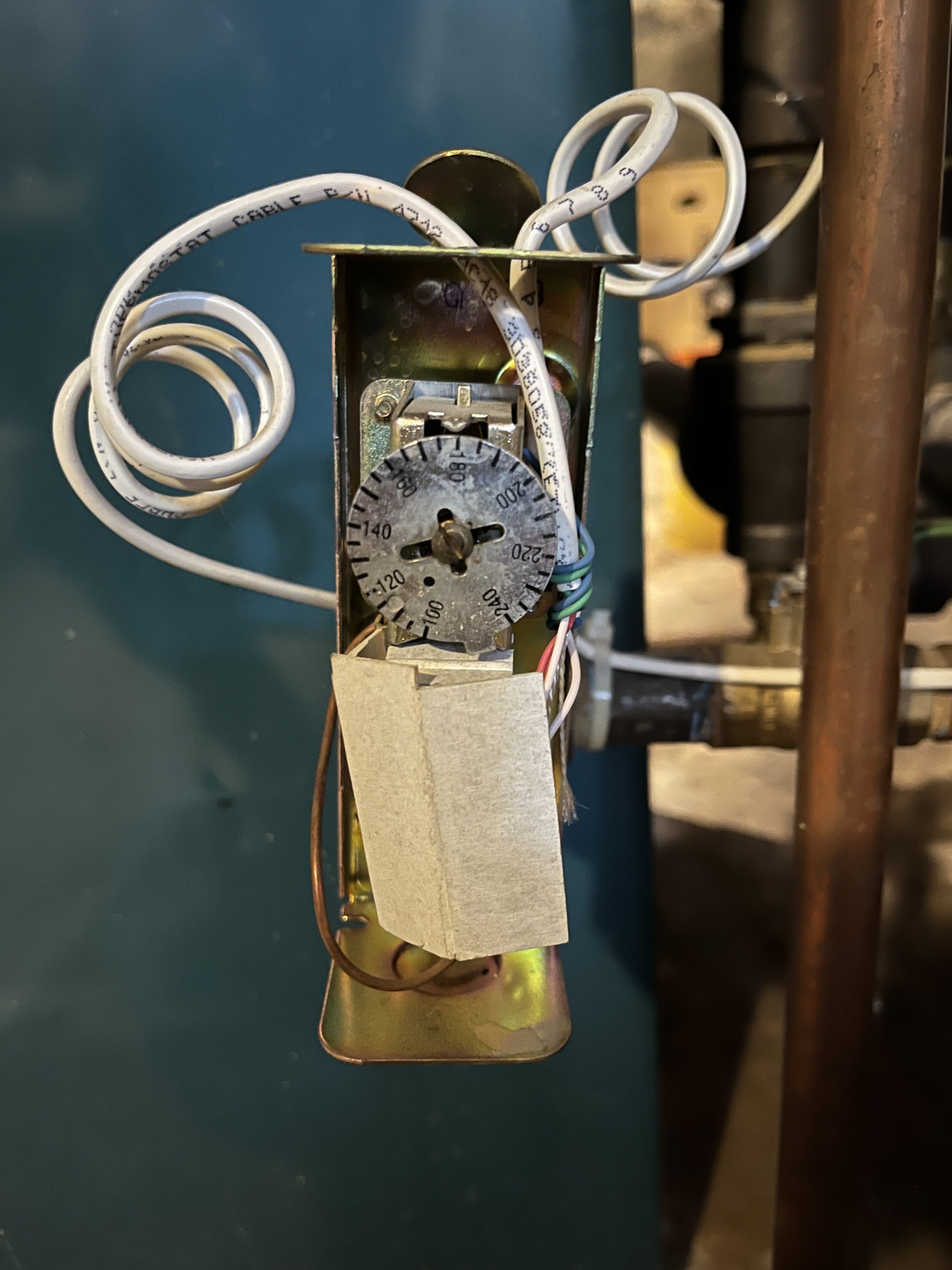

    Yes. That is the bypass that runs along the wall. Maybe I’m mistaken regarding a mixing valve. If you look at the first of the six images, there is a valve(?) with what looks to be a flathead screwdriver slot, that is perpendicular to the water flow. I believe if that slot was parallel to the piping, it would allow (at least some) of the hydronic loop return water from the bypass to mix with the (supply) water exiting the boiler before heading into the circulator pump and on its way to the first baseboard unit and so on until it returns into the bypass and or steam wet return. I’m not certain how much would return into bypass vs the steam wet return (visible in the fifth image).
    If all of the hydronic loop’s return water is now going into the steam wet return and then into the boiler, I’m guessing that (when the steam zone’s thermostat is not calling for steam), the boiler water is constantly being cooled by hydronic return volume of water. If the bypass was open and (some) of the hydronic loop’s return water was allowed to mix, maybe this would help to lessen boiler cycling w/o changing the aquastat’s setting?
    i see it now. that should be partially open. i didn't piece the multiple pictures together right and i thought that was a check valve until i looked closely.
    the purpose of the bypass is to reduce the temp of the water coming out of the boiler which may be at or near boiling temps so it doesn't flash boil with the reduced pressure from the suction of the circulator or the lower pressure at the top of the loop. if there is a steam call or just was a steam call the boiler will be at steam temps.
    the aquastat for the hot water loop should be somewhere in the boiler away from the loop flow. i can't tell from your pictures if that is the case or not. it should be holding the water in the boiler at 160-180 or so

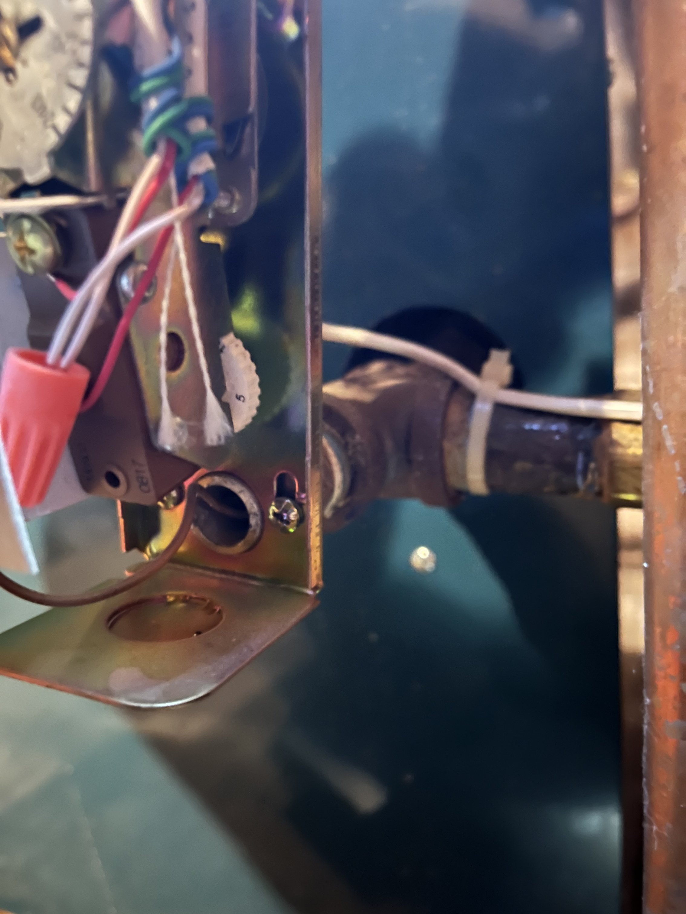

    These might be a better angle to see the how the aquastat is placed .
    the aquastat might do better in a different tapping up higher or with a longer well. also what is the differential, it could probably be 30 or 40 degrees.
  • 1865
    1865 Posts: 18
    The aquastat (Honeywell L4006A) differential is currently set at 5 degrees.
    The mixing valve flathead slot is a bit too mangled for me to rotate it. I suppose best to replace when they come up to install the warranty heat exchanger. Is there brand/type of valve I should be looking for or similar that could be adjusted with a flathead screwdriver?
    i'd just use a ball valve or a globe valve
