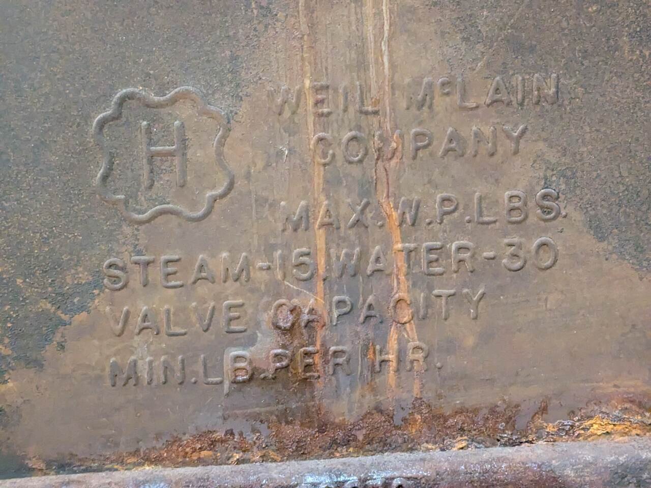

We have this leaky 6000 square foot brick building (former convent) and the biggest oldest basement rads always run way too hot for their space, but the little baseboards in kitchen, bath, and rectory aren't warming their spaces much. Boiler is in the basement, 1st and second floor room rads are basically 'fine' but the third floor rads are cold. Input pipes to the 3rd flor rads feel warm.

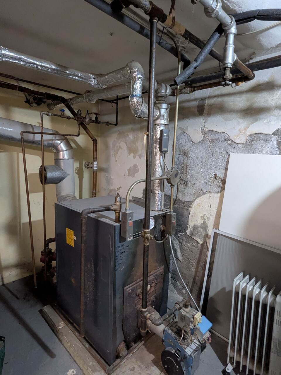

The boiler room:

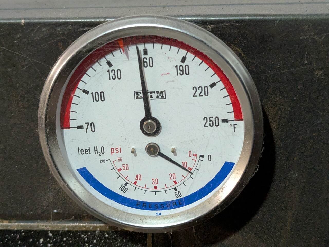

Weil-McLain 62 gauges say we are running 155-ish and ~12 psi

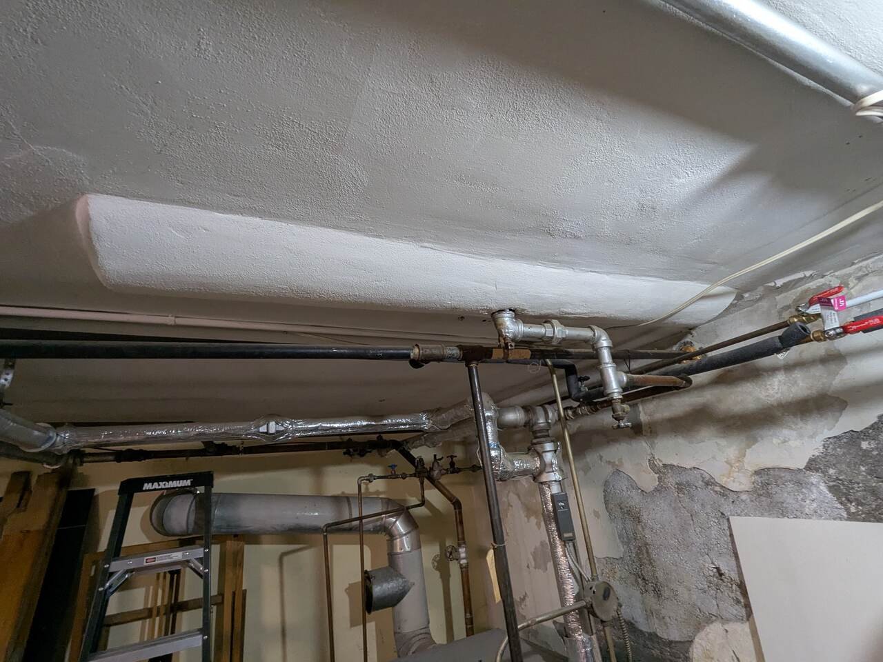

That's just the outline, there was a whole lot of detail I won't bore you with. My concern is if the tank is WATERLOGGED, I'm not going to get the pressure up. (AI suggested the boiler drain valve can be used to relieve the pressure in an emergency - I'm planning to hook up a hose). I'm wondering if the reason the system has been set to 12 psi in the first place is that the previous owners knew the tank was waterlogged and didnt want to deal with it. (It's lathe&plastered into the ceiling of the utility room - see pics)

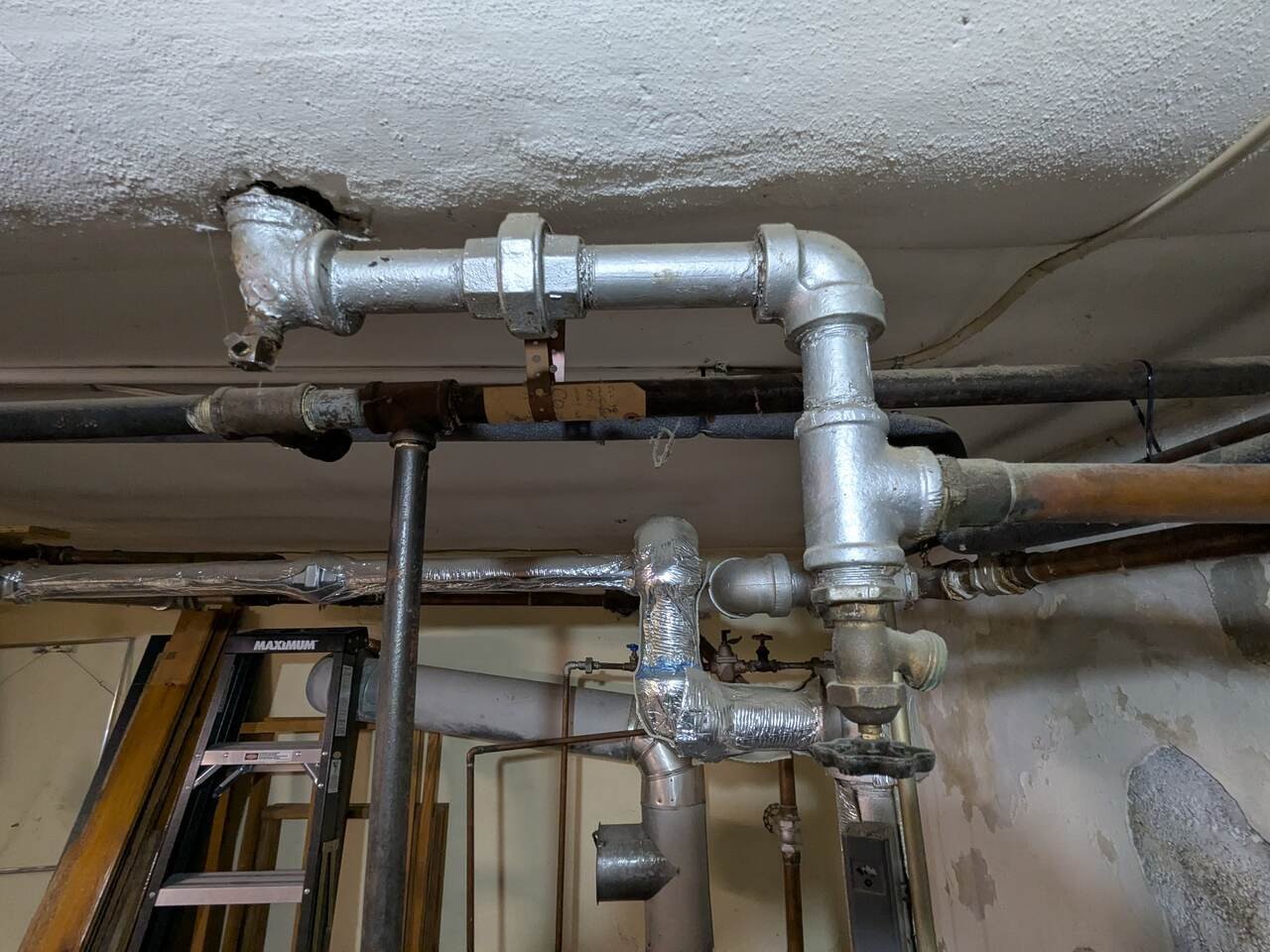

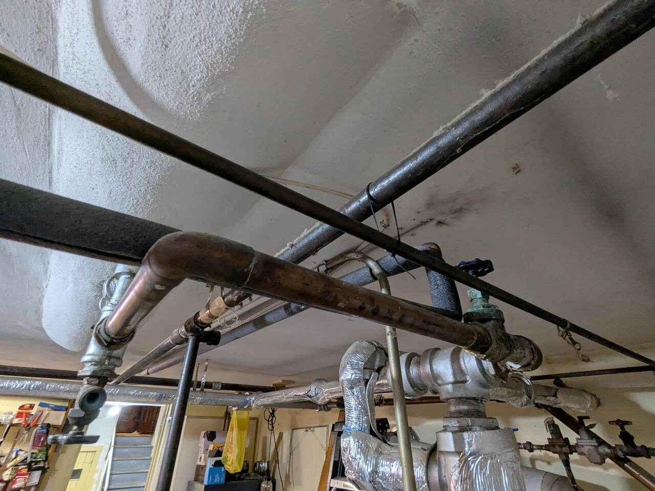

If indeed it's waterlogged I was thinking maybe I could drain it by shutting off the blue valve to the right (by boiler) and then opening up the blue valve feeding tank to the left :
Am I correct in guessing if I drain water out that way, air is going to come up the same tube to replace it?? I dont see any sort of "bleeder valve" lt air back in (maybe been plastered over??).
Maybe that square thing in the corner of where pipe enters tank??
And then there is the question: if the tank is really water-logged, how much to let out? Should it be half-full of air to start? No idea how big that tank is…

    The 'square thing in the corner" might be a way to let air in- let's have a close-up. Also, where are you located?

    I would pump the pressure up slightly by adding water to the boiler. You are about 12psi now. Get that to 15 psi. If you get some pressure out of the third-floor vent you have enough water pressure. If no pressure try 18psi. This dependent on building height and only building height. Check this with boiler and pump s are off.
    Don't mess with the expansion tank yet. If the boiler relief valve is not dumping water the ex tank is ok most likely.
    Bleed the 3rd floor and report back.

    They even gave you a handy drain valve. Which, once you have opened it, will leak when you try to close it, so get a cap for it and use that (should be the same as the cap for a garden hose bibb).
    Then it's easy. Close the valve from the system to the big tank. Open the drain valve. It will glug and gurgle and release a pretty fair amount of water, at a guess. Be patient. You want ALL thew water out of it, and since that drain is all you have it's going to take patience.
    Once you are reasonably sure it's really truly empty, close the drain and open the valve to the rest of the system. Then go and bring the pressure up to where you want it — around 18 psig cold should work.
    You may have to repeat the bleed process on the radiators… sorry about that.
