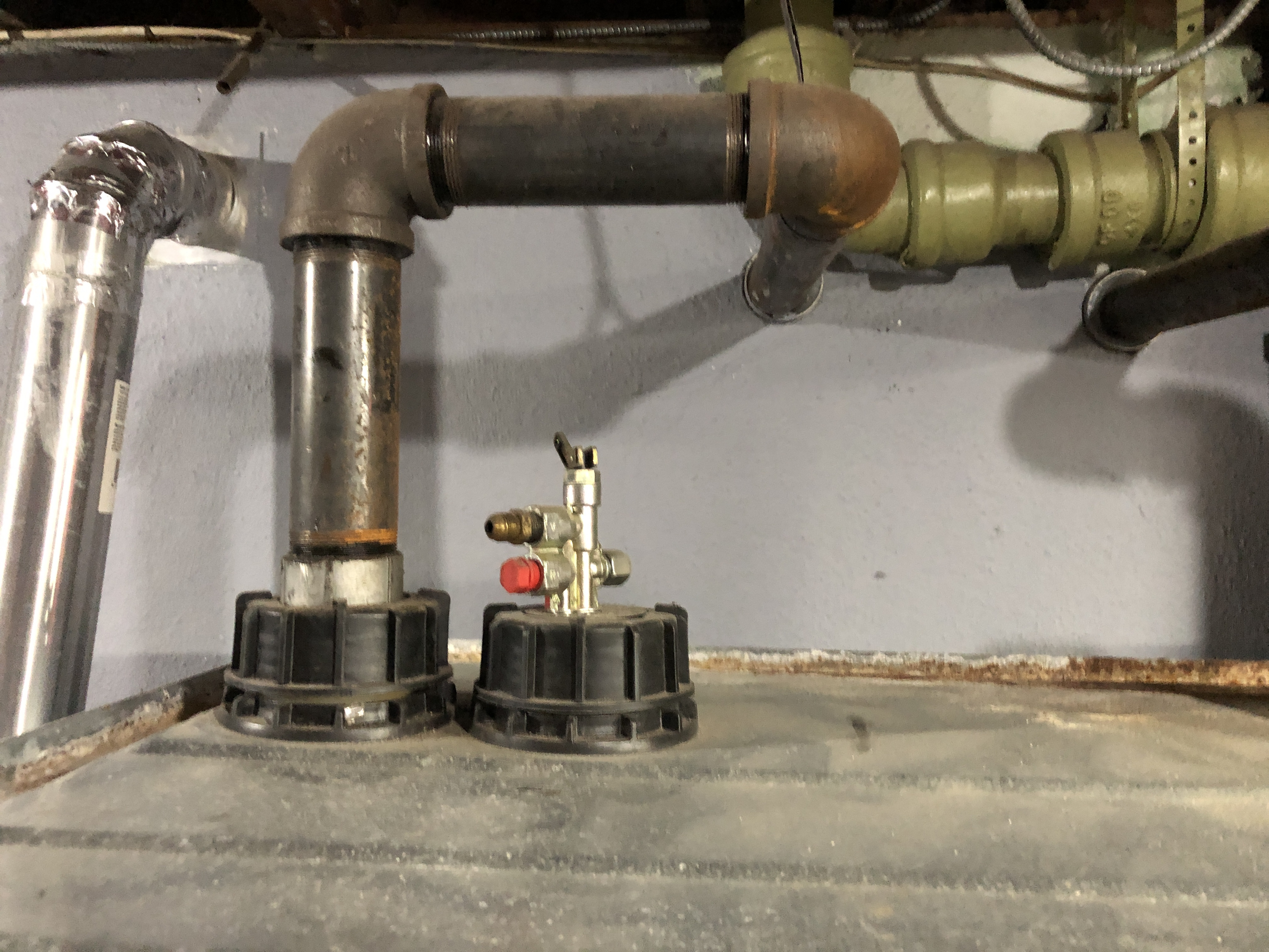

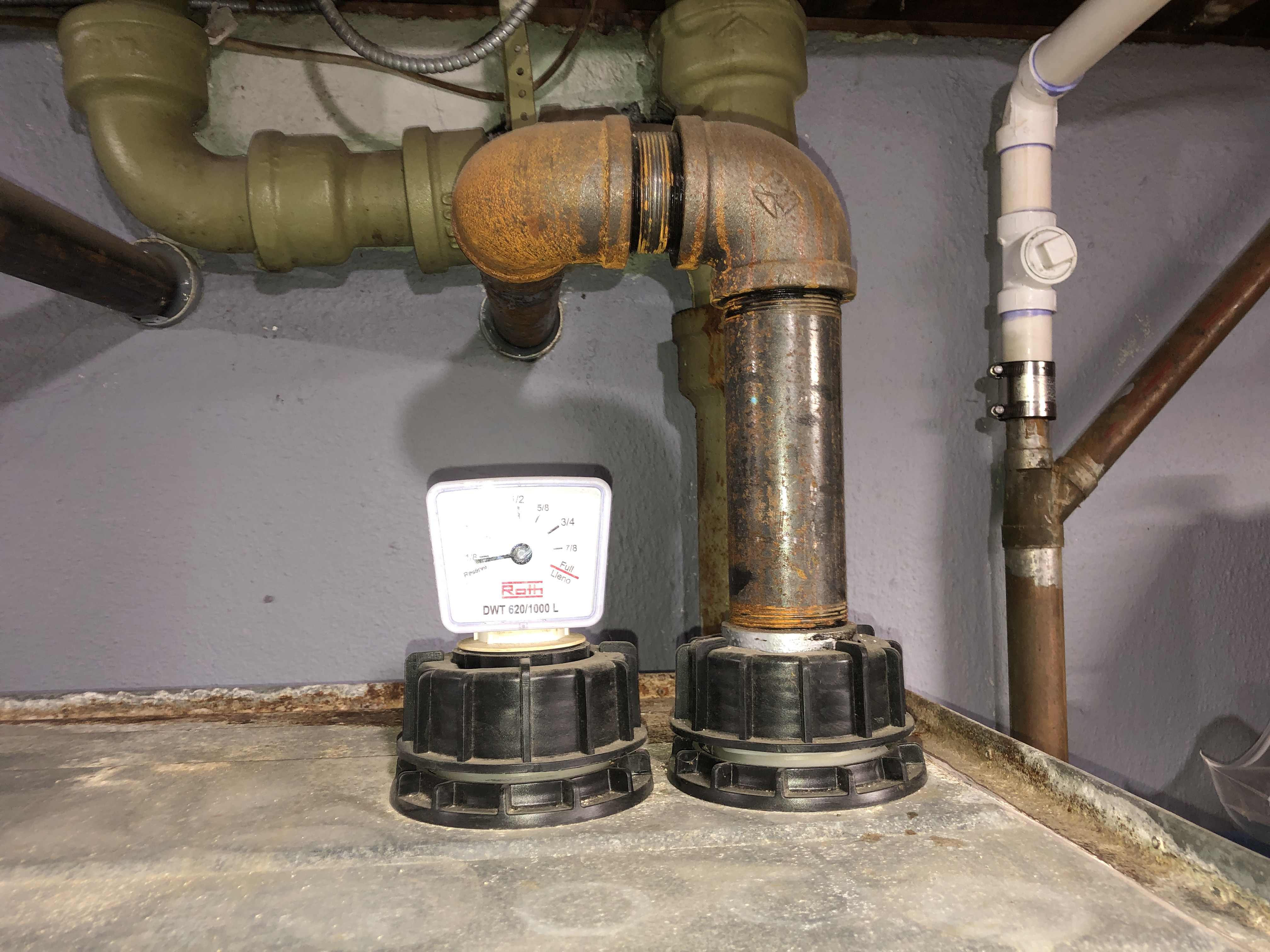

    I was finally able to post a picture of the used Roth Oil Tank.

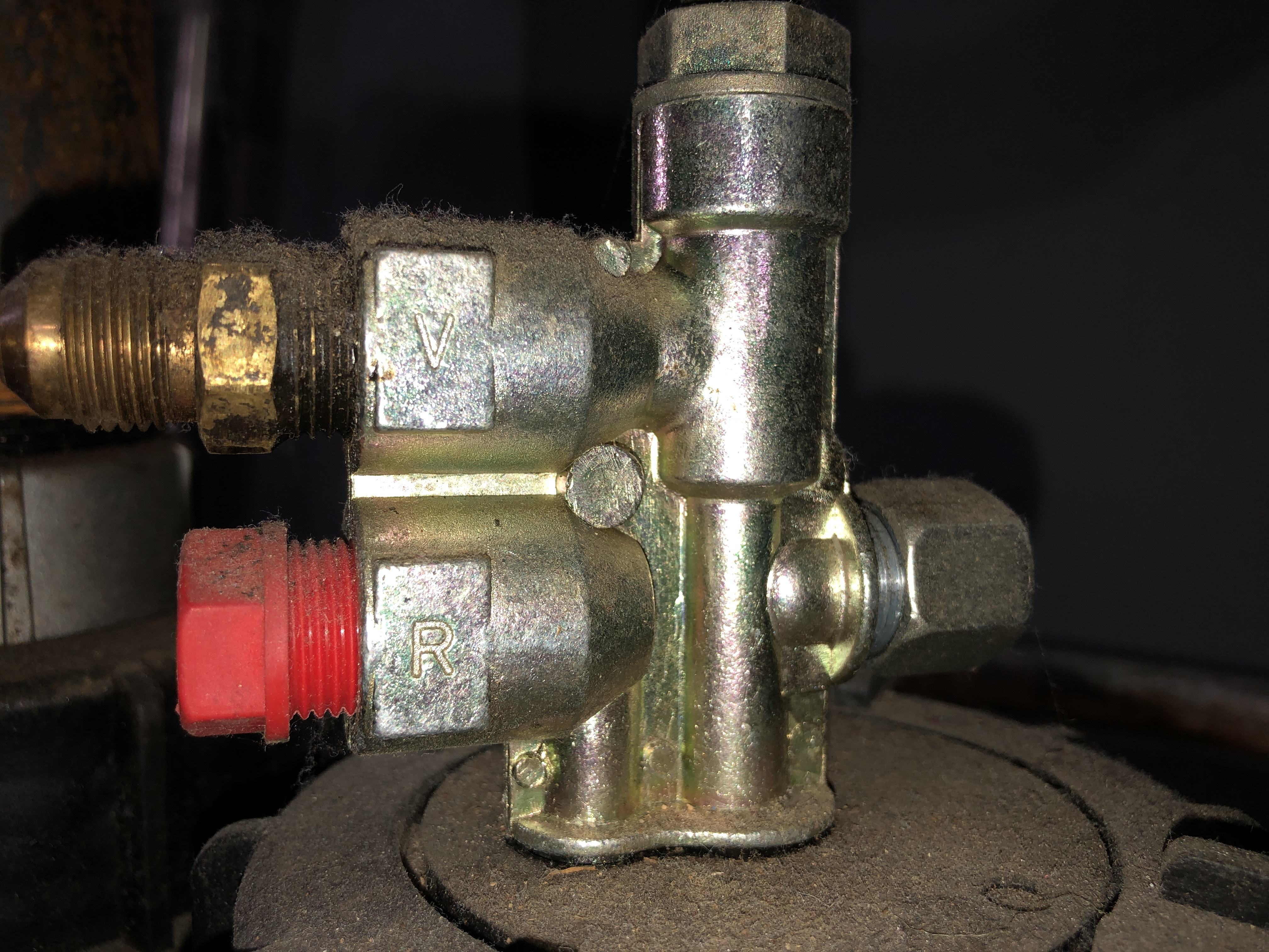

    How would I adjust the height of the fuel line that goes to the fuel filter at my Oil Burner ? I do not want to suck up sludge. I could guess. But I would prefer help from the Professionals. Thank you !
  • LDR
    LDR Member Posts: 21
    Gauge difficult to read. Approximately 1/8 of a tank. Could be Sludge or a mix of sludge and oil.

    The gauge isn’t that accurate. You can empty the tank, remove the plastic front and move the dial to 'E' or full and move the dial to 'F'.
    For your pickup I’d get rid of that fitting and get a simple 2” duplex fitting, a plug for one of the holes and a 1/2” male X (whatever size your copper fill line is) compression fitting. Pick your depth and tighten the compression fitting to hold into place.
    HVACNUT Member Posts: 7,613
    That's the old Roth floating pickup tube. You're asking for trouble with that. If you've got 2 pipe, then Roth offers a double tap bushing for your application. Its not DIY, though.
    With the setup that's there, your 2 pipe setup will not work. Its a lot of work to make it work.

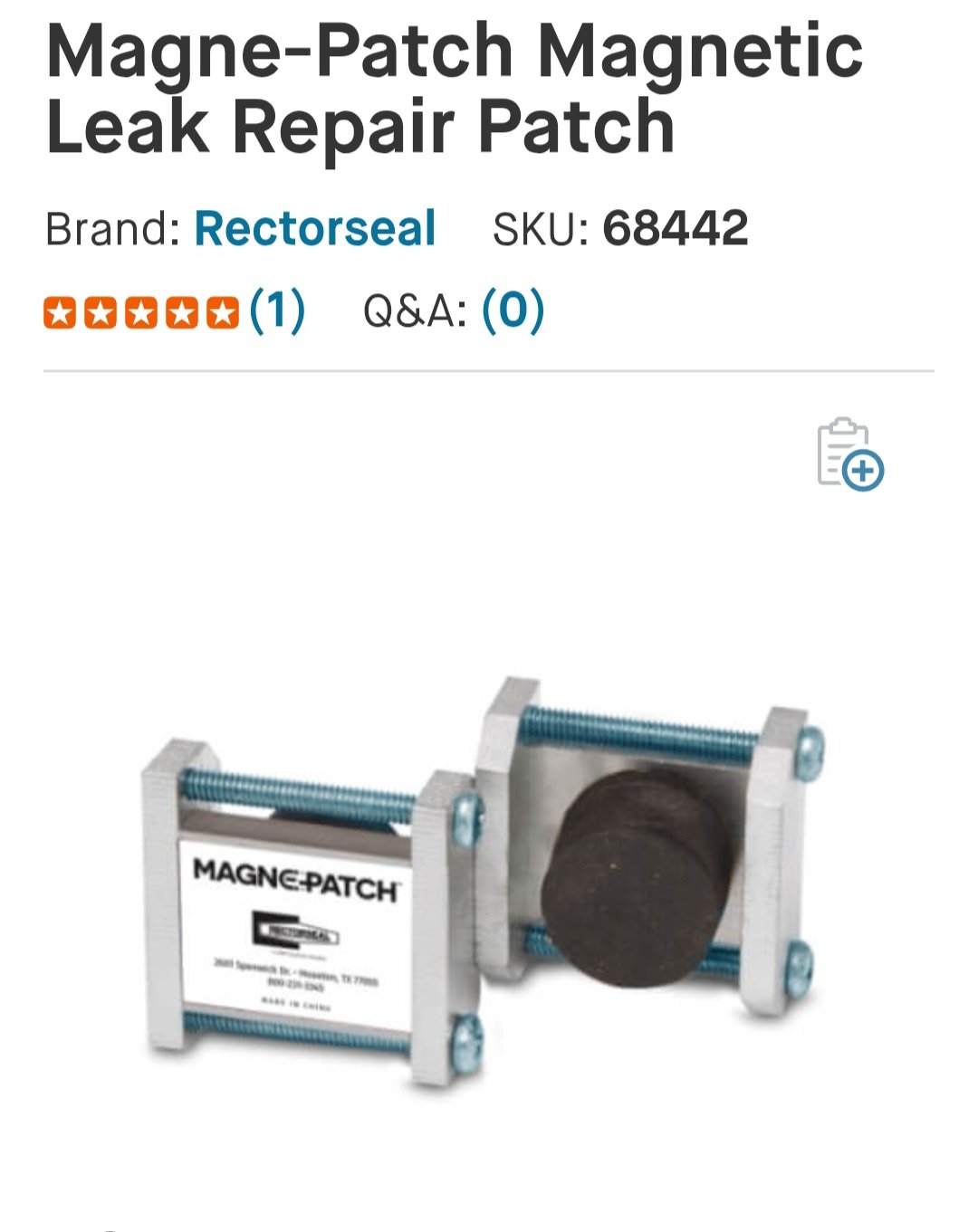

    If your tank has a pin hole put a magnet with some gasket material over it.
    And if the tank is temp. why do you want to fool with a Roth?
    RTWLDR
    pecmsg Member Posts: 7,441
    Why not a New 275 Gal steel tank?
    Its just temporary. You absolutely cannot get fuel delivered with the patch.
