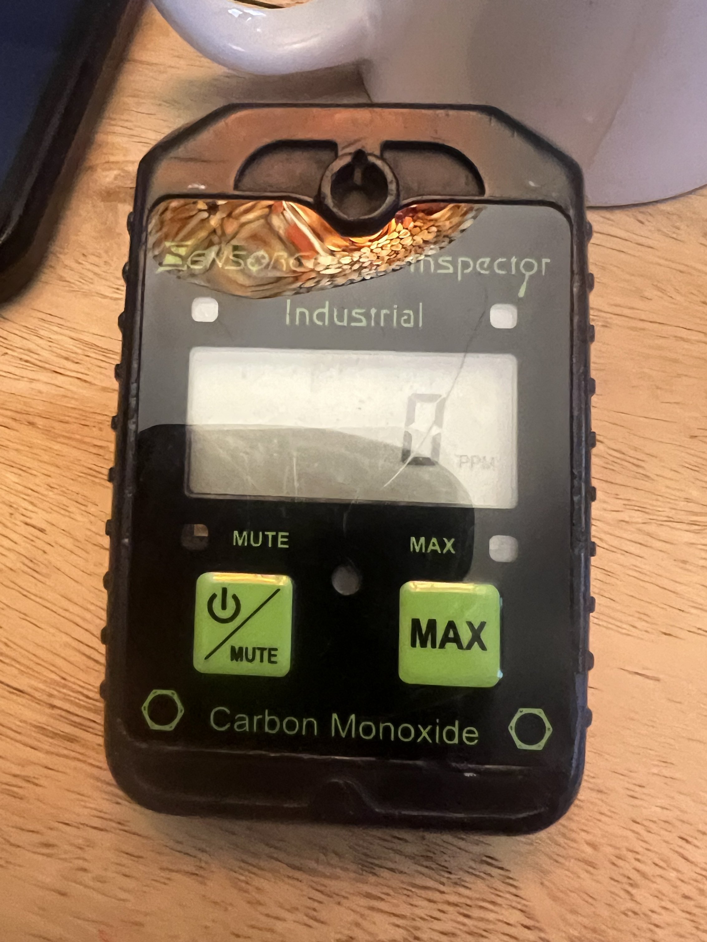

that’s what I have too thanks
I never thought of it , good idea ..

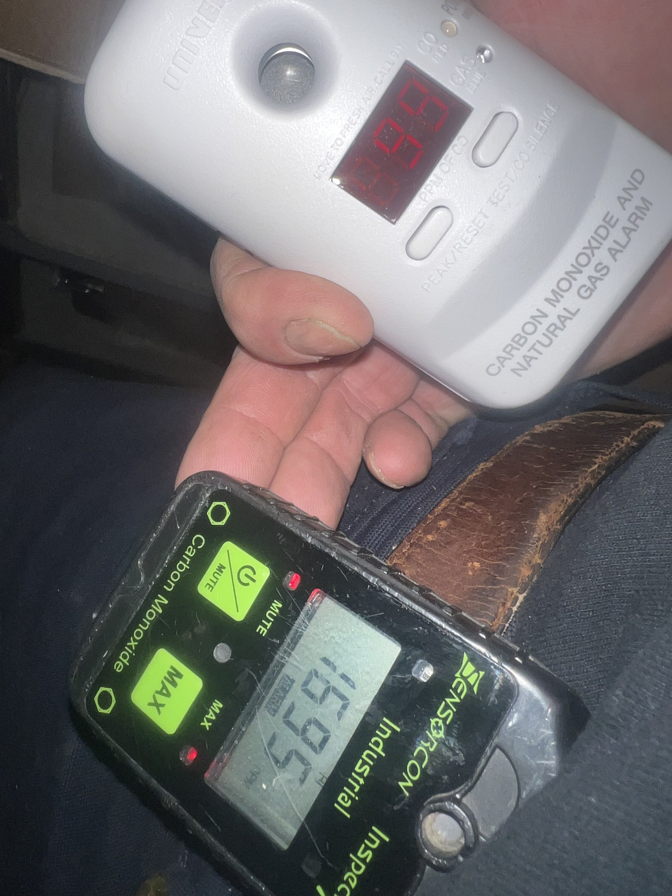

are those max readings or current readings in that picture?
those were current readings. Obviously, I did not stay in there long. chimney company took over. Hugh difference in the 2 readings.

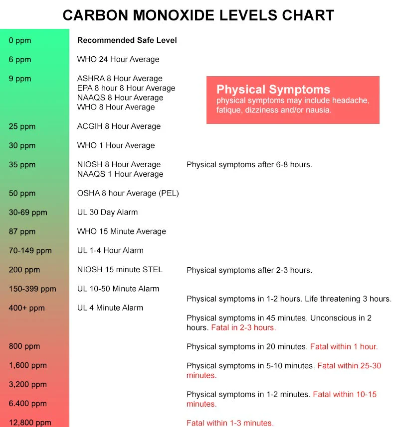

that’s why I wear a on my belt all the time
