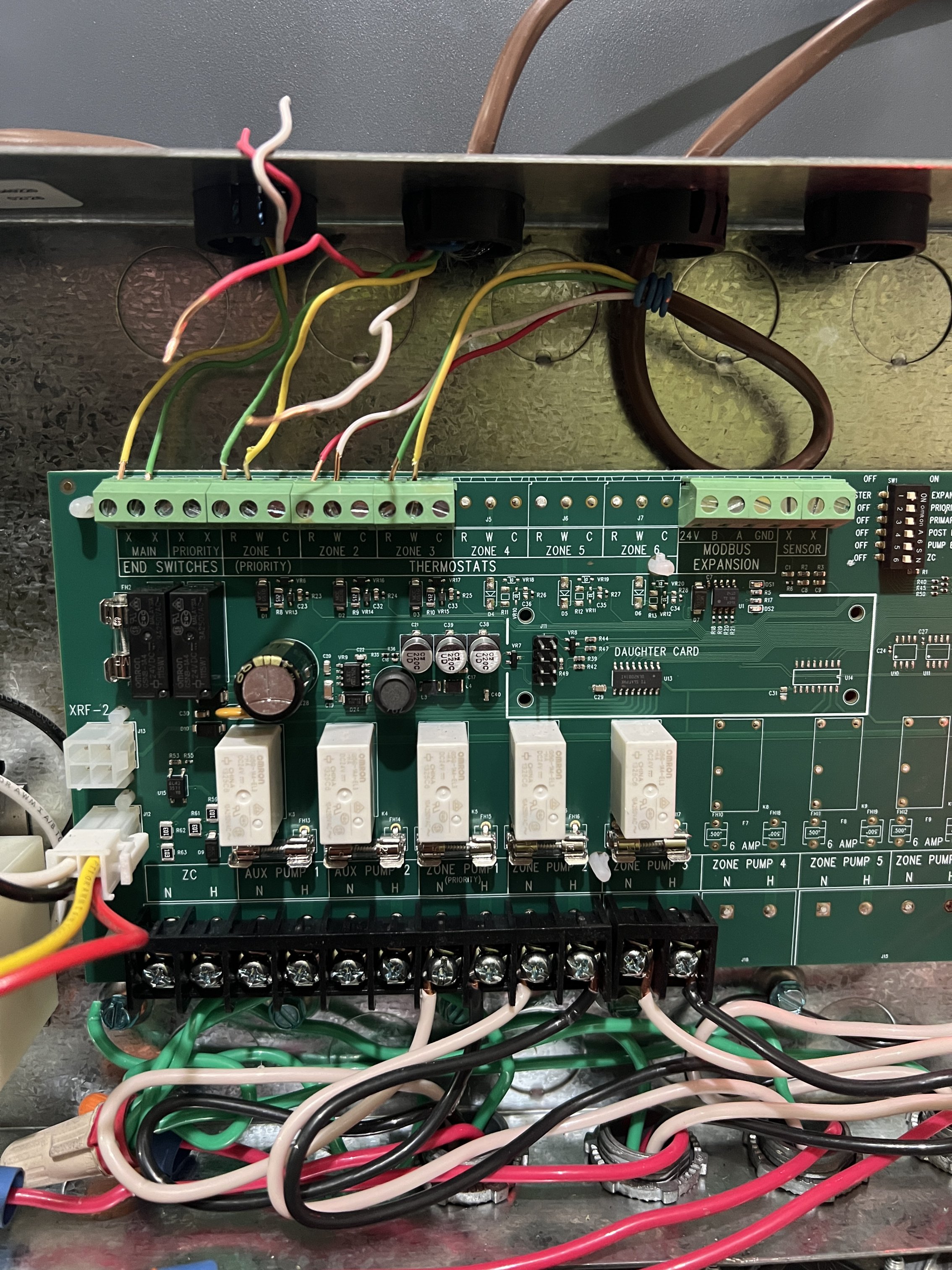

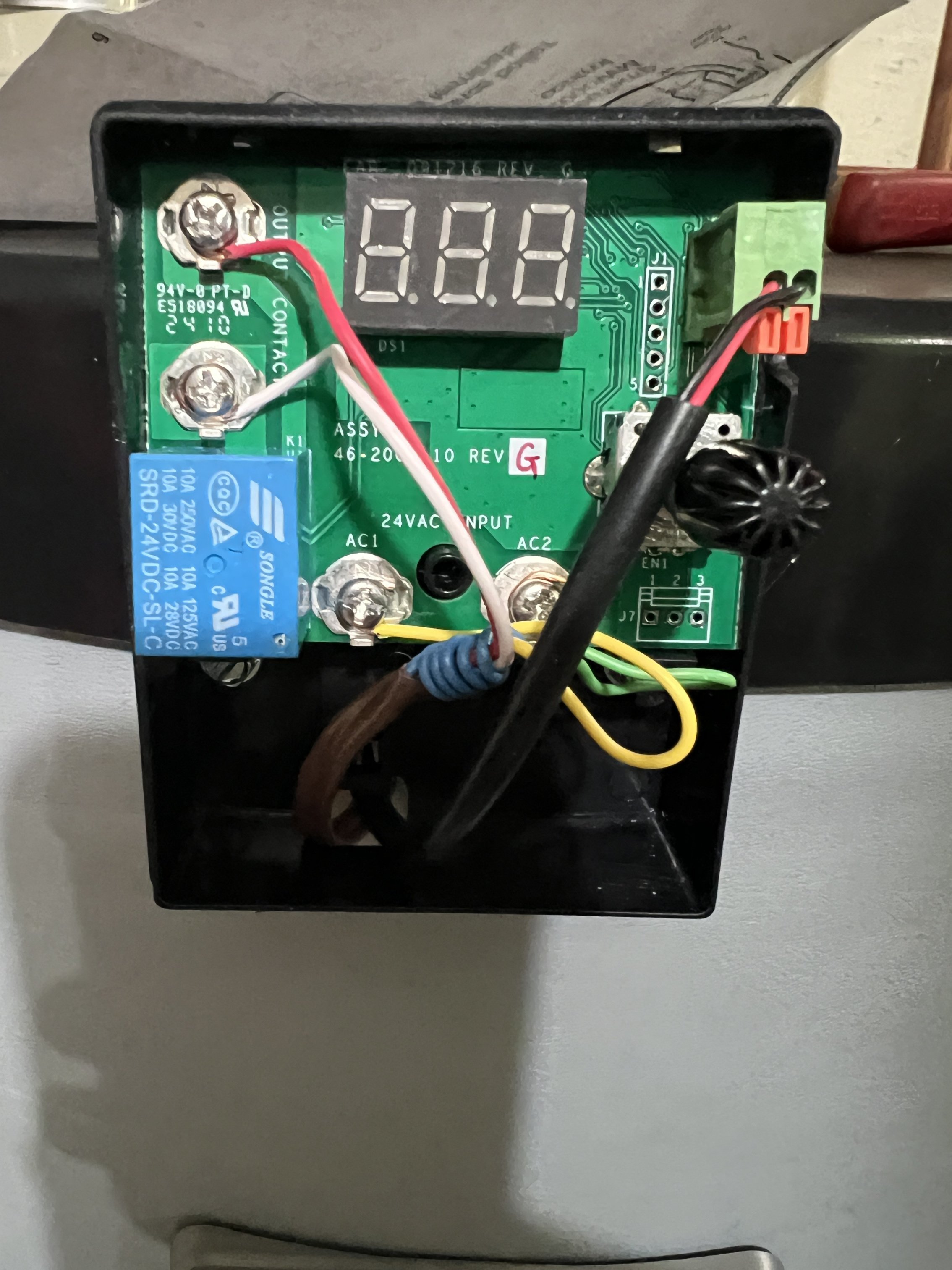

I am trying to wire the Indirect’s aquastat to the Taco SR. I have both of the inputs on the aquastat getting 24V from the R and W terminals in the Taco SR. (There is no display on the aquastat).

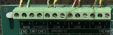

Where would I wire the OUTPUT of the aquastat to on the Taco SR? I am thinking the X X Priority End Switches, but I do not want to destroy either of these controls obviously.

    No, the end switch is what brings the boiler on.

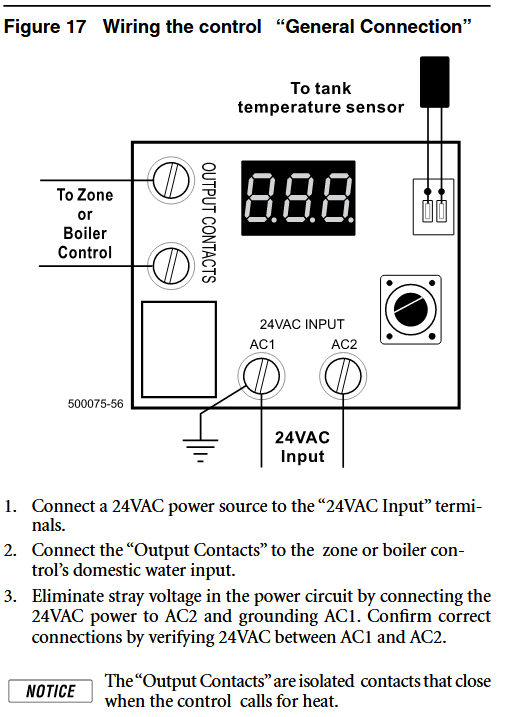

    You wire the aquastat to the priority zone terminals “R & W”.
    “AC1 & AC2” go to the “24V” terminals.
    Bob Boan
    HydronicMike
    109A_5 Posts: 4,761
    edited December 2025
    For DHW priority.
    Red on the aquastat to R Zone 1 (priority) on the zone panel.
    White on the aquastat to W Zone 1 (priority) on the zone panel.
    Yellow on the aquastat (AC1) to Zone 1 (priority) C on the zone panel. (AC1 shows it as the grounded side)
    Green on the aquastat (AC2) to R on the zone panel.
    Enable the priority, the switch array on the Right hand side.
    Connect the Main X-X and Priority X-X (DHW) End Switch terminals to the appropriate place on the boiler.
    Connect the heating zones to Zone 2 and Zone 3.
    Make sure the circulators are wired appropriately.
