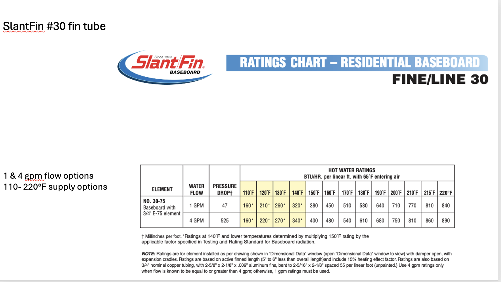

    180' of 3/4 fin tube total in the home? Is that the actual fin, or the enclosures lengths?
    180 X 500 btu/ ft output = 90,000 btu/hr. That is what the fin tube can deliver to the home. So really no need to size the boiler above that unless expansions are planned? Your current boiler may be spot on?

    Here is an example of a typical fin output.
    So if theses numbers are accurate you could heat the home with 140- 150 SWT= 320 btu/ft X 180'= 57,600 btu/hr!

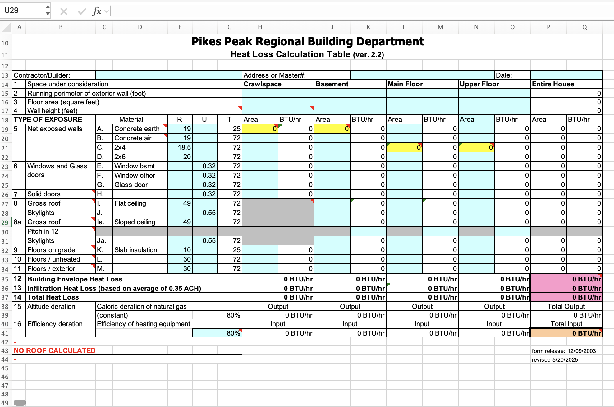

    So do the load calc, confirm the amount of finned tube, and see where you end up. If you want simple and accurate, are good with Excel, here is a calculator at the Pikes Peak building dept website.
