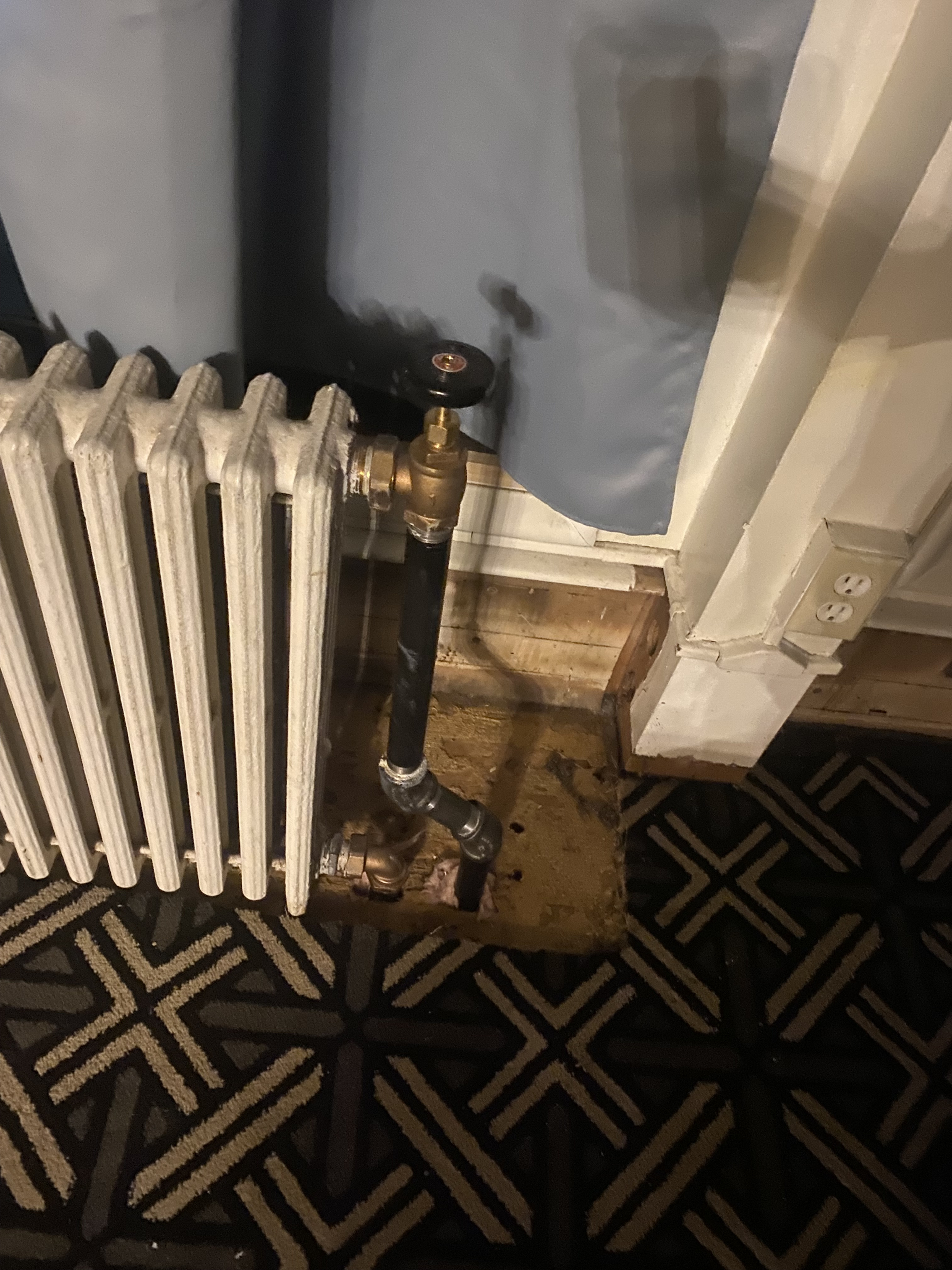

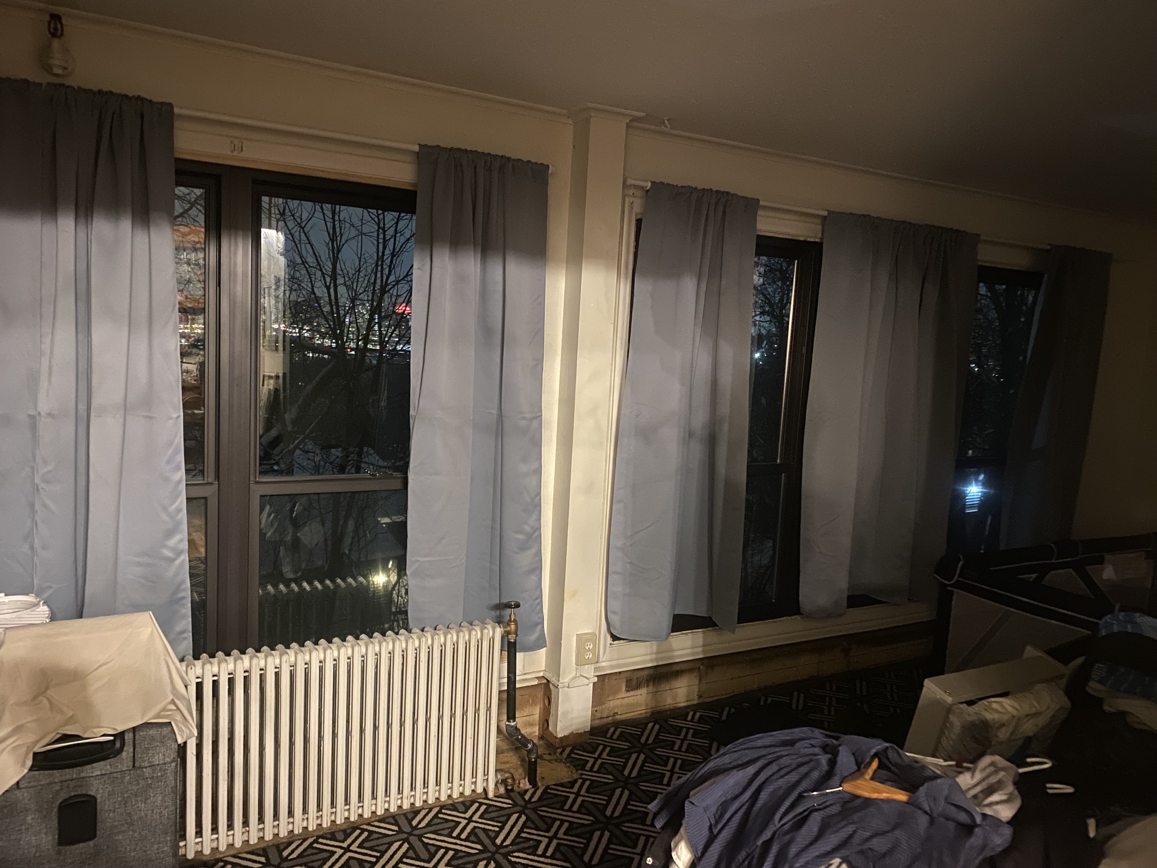

Hello all, I have these 2 banks of windows that span about 25’. I have this dinky radiator there at the moment. My question is, would I still flow if I elbowed the supply and return on opposite ends of a 20’ cast iron baseboard radiator? Or should I just find a larger radiator? I worry about it flowing efficiently with the baseboard. I don’t want to add another circulator on the return.. ideal would be the baseboard as it would be under the window. But I’m not going to spend the money if it won’t flow. There are 2 rads on this loop. The other is the same layout on the perpendicular wall.
When I renovate this area, I will add insulation where there isn’t, which will help a lot but still don’t want this radiator there. I would find one that’s 12-15” tall and longer. Thanks for any input

    wow thank you all for the quick responses. My current rad isn’t sufficient enough to heat that area. I want cast iron baseboard, not copper fin tube. Where the supply and return come up, is the only place for it to be. I cant move it in the basement. If I elbow the supply to the right 10’ and attatch to the end of the baseboard ci rad, and also elbow the return 10’ to the left, would that affect my Flow? Future renovations would just be to insulate best as possible. It’s an old gravity fed converted. I can’t zone separately. Just trying to get most heat in this area. Yes it is hot water radiant heat.

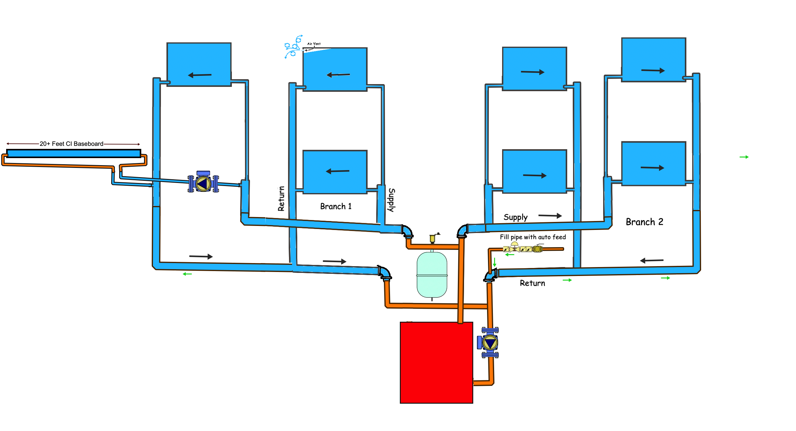

    Here is an illustration I used to explain why Baseboard and standing rads don play nice together. although CI baseboards play better
    Picture this old gravity system with a replacement boiler and the circulator on the return as we have all seen over the years. Works fine but one day someone wants to renovate the kitchen and remove the CI standing radiator.
    Imagine in your mind's eye all the CI standing rads are getting about 0.5 to 0.75 GPM flow each, in this old system (on a 12 radiator system that might be 70,000 to 80,000 BTU or 7 to 8 gallons per minute). Now take out one of the 0.5 GPM branch CI radiator and add 20 feet of 3/4" pipe and 20 feet of CI Radiator. In your mind's eye will that make the water flow easier or will that be more restriction? You don't really know until you try it and it does not work.
    I have had this happen several times and have fixed it a number of ways. This was the easiest one. I added the Taco 007 on the Baseboard loop with a valve to throttle the flow as needed. The add on Circ. operated when ever the system pump operated. Simple. The cold zone then over heated, so I was glad I had valves on that pump.

    A careful look at the OP's photos suggests that this area was previously heated by fin tube baseboard. Both the dust shadows at the baseboard level and the pipe holes drilled through the column indicate this.
    Judging by the look of the piping, the existing cast-iron radiator was installed after that baseboard was removed, probably because the fin tube did not adequately heat the room.
    To avoid compounding what appears to be a series of mistakes, the first step is a heat loss calculation of that room and a comparison of the load with other rooms and the sizing of their radiation, since if other rooms have oversized radiators this one will need one (or more) oversized to the same percentage to stay in balance on a single zone.

    bburd is correct. Old copper fin tube on an old seperate boiler, which all froze and burst every couple feet before I bought the house and the boiler didn’t work as it was 50 years old ish. So these rads were piped in. And are actually balanced well with the rest of the house. They just aren’t big enough. Yes all ci rads in the house are oversized. Ed seems to have the best ruling out of the 3/4 and 20’ of baseboard as I can’t run a circ on that loop.
  • bburd
    bburd Posts: 1,338
    If the rest of the house is cast-iron standing radiators, I would stick with that in this room as well, perhaps not in front of the window like that and properly sized. And I would stay with the same type of radiator, whether it is column, large tube or small tube.
    The water content of cast-iron baseboard is a good deal less than standing radiators of the same heating capacity, and varies considerably between the standing radiator types. Water has very high thermal mass.
    Unless you run your circulator constantly during the heating season, that room is likely to underheat if it has even cast iron baseboard while the rest of the house has standing radiators.

    @bburd ah I see, the rest of my house is large tube just like yours. Make sense why these couple thin tube rads aren’t cutting it. Gotta love these old boiler systems. I do high end cabinetry and I wish I switched trades to work on boiler and radiant systems. They peak my interest. I just can’t take the pay cut to be an apprentice plumber. I want to work on these systems. But I have mine to play with I suppose.
    you can also use the valves on the other radiators to throttle them to balance the system
    Or install more CI baseboard so you don't block the windows. Do a heat loss and compare the heat loss of the other rooms to the size of the rads originally installed. If they are 20% over the heat loss the make the baseboard 20% over
