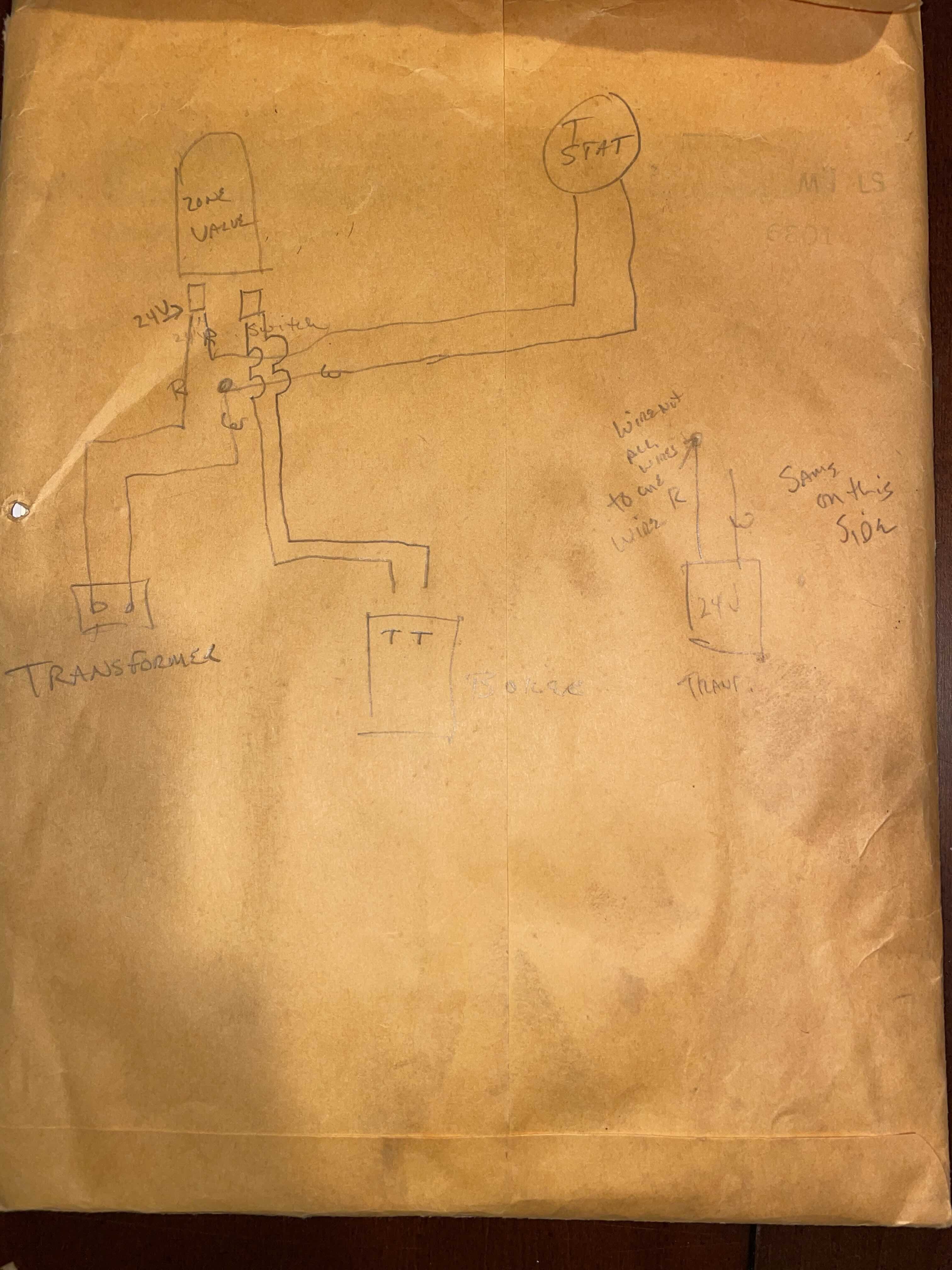

The thermostats are wired directly to the zone valve motor control and then into the 40VAC transformer. This hand-drawn wiring diagram was left with the house:

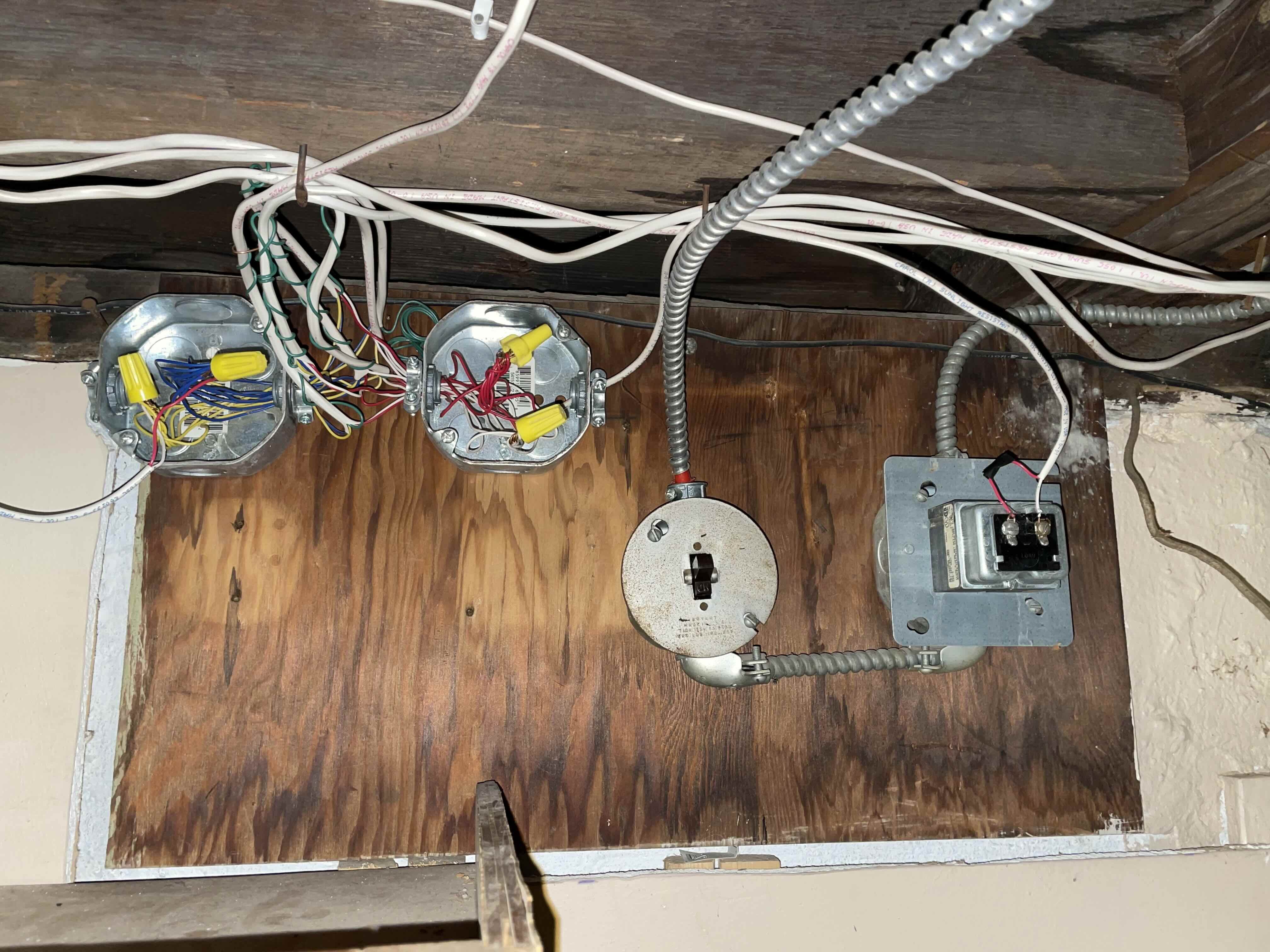

The thermostat/zone valve motor wiring (red & white) and zone valve end switch wiring (blue & yellow) each converge inside a junction box. There is no zone controller in the system. The boiler TT wires are wire-nutted into the blue and yellow end switch wires. See image:

    Aw @rick in Alaska — we're not that old. Though I'll admit it's been a while since I've seen a diagram on a paper bag…
    Which, oddly enough, is correct. For two wire thermostats. Each thermostat — a simple switch — powers its own zone valve. The end switches for all the zone valves are paralleled and run to T-T on the boiler. Couldn't be simpler.
    However I can easily see how whatever Rube Goldberg wiring may have been added or changed to make the T8400C thermostats work on two wires could very easily result in false signals getting to a zone valve or valves…

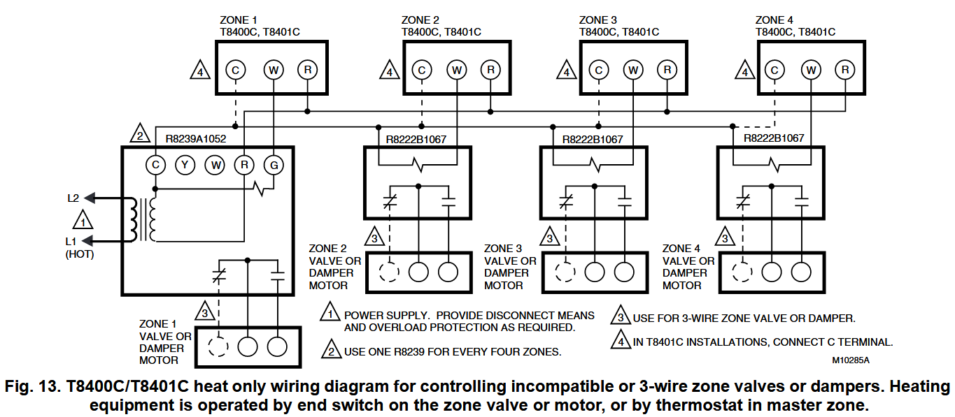

    109A_5 Posts: 4,759
    You may have a compatibility issue between the ESP zone valve and the T8400 power stealing thermostat. Is your replacement Head the same model as the original ones were ? Does the zone valve with the replacement head work correctly if you disconnect the thermostat and just touch the R and W wires at the thermostat for zone valve control ?
    Here is one example of how to make some of this equipment play nicely with each other. In your case you probably have some compatibility issues, as you suggested may also be age related also, which is why you found the mess you did. IMO they took simple an complicated to the point you are lucky it works at all.
