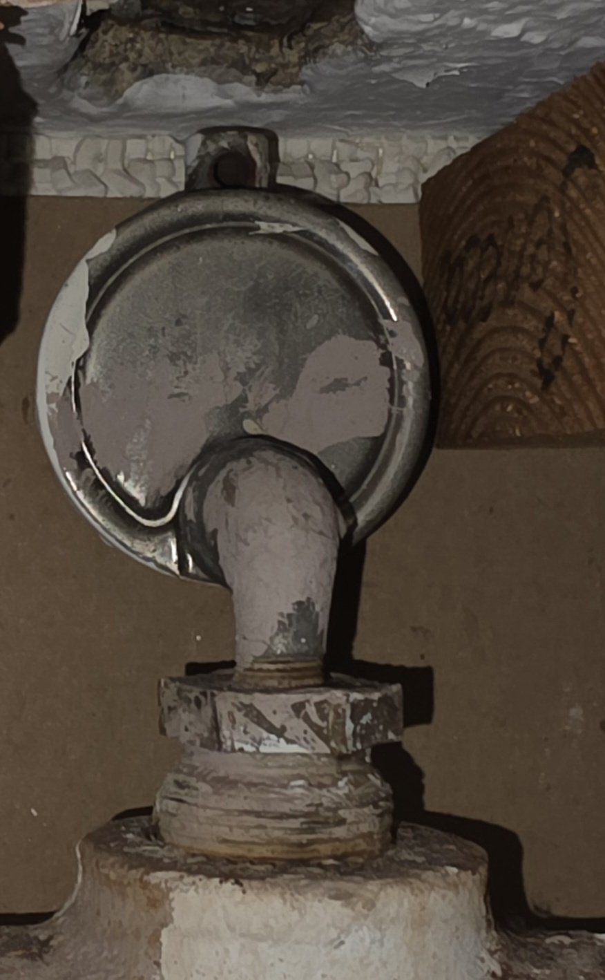

Anyone identify this main vent ?
It's a radiator vent. The format indicates either a Gorton or Maid O Mist. There will be stamped lettering on the other side that will tell the whole story.
Other side is blocked. I couldn't tell from the inlet because it's an odd shape. Maid o mist and gorton look slightly different in that regard
Looks like a Gorton. Maid O' Mists vent through the top of nub. Gortons though the back side of the nub—through the hole in the photo (and leave a mark on my white radiators).
I think you're correct. MoM have that screw on vent
it’s a Gorton radiator vent threaded into a street elbow
Probably a D given it's a rad vent
Given the size of the hole, I think you're right.
Nothing wrong with doing it this way, as long as the vent is adequate for the main it's on. @ratherbfishing , how long is that main, and what pipe size?
1 -
@Steamhead it's the short main. 26 feet, one 90 degree turn, 2.5 in
That should work fine. If the other main is longer it needs more venting.
