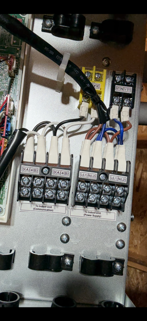

The CDU has a big sticker near the inlet port pairs that states ROOM A, ROOM B, ROOM C and D on my 4 zone. I "thought" when I opened the cover to get to the terminals to connect the power supply and comm. lines from the IU's I would see terminals marked ROOM A, B and so on. NO. Nothing of the sort. Just a block of 8 terminals for the power and 8 for the comm. They say which wire to connect, but not which room it is. Picture above of that. Also on my 3 zone, which pair of terminals do I not use since it's equipped for 4 zones worth of terminals.
In the manuals, it says something to the effect of be certain you connect the power and comm. lines to the correct ROOM the copper is going to, but how do you do that when it's not marked? Does it have some technology where it figures it out itself? Or this just another case of the manual lacking info or the CDU lacking markings.
It also looks like the yellow terminal block has a white wire going from 3A to 4B on the 8 terminal block. 3A should go to 3A. If that marked correctly, then that's wrong isn't it? Is the sticker upside down? The power side sticker isn't and it looks correct.

    4 wiring the branch box is a little confusing. it shouldn't matter which block of terminals go to which IDU though, for consistency I would go from left to right, first power goes to 1st unit, 1st comm goes to 1st unit. This will get set with the pipe addressing step on install which you are going to love. If any of your IDU did not come with a wireless remote controller (air handler for example) then ask your wholesaler about this stat, which you will almost certainly need for the pipe addressing step. Also just ask them now to get the pipe addressing instructions, when you do post them here because they are missing a step. and DO NOT AUTO address unless its well over 50f outside.

    He did say that I need to swap the two wires going to the yellow block in the CDU. They are wired wrong (or you could say the sticker is wrong).

    I had heard that some of the branch boxes were stickered wrong from the factory but hadn't seen it myself yet. should have mentioned that above.
