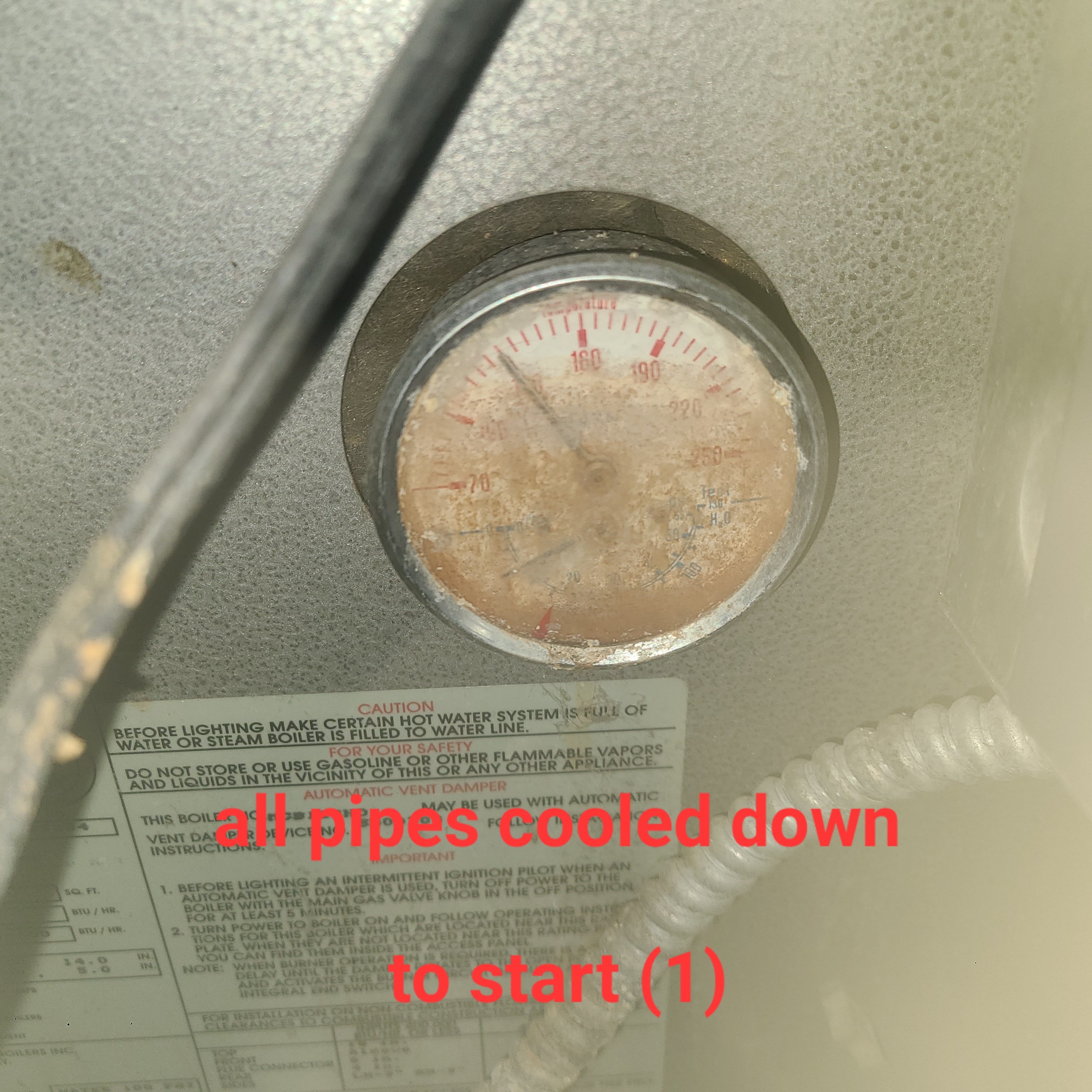

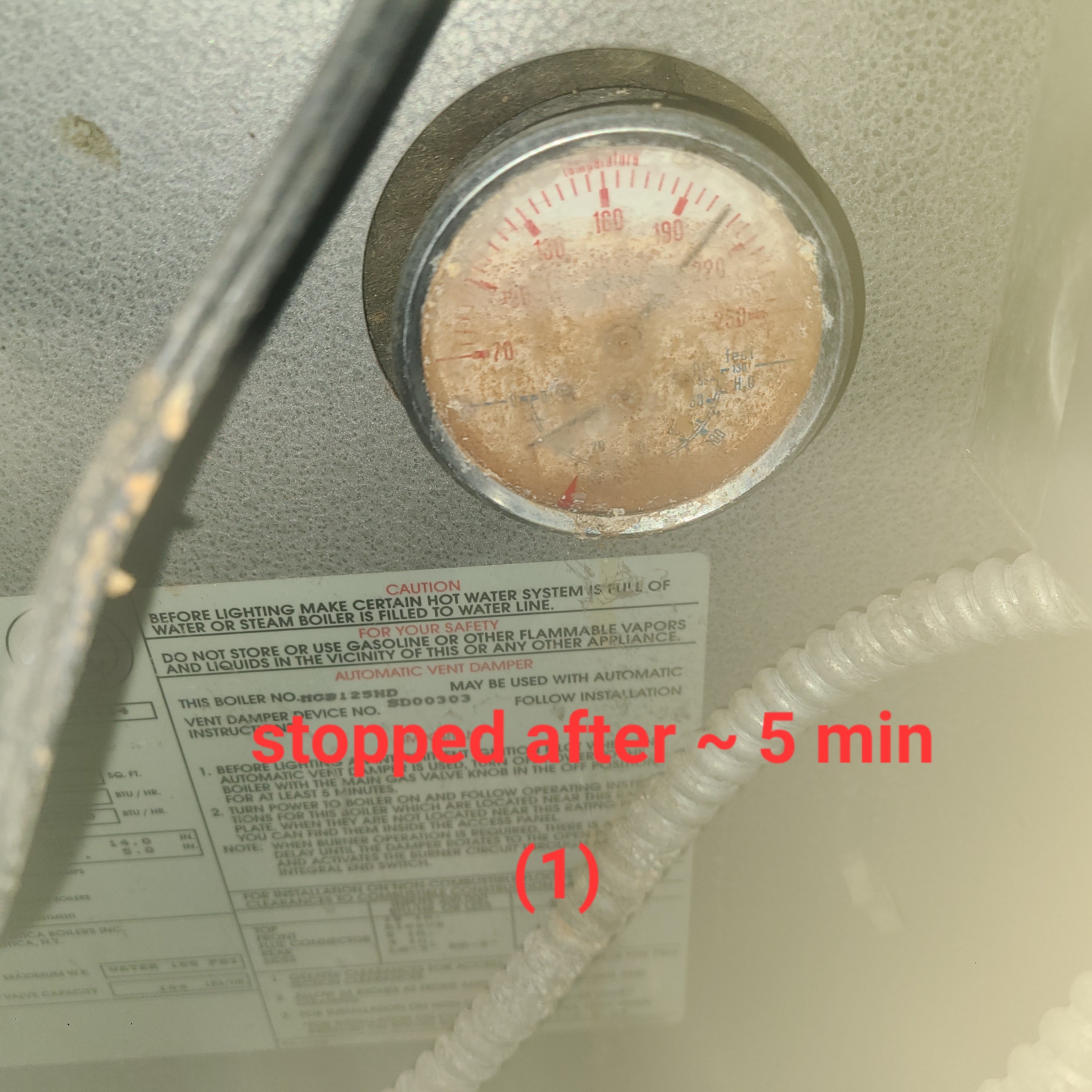

Hi,
I have an old Utica MCB125HD gas boiler. Recently found that the boiler can't reach the temperature set by room thermostat.
By doing some testing, I found that the boiler ran for about 2+ to 5+ minutes and then stopped when the temperature on the boiler reached 195-205F. After about 10 something minutes when temperature cooled down to about 160-170F, the boiler would start again.
The boiler just kept going in this cycle. The pressure was about the same when the boiler is cold and hot (see attached pictures). The Taco 007-FS calculator pump, replaced about 2 years ago, was sometimes a little more than warm (touchable).
Any help appreciated.

    109A_5 Member Posts: 3,887
    Can you clean that gauge, can't see the lower Blue scale very well.
    My bet from here is the system pressure its too low or the system is air bound, assuming the circulator is working properly.
    The boiler is just cycling on the high limit since the heat is not being transferred to the rooms properly.
    hot_rod Member Posts: 27,329
    the chrome ring on the gauge should pop off, then you can remove and the glass with vinegar or CLR
    When a gauge goes bad they often have rust and scale on the backside of the glass.

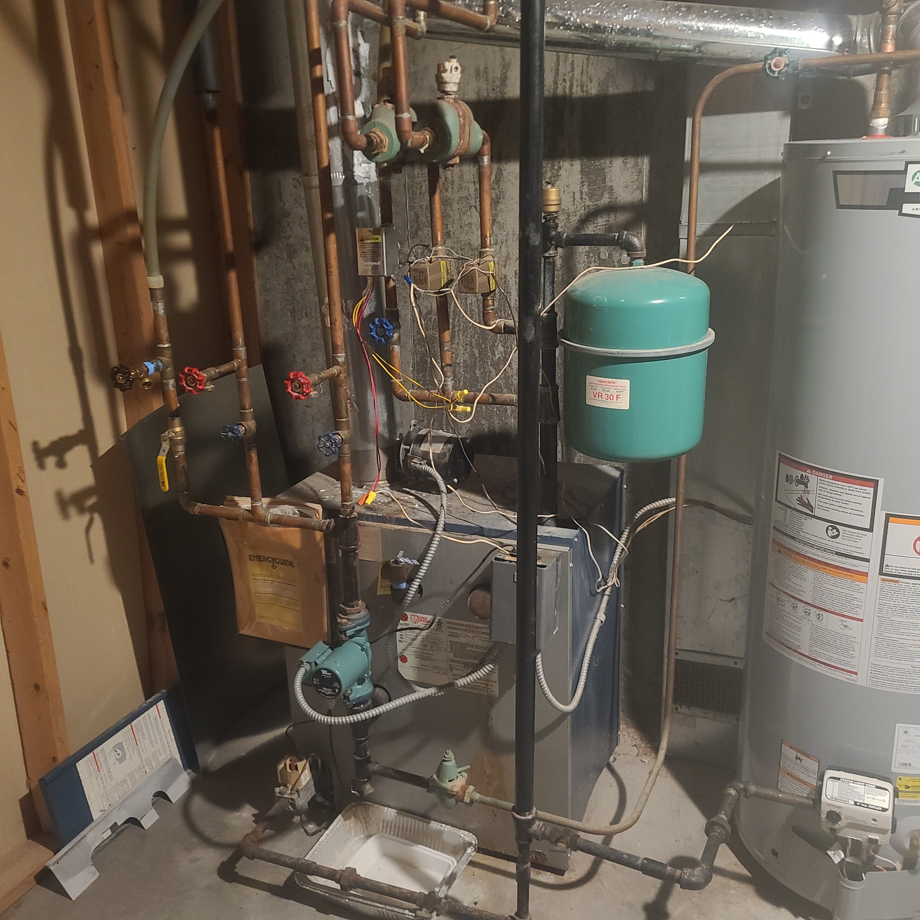

    HVACNUT Member Posts: 7,410
    Show the whole boiler and piping around it.
  • rlxyz0
    rlxyz0 Member Posts: 7
    here is the whole boiler picture.
    we only noticed the temperature issue recently. It was working ok last winter and earlier this winter.
  • HomerJSmith
    HomerJSmith Member Posts: 2,774
    edited December 2025
    Are those two blue valves below the red drain valves or the one below the Honeywell ZV fully open?
    Which one is zone 2?
    If it is the 571 zone valve, you can open it up by pushing the lever down.
  • rlxyz0
    the one on the right is zone 2. the middle one is zone 1. the one on the left is another zone to basement. All the blue valves are fully open. I think the 571 zone valves are working properly as the pipes above them are very hot. Also the damper had been manually set fully open.

    mattmia2 Member Posts: 16,462
    what makes you think the circulator is actually running? that relay has a tendency to break the solder joints on the relay after a few decades. the water in the boiler will make the circulator hot in that position. you can check for power at the circulator with a voltmeter. you can also try plugging it in with a test cord.
    gravity circulation will get some heat to the emitters without the circulator.
    it also looks like those auto vents are leaking. is the cap closed to stop the leak and also stopping them from venting air?

    Just want to provide an update. the issue was the voltages at circulate pump were inconsistent. at some period of time, the pump received 112V and functioned normally and at other times, it only received about 80V. it has been fixed now. Thanks all for the help

    OK, I guessing failing solder joints in the aquastat.

    I saw the tech took apart the aquastat and did some soldering. there were some loose connections
