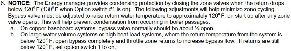

I have been videoing the boiler in operation, and I notice one thing that seems odd. Because we have large secondary loops with tons of cool water in them, the hydraulic operation of the system obviously depends on significant bypass water to temper the return water and prevent condensation and sooting. Despite the current bypass setup, which the dealer swears is exactly-correctly-configured, in a 20 minute call for heat on a mildly cool day, I counted 6 interruptions for condensation protection by the Display Energy Manger, which was functioning correctly based on its display of the return water temp, which appeared accurate. The small bypass pipe is hot, the large return pipe is cool, they blend together and yet still crash the boiler temp and cause a condensation-protection shutdown. Either that’s normal or it isn’t, and if it isn’t, why is the dealer telling me there isn’t anything to do to correct it? Could this be one part of why the efficiency is off? Is my boiler momentarily micro-sooting and harming its efficiency?

    "I counted 6 interruptions for condensation protection by the Display Energy Manger"
    "Is 7 shutdowns in a heat call “normal”?"
    Not an EK expert, but I did not find anything in the manual about a boiler shutdown for condensation protection.
    Or are you referring to a zone valve closing ?
  • wjcandee
    wjcandee Member Posts: 7
    I'm so sorry if I wasn't clear. What I'm talking about is the halting of the injection by closing the zone valve, which concurrently prevents flow from the return into the primary loop while the boiler reheats. The burner keeps firing of course, so the supply temp will raise and the bypass will still flow, and the zone valve or valves will open when the return water, which then is primarily bypass, reaches 140. When the zone valve opens, new slugs of cool water will mix with the bypass, causing the return water temp to drop again and eventually the zone valves to close again as directed by the display energy manager for condensation protection. What you quoted is a slightly earlier version of the instructions, but basically describes the principle of operation. The ball valve controlling the flow of bypass water through the flat plate exchanger is wide open.
    109A_5 Member Posts: 3,889
    Personally I'd want the bypass dynamic and automatic, not a fixed valve. But that would cost more and I don't know if it would help improve the perceived efficiency any.
    "What you quoted is a slightly earlier version of the instruction" Then they don't have the current version on their web site.

    The primary/secondary (low mass/high mass) zone valve opening and closing is protecting the boiler from condensing. The burner will run without shutting off during these cycles. This does not reduce the overall boiler efficiency, but improves comfort and protects the boiler. Here's why: The circulator on the primary loop (which goes out to the radiators) continues to run with high enough flow that the radiators will typically heat much more evenly. Because the primary loop circulator continues to run, the heat distribution is much more even (as compared to a typical boiler where the heating circulator would turn off when the boiler temperature dropped too much from cold returns; this would "pulse" heat out and causes near radiators to heat rooms more than more distant radiators).
    There is usually a ball valve on the return of the injection zone, and throttling this somewhat will reduce the number of zone valve cycles. This is a specific setting for a given primary/secondary loop, and once it's set it does not need to be moved again. Nothing hurts the efficiency or the boiler if this is not done, but if it is your preference, it could be adjusted to reduce injection zone valve cycles. Throttling too much could cause the burner to turn off from a high boiler temperature from too much bypassing water earlier than it would with less throttling.
