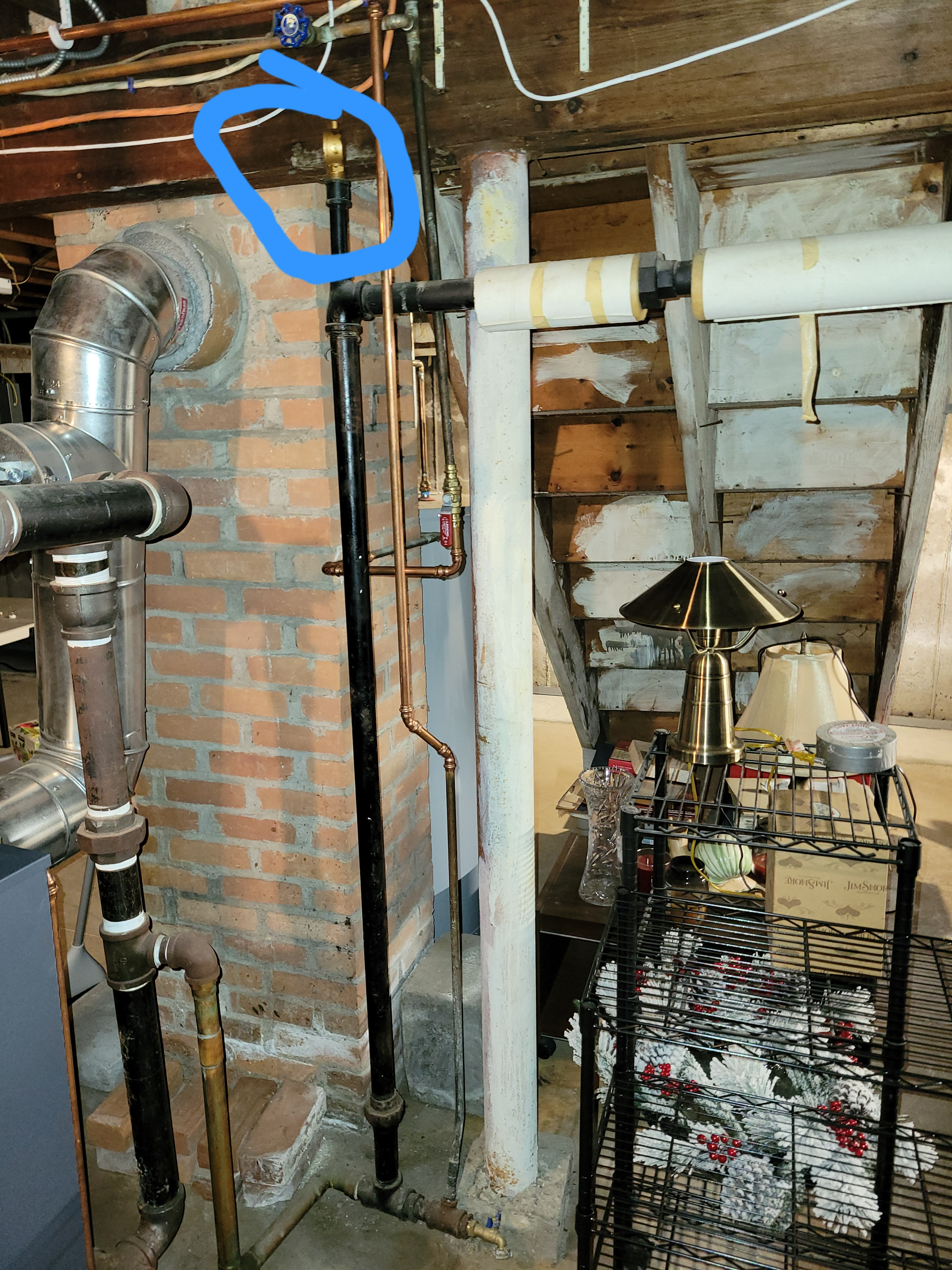

Steam main help
Absolute rookie here
Single pipe steam
Apx 90 ft of 2' main
Main vent replaced from vent rite #35 to gorton #1
Reduced main venting from 40+ mins to 21.5 mins, read that that much line should only take roughly 3-5 mins to vent (blame AI if its wrong), looking through my system i noticed that the main vent is located after a reducer from 2' to 1'

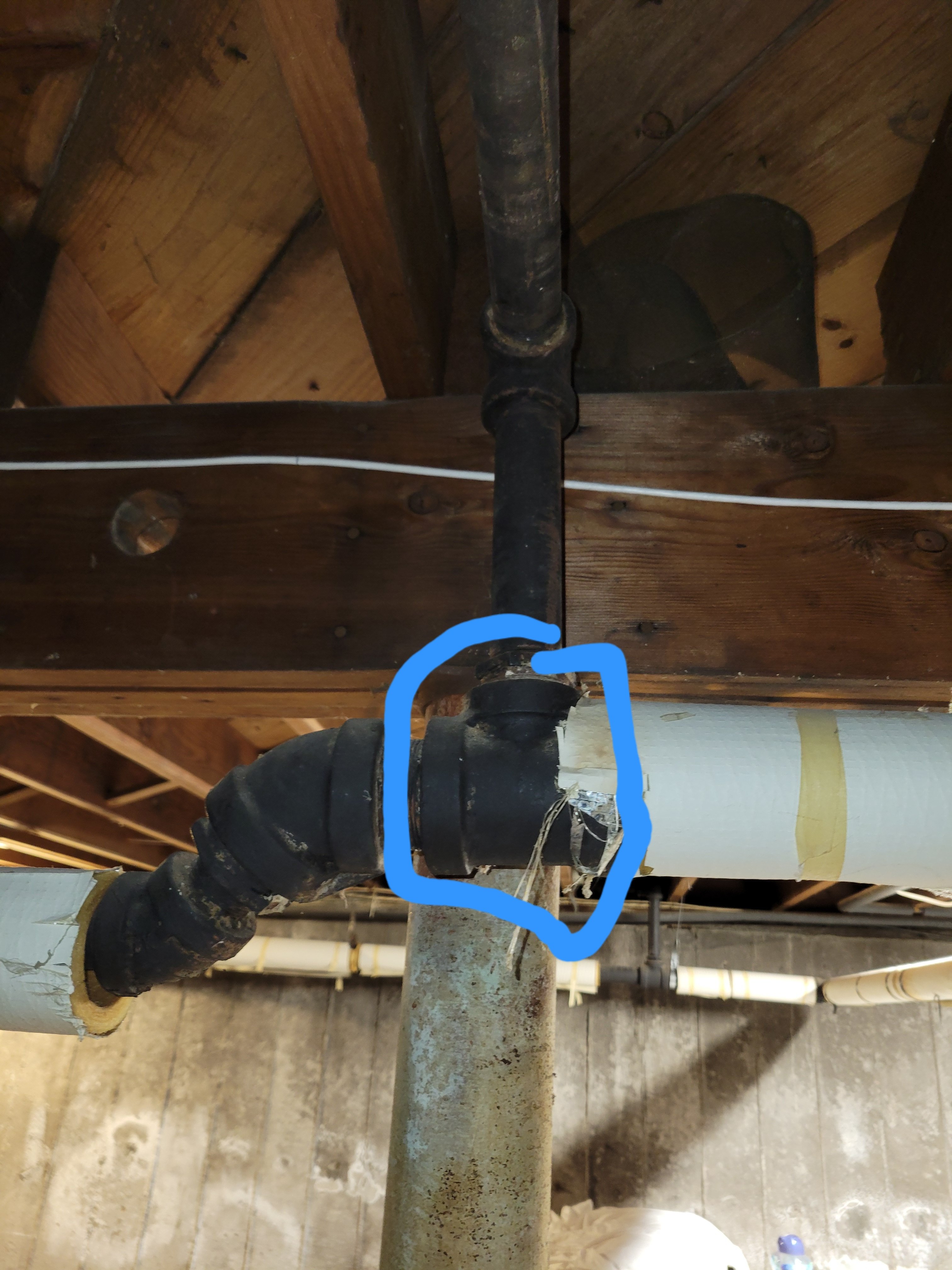

Wondering if it would be a good idea to tap a tee nearby and add more main vents prior to the reduction?
Not working with very much space so tapping the tee seems like my only option, thinking of running a 1 inch pipe and adding a couple of gorton #2
Like I said absolute rookie!
1" is more than adequate to vent the air as fast as the steam can heat the main. are you measuring from when the boiler starts steaming? it will be a lot faster when the system is still warm from a recent cycle than from cold. you can take the vent off and run the boiler until steam gets there, it isn't going to get any faster than that with a bigger vent.
others will know relative sizes of different vents.

Apx 75 ft of 2' from boiler to reduction and 15 ft post reduction to 1' (the only main vent is past this currently)

I would build an antler in your current location with a 90, you have plenty of space to add two or three Gordon #2's or for more venting Barnes and Jones Big Mouths, that is what I use. You also want to check your radiator vents, they might be too slow as well. Gerry Gill put out a chart to match the vents to the radiator size and location that can be very helpful. You may need to play with it a bit to get even heat but it made my system heat faster and evenly thus run more efficiently. Venting the mains helps but the whole system needs to vent correctly to work properly.
why are you blaming the radiator vent for this?
Try a #2 as the main vent and see if things are better.
Your times aren’t very useful unless the main was hot at the time, as already mentioned
1 Gorton #2 should be sufficient or add two more #1's on an antler.
