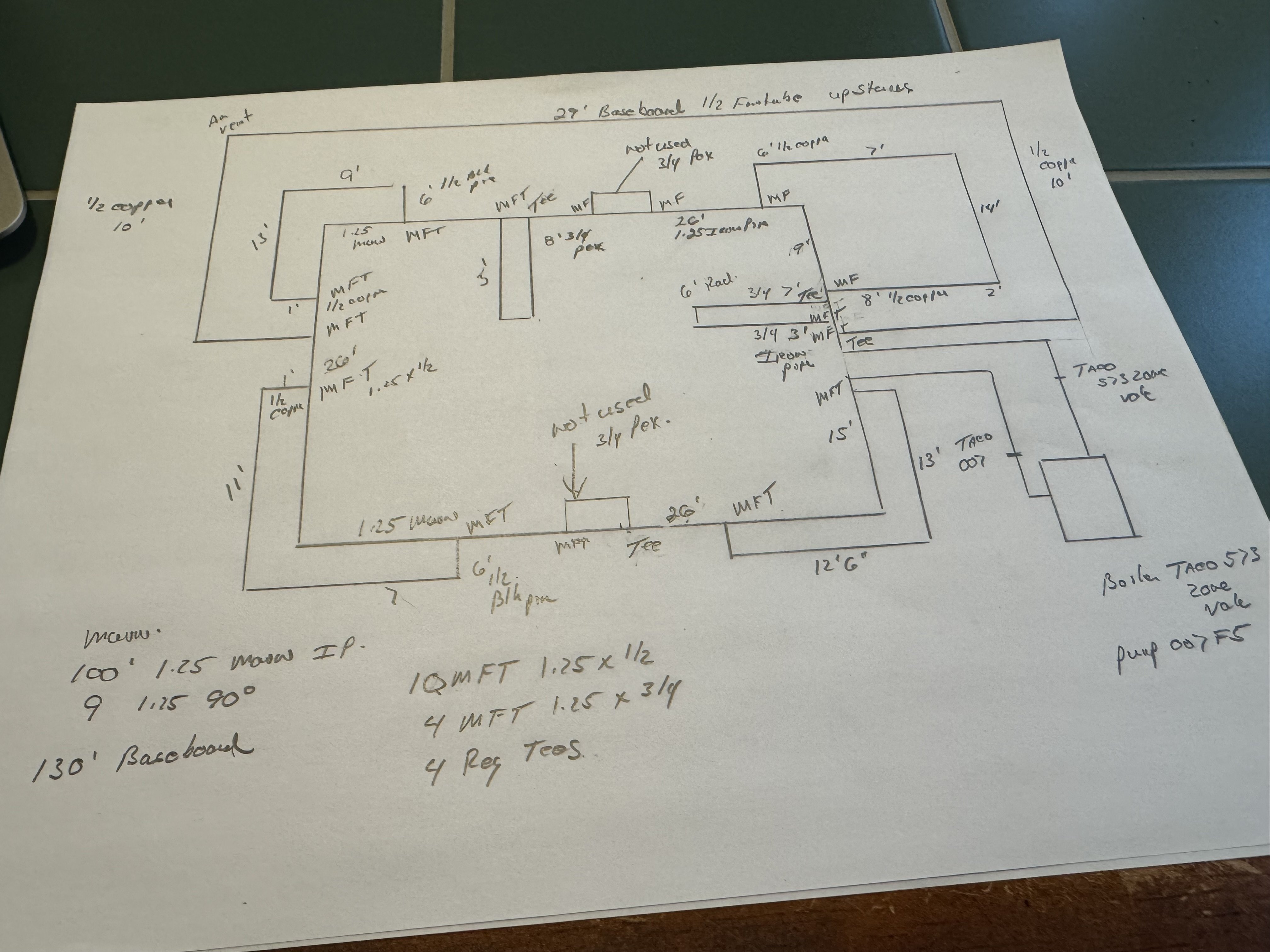

Hi all, Our monoflow heating system doesn't seem to be working very well. we have a 120000 Pennco boiler with 100 ft of 1.25 iron pipe with 16 mono flow tees single loop 130 ft of baseboard on a taco 1.25 zone valve on one zone. other two zones are on 3/4 zone valves and about 38 ft of base board on a loop, one taco circulator 007 f5. I feel the taco 007 is too small I don't know how to calculate the head per monoflow tee. any help would be helpful.
«1
    edited December 2025
    Is this a new problem or has it always existed? If it used to work what changed? Do you get domestic hot water off the boiler?

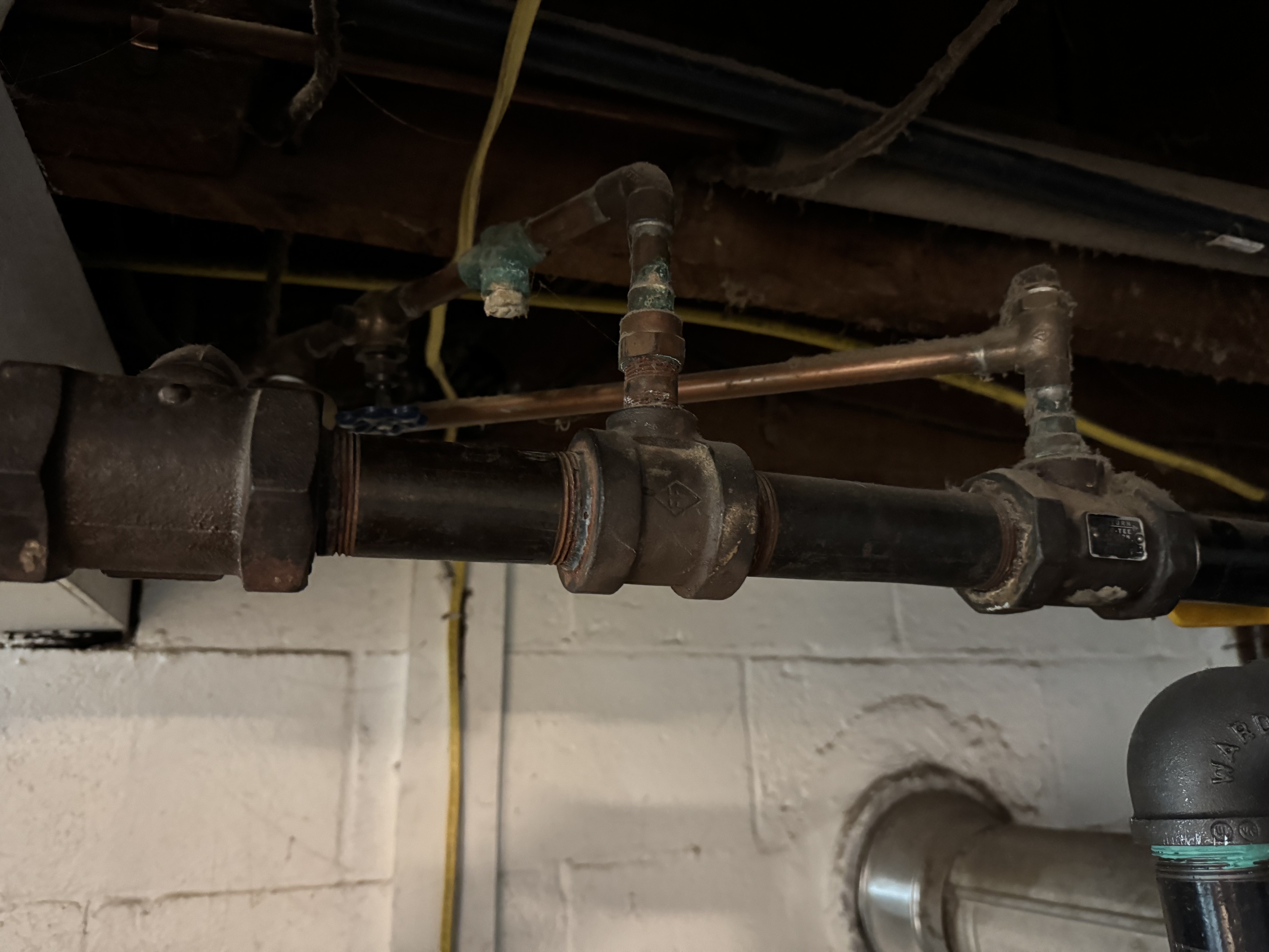

    Can you post a picture of the piping around the boiler and a picture of a Monoflow tee.
    does the house not heat at all or is it sluggish? Was the 007 changed?
    Are all the zones monoflow or just the main zone?

    This is an existing problem, no domestic hot water. B&G monoflow tee 1.25, House does heat sluggish. the 007 was on the boiler. Just the main zone is a monoflow.

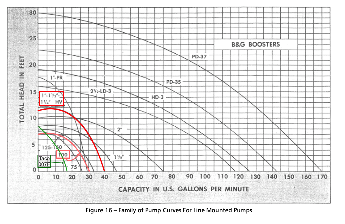

    Even if you can't understand pump curves, You can clearly see that the old standard B&G 100 and HV pumps are more powerful than the Taco 007F. I can do the math for 16 MonoFlo® tees on one 1-1/4 main pipe, but I would feel more comfortable if @hot_rod took a stab at it.

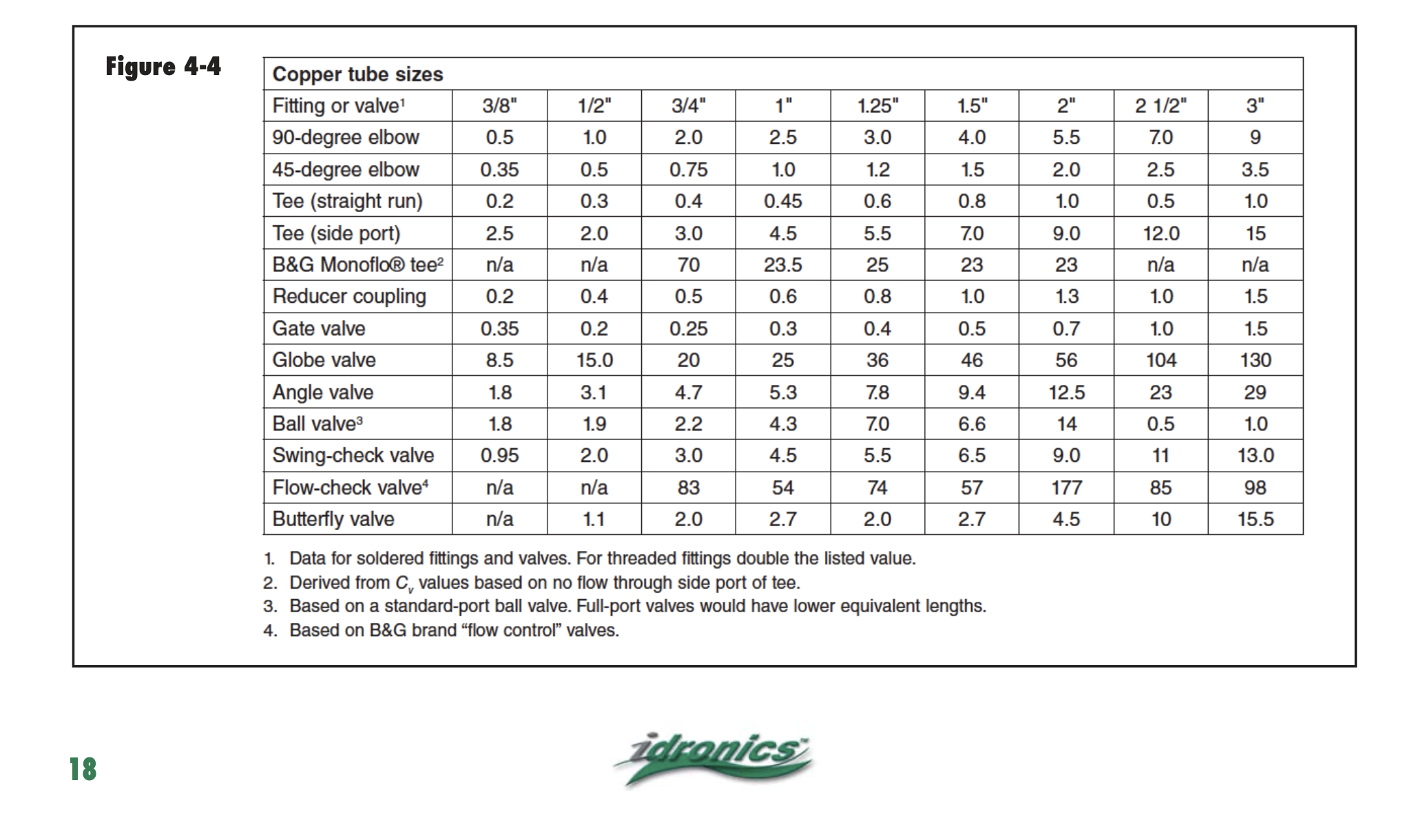

    I ahd a n 1 1/4" copper monoflow system with 8 tees. The 007
    The oo7 runs out of gas at 10' of head which is only 4.3psi. If you had places to stick a couple of pressure gauges on your suction and discharge you might be able to see something but gauges are not vary accurate at low pressures. Based on my experience with the 007 and other posts we have seen here I think you don't have enough pump. I had about 95 feet of 3/4 baseboard and about 130' of 1 1/4" main

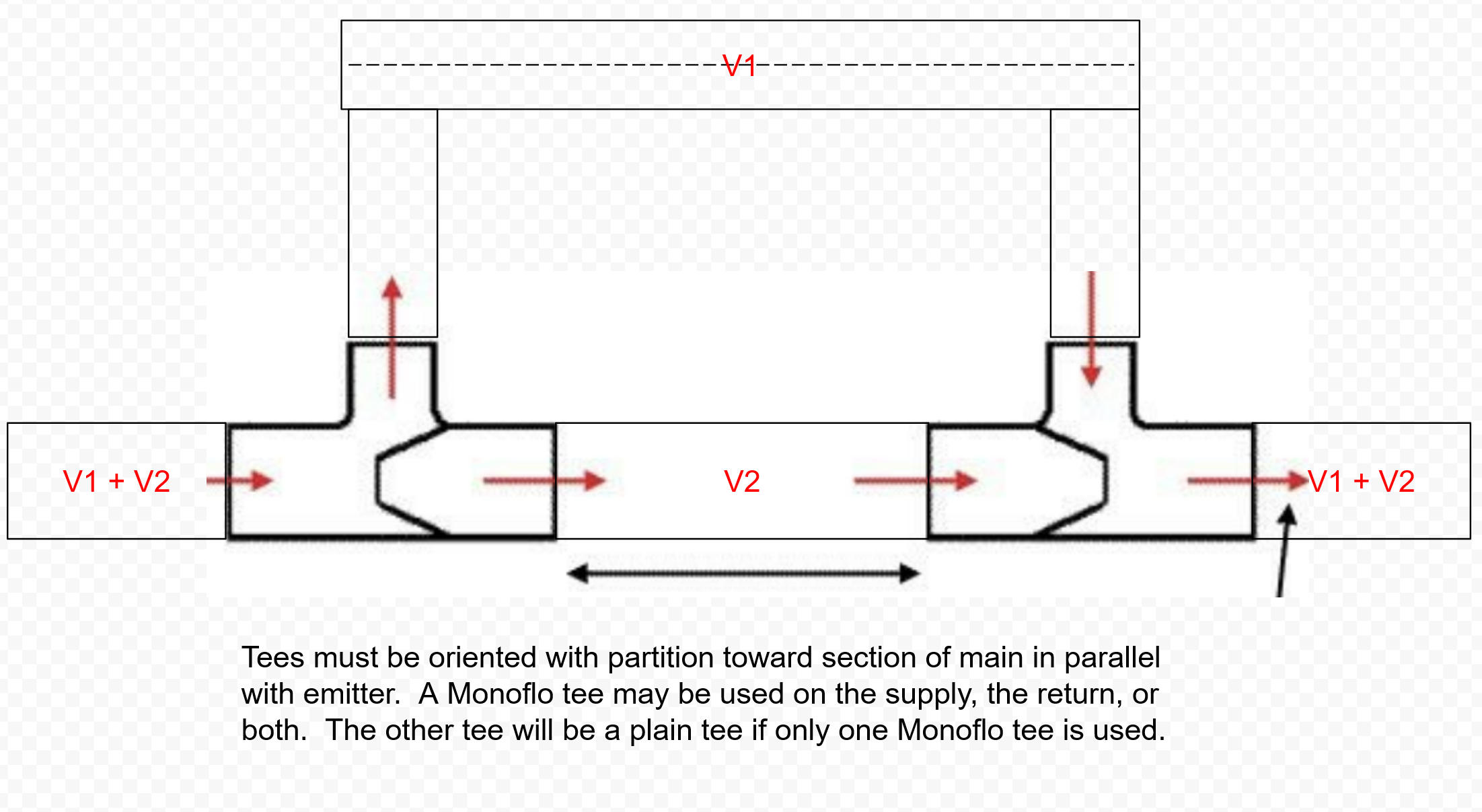

    if it is 130' of baseboard on the monoflo loop it is a series-parallel combination so the flow splits between each section of the fin tube and the main at each section of fin tube so the fin tube only has to carry a fraction of the total flow. if the baseboard is about 500 btu/hr/ft then that is 65,000 btu/hr and you need somewhere in the ballpark of 6.5 gpm through the 1.25" pipe.
    the monoflo book from b&g is out there as a .pdf in numerous places that describes the design.
    the monoflo tees simply have a circular partition in them that divides the flow between the branch and run. you could get the same effect with a reducing tee.

    Does the monoflow book give the head for the 1.25 tees? I did check the pressure before and after the pump which was 8.74 on the suction side and 12.68 on the discharge side, will that give me the head pressure of the system?
    hot_rod Member Posts: 28,078
    Generally when defining or determining the pressure drop of a circuit you convert pipe and fittings to EL, equivalent length. An example and chart with common fitting conversions. A 1-1/4" monoflo® tee =24' of tube

    B & G sizing chart is attached

    I don't see any possibility of an 007 pumping this job after what I went through.
    @skip143727. You have 3.94 psi across the pump. that equals that equals 9.10 feet of head. At 10' of head the 007 is flat on its face and hardly moving any water.

    Your short on pump
    Your pressure drop measurements tell the story.

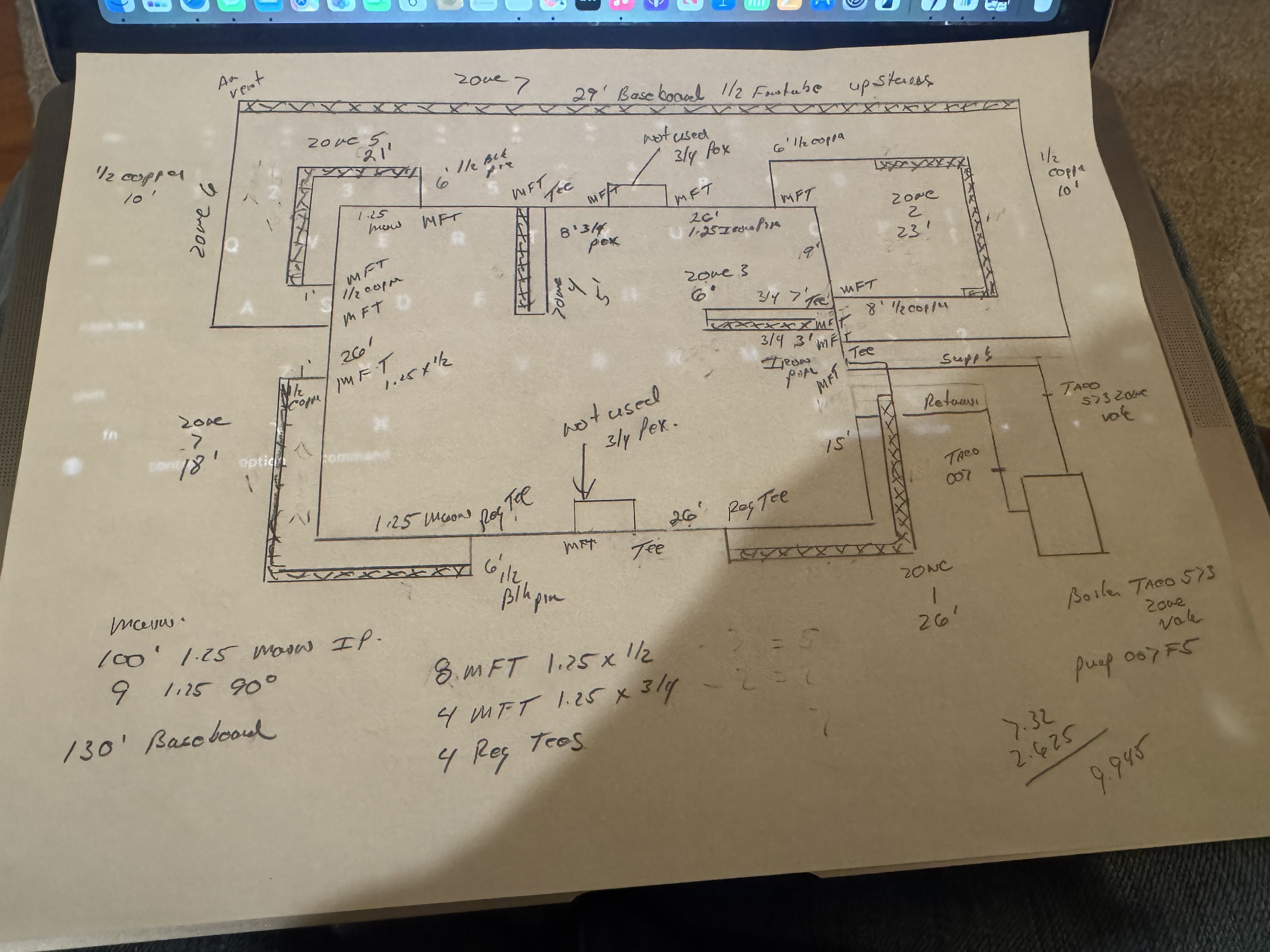

    If you want to gather all the information and post a sketch of the piping I can calculate the head and gpm you need.
    Your going to need"
    Feet of baseboard on each branch
    size of branch pipes and approximate length, fittings on branch pipes etc
    size of venturi tees 1 1/4 x 1/2" , 1 1/4 x 3/4" etc
    Sketch and length of 1 1/4 main
    Flow check valve/, zone valve etc and sizes
    Pictures will help.

    I will definitely get the info for your review! Thanks

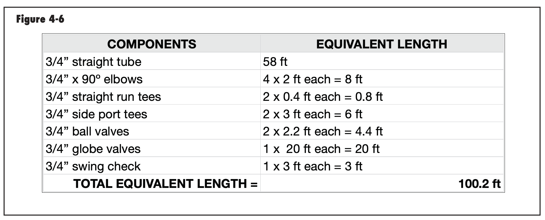

    • The equivalent length of a 1-¼” Moniflo®, according to the chart provided by Bob @hot_rod Rohr, is 25 feet.
    • Then we need to add to the 210 feet the EL of 16 Moniflo® tees @ 25 feet or another 400 feet .

    I wonder… is the 25 ft equivalent length of the Moniflo® is for the branch?   Additional research shows that the equivalent length thru the restriction in that tee thru the run is as low as 10 feet.  I believe there is a chart somewhere that indicates the run of a 1-1/4" Moniflo® is about 10 feet.  If that is the case then that will make the needed pump head only 15 feet.   That makes the B&G 1/6 HP model PR pump more likely to be the pump that was on the original boiler.  But this is all speculation at this point.
    I might try a Taco 0014F or a Taco 0011F as was suggested earlier.
    We will see what the calculations come out to if I get the info from the OP.
    I doubt he needs 24' of head unless he needed to run the 1 1/4 to full capacity. He has 130 ' of baseboard that would be 130 x 550btu/foot or 71500 btu/10000=7.15 gpm.
    He has 3.94psi deltaP across the pump which is 9.14 feet of head. The Taco 007 moves very little at that head. The 007 at just over 7 gpm dies at 8' of head. Given the inaccuracy of using pressure gauges that is pretty close.
    If he needed a pump that did 24' he would not be getting any heat at all instead of it being just sluggish as it is

    B & G likes to keep secrets. I have been searching for the pressure drop of 1 1/4" B & G Monoflow tees and couldn't find it. I only found the 24' @hotrod @EdTheHeaterMan mentioned. But as HR pointed out it says with no flow on the branch.
    I did find something in my old B & G Handbook second edition 1949. Page 43 has a chart for Monoflow fittings. an 1 1/4 Monoflow tee with a flow of 14 gpm on the main is 4500 milliinches. Chart 7 "Pressure drop Curves B & G Monoflow tees". This manual or one like it is probably on this site. 12000 millinches=1' so
    .375 feet/tee or a delta P of .162. 16 tees x .375=6 feet of head The op does not need that much flow however.
    I have a 1964 Ashrae "applications" says to use 3000 millinches if you can't find the MFG data.
    Taco has Standard or Super Venturi tees. The standard is 5000 MI the super is 14000MI both 1 1/4 " and both at 14gpm
    so the standard would be 6.6 7 feet for 16 tees
    super would be 18.66 feet for 16 tees.

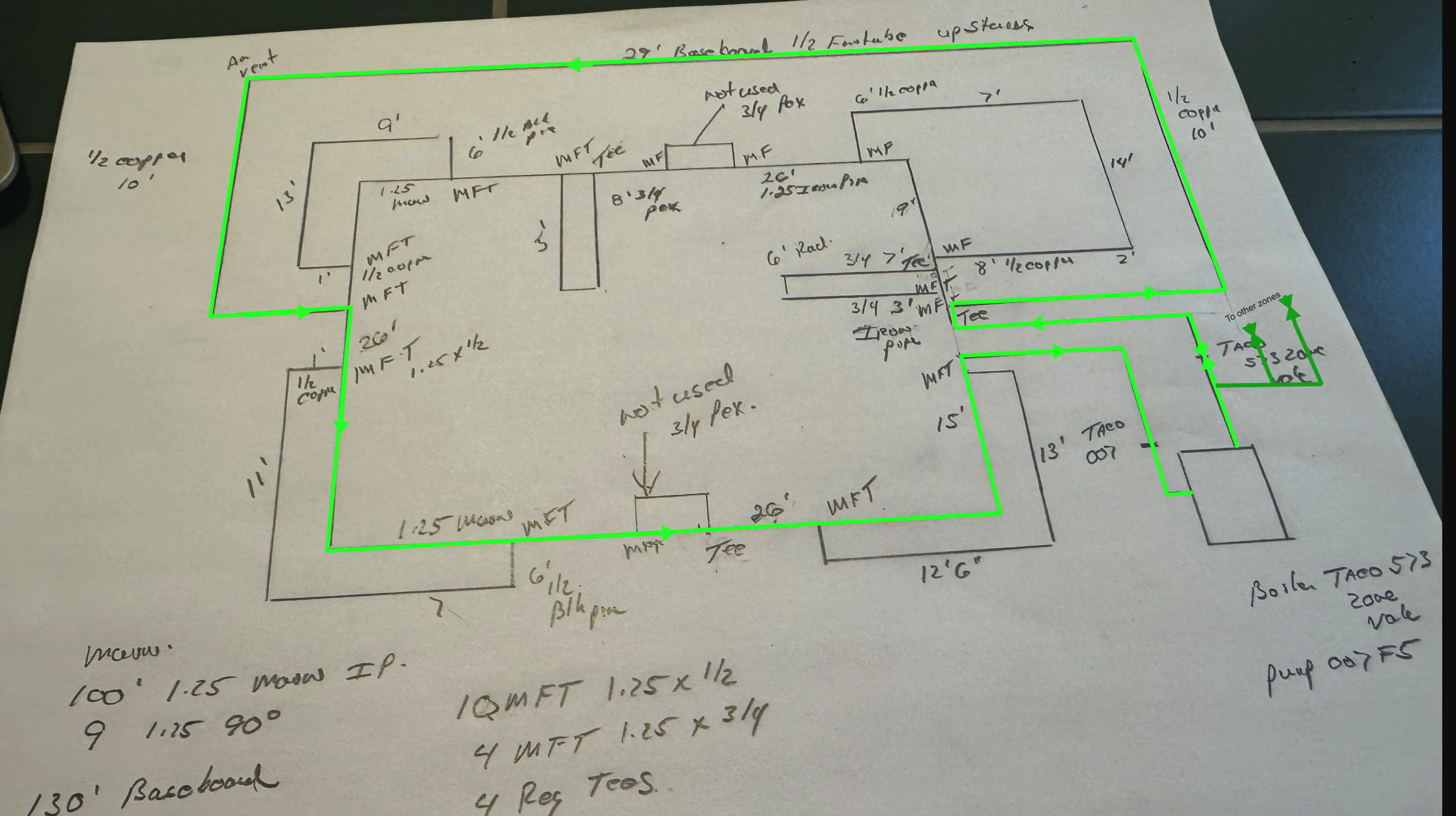

    @Skip143727
    So most of the radiation loop have monoflow tees on the supply and return? I count 6 loops with monoflow tees on the supply and return and 3 short loops with 1 tee.
    How do your other zones with 38 feet of baseboard tie into this. Do they have their own pump and work fine so they can be ignored? Or are they on the same 007 pump?
    I will work on this tonight.

    7 loops, 4 loops have tees on the supply and return, the upstairs loop that has 29 ft of baseboard has 1 regulator tee on the supply with what I assume is a 1/2 check valve and the return has the 1.25 x1/2 MFT which is all in 1/2 copper with a air vent and is terrible! Two locations are just piped in with 3/4 Pex I found they were just capped off. Spacing on one is 18 inches and the other is about 6 inches. There is a 6 ft convector in the kitchen that is piped in 3/4 black iron about 10` of piping , works good. The basement zones have there own taco 3/4 zone valves with a taco zone controller they won't come on if the main floor calls for heat so I didn't add that in. Hopefully that's okay they are on the same 007 and seams to work fine. The boiler is a Pennco gas 120000 btus. hopefully I didn't miss anything. Your help is greatly appreciated!!!

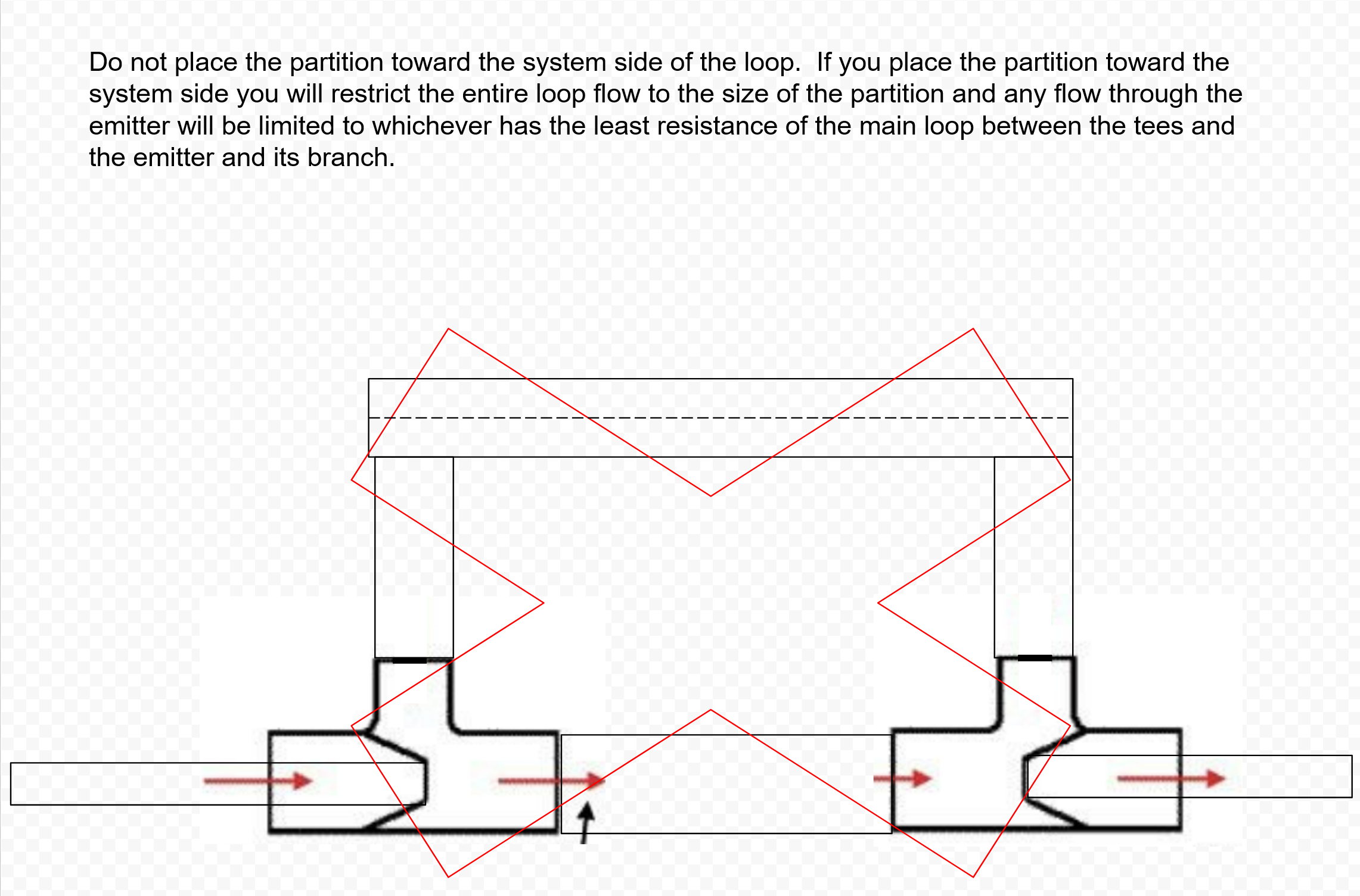

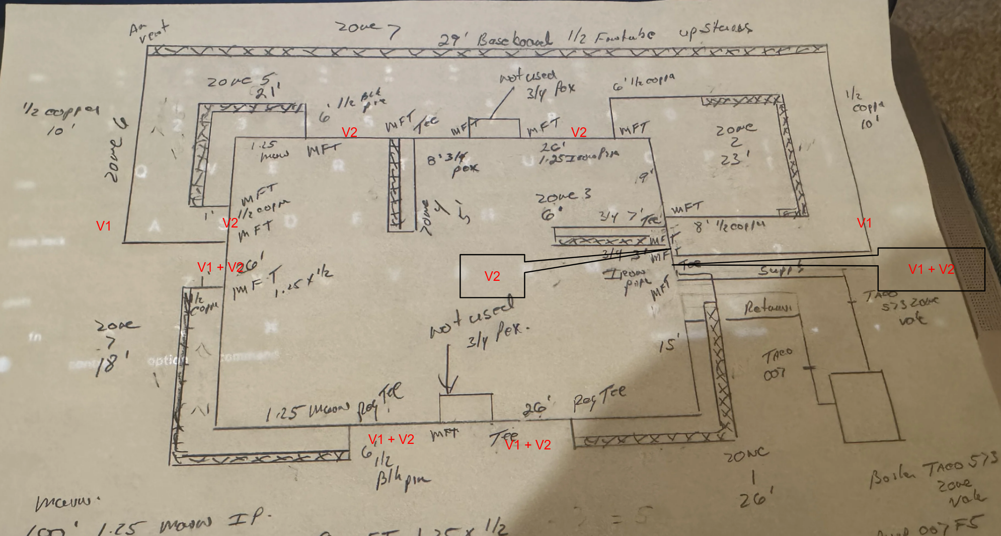

    mattmia2 Member Posts: 17,905
    You can't put other emitters between the monoflo tees for one emitter, it will reduce the flow in the main for all those emitters.
    Since it divides the flow, the flow has to recombine before the next emitter. That baseboard loop has to either reconnect at the same spot on the main or be made a separate zone.

    One location has 1 monoflow tee on the supply as the first zone and a regulator tee last on the return end. Could this be done with a regular tee. The 2nd location has a zone in between another zone with 2 monoflow tees? 1/2 copper. The upstairs zone is split right in the middle of all the zones in 1/2 copper?
    one regular and one monoflo tee is ok as long as the monoflo tee is pointed the right way.
    i don't understand the 2nd and 3rd questions.

    So the emitters in between different monoflow tees will need to be changed so it doesn't reduce the flow to all other emitters? There's 3 locations like that? Or is okay if using only one monoflow tee with a regular tee? 1 monoflow tee says supply/return on the tag?
    I can figure out the main with what you posted. If you could repost the drawing with the baseboard on it it would help.
    I can tell you that the second floor (is the 29' of baseboard all the baseboard on the second floor?) you have a load of about 16,000 btu and the flow needs to be 1.6 gpm. Since it is all done in 1/2" copper it is maxed out.

    I needed to make some changes hope this helps
    @Skip143727 K. I will see what I can do.
    @Skip143727
    So the 1/2" monoflow loop to the second floor is that the only radiation on the 2d floor?
    What is the lay out of the house. Is this typical boiler in the basememt? Your existing basement zones heat the basement are not part of the drawing correct?
    All the radiation shown on the drawing is above the boiler and is on the first floor except the 1/2" loop to the upper floor correct?

    Yes the 1/2 inch is the only radiation on the 2nd floor. yes the boiler is in the basement, and the other two zone controls a bathroom and a living area.they work fine. Yes the first floor is the real problem. And then I have this, I think this is what's killing the flow to the far side of the house? The middle tee feeds the upstairs on the supply side of the 1.25 main pipe. the first tee says supply, the third tee says supply/return with the arrow pointing to the supply on the 1.25 main pipe.
