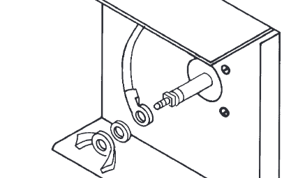

I was doing a steam boiler maintenance and was checking the low water cut out and it did not shut off even though the water level was well below the probe. At this point I turned off the burner so it would not continue to run. After 10-15 seconds it registered low level (yellow light on the cut out turned on and the vent damper closed) I tested it four times and it repeated this every time. The sight glass and the probe are on the same side of the boiler so I would presume the low level I am seeing in the sight glass is also a low level at the probe.
Any ideas?
Thanks in advance.
  • I cleaned the probe and checked wire connections at probe but that didn't help

    This is because the boiling water splashes onto the probe and makes it think water is there (which it is). I have seen this occur as well.
    This is why the Cyclegard LWCO exists which every 15 or 20 minutes stops the burners for 60 or 90 seconds (depending on model) in order to test the level of quiet water.
    This is why several manufacturers ship their boilers with this device. Unfortunately, the 1 minute pause 4 times per hour annoys installers, generally speaking, so they make the incorrect in my opinion choice to remove this very safe device, throw it into the junk pile, and replace it with a similar device that doesn't stop the burners to test the water level.

    I think it's normal, because I have seen it happen too. And plus, otherwise the cyclegard wouldn't exist.
    OK you have a Cyclegard. What does it do when the low water test occurs?
    Read the control instructions. Most (maybe all) probe type controls don't shut the burner down the instant the water goes below the probe. They delay for some time period.

  • I hear your point, but it was definitely below the cut out level for a while without shutting off and every time I turned off the burners it shut off within 5-10 seconds.
    109A_5 Posts: 4,759
    As a sanity test, instead of lowering the boiler's water level what happens if you just disconnect the probe ?
