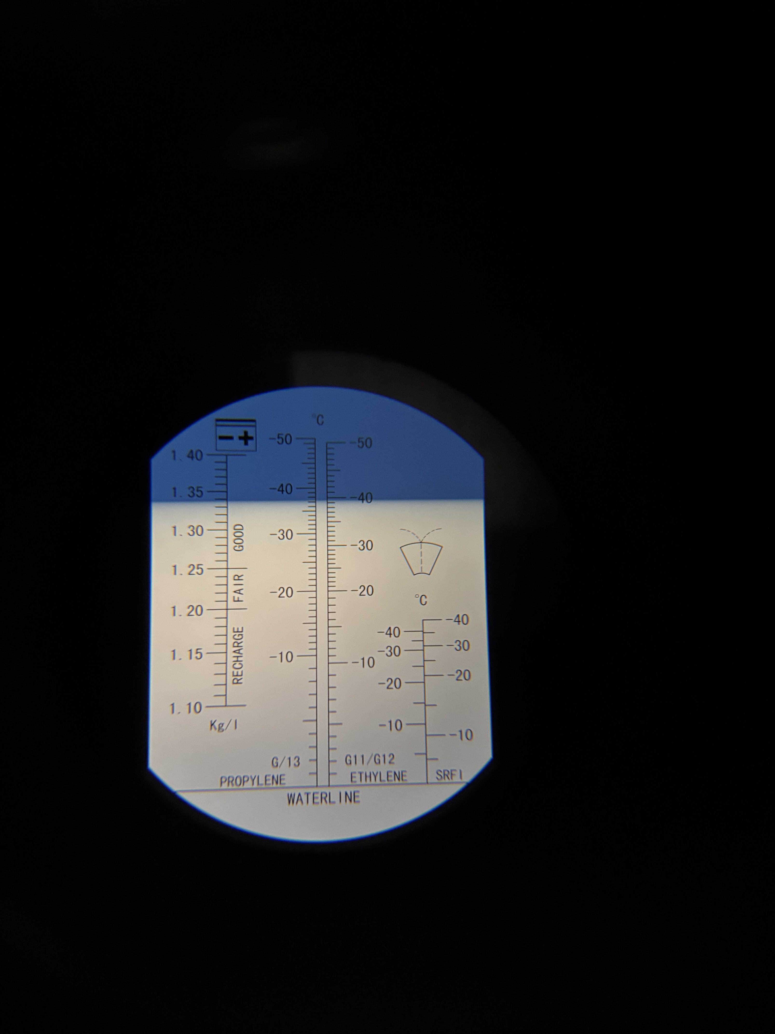

  • here’s a picture i took of the refractometer…..
    pecmsg Posts: 7,634
    way too low.
  • GroundUp
    GroundUp Posts: 2,573
    I'm no professional when it comes to refractometers, but pure 100% PG is only 1.04 kg/L so 1.34 seems to be beyond pure unless your fluid is very cold?? -40 freeze point is approximately 52% according to my chart and that's too high

    ok, so I think I confused freezing point and bursting point as suggested by pecmsg - a combination of the documentation provided by my glycol vendor and my (mistaken) assumption that freezing temp = bursting temp. It’s now clear to me that for a given glycol concentration the burst temp is much lower than the freeze temp (or perhaps more accurately the slush temp) .
    The 30% mixture suggested is only good for a -18 C slush temp, so I’m still considering if I’m that confident in my ability to supply power to my rural home in event of a long duration power outage in the winter, but I’m definitely going to change the mixture.
    thanks for your comments they helped me figure it out - much appreciated and happy holidays to you all.
