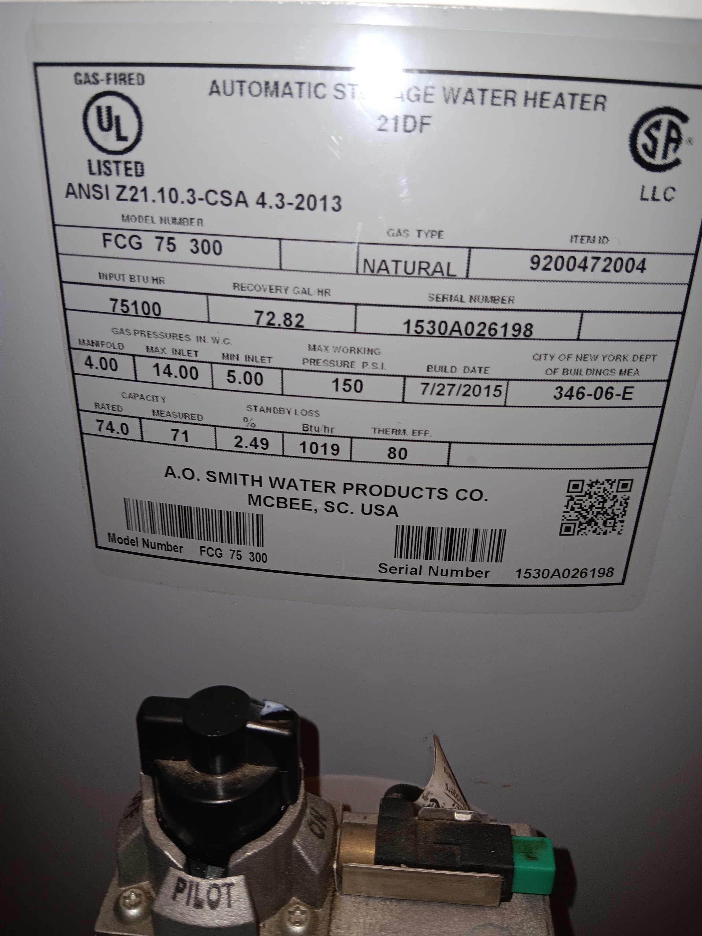

My water heater would not kick in to reheat the water automatically. See attached picture.
I have to manually set the temperature knob to "A" or "B" to trigger the water heater to heating again. I've been manually "turn on" the water heater every night for the past 2 weeks. Any idea how to fix? Thank you.

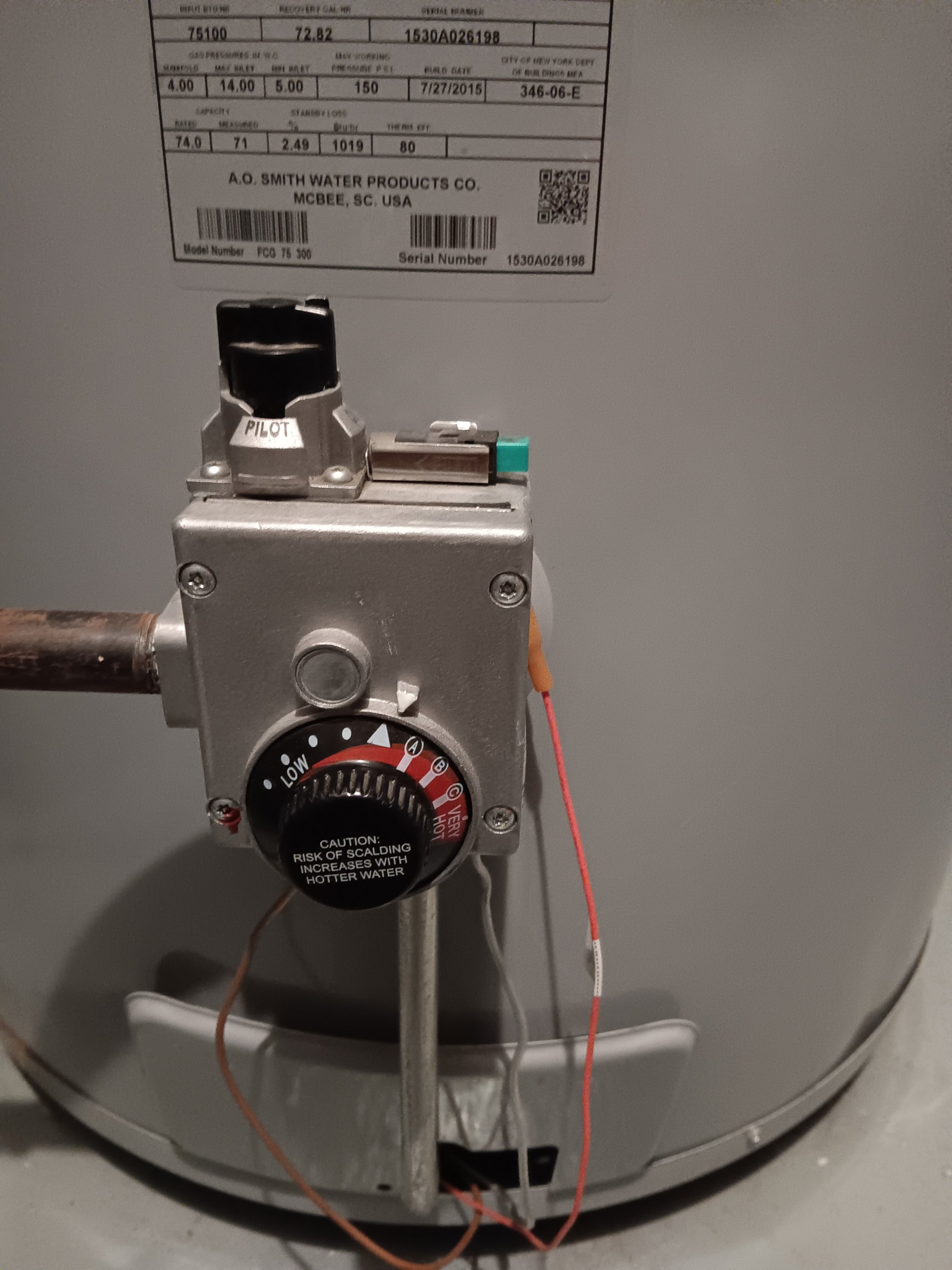

    Can you send a picture of the gadget with A and B settings? Is there an aquastat other than that invollved?
  • See attached picture. I don't know what is an aquastat, and I don't think there is such a device here.
  • Hi, Modern controls can have a thirty degree deadband, or space between on and off points. I'd just turn the knob slowly hotter until you hear and feel it click on. Then, live with it a bit and see if it reheats by itself.

    Gas fired WH control read temperature near the bottom of the tank. So if it shuts off at 125, the top of the tank will be a bit hotter due to stratification. Unless it is constantly circulated with a recirc.
    Cold should enter the tank at the bottom, when the control sees the cut in temperature it will fire. But you may still have warm water being pushed out.
    If it runs hot for a few seconds and turns cold it could be a failed dip tube.
    Since there are no temperature numbers, you will have to test with a thermometer.
    Although controls used to have temperature numbers, I think they got removed and replaced with letters for liability reasons?.
    Bottom line, if you are measuring at the faucet, the initial water from the tank may be 125 and the bottom of the tank is lower, maybe 105. As @ Larry mentioned there is at least a 30° difference from where it turns off, then back on.
    A small possibility the control is bad.

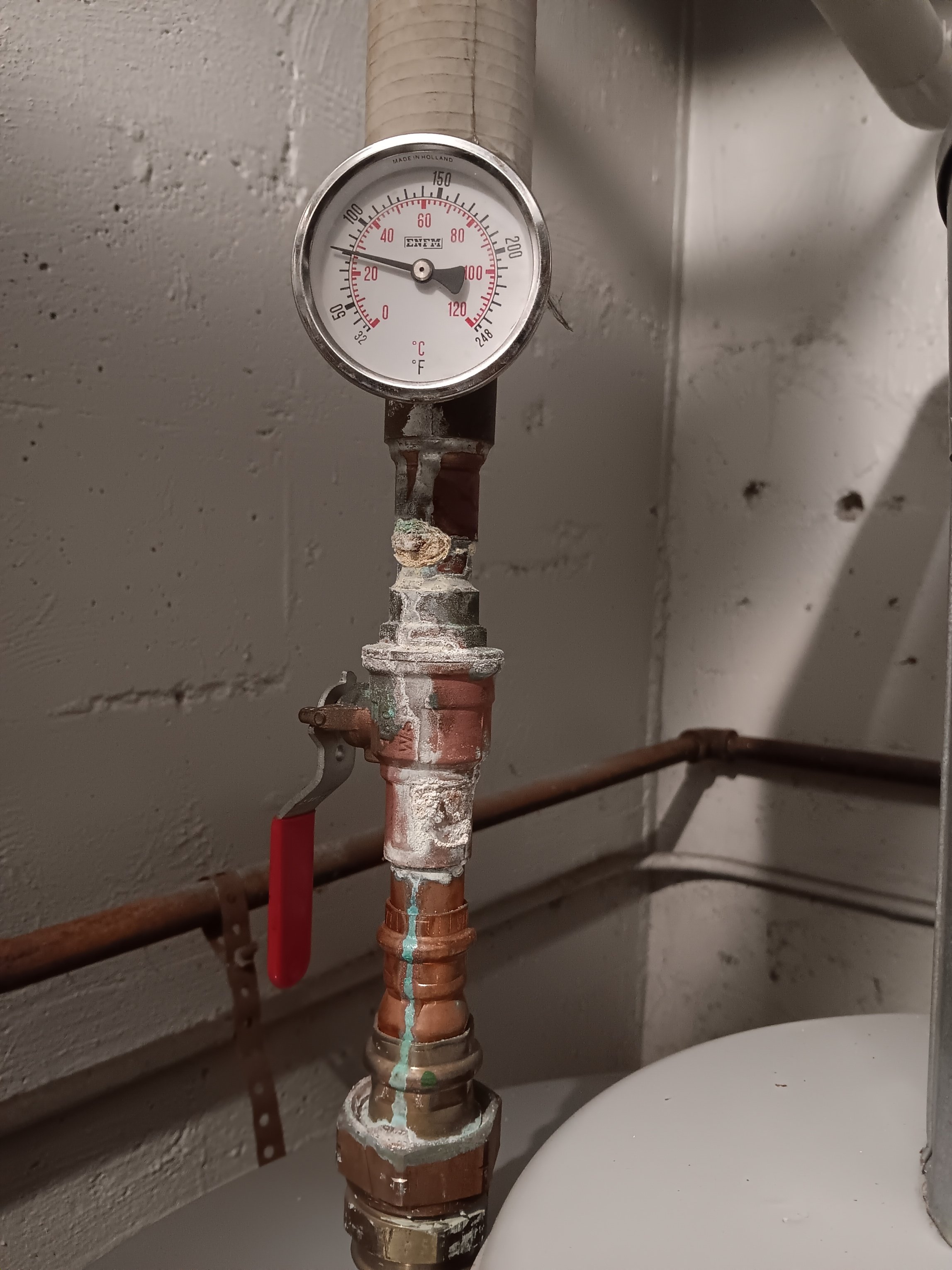

    I didn't measure the temperature, i just read the thermostat at the hot water out:
    Untitled Image
    So far, my experience has been the thermostat at the hot water out feels pretty accurate.
