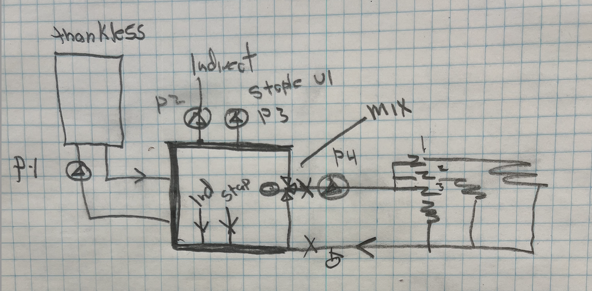

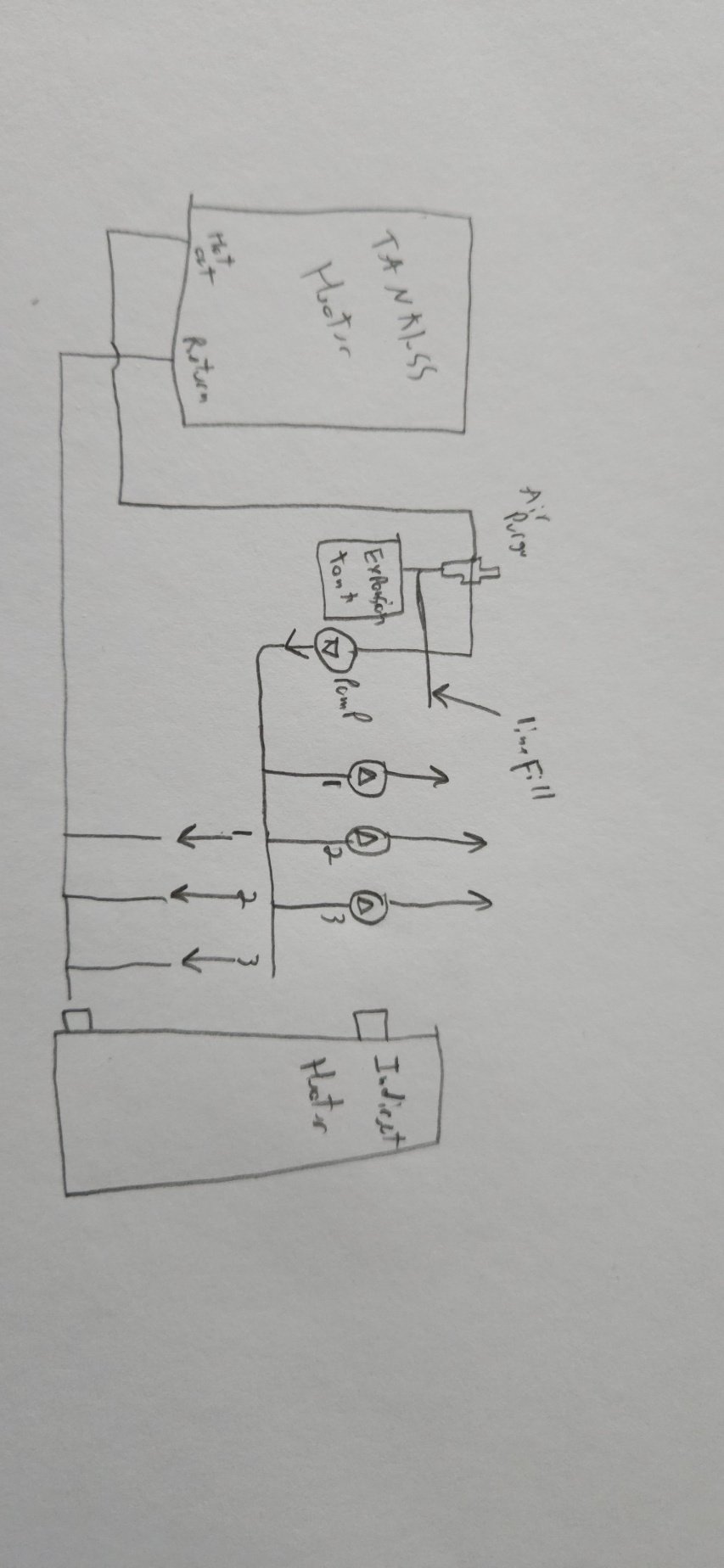

    Possibly you can force it to work with a primary secondary piping, like this.
    The manual should tell you how many gpm you need to pump through the heater to get full output. Some manuals show a pressure drop curve for flow rate sizing.
    Somehow you will need to run up around 180 to get an indirect to perform to it rating, not all tankless go that high. If the one you have oly goes to 140F,the indirect performance will be low. Possibly the indirect manual shows various input temperatures?
    Basically the boiler pumps into a loop, the loads pull off the loop. The heater may need a high head circ to get full output.
    This would be a two temperature system, high for the indirect and staple up, a 120 degree from a 3 port mix valve for the radiant zones.
    You need more info for pipe, pump and mix valve sizing. Don't fire the parts cannon until you do some math.
    How many gpm to the indirect?
    How many gpm for the staple up? What supply temperature
    How many gpm for the radiant, what supply temperature for the radiant?
    A small mod con boiler would have most of the controls and flow capability to pull this off.
    One primary secondary piping option.

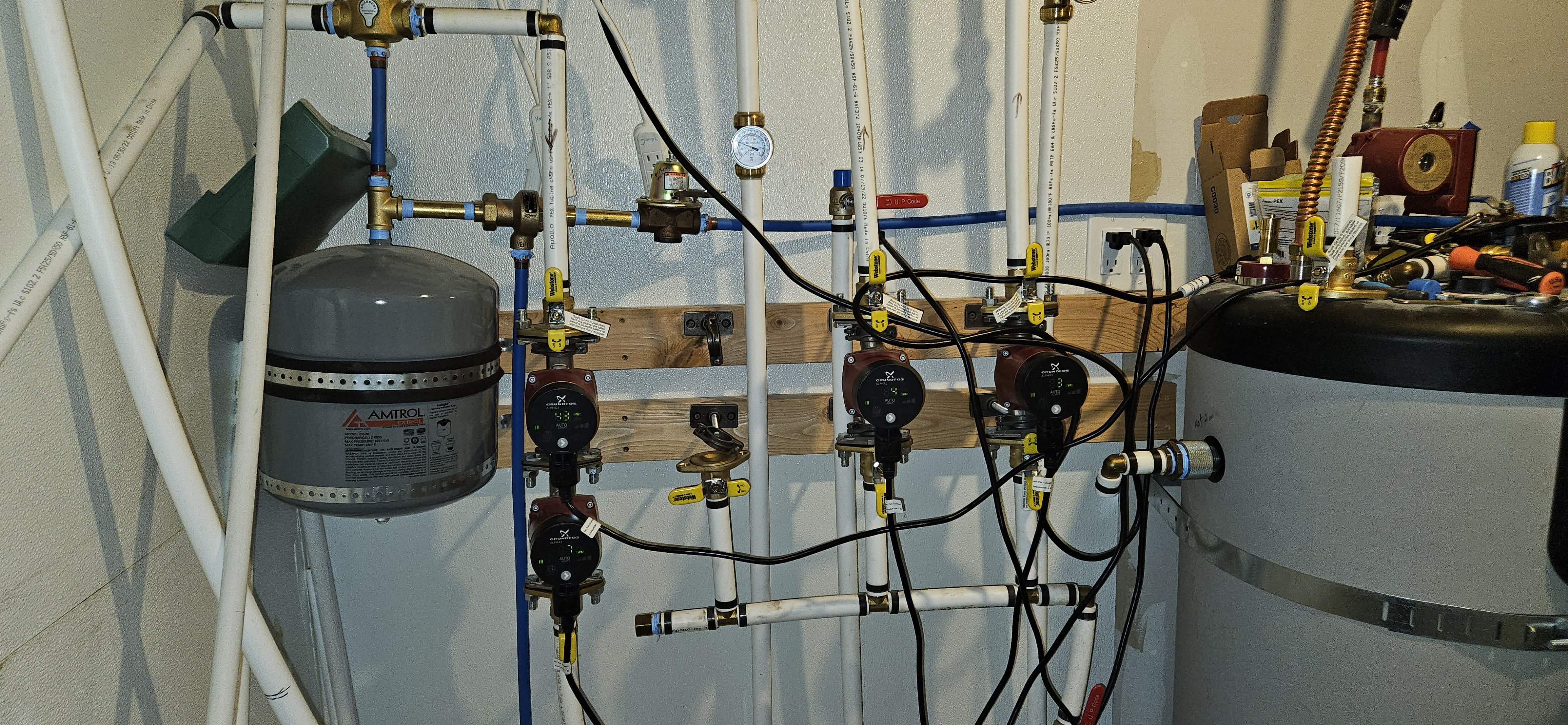

    Sorry for the confusion in my wording. Zone 2 and 3 turn on/off with a thermostat, and are functional.
    I assumed that the hotter and faster I push water through these slabs the hotter the return water would be, so the less fuel spent heating the water back up to the 140 degrees. That did not work. the concrete seemed to absorbed more of the heat from the water and I still burnt a ton of fuel heating it. Low flow at 120 degrees through the tankless still heated the garage to 64 degrees but cost way less compared to high flow and 140 degrees to maintain 64 degrees in the garage.
    I experimented by taking running 2 pumps feeding the zone pumps. I disconnected the indirect I thought it was consuming to much fuel to heat up.
    Can we return the slab water through the indirect?
    2 pumps on the left are pulling from the tankless feeding the zone pumps. Pump on the right is pump for basement, then pump for garage, then the extra pump (I took and hooked to the main pump)
    I DO have a taco switching relay I normally run these on
    The manifold in this picture is getting 6gpm ONLY with the zone 2 pump shut off. About .75 gpm each loop. With zone 2 pump running at the same as zone 3 some manifold loops don't read any flow

    Looks like a recirc pump on the indirect. If so that recirc loop is another heating loop using fuel and tankless output.

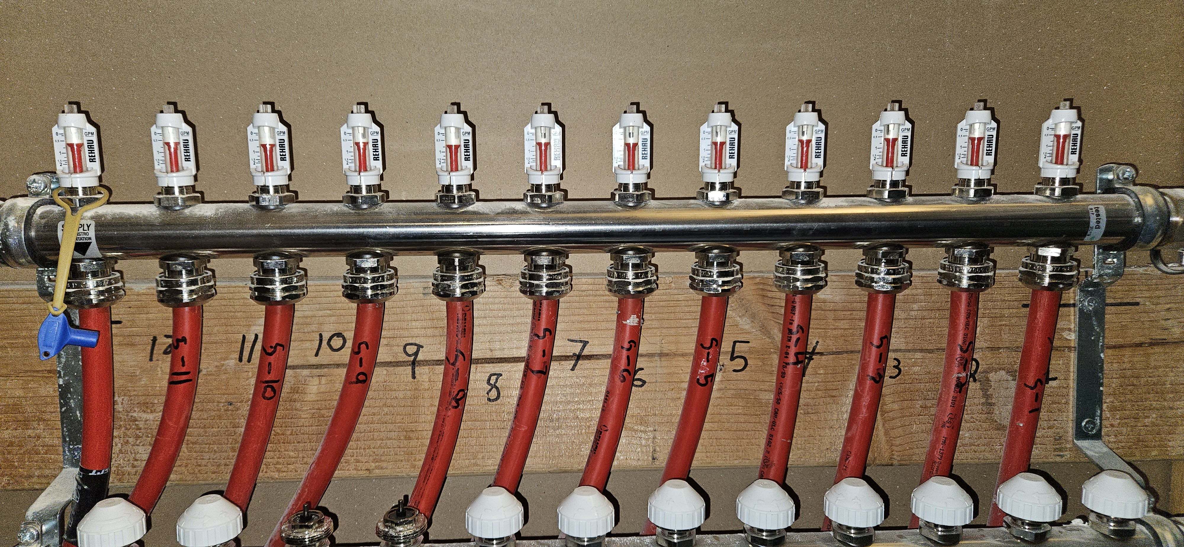

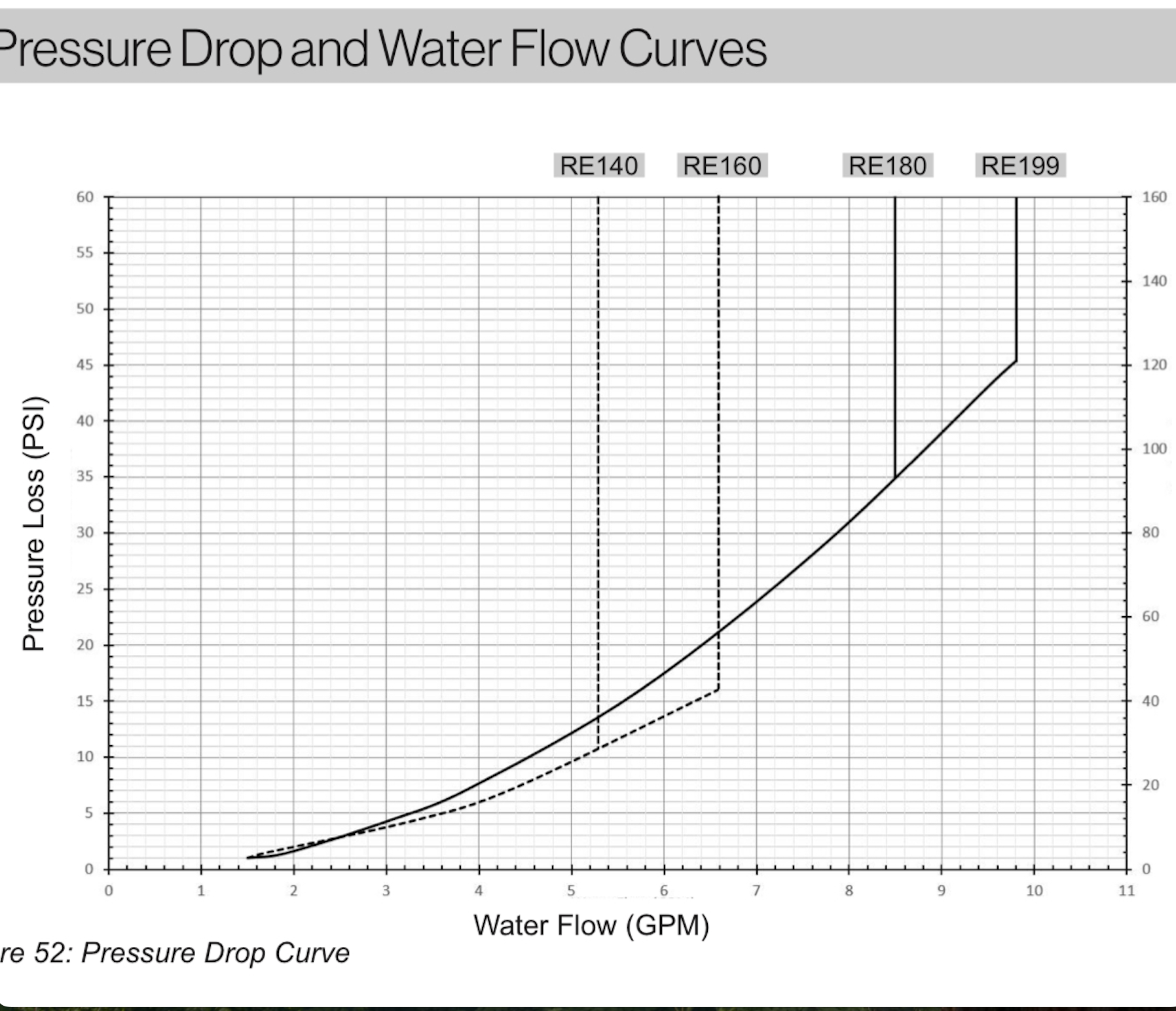

    12 loops at .5 gpm per loop, (typical for 1/2" pex) you need 6 gpm just for that manifold.
    1" pex is good for around 7 gpm so the pex header at the pumps just covers that 12 loop manifold. Not much capacity for any other zones.
    That pex header size needs to be able to handle the total gpm of all zones running, if that is what you want?
    If you need the full 162,000 the boiler can put out, and if you can pump it to get that, then you want at least a 1-1/4" headed for 16 gpm. Does the building have a 162,000 load?.
    Here is the pressure drop curve for the various sizes. 8 gpm through a 180 is 30 psi pressure drop. That will take a sizable circulator to get the heat out, which is why you need a primary loop with a dedicated heater pump, probably a Grundfos 26-99. And you still may not get the full heater 162,000 output.

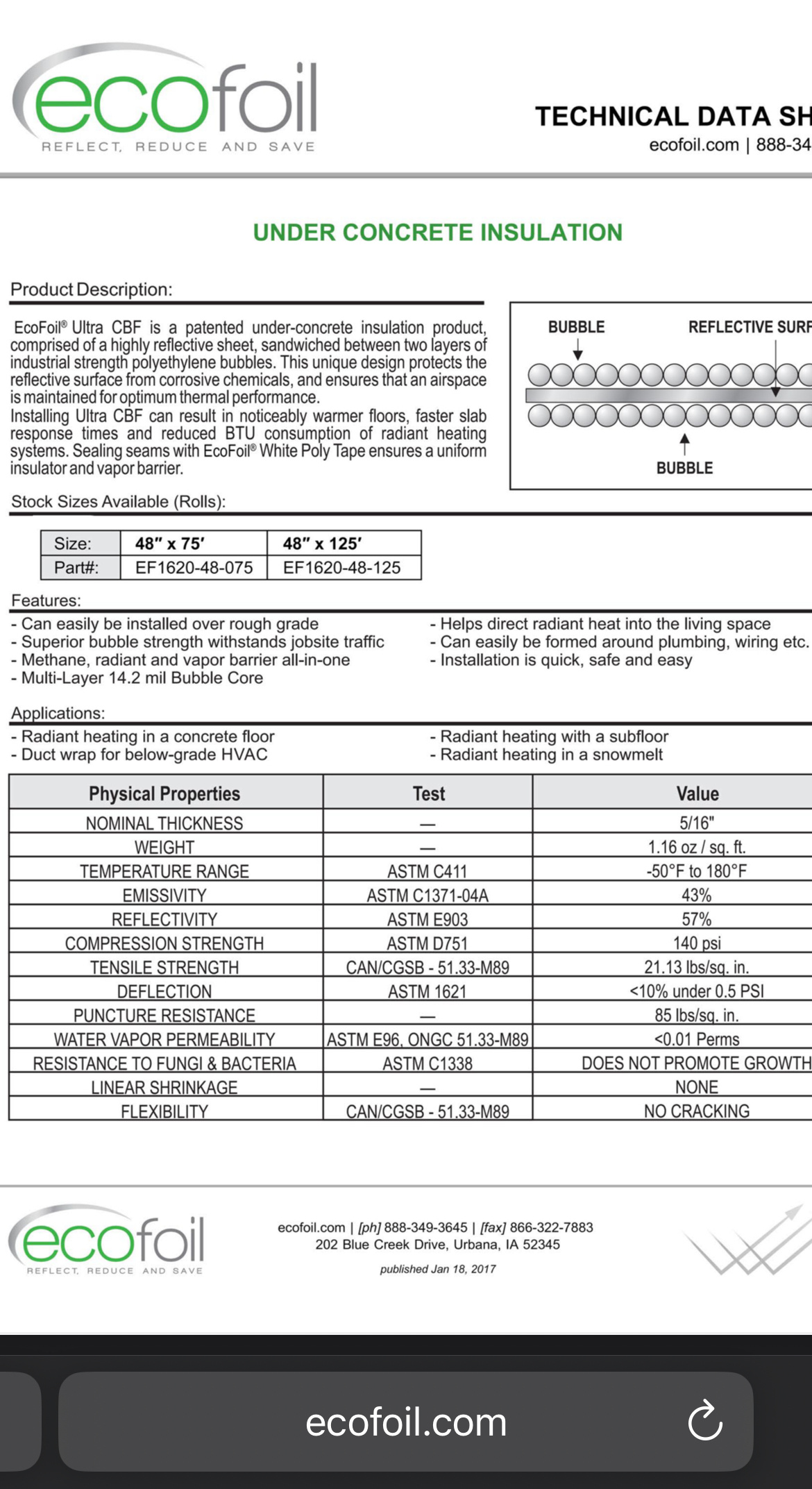

    in their video they claim it is 1/4”, their spec sheet shows 5/16”?
    But no R value listed
    Foam is typically R-5 per inch
    So that small R value allows heat from the slab to go down into the earth
    If the tube is at the bottom of the 5” slab, that hurts you also

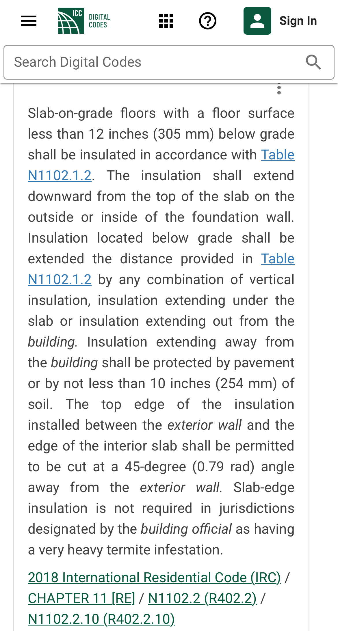

    Check the mechanical code book for your area to see what is required to meet code
    The drawing I attached above shows the tankless loop with big pump, then the Alphas will work for the zones, with those 200’ loops
  • R5 is required under heated slabs
    Have you guys never used that foil before? Is their claims all bs?
    I'm not fallowing your drawing to well, I don't see the garage circuit which is zone 2, zone 3 (basement) using a mixing?
    We can definitely ommit the indirect heater
    What diameter do we use for the loops? You have the big pump feeding the tankless?
    What temp water are we expecting to use?

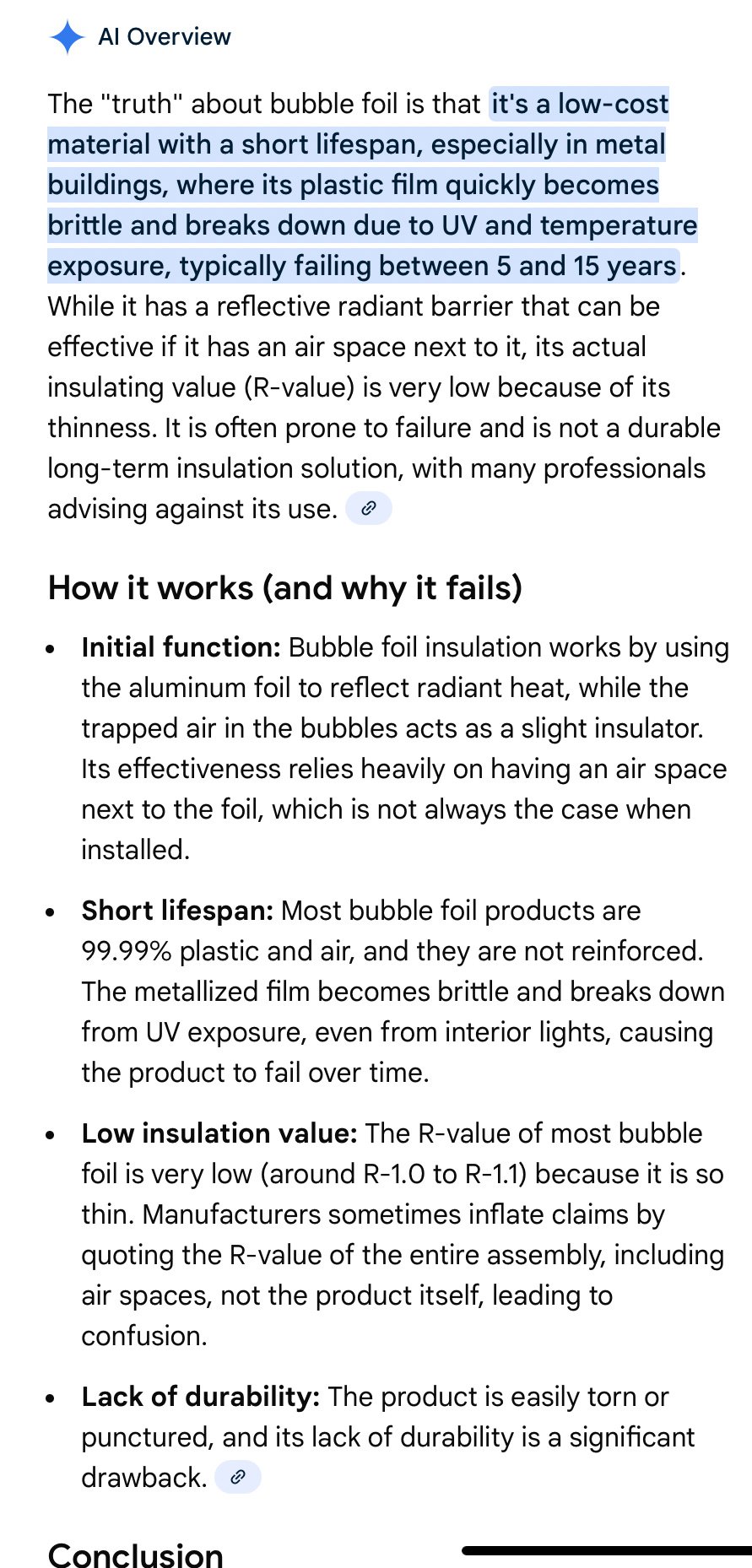

    If they cannot provide a tested, certified R-value?.
    Even AI has the correct opinion
    https://www.legalett.ca/FPSF-Radiant-Floor-Heating-PDFs/Radiant-Mythology-22-Myths-About-Radiant-Floor-Heating-and-Cooling-brought-to-you-by-Legalett.pdf
    You have options to improve the distribution piping layout, the slab insulation will not be an easy fix.
    If there is a code requirement in that area, either mechanical code or State energy code, I’d be having a chat with the builder and radiant installer.
  • Yeah, the bubble wrap is a scam.
    Still air is about R-4 per inch, anything that relies on trapped air for insulation is going to be about that. Most materials are lower R-value than air so the combined assembly is slightly less.
    Some closed-cell foams use a gas other than air to fill the space and are able to get higher R-values. Polyiso foam and closed-cell spray foam are both R-6 per inch. But as the foams age the gas leaks out and the R-value drops.

    The foil is BS yes. if thats all you have for insulation there is your answer, you don't have any insulation and the heat from your slab is going to transfer more easily to the coldest area, which is down to the ground.
    Would be curious what a load calc for your house looked like before construction began? That way we know how much over your load you are using. it's hard to tell from afar, some people use a ton of fuel. I figure you are using about 2 times (maybe even more than that) the btu/hr my house would be at design day conditions if that 200 gallons number is accurate . i have a 2500 sqft house in northern michigan
    some highlights from the linked study
    "Via email, Dr. Straube informed us that his results were showing Ultra CBF rFOIL with an R-value of approximately R-2 and that, because preliminary results were not looking favorable, Covertech ended this study prematurely before more accurate results could be determined." Manufacturer ended the independent test because the product does not perform well
    "The insulating value of this type of product varies depending on what other insulation it is combined with and where it is installed on the slab. At best, its insulating value was only slightly better than two layers of bubble wrap without the reflective foil layer, or a maximum possible R-value of 1.5 to 2.0. This maximum is unlikely to be achieved in an under-slab application and impossible if the air gaps are not maintained." Max R1.5-2 if installed perfectly
    " The least effective application of a bubble-foil-bubble insulation from an energy standpoint is an installation under the full slab area on top of R-10insulation. In this case, heat loss from the slab may be increased by as much as10% due to the thermal bridge effect of the aluminum foil, as illustrated in Figure 2. In other words, the R-value of the slab insulation system would be decreased by the addition of the bubble foil-bubble insulation" The product will actually decrease the effectiveness of regular R-10 insulation by 10%

    Will you draw up a clearer schematic with sizing and only the 2 heating zone pumps
    Zone garage @ 4gpm
    Zone basement @ 7 gpm
    1 loop feeding boiler
    1 loop feeding zone pumps

    "The garage is only concrete floor heated and it's not negotiable it has to be heated. radiant heat let's my tooling and cnc mills not rust because of condensation."
    The only kind of heating that won't keep humidity down would be an unvented gas burner, which I wouldn't recommend either.
    It's going to be cheaper to put in a different heating system than replace that slab.
  • 1200 square feet is fairly accurate. I thought the basement slab was little more than 1900 sq/ft the 200' loops is what I recall the builder saying . I didn't get a schematic of the layout,only pictures I took during the build
    If you guys didn't mention the insulation is inadequate I wouldn't have known. This tankless heater absolutely will keep both the basement and the garage heated. it's only $$$$$
    I was thinking I have a flow issue, maybe closely spaced T or mixing valve that could help lessen the fuel consumption.
    What should I expect the builder to do? Empty all the stuff out, cut out both slabs, new insulation, new loops, new concrete, then move everything back in?

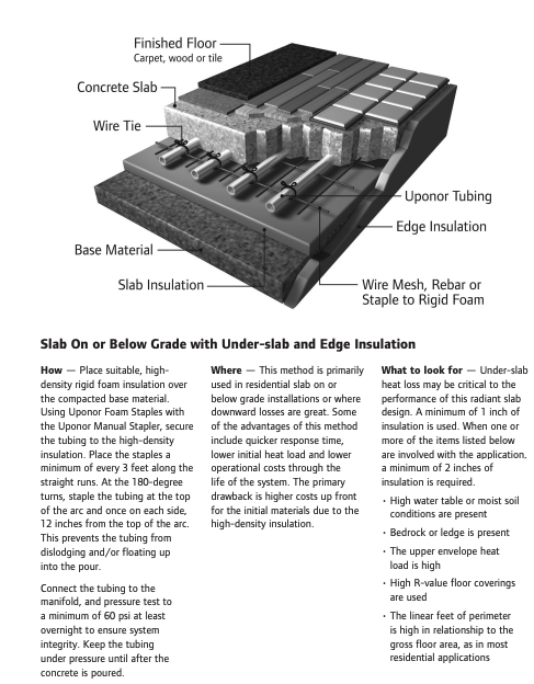

    Also from this Uponor design manual their slab on grade method.\

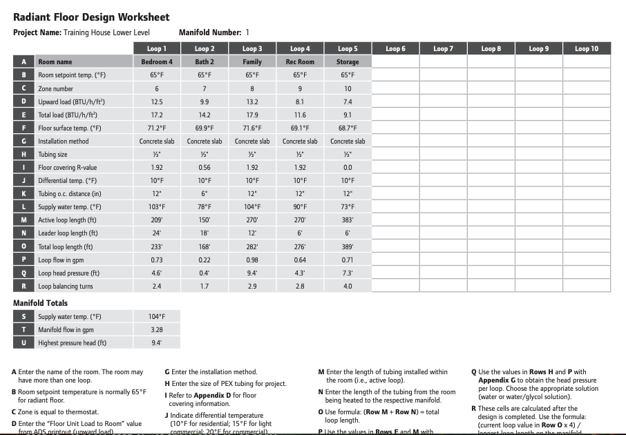

    Read through this manual to learn the terminology and proper design and installation steps.
    https://blog.twinsprings.com/wp-content/uploads/2013/05/Uponor-Radiant-Heating-and-Cooling-Design-Assistance-Manual-Part-1.pdf
