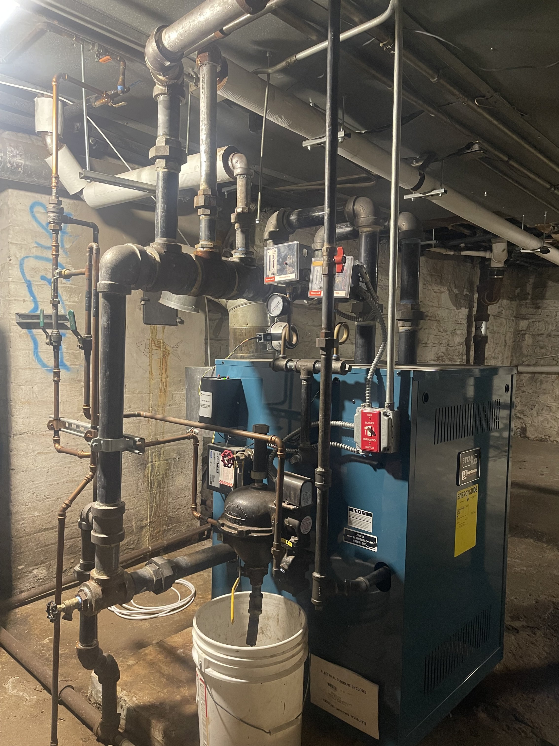

It has been years since I installed this other brand of steam boiler (I use their other products, including in my shop), and I was very disappointed in the quality of this classic that is still prevalent in NYC.
First, the bottom metal/insulation panels and channels have a burr that will slice your hand if you are not wearing gloves. Common sense would say to have someone spend a few seconds getting rid of the sharp edges, just like we do in the field when cutting strut.
Second, I thought I was losing it for a minute until I realized that the rating sticker was applied upside down. That doesn't look good when I am the one who specified the boiler. Now I have to return with a heat gun and hope it comes out clean in order to have the rating sticker right side up for inspection.
Third, the terminals on the fan center relay are too loose, and they fall of from their own weight. I squeezed them a bit tighter, but they are still loose. I think I will have to cut them off and replace them to avoid a callback.
I am renewing my loyalty to Burnham now :)
