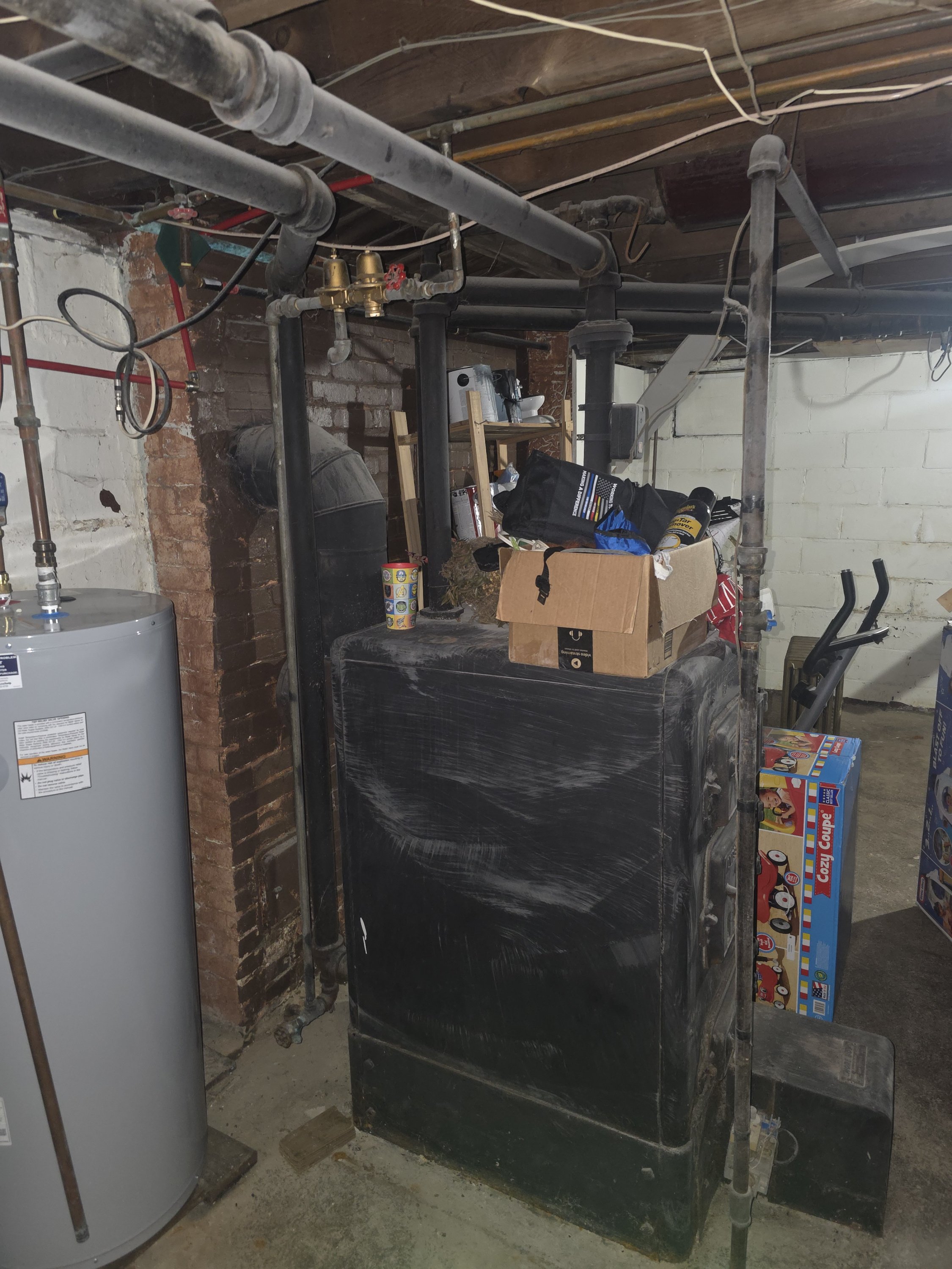

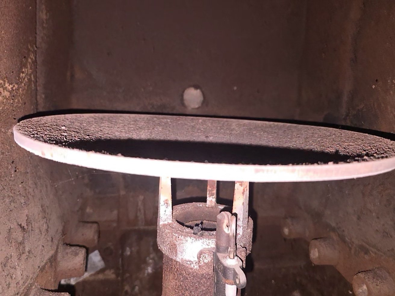

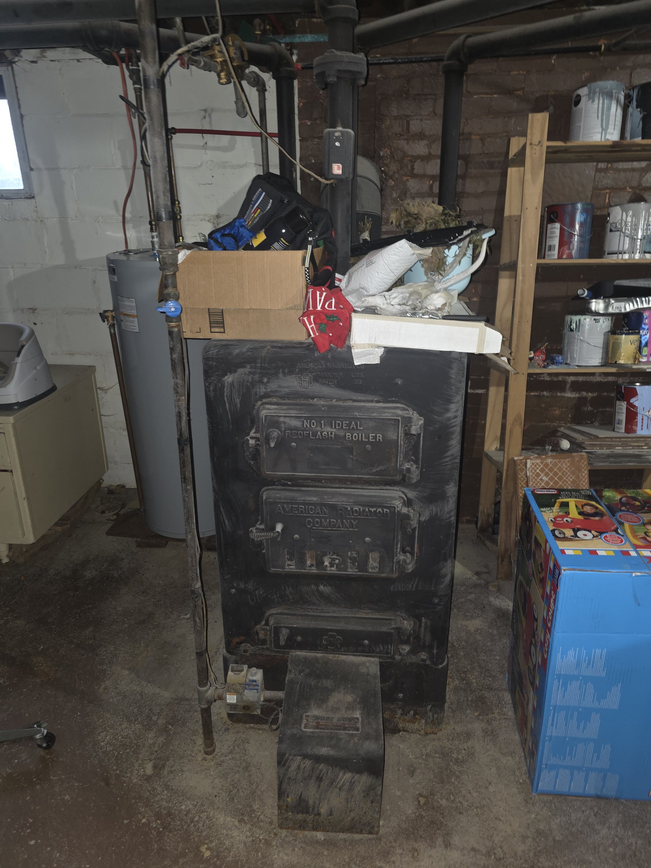

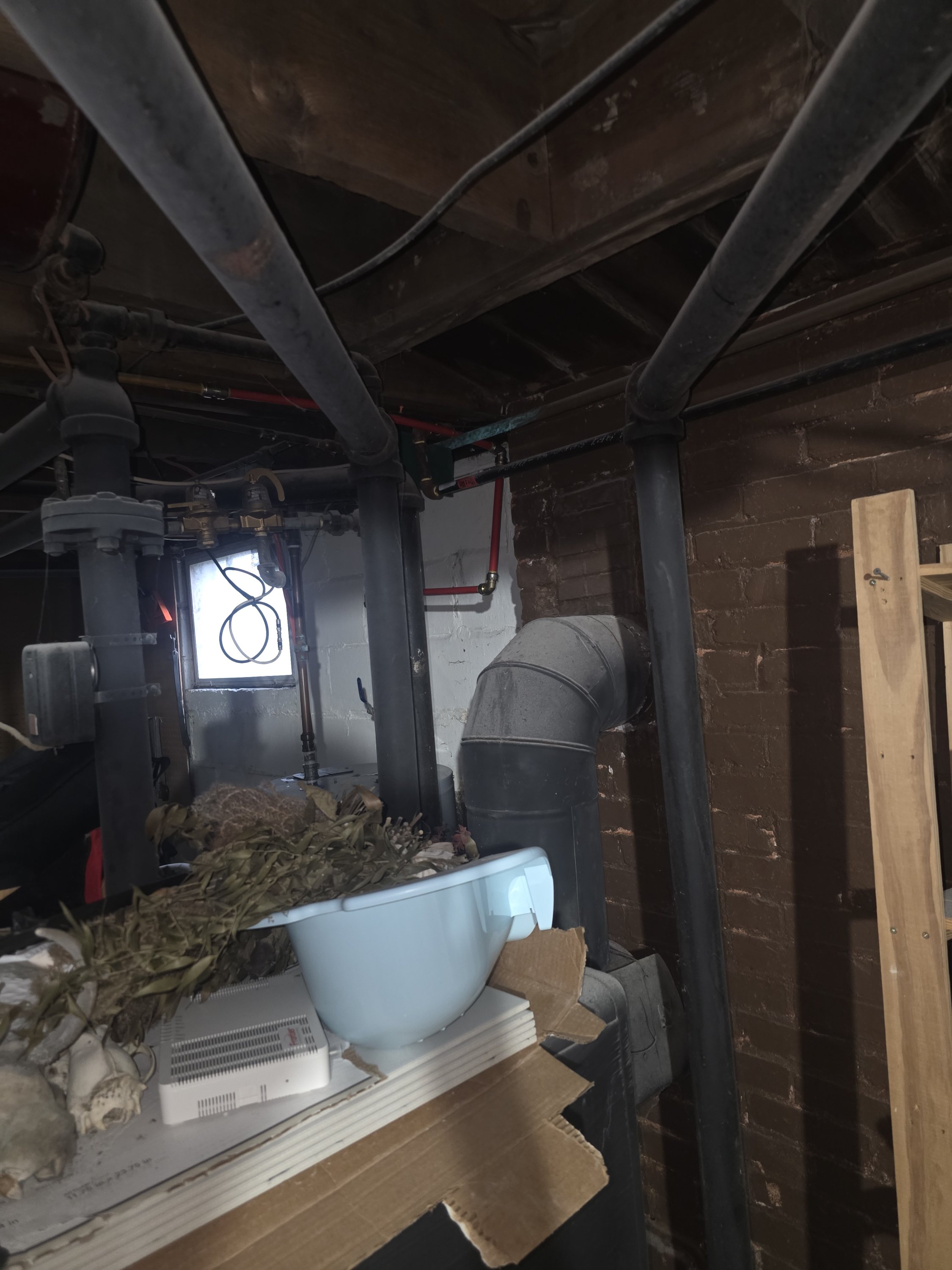

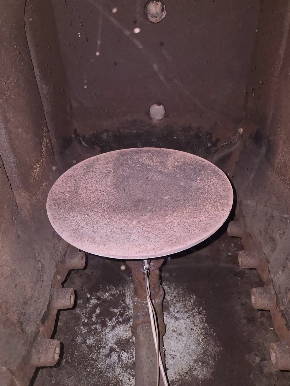

Thinking about re setting up my gas boiler system for my radiator. I ran it for around a month when we first bought the house and the heat bill was almost 700. Been heating with gas fireplaces ever since. Would like to try and make it more efficient. I think the first place to start would be the burner. The burner pretty much looks like a blow torch end that shoots at plate to spread out. Would u have any recommendations on if possible to upgrade this system to start
    Eh? I think we need some pictures of this setup, and the make and model of the coal stove (?) which you are trying to make into a boiler?

    Do you have an AVCO LYCOMING boiler?
    Steamhead Member Posts: 18,803
    That's a typical form of gas conversion burner. Your boiler was originally coal-fired. It has large flue passageways that let a lot of heat go up the chimney.

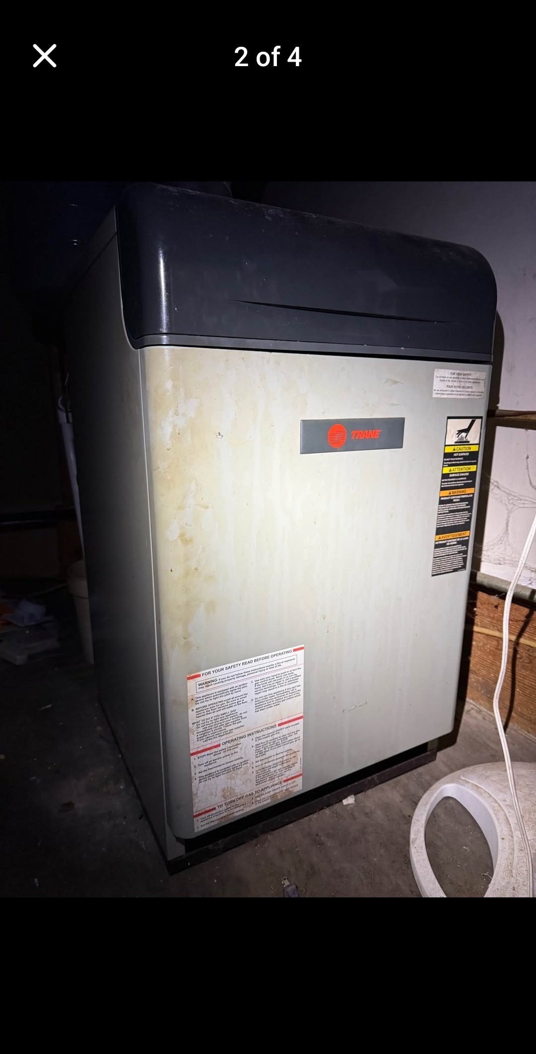

    BBeckley Wv. I have someone offering me this could I use it to replace it
    mattmia2 Member Posts: 17,902
    someone has put a modern combination gas valve on it.

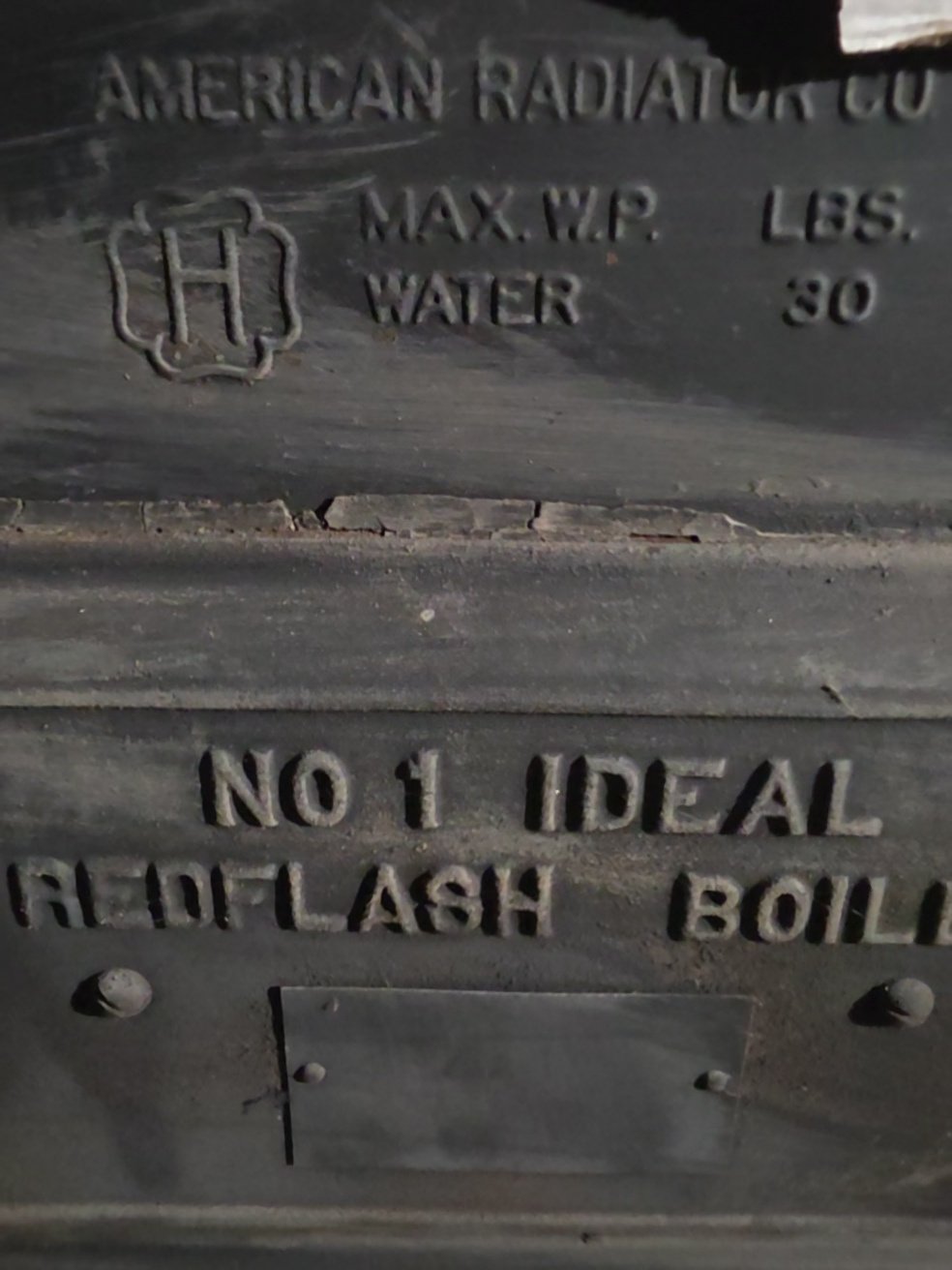

    You have an Ideal Red Flash boiler that used rocking coal grates, one of Mr. Holohans favorite boilers! They burned Bituminous coal in it to heat the home.
    As Mr. Holohan is fond of saying, "if all you get is water it aint an air problem".
    It is a hard pass on that Trane unit period as you have no idea what shape it is in.
    How many floors and how many radiators?

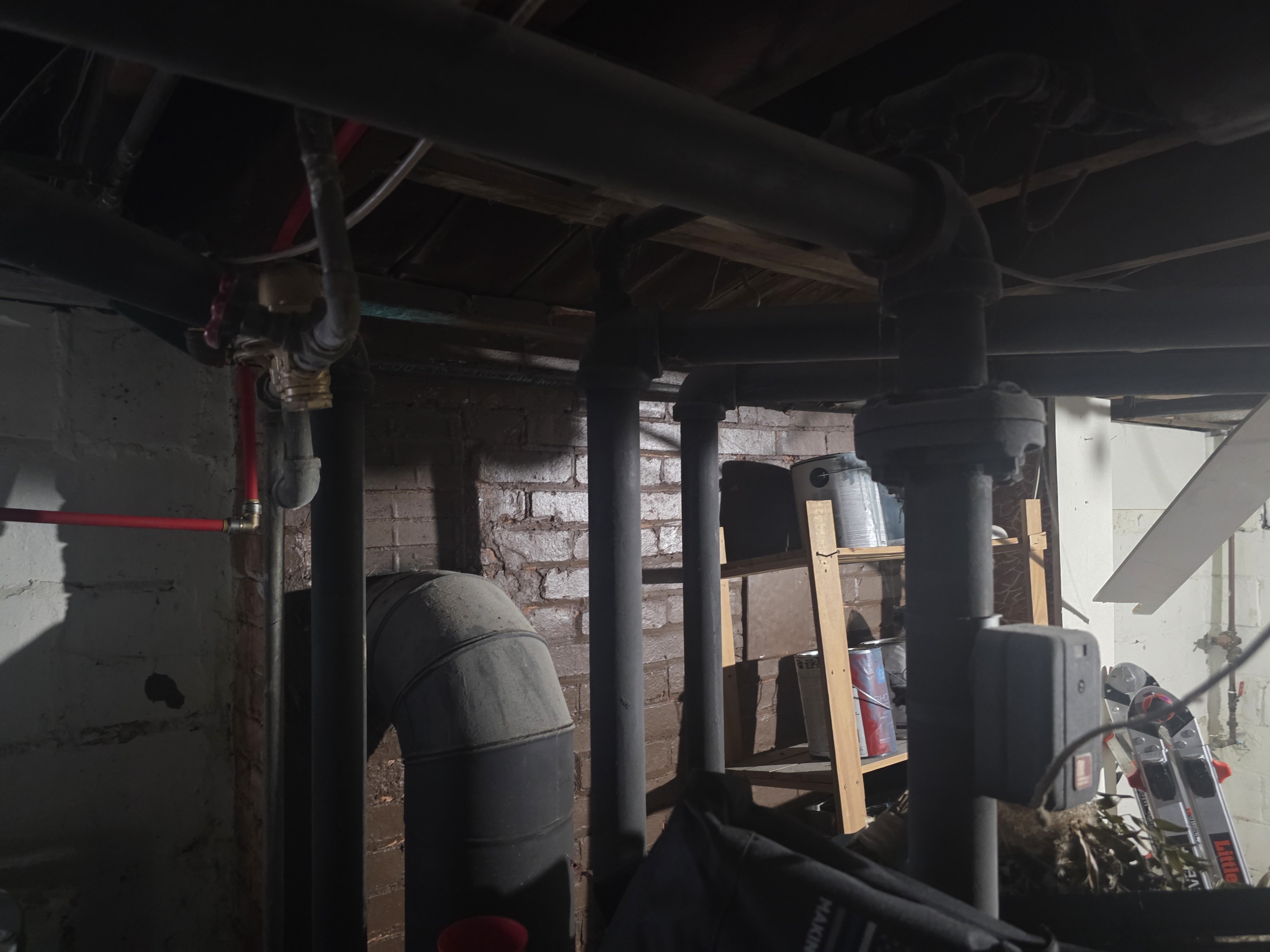

    If it is a true gravity fed system is it a top fed gravity hot water heating system with one riser and an open to air expansion tank in the attic or a bottom fed gravity system with two risers and an open to air expansion tank in the attic?

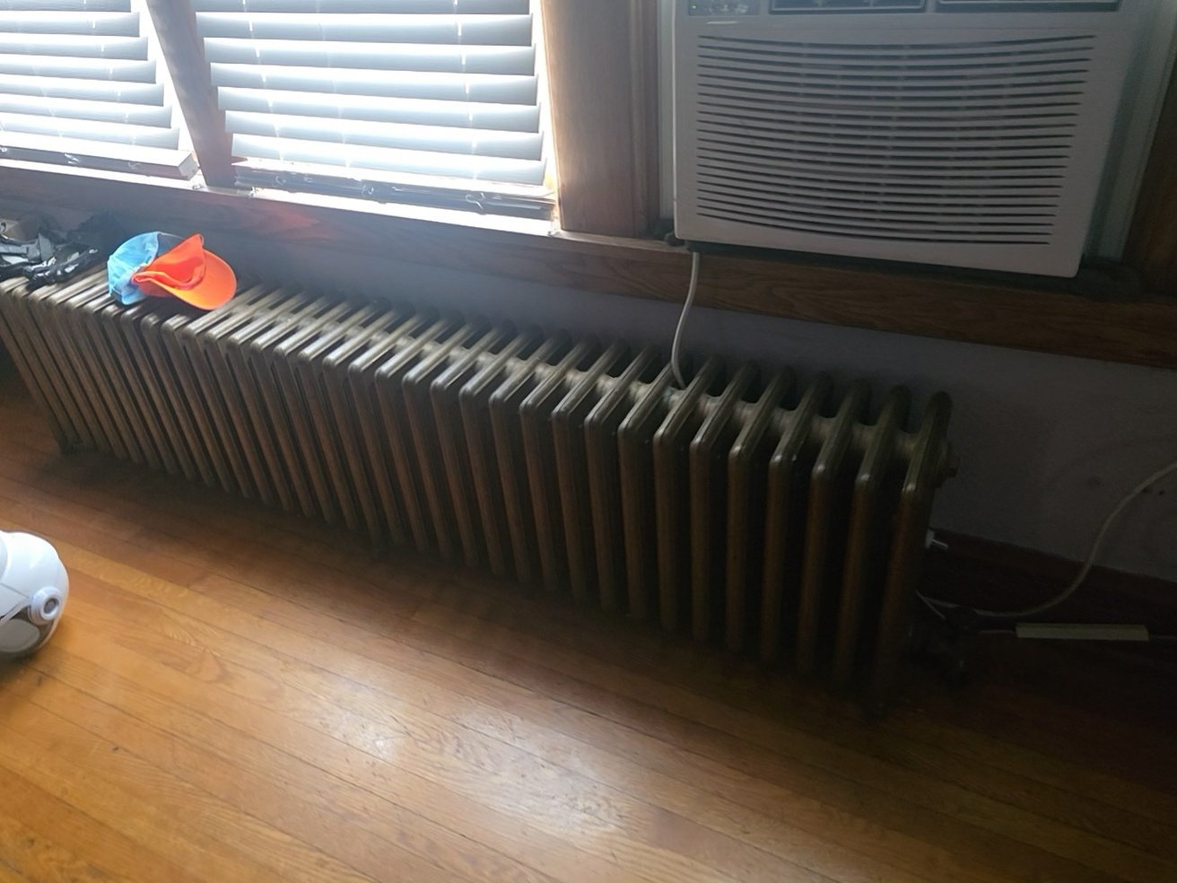

    Please measure the ALL the radiators so we can figure out what the total amount of radiation/emitters you have.

    I have 1 86in 3 that are 48, 3 that 36 and 1 that is 13. So 8 in total and its 2 story with 4 upstairs

    We need the width of the radiators and the height and the number tubes, I am sorry, I should have been more clear about the need to measure them.
    @Benjikittens , also post some radiator pics.

    11in wide 18in tall
    And they are 4 tubs off the boiler around 2 in

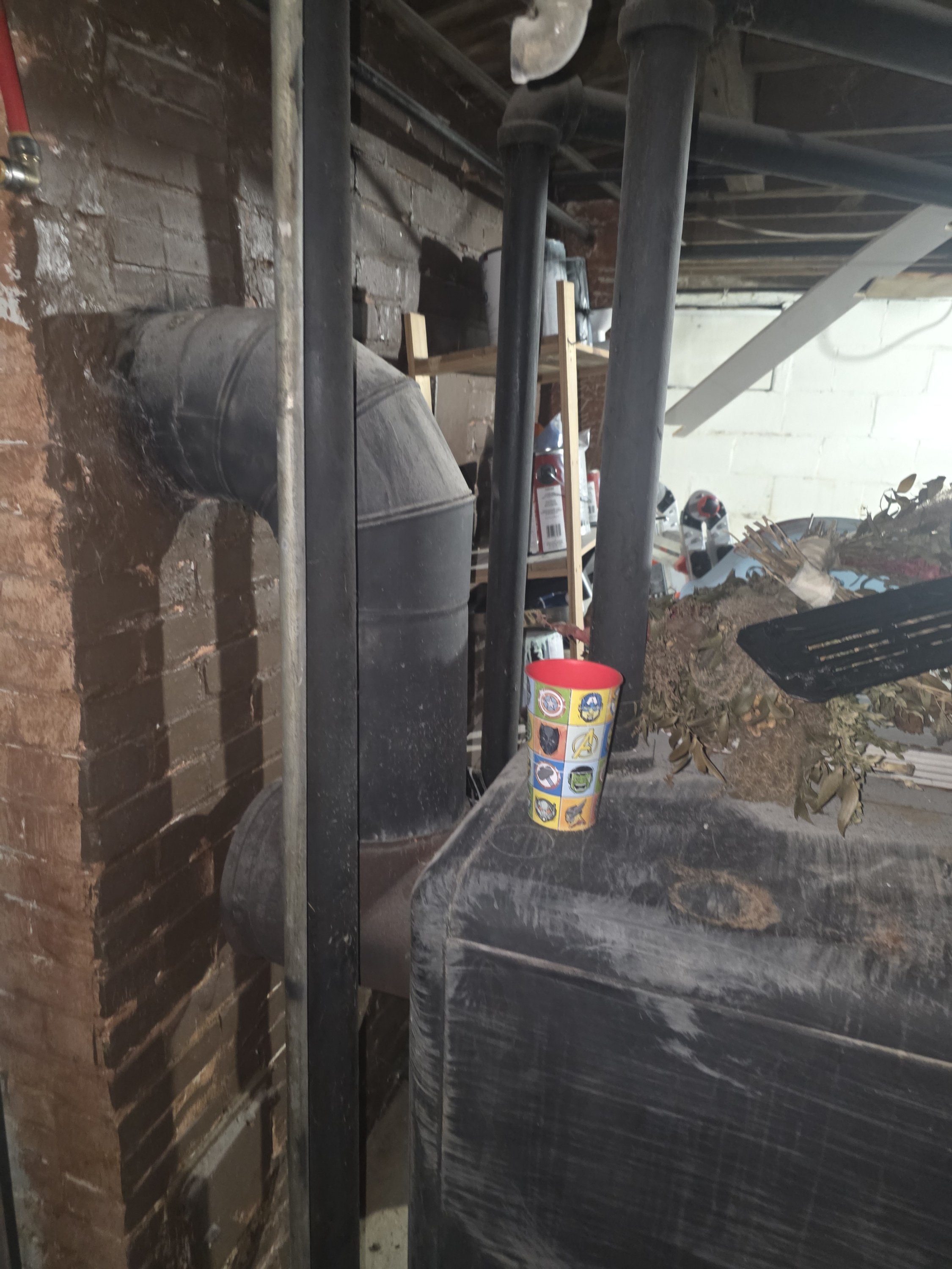

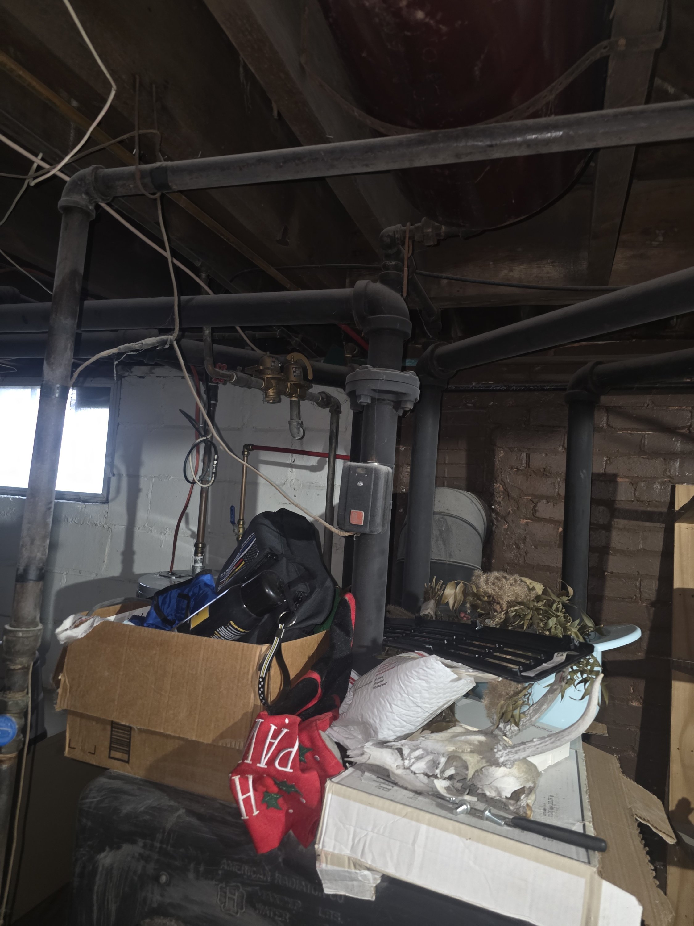

    Would you be so kind as to post more pictures of your boiler and the risers and return piping hung in the ceiling joists with better lighting? Doing this will help us to help you a great deal.
  • neilc
    neilc Member Posts: 3,201

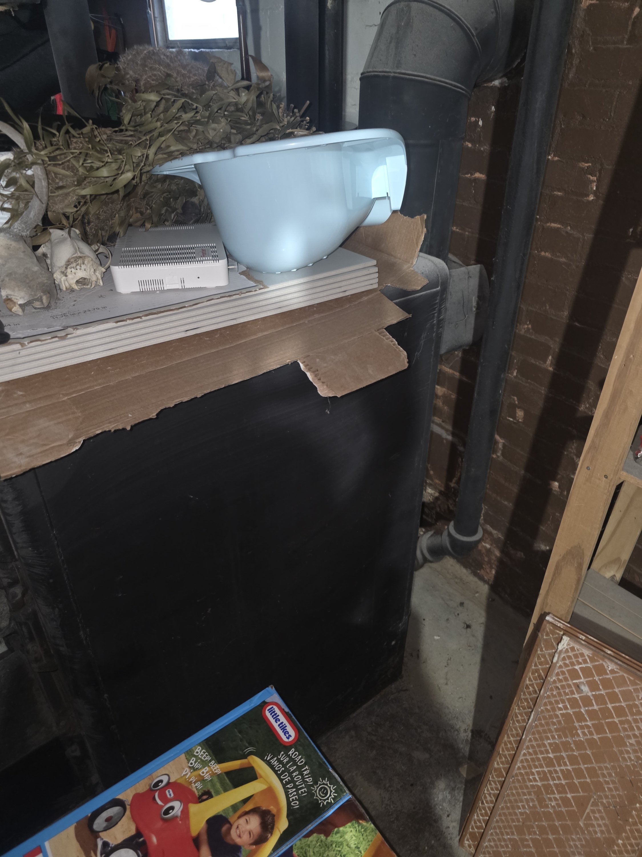

    clear the crap off the top of that boiler, and anything along side it also,

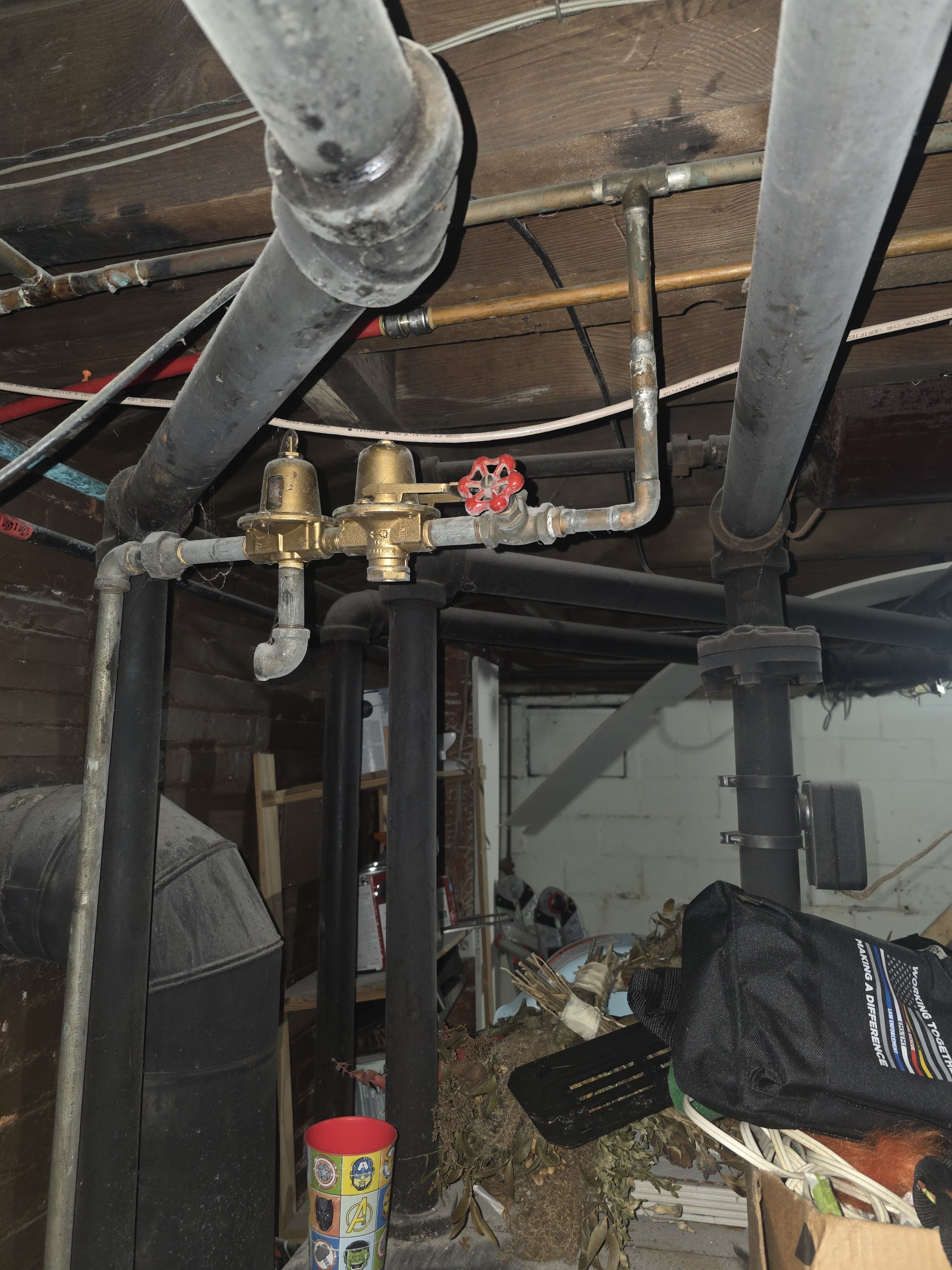

    You have a great deal of thermal mass in your existing boiler and your radiators. A gravity hot water heating system is very simple to own and operate because it depends strictly on convection. A new conversion gas burner will help with reducing your natural gas consumption.
    Your installer should make sure that the door gaskets for this redflash boiler are replaced to assure that the doors close tight and do not leak carbon monoxide.
    You have a compression tank hanging between ceiling joists in your basement which is used to create the point of no pressure change.

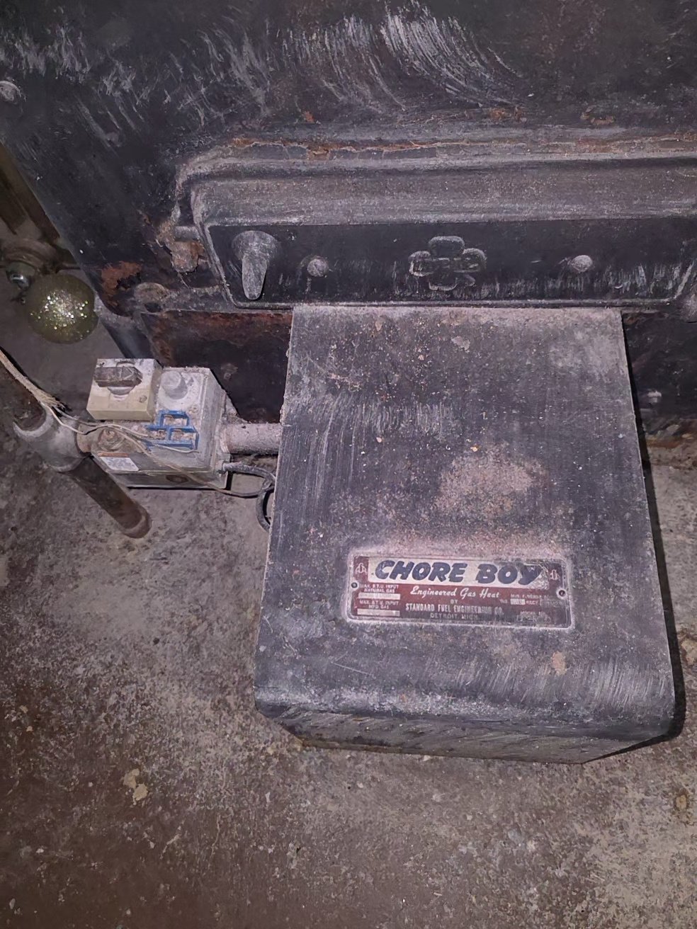

    The clamp on thermocouple-the black box in pictures 5 and 7 is what controls the boilers temperature for you and it will operate the gas burner for you turning the gas burner on and off as needed to heat your home. The wiring to the thermocouple and gas burner needs to be replaced as it appears to be cloth/woven and needs to be replaced.
    Do you have a round thermostat on the wall in the room above the boiler?
    It appears to me that they completely removed the ash pit door and cemented in a replacement metal plate to mount the conversion gas burner in your boiler.
    Please provide us with more images of the steel compression tank hanging in the ceiling joists above your boiler as we/I need to know if there are any valves at the opposite end of the steel compression tank to help you further.

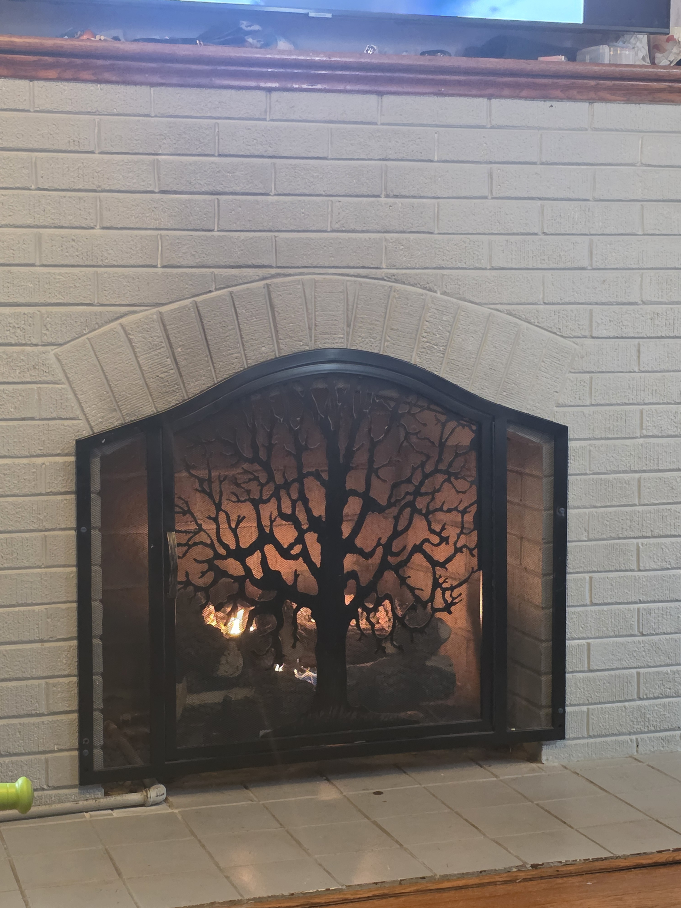

    What are these fireplaces like? Do you have a picture?
  • Benjikittens
    Benjikittens Member Posts: 42
    TThe Ither on is its own housing with a blower

    Those fire places are nice to look at and make reasonable space heaters at pretty high cost. The repair of your boiler wont be inexpensive but once it is complete I think you'll find it is less expensive to operate and far more comfortable. Again the cost of warming your house depends to a great deal how much of that comfortable heat you can keep in the house. And in the spaces you wish to heat. A gravity hot water system is very "adjustable" assuming the radiator valve are functional meaning you can open and close them to adjust the amount of heat you want in each space where there is a radiator.
