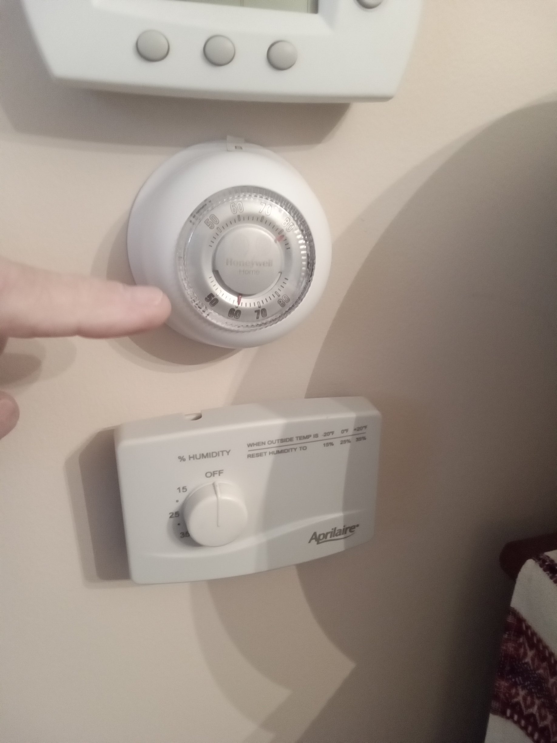

Every so often this thermostat fails to call for heat. I will turn it all the way up and nothing. No click ,nothing. I will pull the cover and put it back together and Bingo!
Is it a quality issue?

    Yup, That type of t-stat has always been tempermental.
  • Recommendation for a simple one?
    Thanks!
  • Honeywell T4 is a good simple digital thermostat for boilers. Highly recommend them. Just make sure to set the boiler to cycle once per hour for steam if that’s what you have

    I had one of those digital Honeywell round stats in my house. It worked well for a while, and it went fluky. Got rid of it for a Robert Shaw.

    Is that round Honeywell a mercury bulb type? If so is the anticipator inside adjusted?
    Those old mercury bulb stats were pretty troublefree.

  • No It is a "modern " thermostat. I do have a mercury type I the bedroom but the color is bronze!

    Sounds like a loose wire or printed circuit connection on your HW. If tampering with it allows it to work, something is loose?

  • Had one of those white round ones at our apartment, once the set point was met it went into some kind of short cycle prevention delay mode, so even if you turned it up again it wouldn't run for a given amount of time. Ticked me off. I stash the mercury ones. They do what you say. No schedules, batteries, Pentagon level passwords and secret codes. I'm old fashioned I know. Setting the anticipator works for me.
  • I have not had good luck with that digital stat. I've had them that would not work right out of the box, So, I would get a different one to put in.

  • So I think I found a solution. Last year I bought and installed a Tekmar thermostat and floor sensor. I did it jut to monitor the floor temperature. I think that now that I have a good idea of what floor temp I want I will switch over to it. Right now it is currently installed in the basement by the switching Relay. I did that for convenience.
    And yep we have 2 systems! I like redundancy!
    Like I posted above I agree with @rick in Alaska . I had one in my house it was fine at first. It did delay a bit then it got flakey and couldn't make it work so I tossed it. Got to be so it wasn't reliable and I was selling the place so it wasn't occupied and couldn't trust the stat

  • We have a F/A with A/C and I retrofitted our home about 16 years ago with staple up radiant floor heat. Thus the need for 2 thermostats. We use the F/A in the shoulder seasons.

  • That round thermostat has an undocumented, difficult to change, unusual battery in it.
    Probably needs a new battery.
