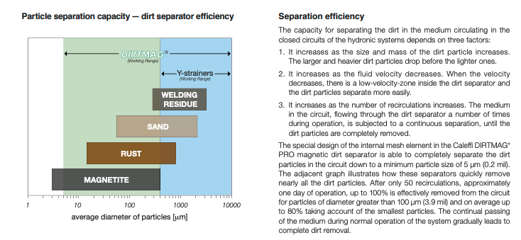

    hot_rod Member Posts: 27,904
    High efficiency boilers and ECM circs need some good particular protection. They are a couple steps beyond a basic Y strainer.
    A separator forces particles into the bell of the unit, to flush out. Whereas as Y strainers trap particles in the flow stream. Y strainers cannot grab the tiny magnetite particles.
    A mag separator does both particle, down to 5 micron, and magnetic particles .05 micron.
