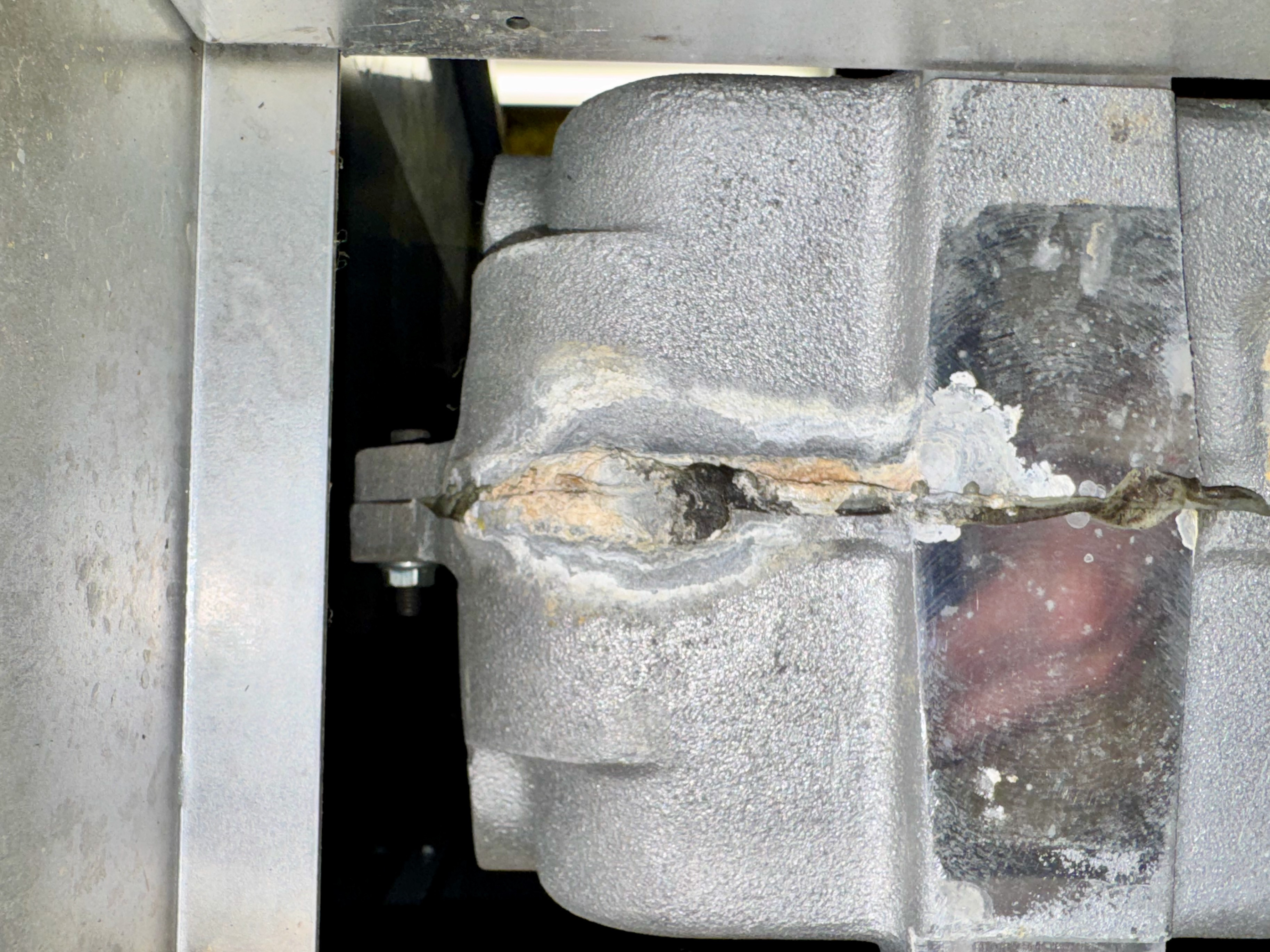

Backstory:
This boiler was installed in 2007 in a new construction home to support two baseboard hot water zones (first floor, second floor), and an indirect hot water zone supported by a Buderus S120 tank. The plumbing and heating contractor installed as a single loop with one circulator pump with three zone valves (not primary/secondary).
On Christmas Eve 2018, I woke up to a strange sound in the basement and upon inspection, discovered that the (cast aluminum) heat exchanger had sprung leak, spraying directly onto the draft inducer. After working with a local Lennox dealer and coming up with some very creative ways to re-route the growing leak while continuing to run the boiler, the heat exchanger was replaced as it was within the 15-year warranty and installed on January 9th.
Between that heat exchanger replacement and now, we've also replaced the draft inducer, multiple igniters, and the control board.
Fast forward to this year's heating season and as I was doing a once over, I noticed a small puddle of dried crusty water under the boiler. When I poked my head up inside, I found that there is a slow leak at the gasket seal (see photo — this is looking directly up from under the heat exchanger).
I had a Lennox-authorized service tech take a look and his reaction was that we won't last the heating season and need to replace the heat exchanger/boiler. When I contacted Lennox directly, they stated that while the replaced heat exchanger is < 7 years old, the warranty coverage is based on the date of original installation.

    i think, without digging for the lennox manual, that in aluminum hx boilers, you have to maintain an inhibitor in the system to keep the aluminum from dissolving in the hot water.
    it is more what the installer knows vs a specific brand but lochinvar, viessman, htp, and a couple others make good boilers. Baseboard isn't really the right emitter to take advantage of the benefits of a mod con boiler. It will work but you are likely getting efficiency in the 80's because the output of baseboard is very low at the low water temps you need to get condensing.
    Well, you got 18 years out of it and that is all you're going to get out of a mod con although the hx was replaced.
    I don't think I would fix it at this point as it is likely that you would need other parts as it ages and most mod cons parts become scarce after 15-20 years.
    I would stay away from aluminum. Buderus/Bosh mod cons were/are aluminum

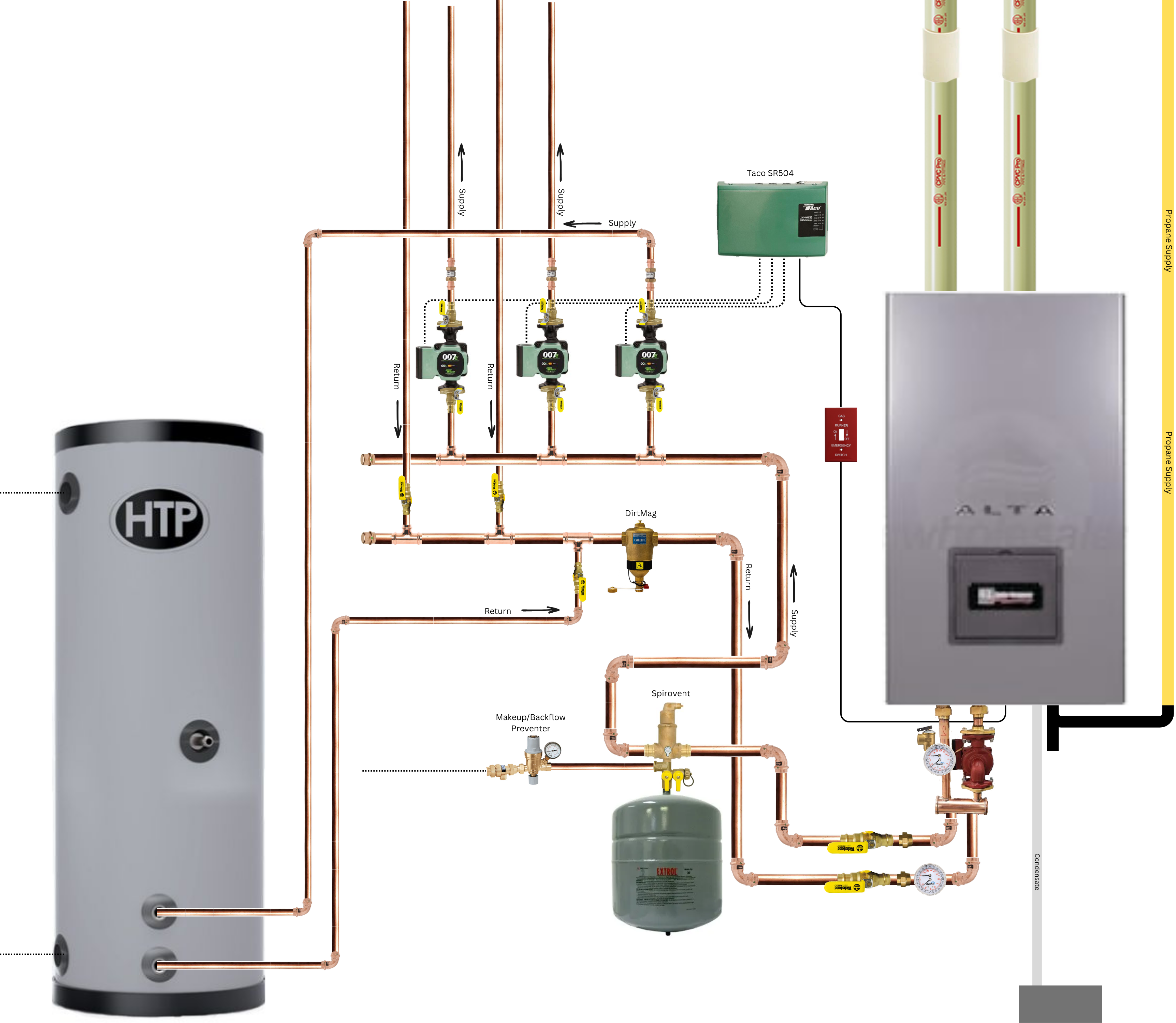

    I apologize if this isn't proper etiquette in the forum, but after reading more about primary/secondary loops and the US Boiler ALTA manual, I put together a drawing hoping to wrap my head around what a replacement of my current boiler setup would entail.
    Would you be able to help me understand if this looks generally correct?
    Note: The manifold beneath the boiler is a little oddly oriented in this image because it was the only thing I could find that would somewhat depict how it would get connected, but would rotate 90º
    The way you have it piped the boiler circulator would have to pump down from the boiler into the manifold

    Ed, this is the diagram from the I&O manual (note the rotated manifold/piping).
    Is there some nuance that I’m misunderstanding from the manufacturers drawing? My interpretation of what’s depicted is that the primary loop circulator is on the boiler return
    @steve_ no your ok. I apologize. It confused me for some reason
  • Ed, thanks for confirming
