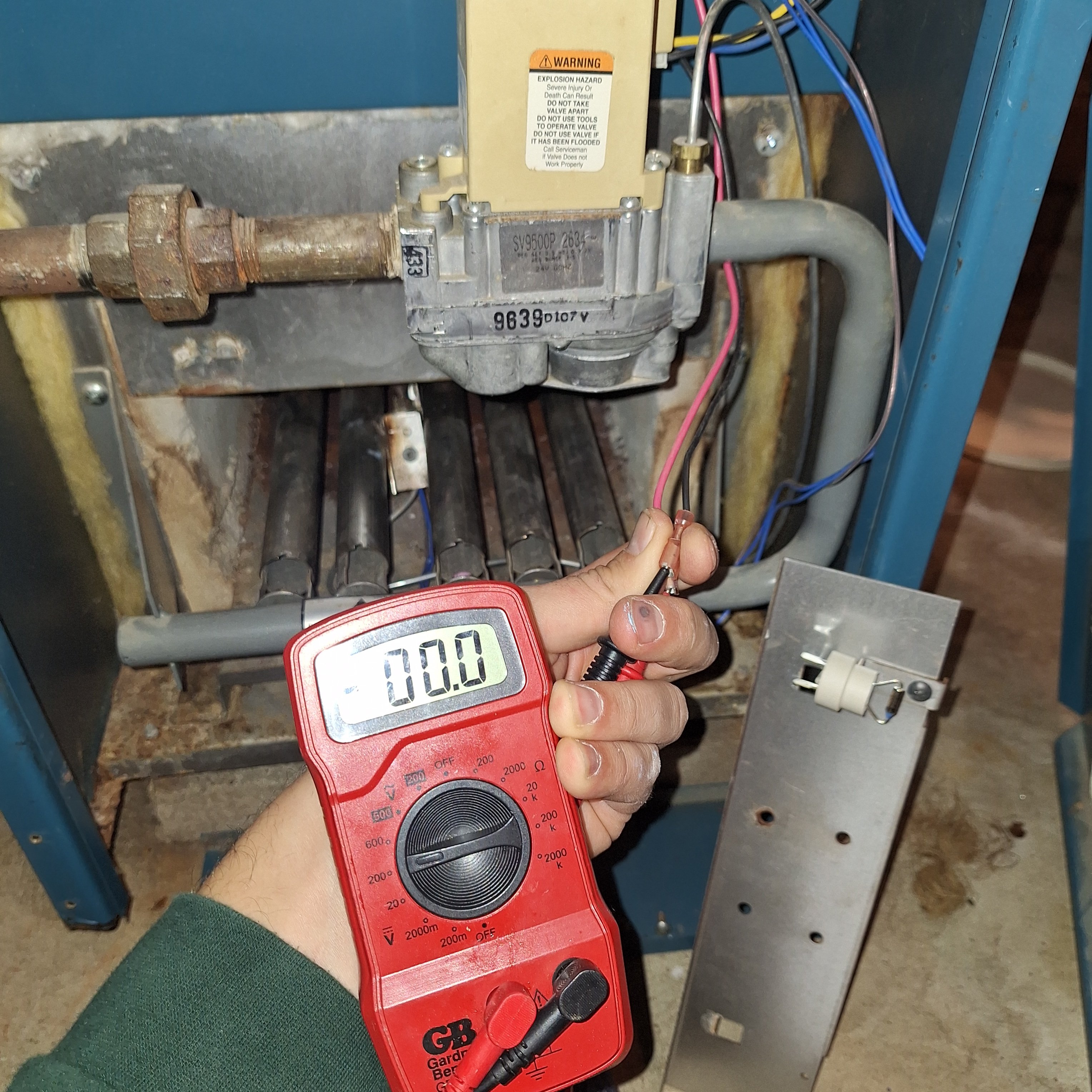

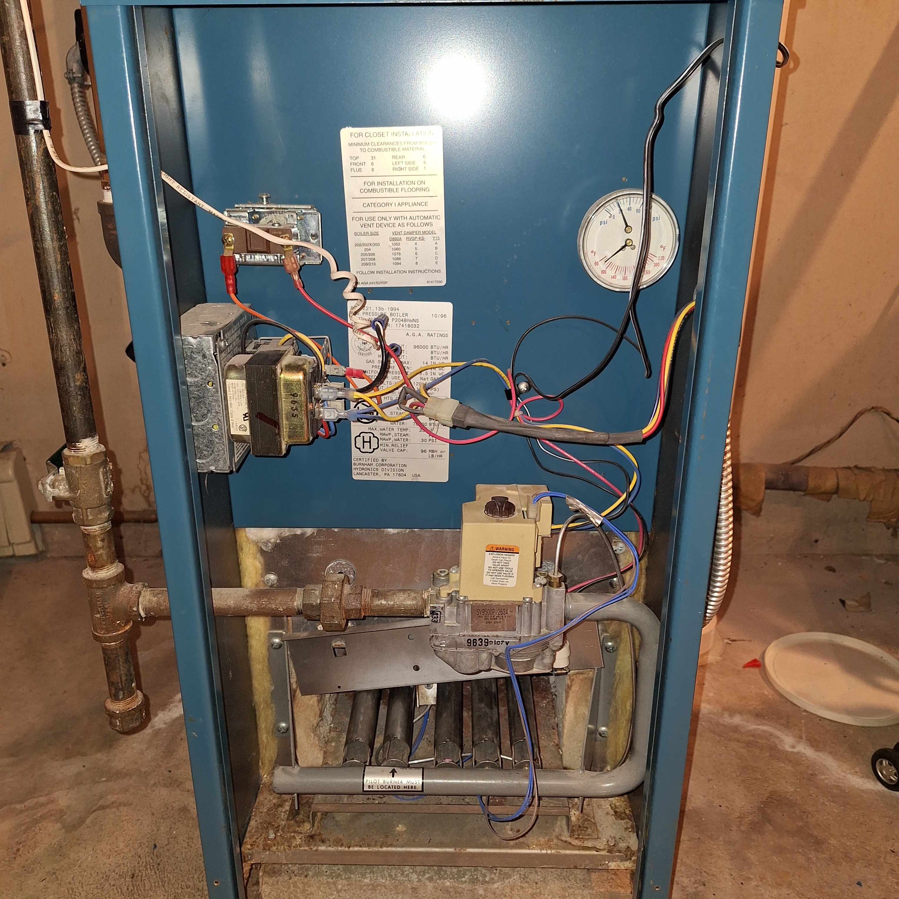

Hoping someone would be willing to help out with my Burnham Low Pressure Boiler (see photo 1).
I seem to be having issues with the automatic pilot (theres no manual ignitor).

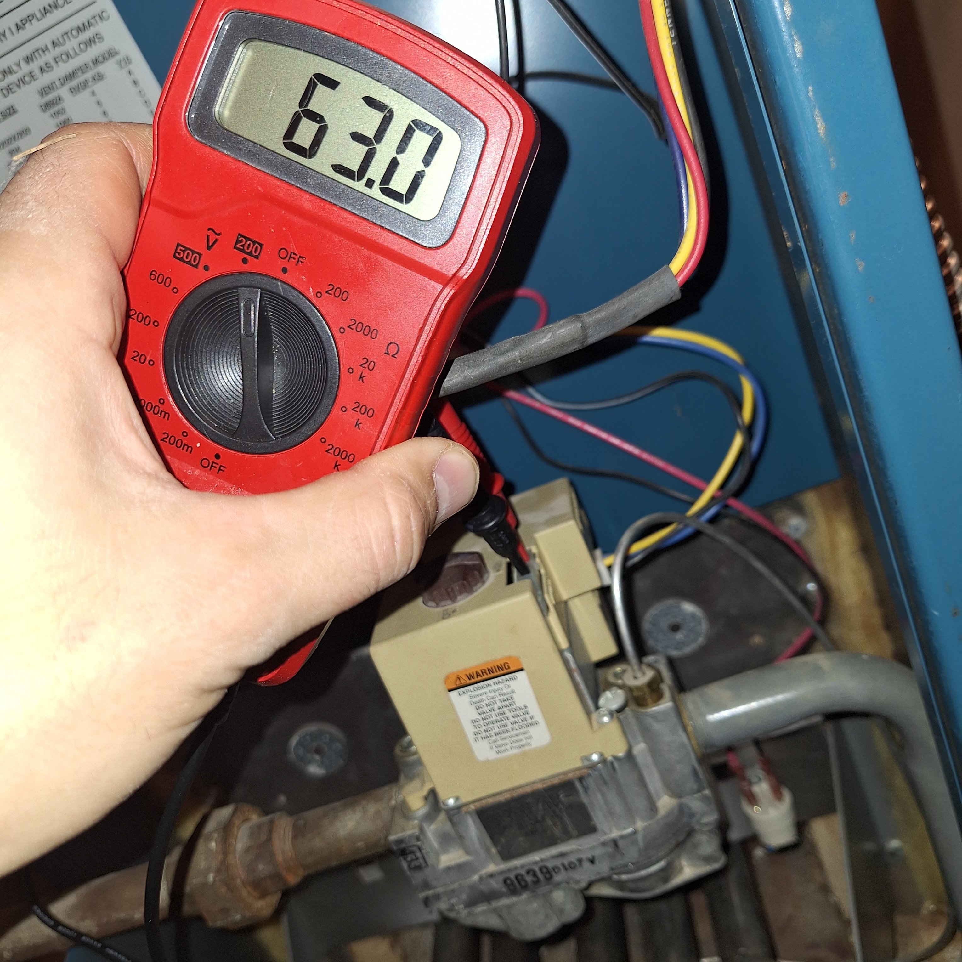

I have attached a few photos to help walk through the troubleshooting I did. When i turn power on i hear the thermostat click in and I believe the exhaust switch click? Then i hear the gas valve click and the thermocouple/ignitor click? I seem to be having 2 potential issues...
  1. The gas valve ignitor plug seems to be reading 63 volts. Shouldn't it be 24?
2. The lines to the high limit/roll out switch seems to be reading 0 volts...Once again, shouldn't it be 24?

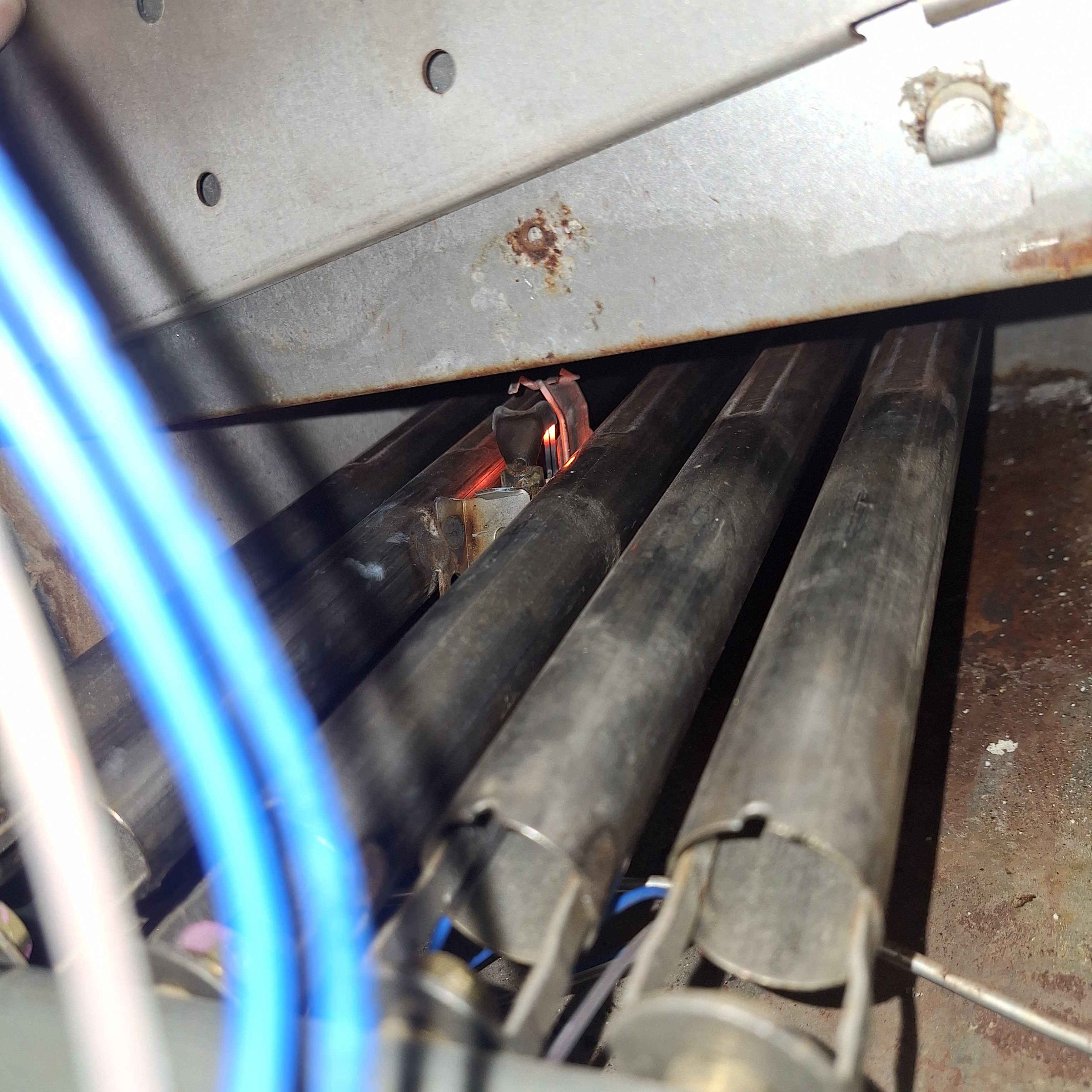

I replaced the ignitor/thermocouple and it glows, so that appears to be working. I have the thermostats on and set way high.

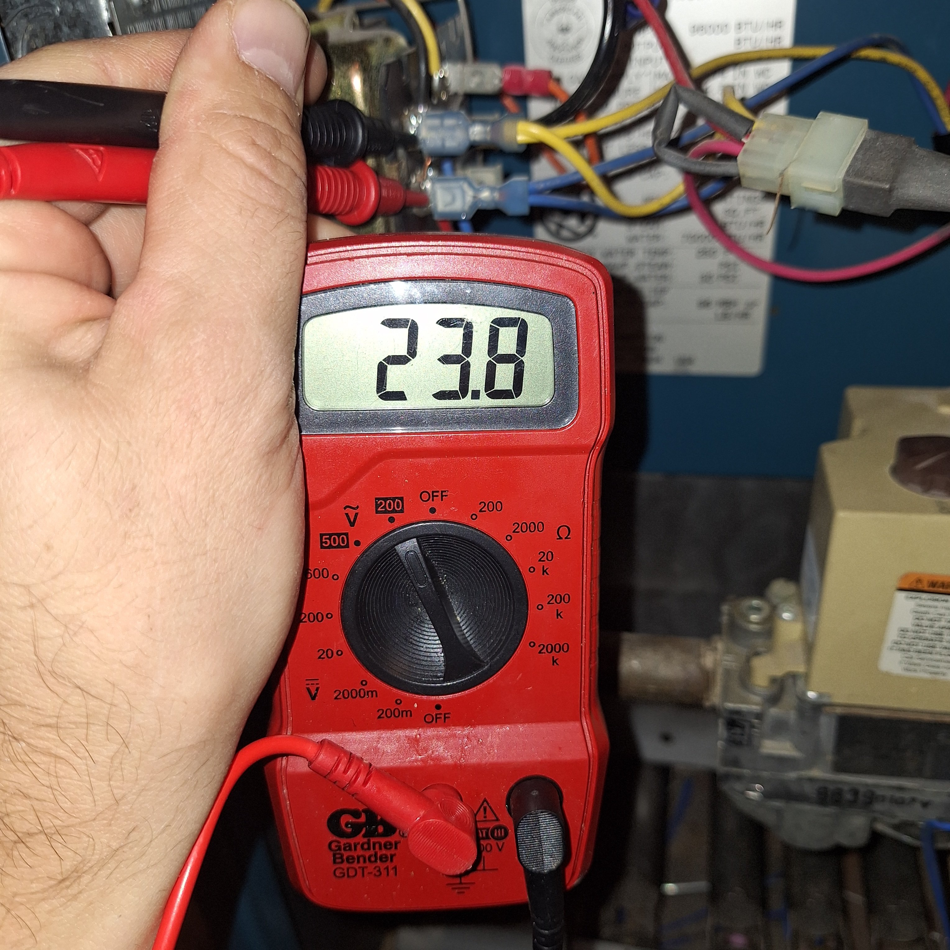

is my gas valve shorting out and not properly opening to allow gas to flow? I dont smell gas. Photo just showing i have 24 volts at the transformer.

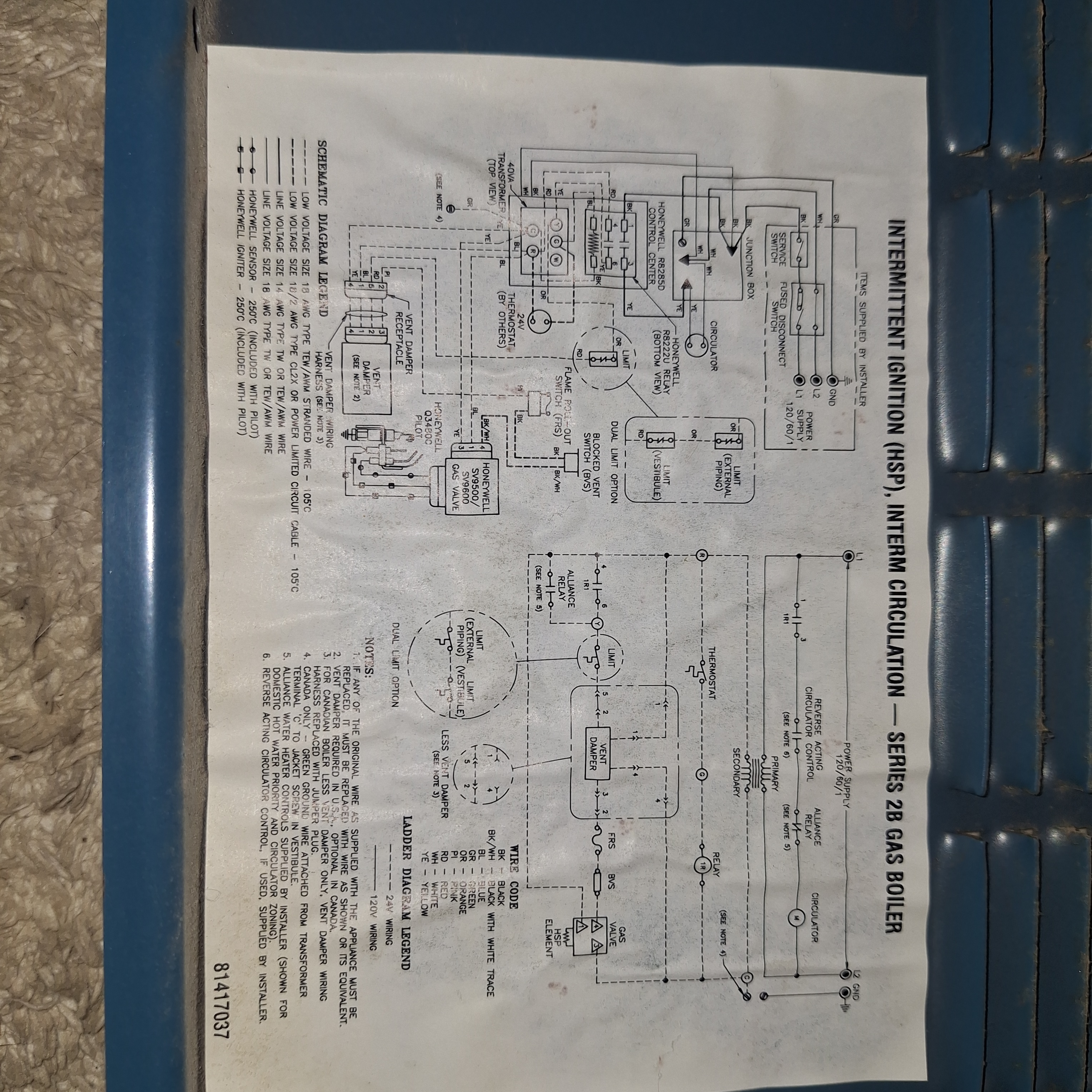

    Should be a wiring schematic inside the front cover, or in the manual. We need to see what else is in that circuit.
    Is there a vent damper on the boiler? That is a common cause of no fire conditions.

    That is a Honeywell 'Smart Valve". They work a little different. That model valve is pretty old and is no longer made. The valve shown on the attached is a direct replacement so everything should be the same as far as troubleshooting.
    Troubleshooting starts on page 11.
    The hot surface ignitor is also the flame sensor. Since it is glowing it should be ok. First thing is check all wiring connections.
    Then try the troubleshooting chart.

  • Your second picture is where you are measuring voltage to the hot surface igniter which will be greater than 24 volts in order to get the igniter hot.
    Your third picture where you are measuring voltage to the flame rollout switch, you are only measuring one leg of the transformer, so you won't see voltage unless your other lead is placed on the other leg.
    Your problem could be as simple as a clog in the small aluminum pilot tube that goes from the gas valve to the pilot. A technician would unscrew the brass nut that connects the small aluminum tube to the control and see if gas comes out of that port on a call for heat. If yes, there's a clog in the line, probably at the pilot. If no, you may need a new gas valve.

    Some of the Smart Valves only use 24 v to the HSI ignitor.

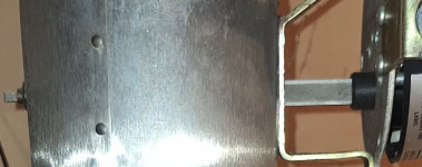

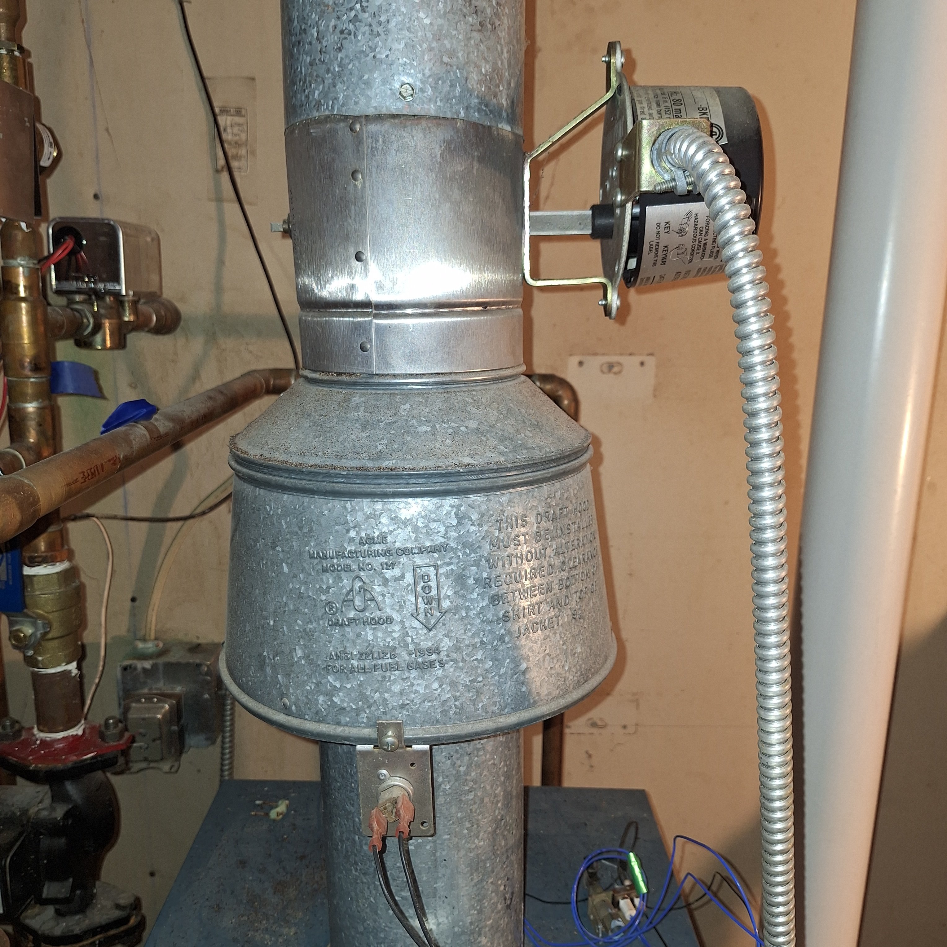

    Thanks for the responses everyone. I didnt realize I had any comments. Attached are 2 more photos; one of the schematic and one of the damper. I have pressed the reset switch on the damper and it didnt lead to ignition. is there anything else I can do to deal with a potential damper issue?
    to the poster who asked about the gas valve being off, unfortunately I turned that off after attempting to fix it. I wish it were that simple!

    There is a vent damper. See photo above. There is a reset and I pressed that. Is there a correct way to use a multimeter to check its function? I feel like I hear 2 clicks when I turn on power. the thermostat and vent. Is that what I should hear? Should I take a video?

    If the vent damper were not opening, or if a safety were open, it would not allow the pilot to ignite. Once the pilot is lit, the only thing preventing the Smart valve from opening is that it must sense that the pilot is established. If the pilot is good, then the Smart valve is the problem. This is quite common with them.

    I feel like I hear the damper click. What is the best way to see if the damper is open?

    Interesting, I will clean off the pipe dope and retighten. To be clear, I dont have a lit pilot light, I just have a lit surface ignitor.
    hot_rod Member Posts: 28,078
    The position of the shaft tells when the damper is open. Ten a switch in the damper when fully open allows power to the gas valve.
    In this pic the vent is full open. when the call for heat stops this flat metal shaft should turn 90°. Does it?
    In some cases those dampers can be manually forced open, maybe a black switch on it to allow that?

    If the ignitor glows, then its making through all of your safeties. Issue seems to be with either the smart valve itself or gas supply.

    Thanks Bob! I will check if it closes when I get home. I would think that if the vent is fully open, it would not prevent the smart valve from opening, correct? So that seems to suggest i either have a blocked line or failed smart valve?
