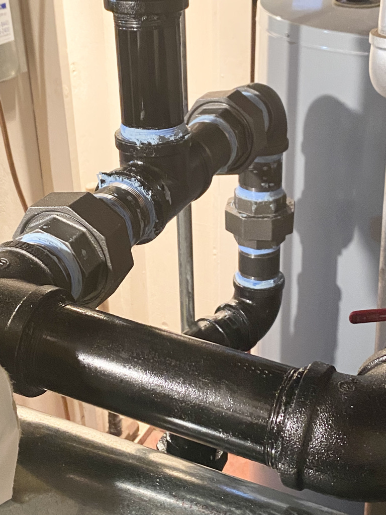

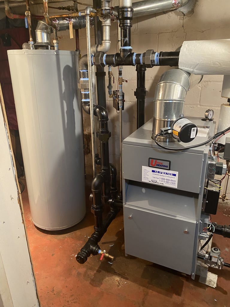

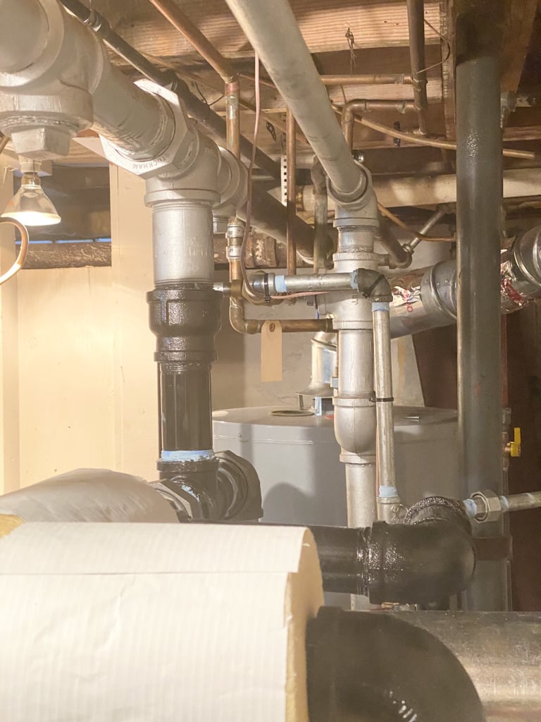

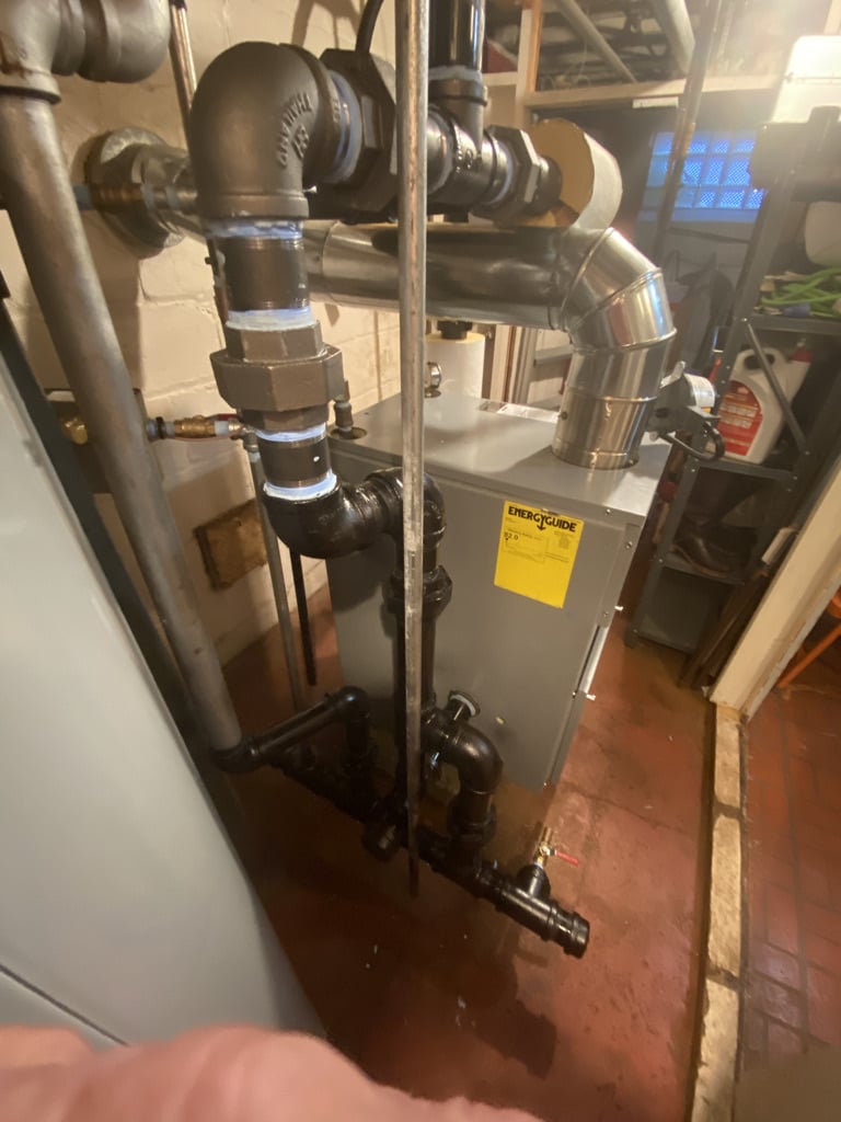

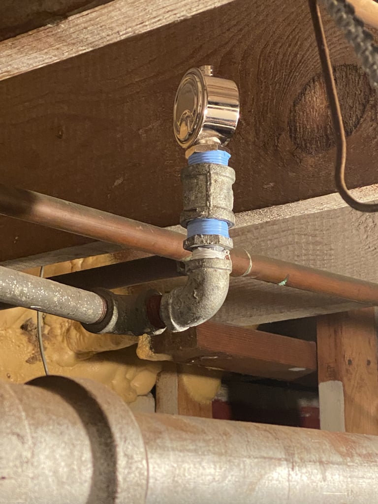

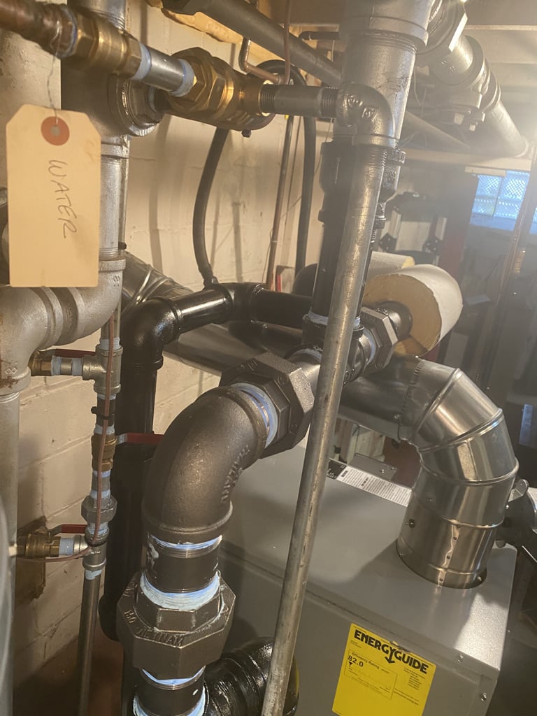

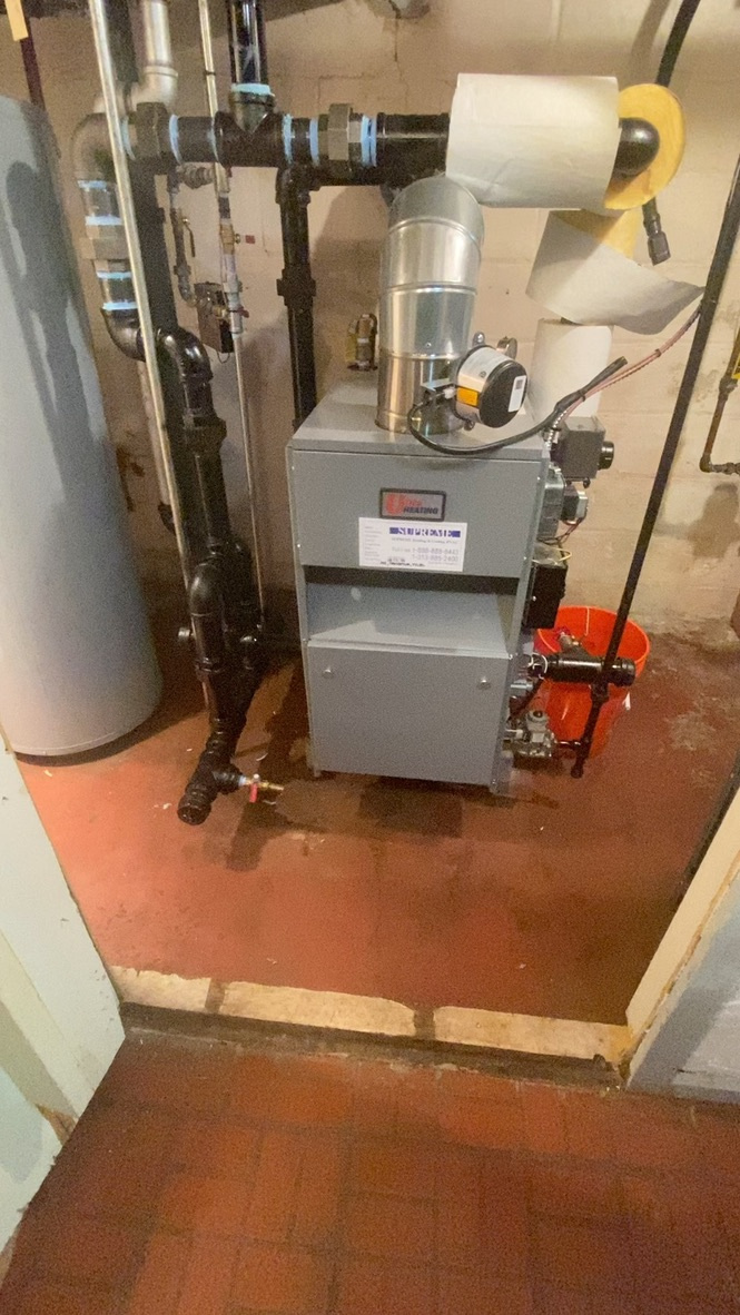

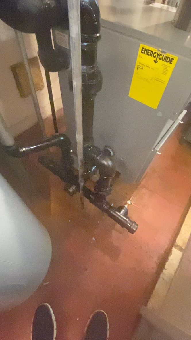

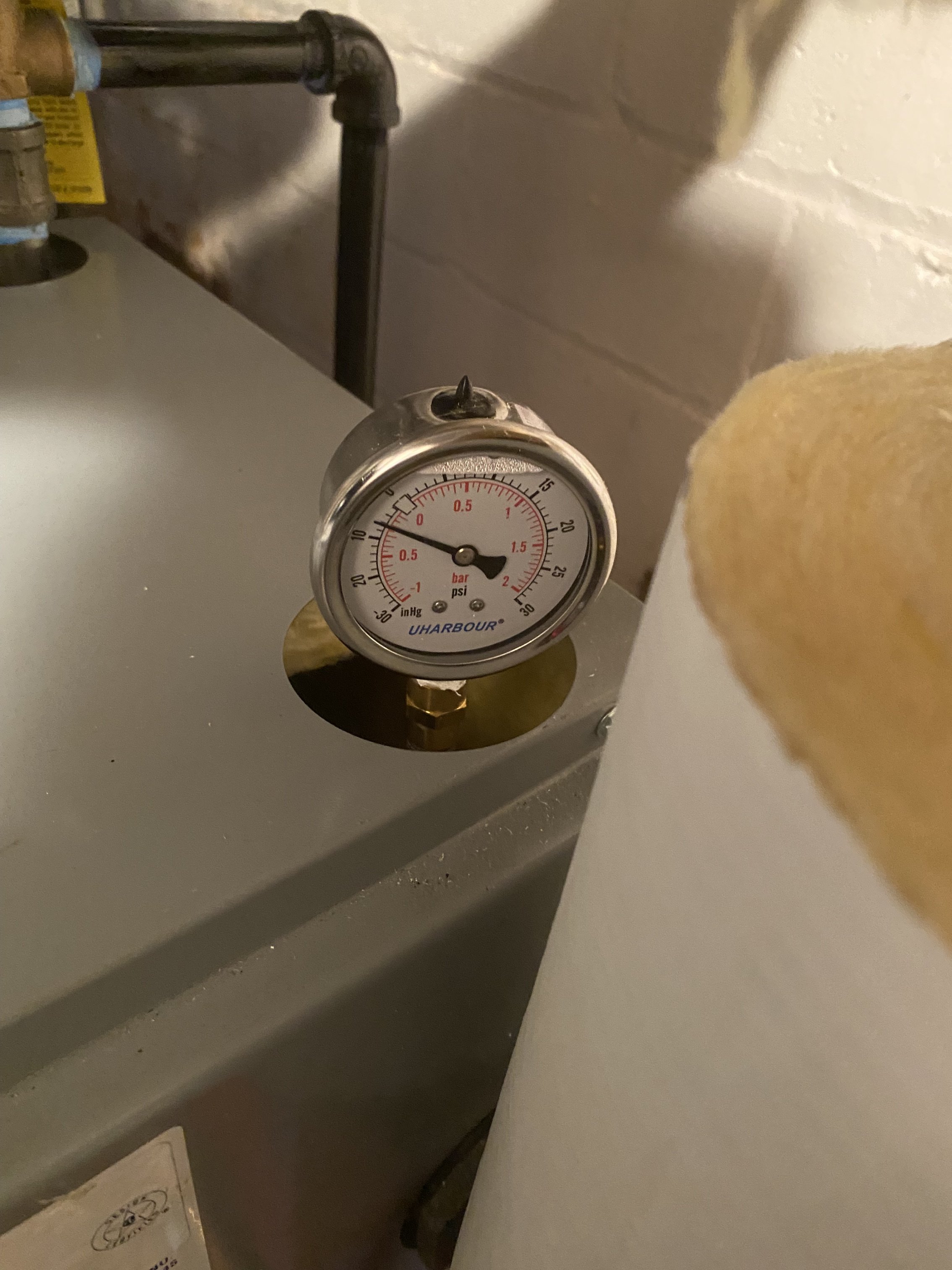

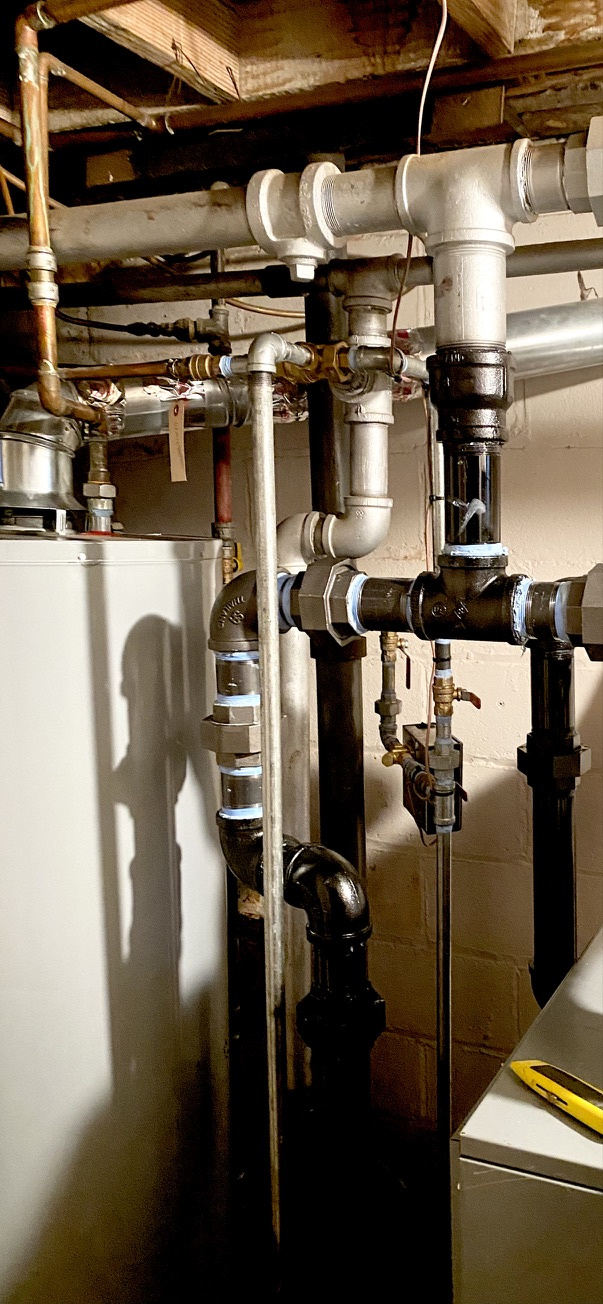

Recently I had a new system installed for my two pipe system. The system has been working properly. Today, all radiators are cold and the boiler has not been running for 2 hours - now a couple of radiators are clanging but the boiler is not running - pressure gauge is zero. riser pipes are cold - clanging is still happening. please advise.
pictures of the boiler,
floor to ceiling, showing the header, from 2 angles,
of the sightglass,
show the Ptrol and pigtail, and the ptrol settings,
what pressure do you see when the boiler is hot and running?

This doesn’t make sense if the boiler has not running after two hours. That would mean it has nothing to do with your boiler system as the steam would have condensed by now. You should set the temperature higher at your thermostat to kick the boiler on, go to said radiators and see if they make noise. Then turn the temperature down and go to said radiators to see if they make noise after a few minutes of being off. Two hours is too long to be hearing noise from your boiler
maybe also double checking your system isn’t being overfilled if this is steam0 -
Check the sight glass maybe the boiler is flooded with water or low on water. Use a flashlight behind the sight glass.
Sometimes its hard to tell an empty sight glass from a full flooded one. Post a few pictures.
If the thermostat is calling it is most likely off on pressure or water level.
Did you check the circuit breakers?
the "clanging" could be expansion noise
System does not show any pressure only negative pressure
If the boiler is off and cold. And the pipes are cold. And the radiators are cold.
And it's been that way for a while and then suddenly starts banging. It's something else. A little hard to say what without being there.
