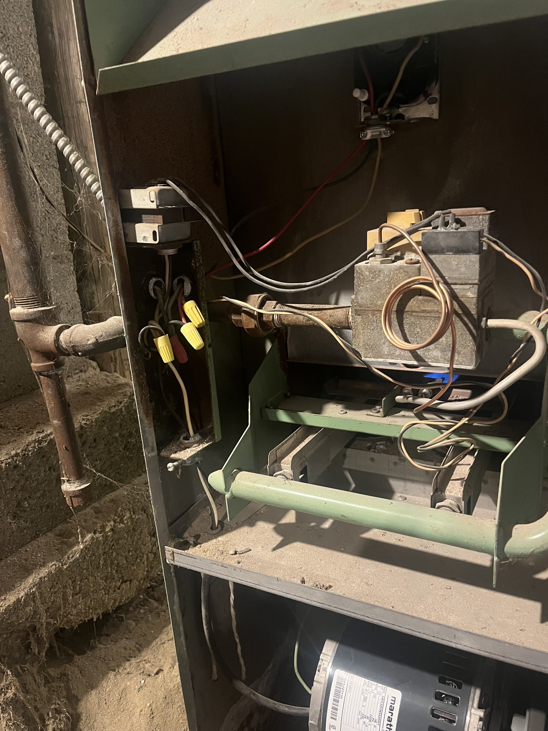

Hi all, I have a very old furnace in my 1950s house. I have replaced the fan and limit control coil (as seen in this picture) because the old one was not turning on the blower. I also had to buy a new motor because the other one would not turn on and was so hot that it burned some wires. Now, when the limit control coil tells the blower motor to turn on, it periodically shakes rather then spinning the pully. Please watch the 11 sec video below to see an example. What could the issue be?

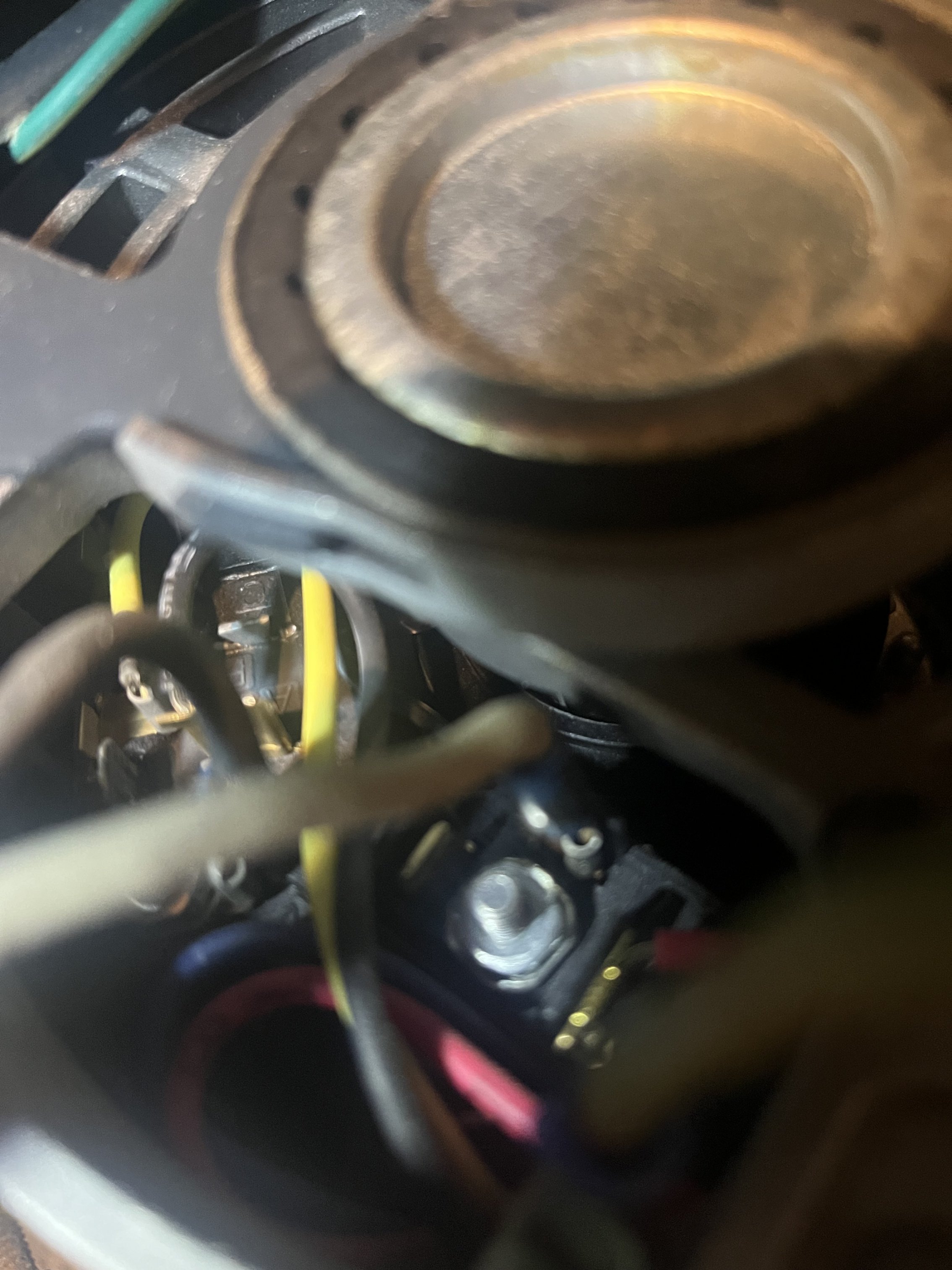

    OK, I am going to turn off the power and test those things. I will send these pictures for now because I’m wondering if I do have a capacitor. I really don’t know what all of these components are.

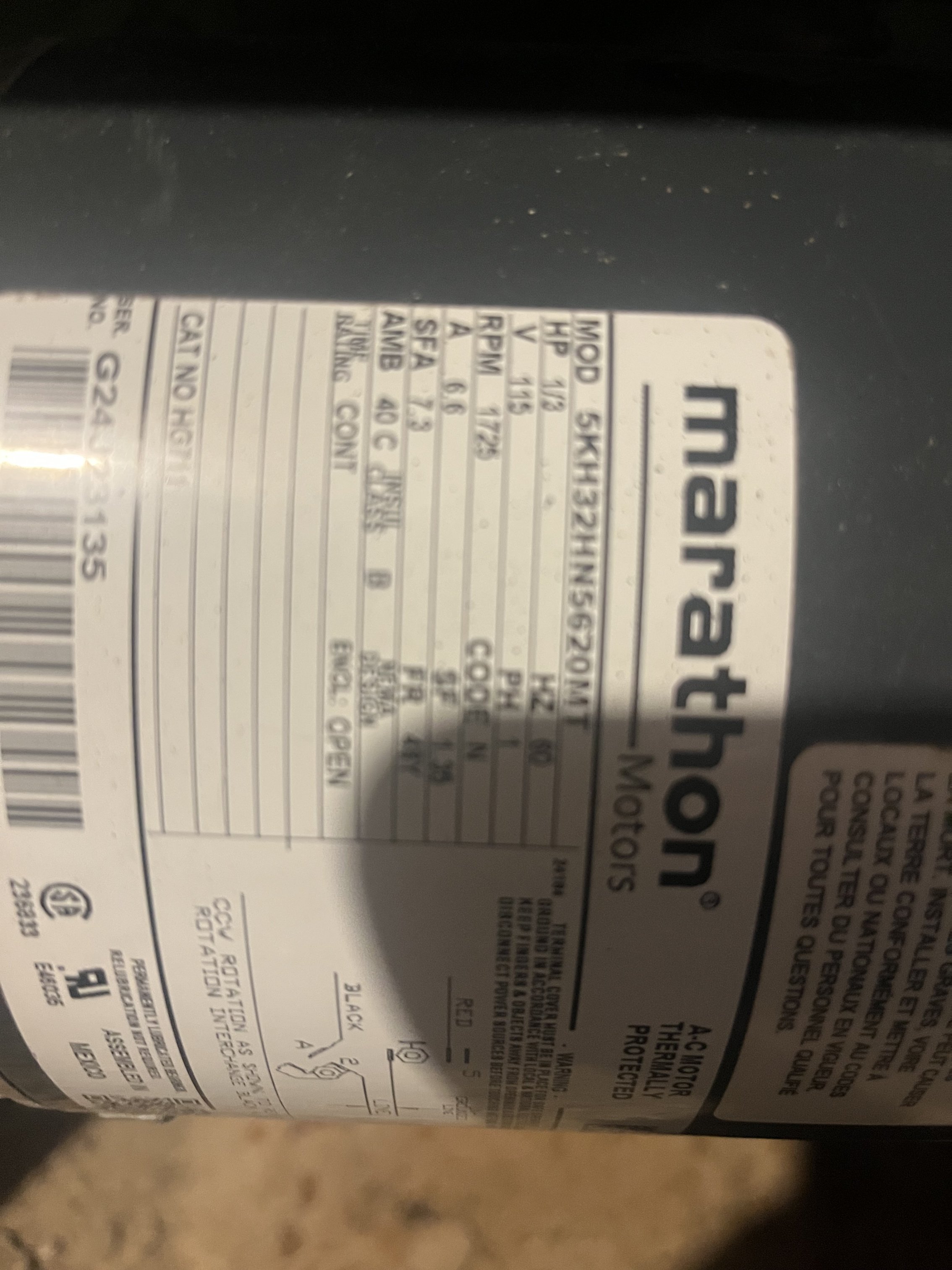

    I’m also sending a couple clear pics of the label

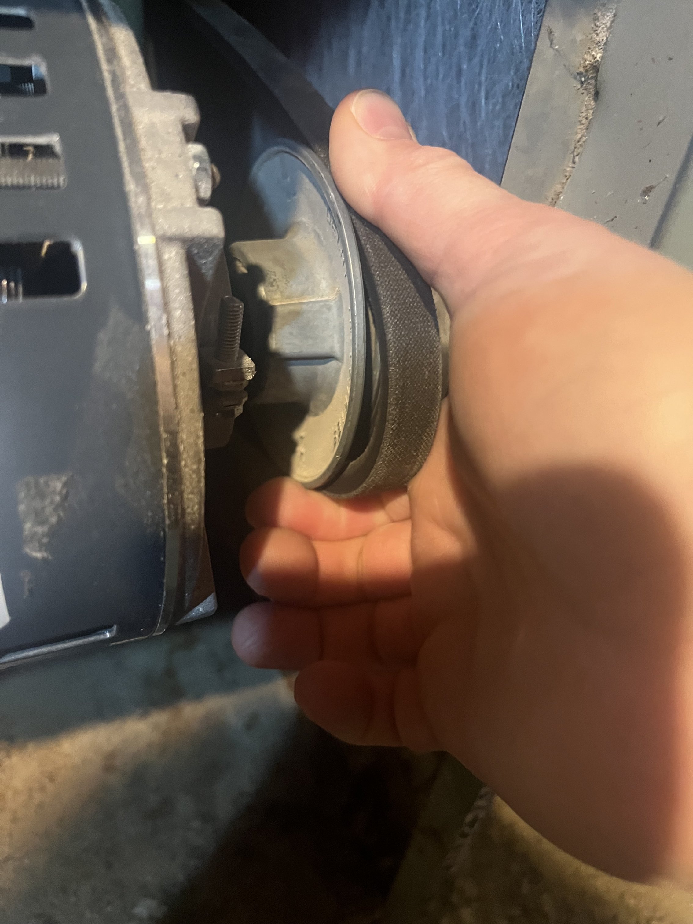

    also, I have determined that the belt is pretty loose. Check out the slack

    I’m also attaching this picture of where the neutral wire connects because there are two possible slots and I can’t tell from the motor the diagram if I put it on the right Slot. Hopefully you can see in the picture that there is a slot on the left it could attach to.

    No capacitor. That's a shaded pole motor.
    We're assuming this is 120 volt? Have you tested voltage at the motor? Hot and Neutral, and Hot to Ground. Can you post the wiring diagram? Some wires might be on the wrong posts, or might need to switch posts.

    I put the new belt on and when I roll the pulley with the belt there are times when it easily and then times rotation it is very difficult. Is that normal? Here’s a video.

    no. that is your problem. turn off the power and pull out the blower and figure out what is binding. could be a warped or broken blower wheel or housing or debris i the blower or something with belt alignment or bad bearings on the blower or some sort of manufacturing defect or debris in the motor.
    when you rotate it by hand it should keep rotating at lest for a second or 2
    take the belt off and try to turn the blower and the motor by hand. try to move the pulley on the blower up and down and front and back, there shouldn't be much play in that direction. there might be more play in and out which might be ok.
    mattmia2 Member Posts: 17,759
    also that belt shouldn't be super tight, too much tension will damage the bearings

    both the motor and the pulley each rotate on their own with no belt.

    or bearings or mounting. the tension might be moving the blower wheel around and causing it to bind with something with the belt tension on it
    there should be some bolts or pins or clips or something that you take out and the whole blower assembly should slide out so you can see where it is binding

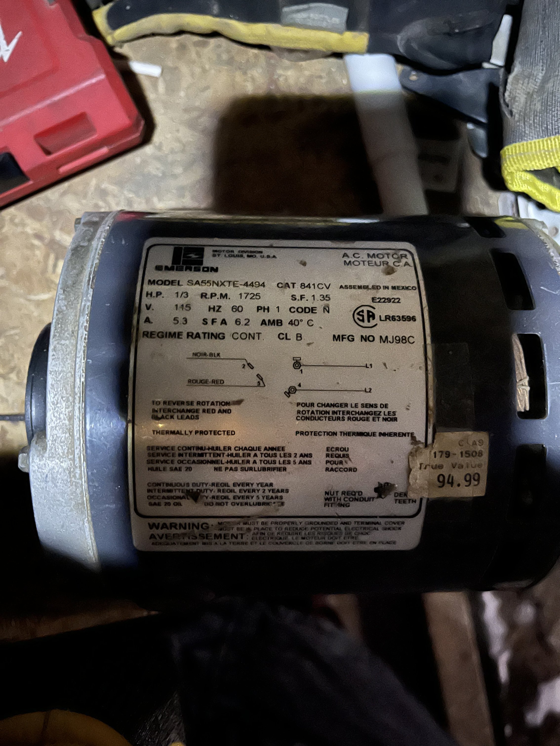

    here is a picture of the label from the previous motor. It seems as though they are the same unless somebody different than I do.

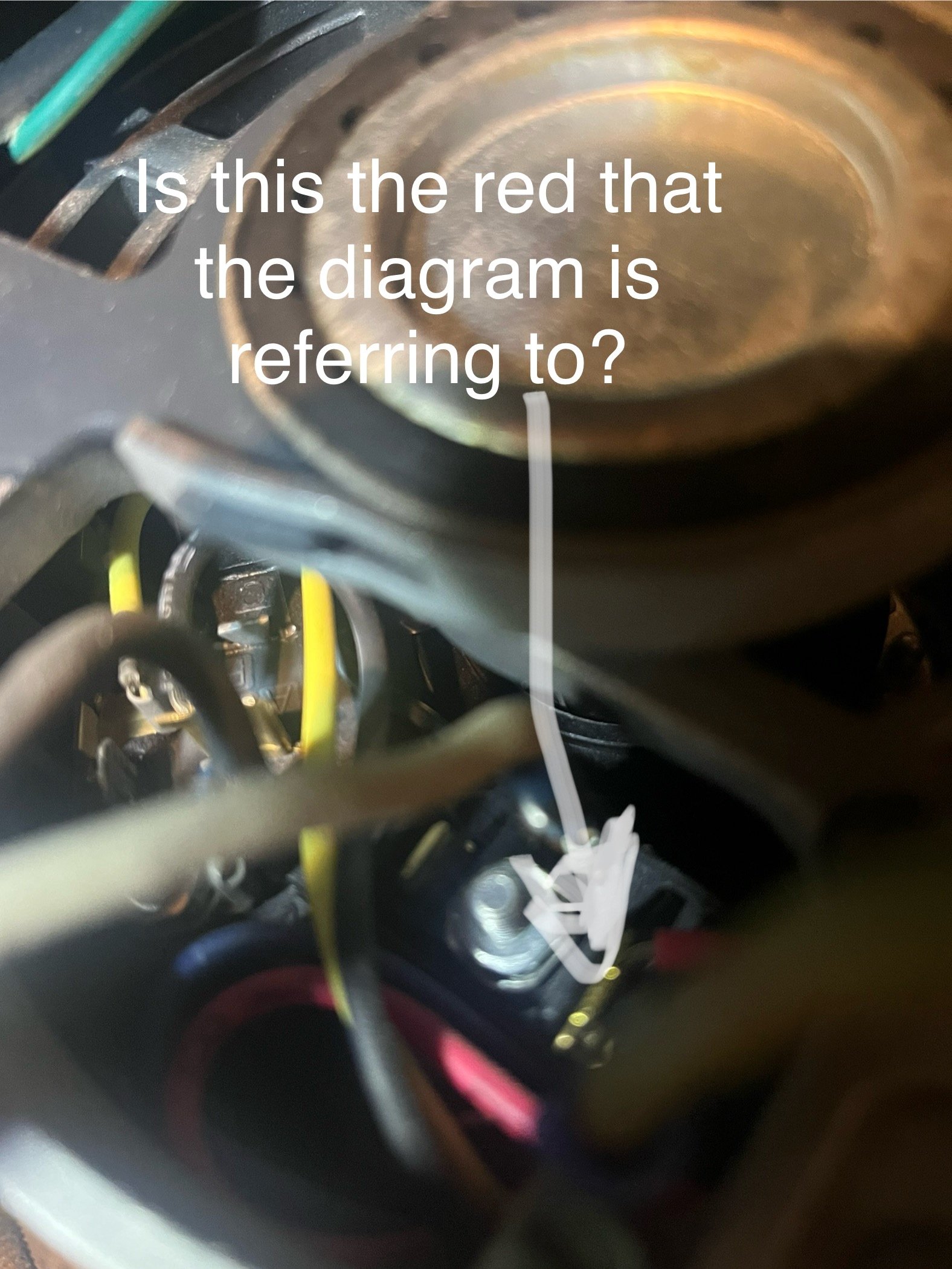

    I’m not really sure how to make this motor spin the other way.

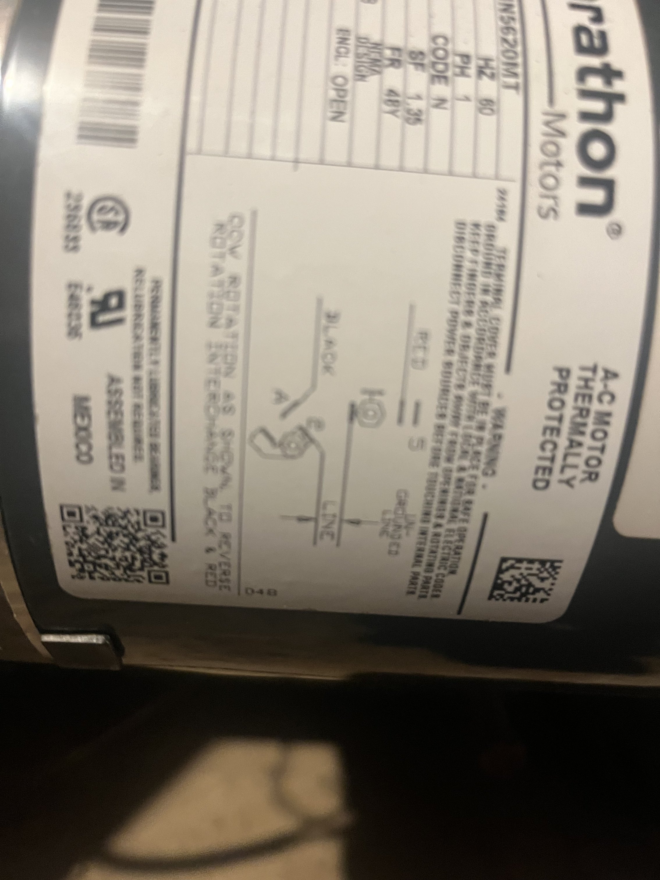

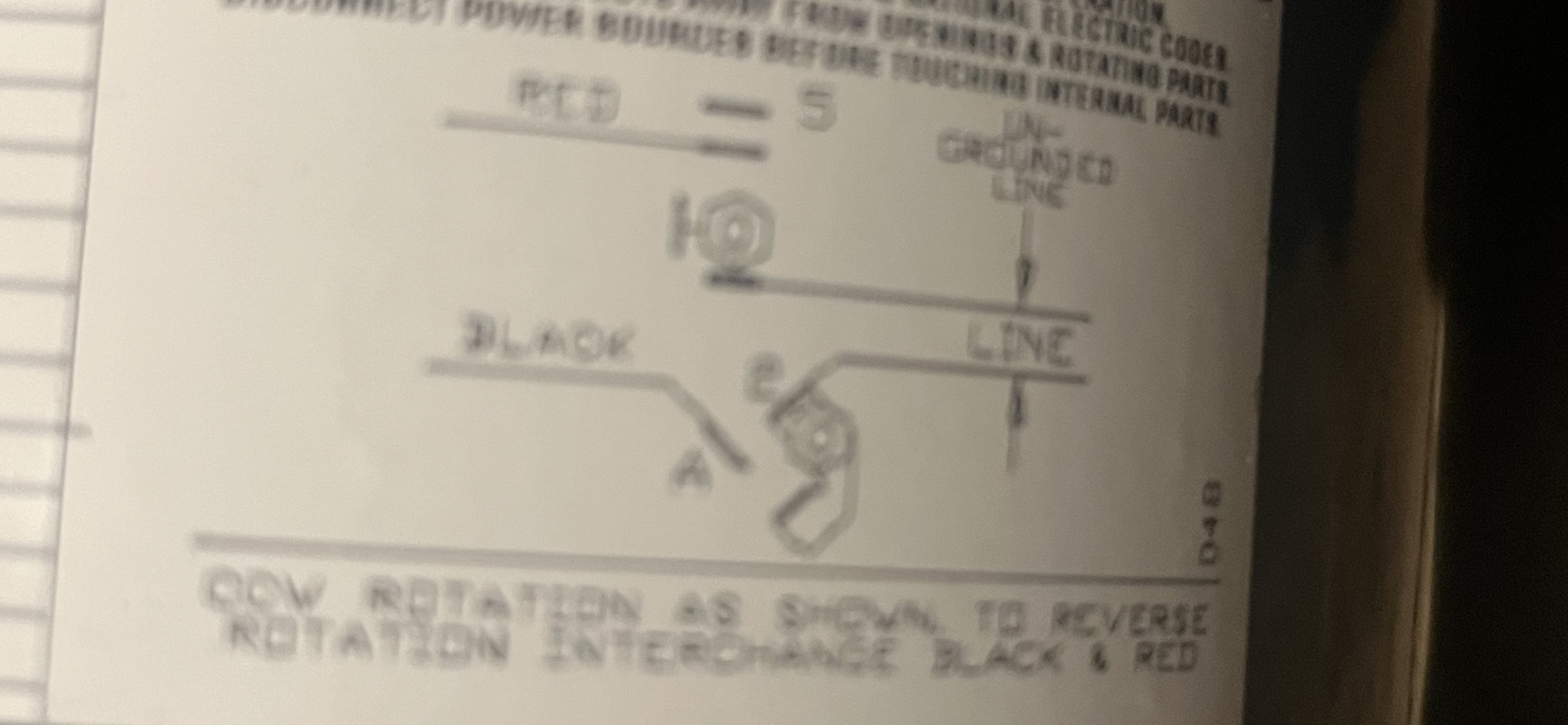

    I know it’s blurry, but this is what it says on the front of my motor.
    The words at the bottom of the diagram indicates I have to switch black and red. Where are the black and red?
    yes
    EBEBRATT-Ed Member Posts: 20,716
    Yes reverse the red that is on #5 with the black that is on A

    it says ENCL: open
    what would that indicate?
    pecmsg Member Posts: 7,379
    That's an open enclosure. Air can circulate to cool the windings.

    can you take an in focus picture of the schematic section of the label on the motor so we can read the notes and labels on the wires and a good picture of the terminal strip? for the terminal strip you may need to use a light pointed in the wiring compartment and press the screen on your phone where the bottom of it is to make it focus and expose to that area. there should be little numbers/etters molded in to the plastic by the terminals.
    if you have the neutral connected to the wrong place(i didn't see that question, it might have been flagged for moderation for some random reason and wasn't there the first time i read this) it could be just energizing the start or main winding instead of both. I'm not sure if that motor has a start switch or not, do yo hear a click a second or so after the motor starts and another click as it stops spinning?
