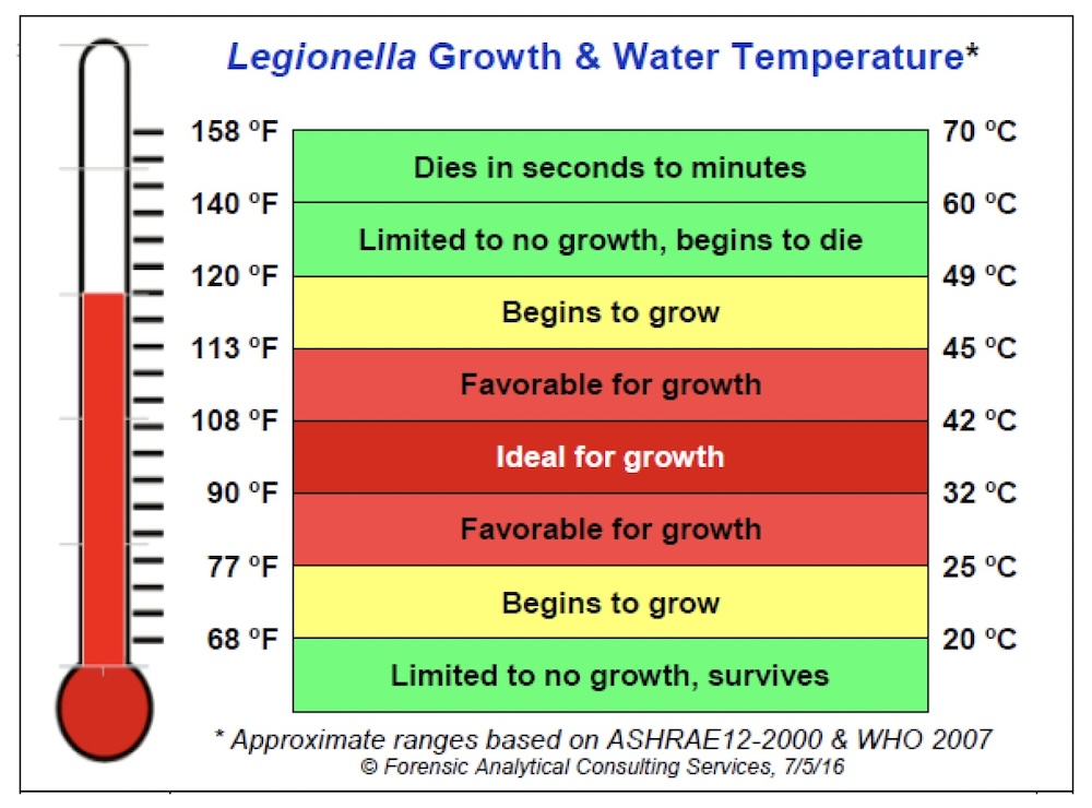

    Heated slab typically uses 110F water. Look at the chart bellow.
    Very few ways to stay out of trouble, to pasteurize the loop you probably will need more than 140F water and run it long enough that the returns water goes up to above 140F. It will take a fair bit of energy to get a slab hot enough for that to happen. The slab will also be a bit too hot to walk on.

    Thanks for all the comments. Seems like at 130 would be sufficient if done every week or so for an hour.
    It's well water that has been chlorinated for light sulfur smell and through a large carbon filter. So legionella seems a low risk in any case. But, regardless, seems weekly, or more often, recirc for a few minutes would not allow "stagnation" to be a concern. Hope that's not wrong.

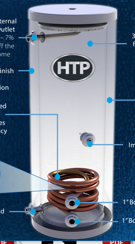

    Don't understand "if the coil goes up higher". It looks like a typical Super Store, about the size of a 55 gallon drum, with a SS coil vertically oriented.
    It does not have it's own aquastat, it's a priority zone of a 5 zone box for the oil burner recirc pumps.
    I think at this point, I will just hook it to the indirect, "for now" so I can get on with closing out my building permit and dealing with a lasting solution in the spring or early summer.
  • Kaos
    Kaos Member Posts: 939
    edited November 2025
    Looks like the coil is on the bottom, so it won't work as a reverse indirect anyways. A reverse indirect is where you use the space heat coil in the tank to pull heat out of the tank. Since water stratifies, you can only pull heat out of the water that is bellow the coil. Since the coil here is near the bottom, that is very little volume. On some indirects the coil is taller and reaches up near the middle of the tank which would work.
    To pull heat out of an indirect you need the coil closer to the top. I guess you can flip the tank upside down but that will get some strange looks down the road.
