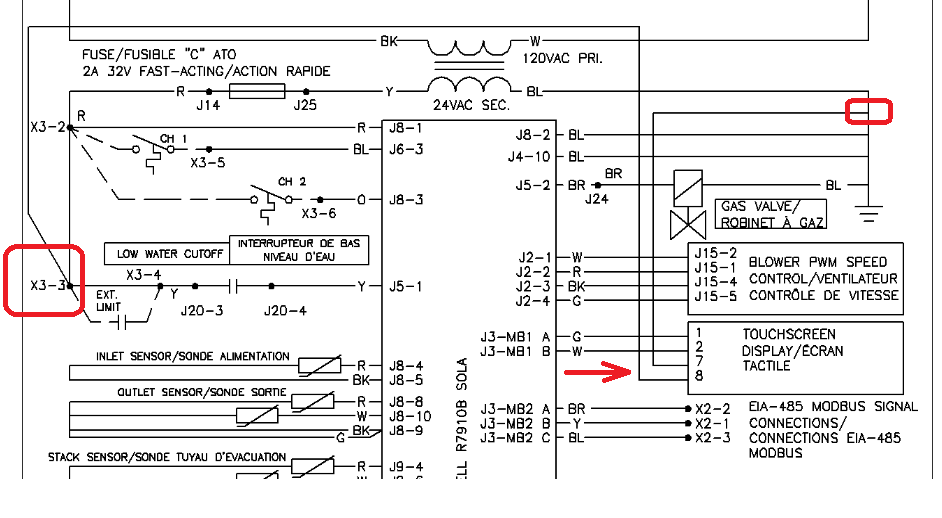

chs 110 boiler
screen is blank
boiler runs no screen
replaced screen same thing amy thoughts
Display not communicating with the control board.
Could be an issue with the board or the cable.
