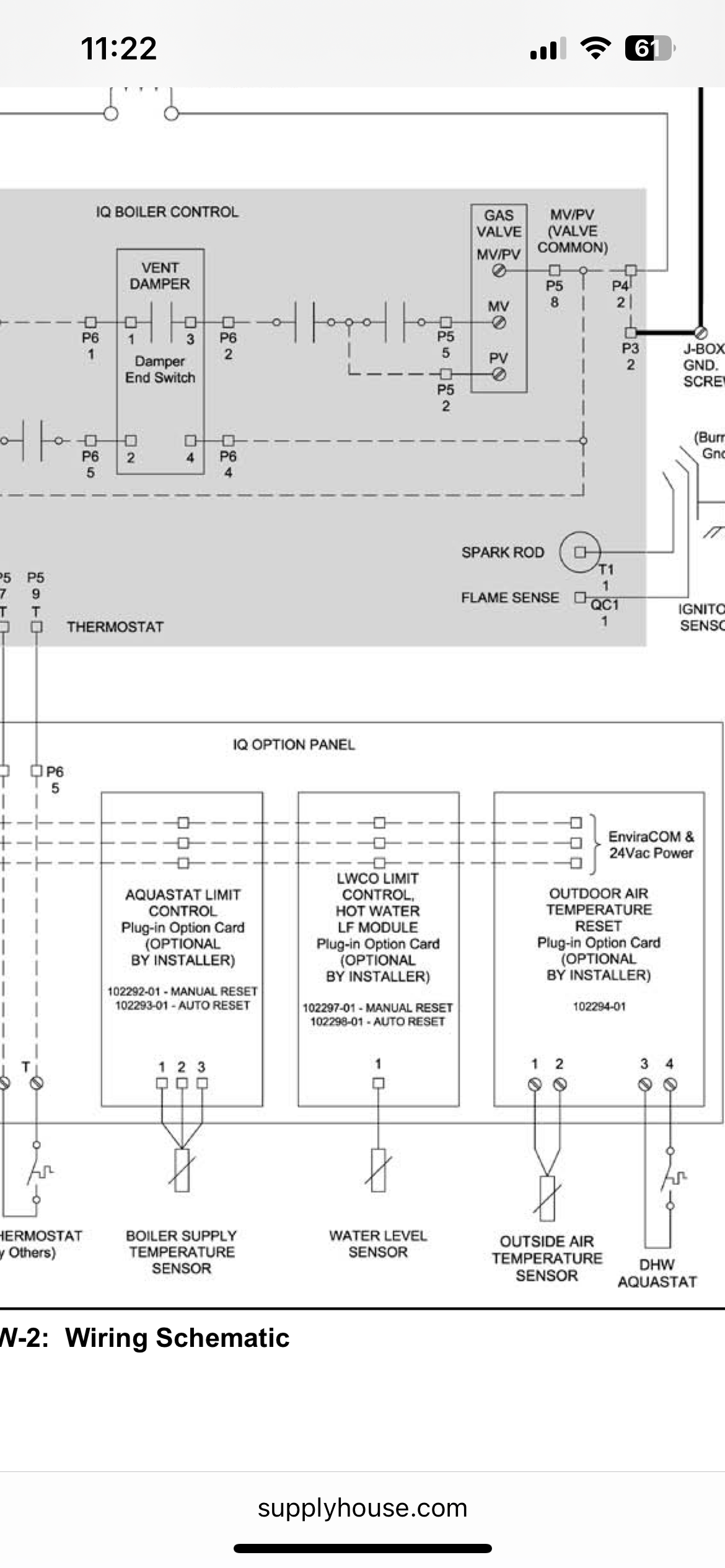

    Looking at the wiring diagram for the ES27 from the ES2_IOManual, it appears to me that there is a single sensor for water temperature - "Boiler Limit Temperature Sensor". Maybe I missed something.
    Burnham used to make an Option Card for an "Aquastat Limit Control" but they stopped making it in 2018 and it's no longer available. There are 3rd party products available though as @Jamie Hall mentioned.

    it looks like that boiler has optional, installer supplied cards for additional safeties
    LWC, manual or auto reset limit, odr

    the manual reset high limit one is discontinued it looks like. I imagine they ran into some kind of CSD-1 compliance issue or something. the LWCO and ODR are still available.
    I have never seen a boiler sold without a high limit installed from the factory or at the very least shipped with the boiler with instructions to install it. Same thing with a safety or relief valve.
  • The Burnham ES27 does indeed have a high limit sensor, it is internal to the boiler.
