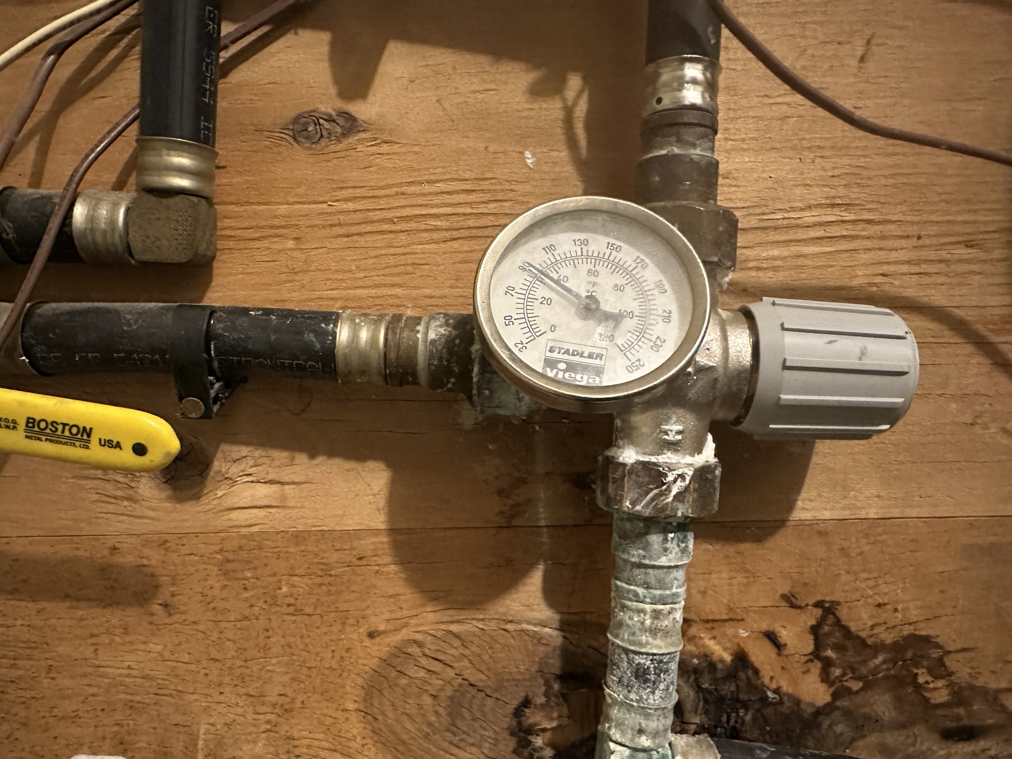

I have the following three sweat unions I need to remove and replace from a thermostatic mixing valve. What tools would you suggest and what process would you use? At this moment all I can think of trying is cutting them off with a Dremel.

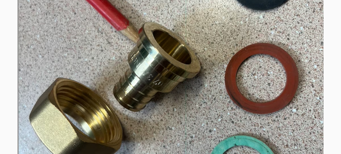

    Which parts are you trying to remove and which parts are you trying to save?
  • I would like to remove the tailpieces, that have the old nuts on them. Look like I need to cut the ferrules of and in doing so possible damage the pex pipe which will need to be replaced. Then I will need to use some form of clamp around the new fittings. I am not sure what that might be an open to suggestions.
    hot_rod Posts: 28,705
    The nuts should be fine? Just loosen all three nuts, remove the valve, clean the face of the tailpiece, use a new rubber or fiber gasket.
    That looks like a Honeywell AM series valve, measure the face to face, so a new one should drop into that spacing.

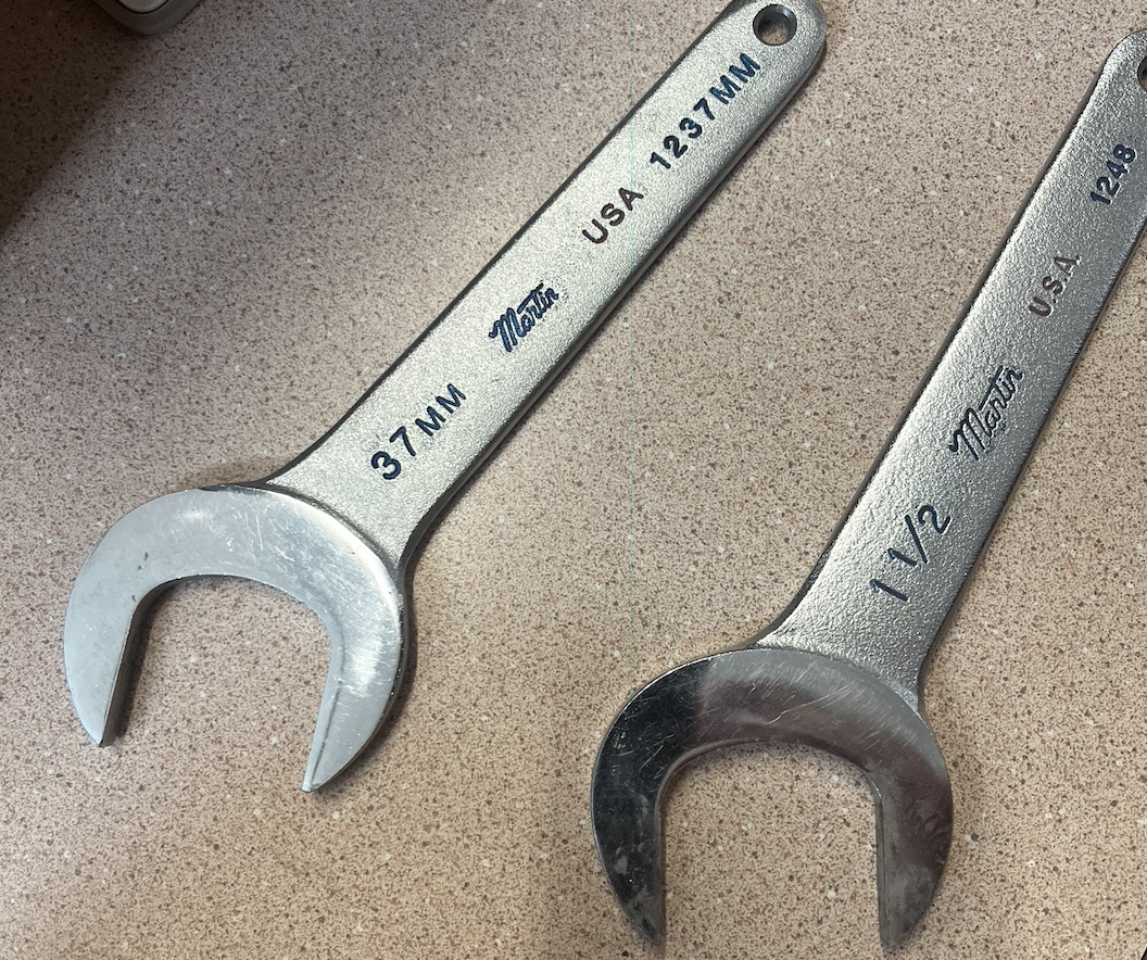

    I work with brass nuts quite a bit so I have an assortment of exact fit open ends. Martin Tool, Kansas City.
    It is a two piece fitting, the nut and tailpiece.
    Nowadays you can pex tailpieces, but you piping would need to extend the pex.
    If you want to clean up the leaks, disassemble, clean, new gaskets, reassemble.
    I would soak that valve in CLR or vinegar if you remove it.

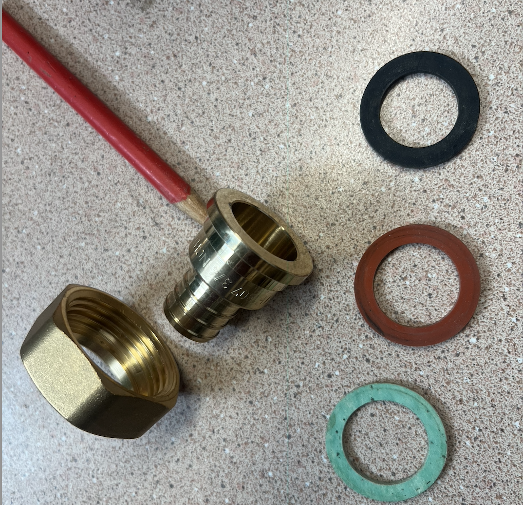

    Fiber, EPDM or silicone gaskets are available.
    Personally I would put a thin film of teflon pipe dope on both sides of any fiber washer. No not overtighten.

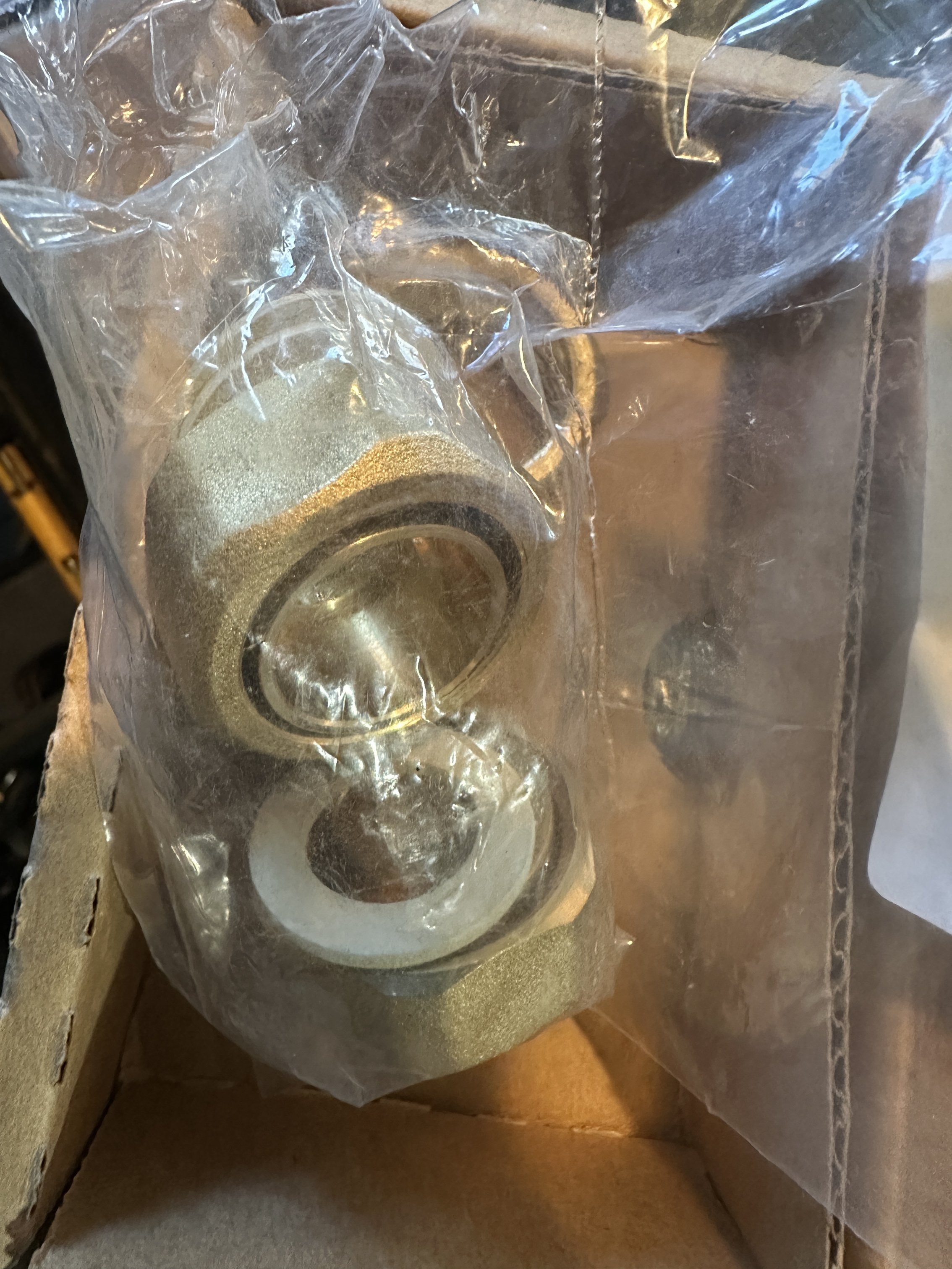

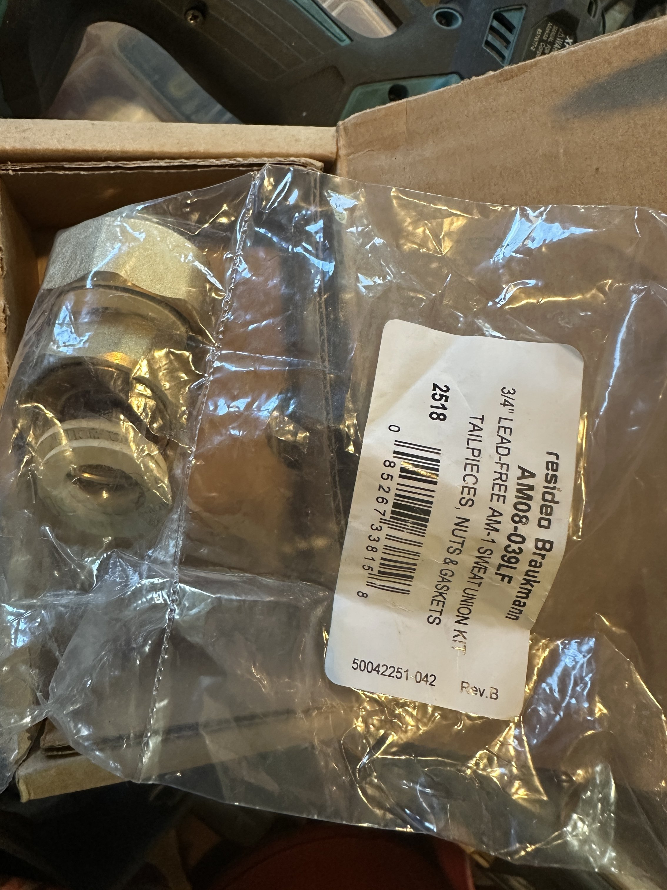

  • Does the mixing valve still operate at the desired temperature? IF yes then all you need are 3 new union gaskets. AMU200 AM-1 Gasket kit
    If the valve is no longer operational, ther the replacement valve comes with new gaskets. AM1010US-3/4

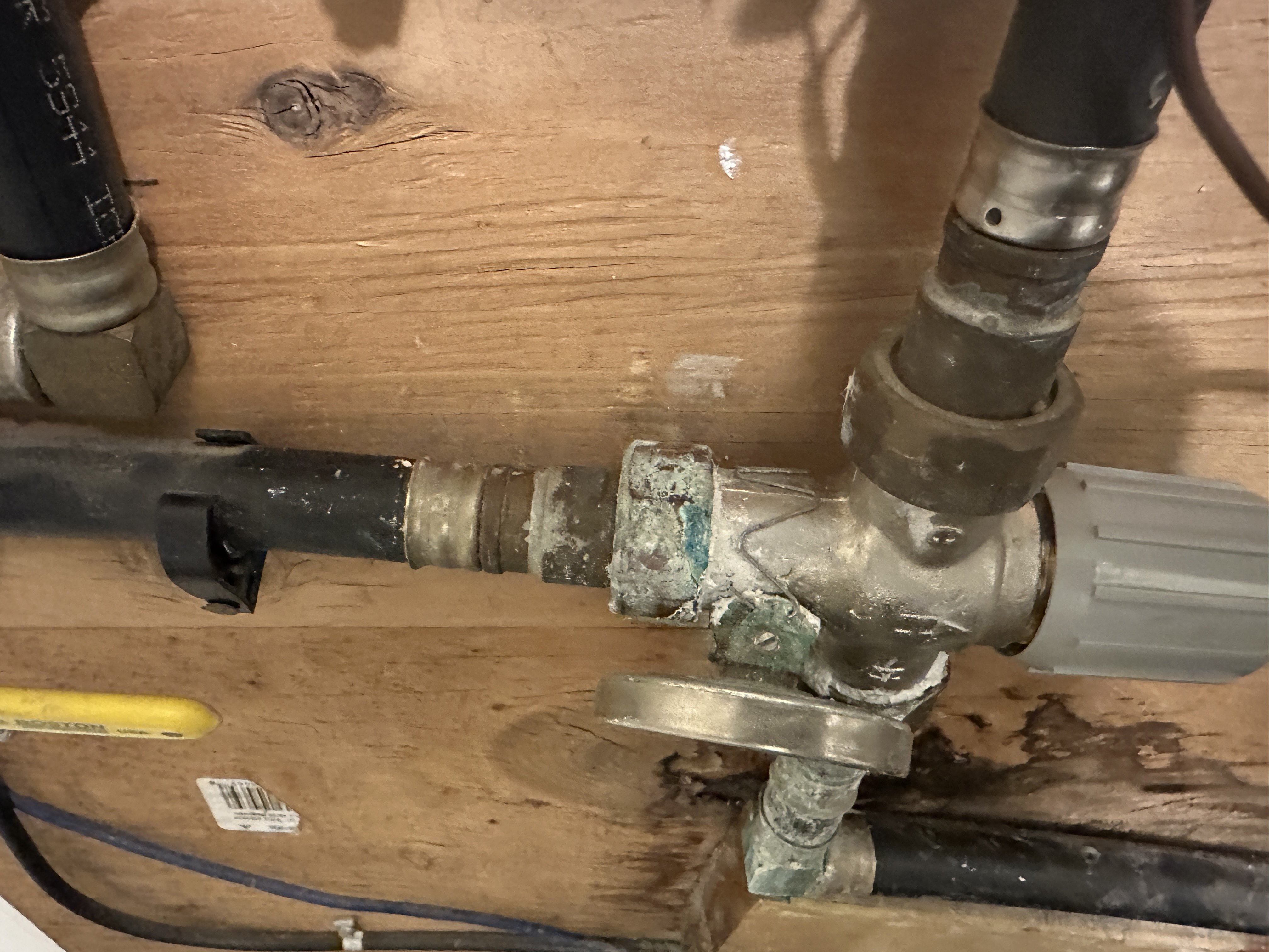

    It looks like I was not clear enough. I replaced a failed thermostatic mixing valve. Those nut are leaking from both sides. I would like to replaced them and I need to cut off the pex pipe to do so or the compression metal around it. Attached are images of what I would like to replace.

    hot_rod, I needed to know the size of those wrenches. Thanks very much for this.
    the nuts are leaking because the gasket is bad. get the epdm gaskets that @hot_rod mentions.
    hot_rod
  • I will replace the gaskets and see if that solves the issue. Thanks
    the nuts are not the sealing component, changing them will not accomplish anything. It is the face of the tailpiece that does the sealing, the nut just holds the tailpiece against fiber washer and valve body

    those composition gaskets suck. i opened one that was pretty new to service a prv and i couldn't get it to seal, had to change the gasket. pretty sure it didn't tear but it wouldn't re-seal.
    They are a compression set type of material, they should not be reused. Ideally they will stick to both surfaces. Then you need top scrap them off with a knife.

    I think that the new AM 101 valves use fiber seals which is why I wet them before installation. As stated the surfaces of the fittings must be cleaned because the old fiber seals sticks to the surfaces. I use a fine file to remove the debris (the old gasket still stuck to the fittings) and wet & dry sandpaper to finish the cleaning of the surfaces. I don't replace the nuts, just the valve body + gaskets and have never had a leak.

    Yes, getting them wet does help them seal the first attempt. Most often they are overtightened which distorts the nut and prevents it from sealing the tailpiece properly.

    Fiber washer seals are used by the millions for plumbing, heating, hydraulic, pneumatic, and automotive seals. They handle heat, pressure, temperature well.
    They are not going away as they check all the boxes for those applications. There is no rubber or composite replacement, we have searched the world, tried EPDM, Buna, silicone, various hard composite plastics, multi layer materials, etc. We see other brands going through the same gymnastics..
    If YOU can't get them to seal, there are people that know how to :)
    it sealed when i scraped the old gasket off the side it was stuck to and used a new gasket (and supplyhouse.com had them backordered). they are great for a carburetor or water pump or pump housing but in something that needs to be serviced and is round there are better options.
    Hydronic fiber, all the ones we have tested and offered are a one time use.
    If you remove the component for service, buy new fiber
    Or upgrade to PosiStop if you plan on taking them apart and reassembling. The "stop" part of PosiStop prevents you from over-tightening and destroying the o-ring.

  • @mattmia2 , and @hot_rod , these are great tips. Bulk of my experiences are in automotive, so I have a torque wrenchs. What I need is a 37 mm crowfoot wrench. Not much information can be found on the torque specs.
    The replacement thermostatic valve I purchased came with the gaskets. I will replace them, clean the surfaces and wet them before install. These tips have been useful. Thanks for everything.

  • ] Solved Solution [
    After replacing the gaskets three days later I have no leak. Thanks for the help everyone.
