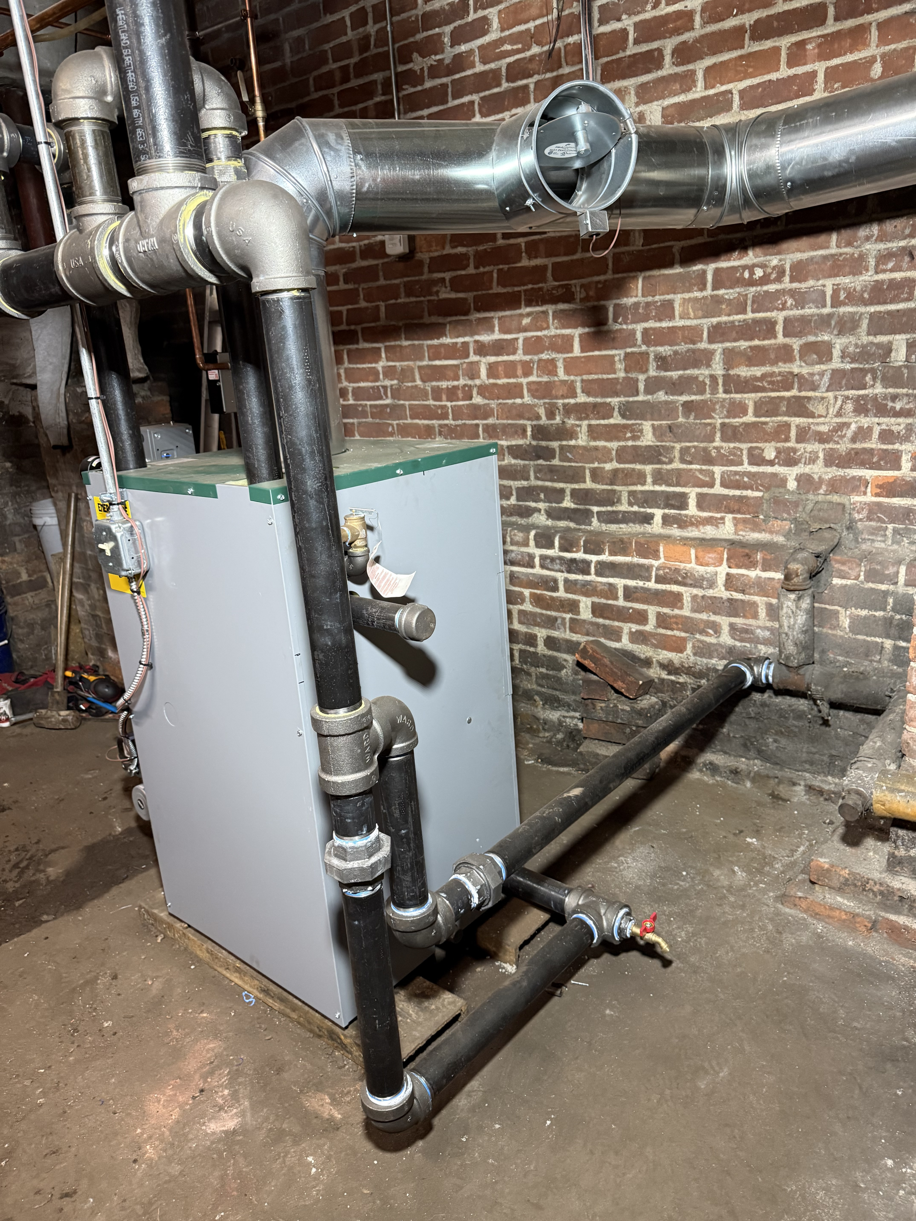

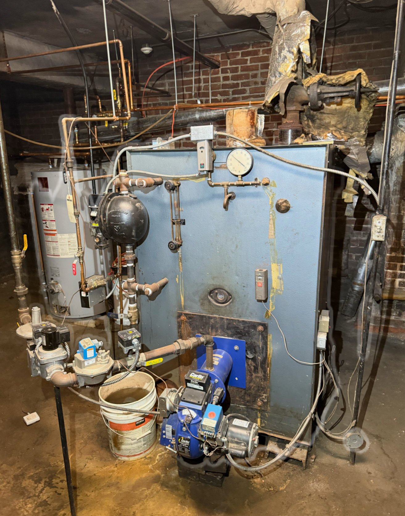

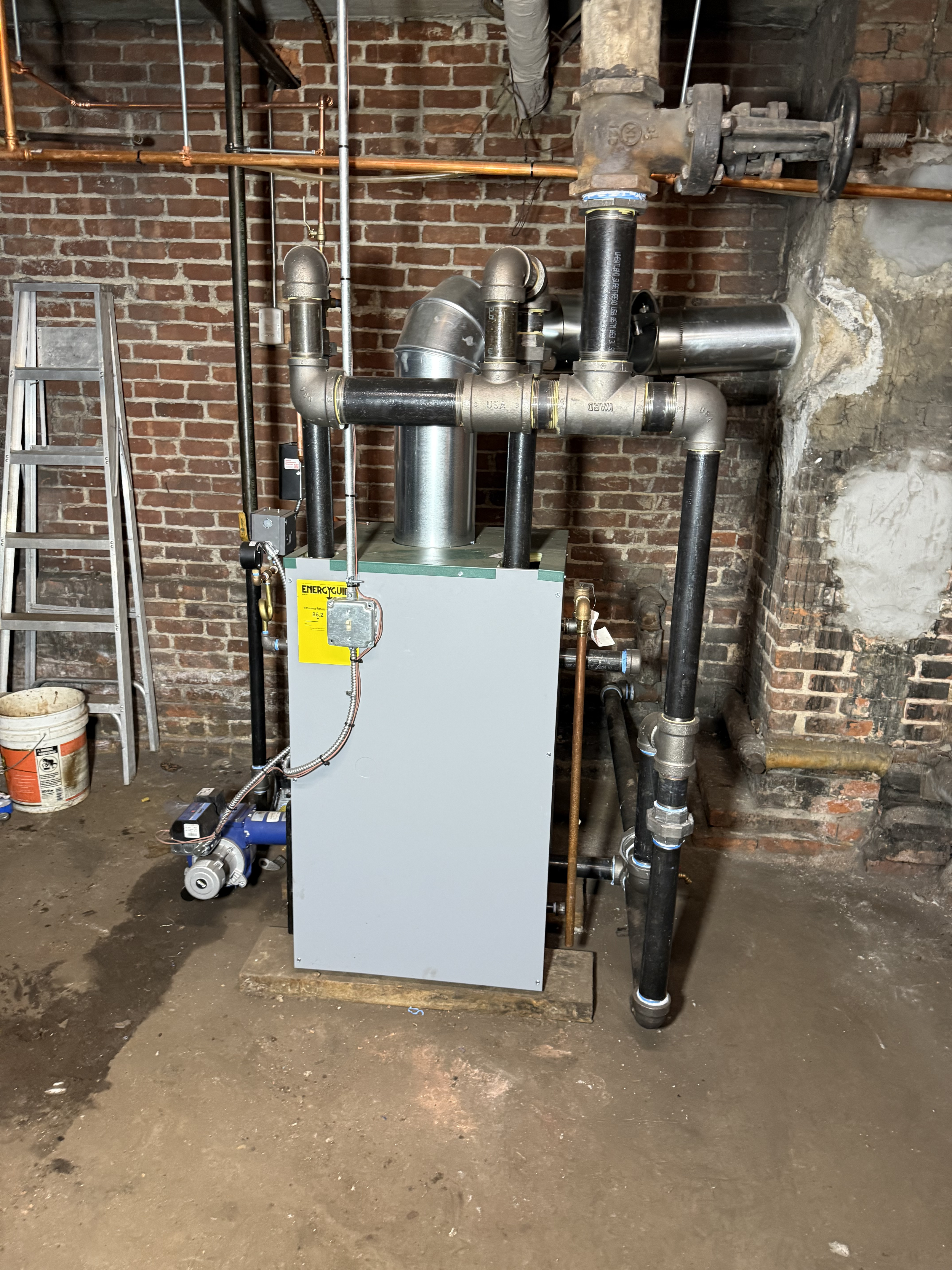

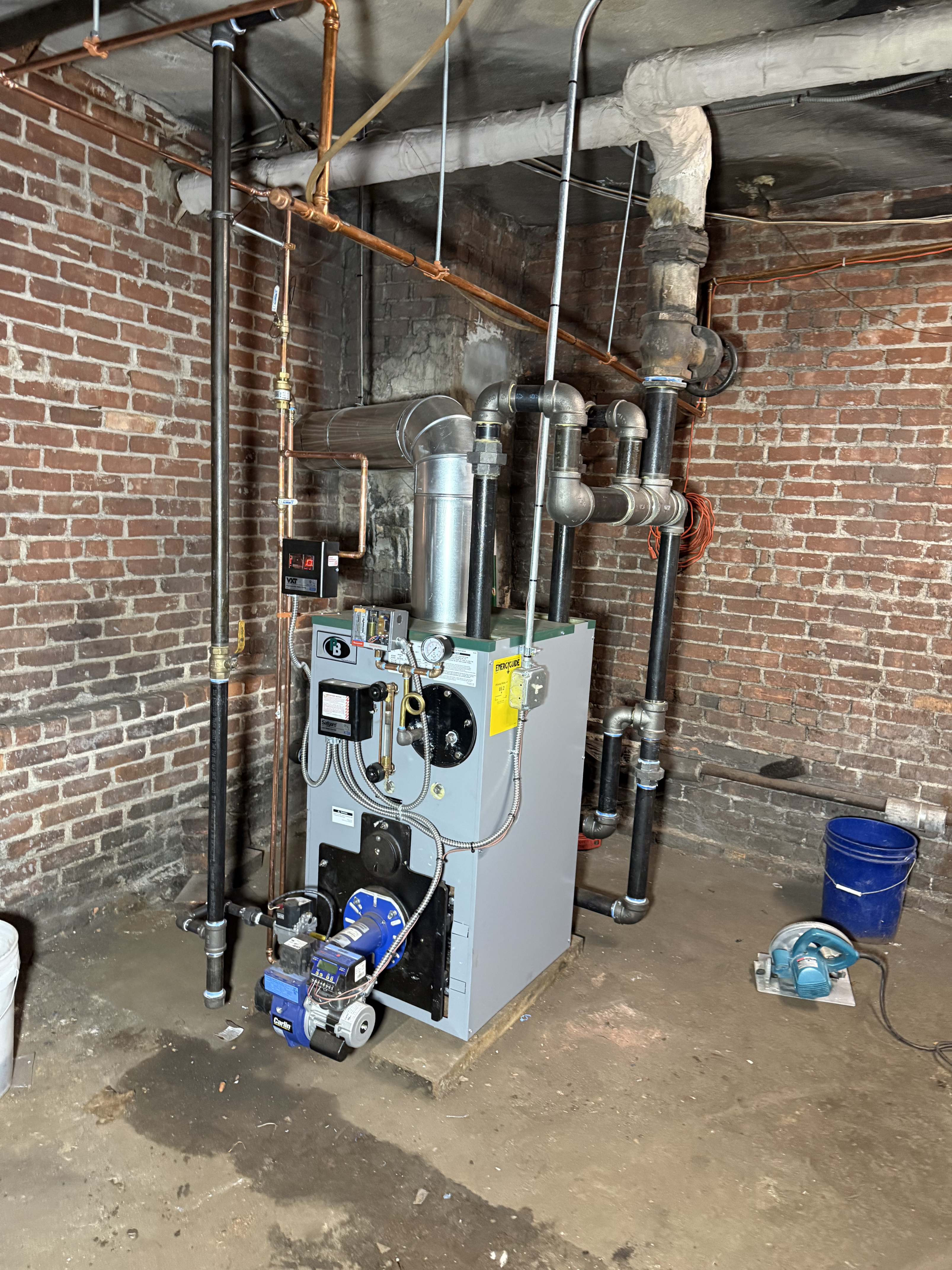

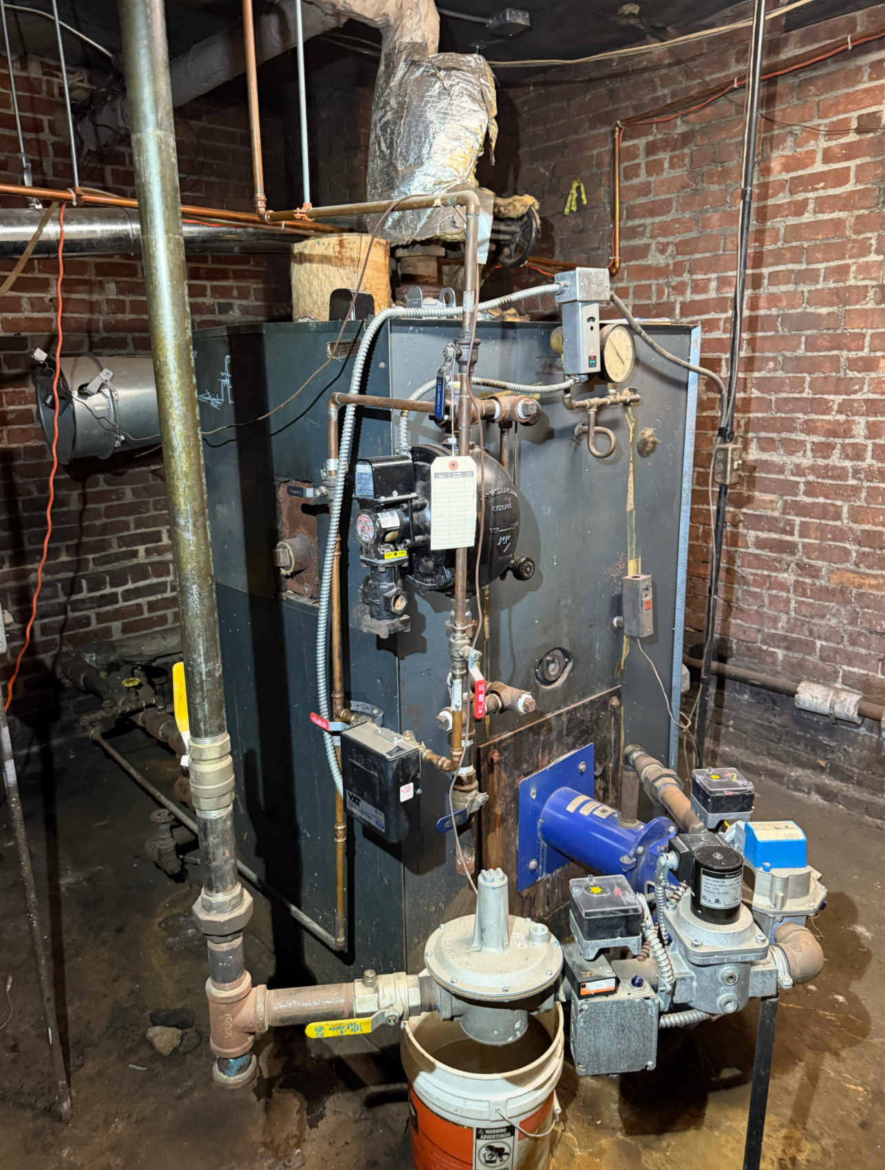

Our two day job, and pulling the old boiler was a real treat.
Yesterday evening I flung some romex and heated up the building a couple degrees (then shut it down- no controls at all)
This morning I get there early to fire it up again- building management system said the sensor was reading 64. Ran it for 2 1/2 hours before the electrician got there, it reached 71.
We cleaned up the boiler room- took some junk that the previous people left behind.
We maxed out the little EZ Gas with a 7/16” drill bit
We left it nicer that how we found it 💯

    The new boiler has a much simpler gas train. Is it smaller capacity, or has the code changed?
    Bburd
    GW
  • GW
    GW Member Posts: 5,211
    it’s definitely smaller- but I could not clock the old boiler- the building has a commercial meter. Well, I did clock it, but I don’t know how to convert the time into BTU
    The old boiler had a giant Carlin 601 gas burner, rated 700,000 to 1,500,000 BTU
    This one’s burning it about 275,000

    Wow. The old one was massively oversized!

    @bburd gas trains change at 400,000 btu (actually 399,999) over that number you need high and low gas pressure switches and double gas valves. Anything under 400k is treated like residential.
    @GW
    looks really nice!!!
    You wouldn't think it was the same boiler room!!!
    Amazing how much the old boiler was oversized.
    How did you get the old sections out?

    it sure was. The irony- a somewhat well known commercial boiler contractor quoted the job, like for like! Same pipe connections, no header or equalizer or Hartford! Same giant Carlin 601.

    We did a combination or diamond cutting wheel, sawzall, and sledgehammer. Even pulling the “half sections” wasn’t easy.

    If someone asked the other contractor what EDR was they probably wouldn't have a clue.
