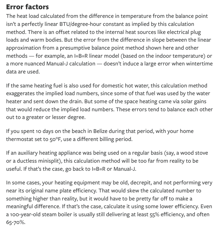

For existing structure, the quickest and most accurate heat load is from fuel use. Older houses have too many unknows for any Man J type of calculation to be accurate. In case of fuel use about the only error is boiler efficiency, DHW loads and passive solar gains.
The math is pretty straight forward:
https://www.greenbuildingadvisor.com/article/replacing-a-furnace-or-boiler
If you want even quicker, in zone 5,6, winter fuel use in Therms X 42 is about your heat loss. So if you burn 1000Therms of gas, your heat loss is around 42000BTU.
2 -
If the home uses gas or LP for cooking, DHW the numbers will be skewed. Solar gain, wood stove, indoor gains also.

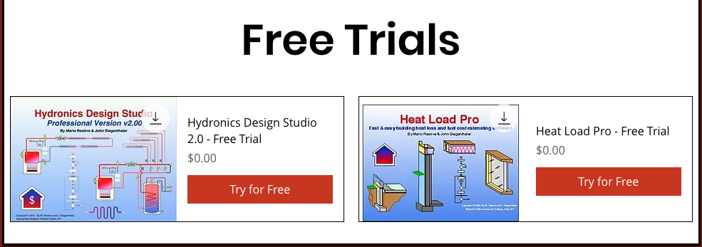

The online load calcs are quick and easy for a double check.
usboiler.net has one
hydronicpros.com has a free trial version
If you are old school and have a tape measure.
