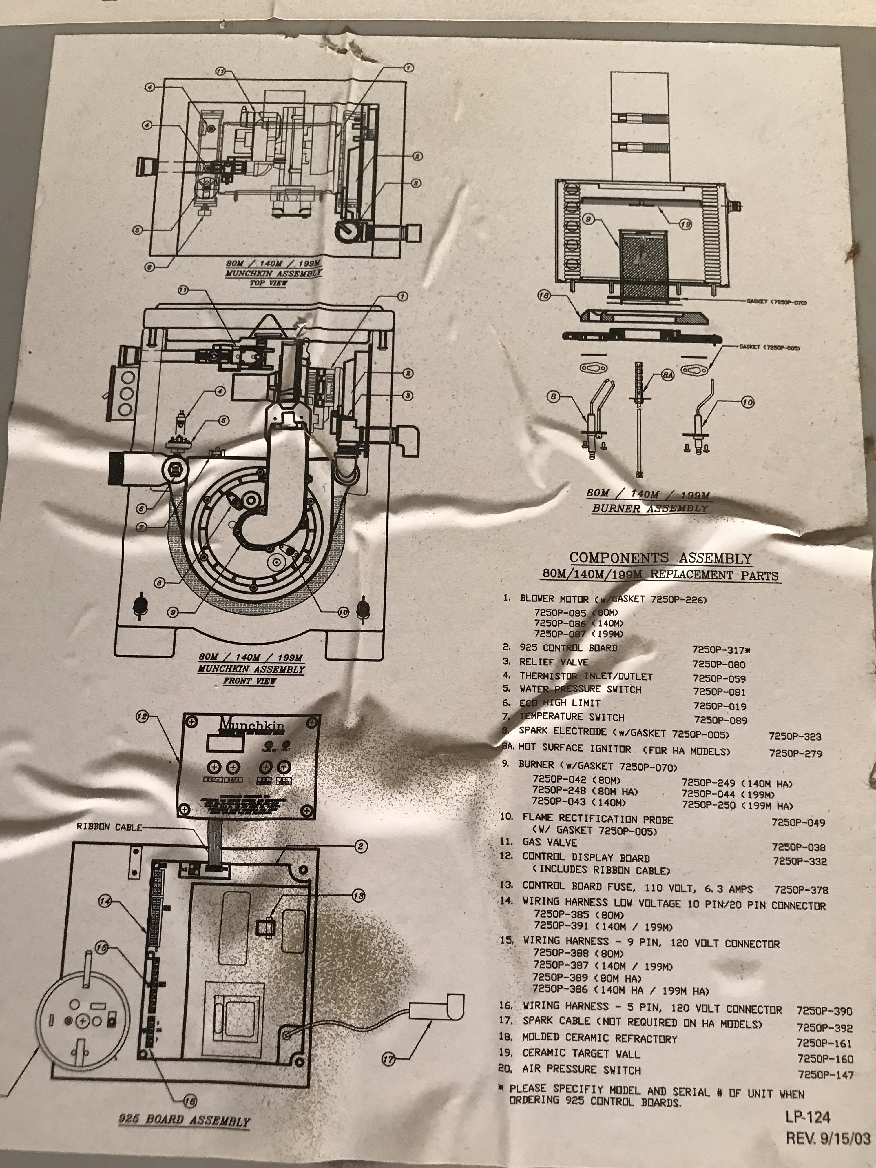

I know this question has been asked a million times, but I figure as time goes on it can't hurt to see what's new in the marketplace and who the more reliable brands and manufacturers are. I have a Munchkin natural gas boiler (I have attached some label pics to hopefully give as much specification information as possible) that is coming up on 20 years of service. I have not had any issues with the boiler function directly (I have been told I may need a new blower motor because this one does not 'spool down' correctly when it shuts off…whatever that means?), and any service I have had is related to manifolds, zone controllers, etc.

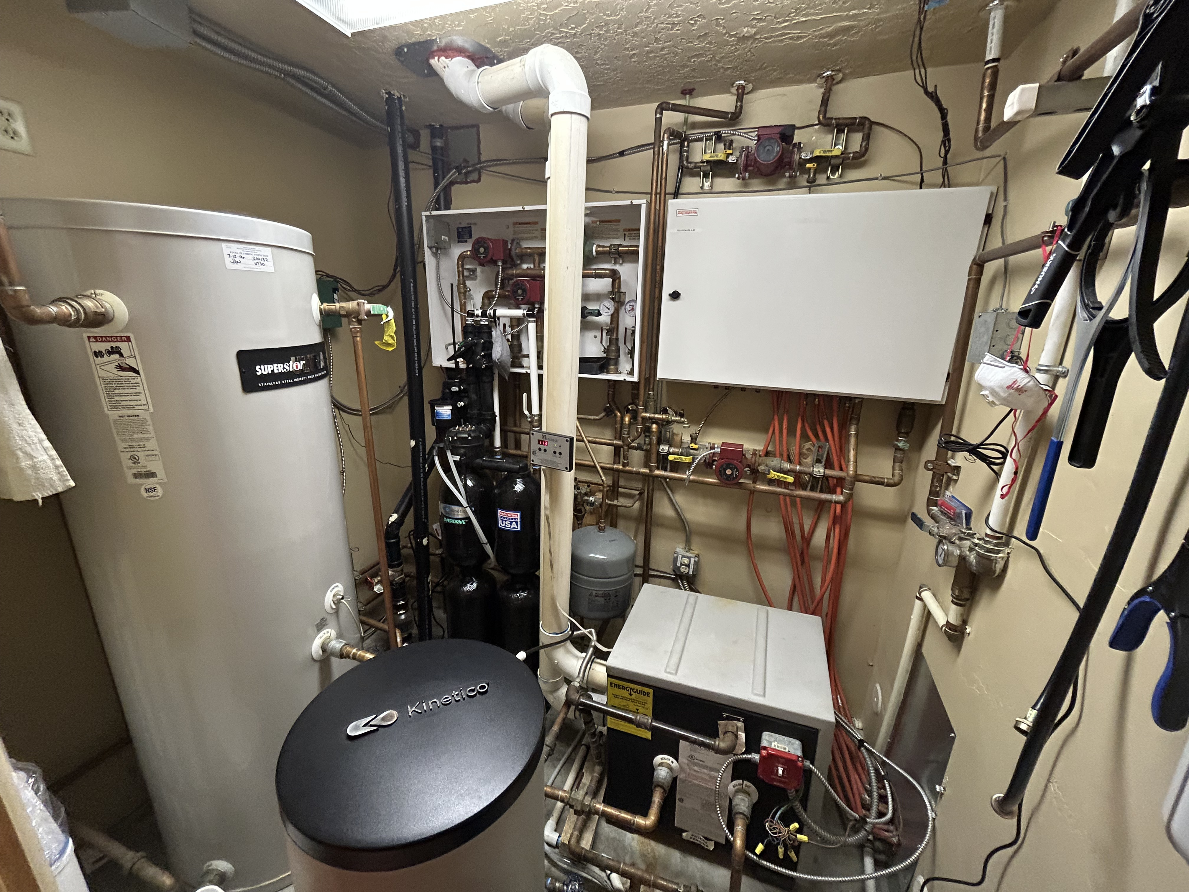

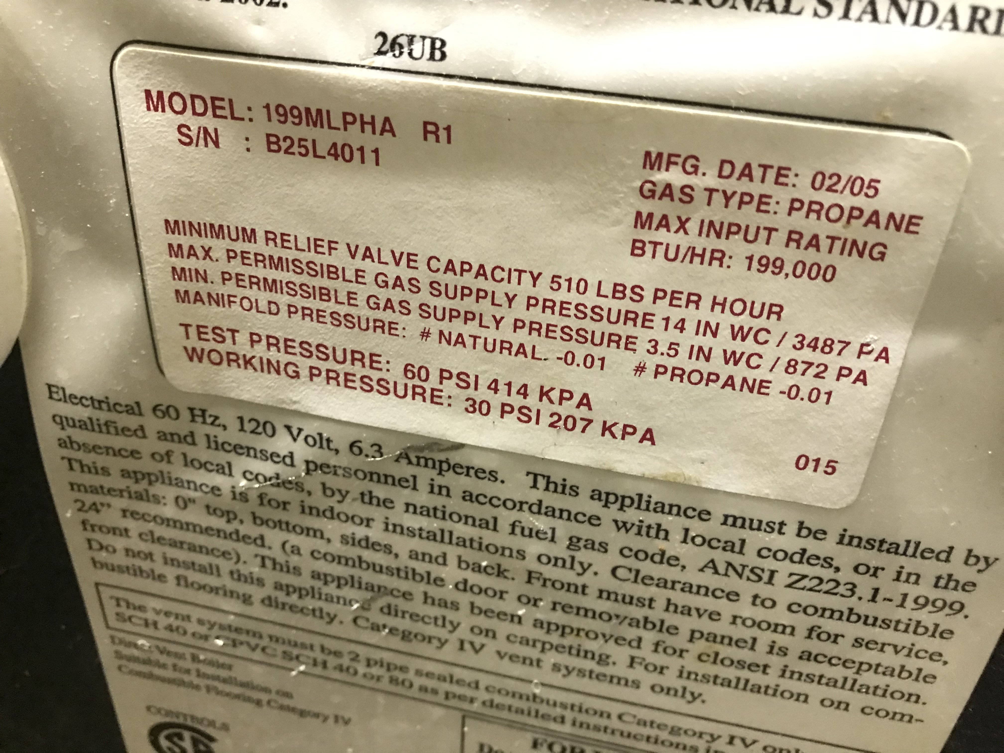

Here are some pics. I did talk to someone who said this unit was for HA (high altitude) use and also LP (liquid propane). I was told that regional suppliers in this area would purchase units in this format and then convert units as needed upon installation requirements. I am at 3,000 feet so not high altitude, and I have natural gas to my house, not propane.

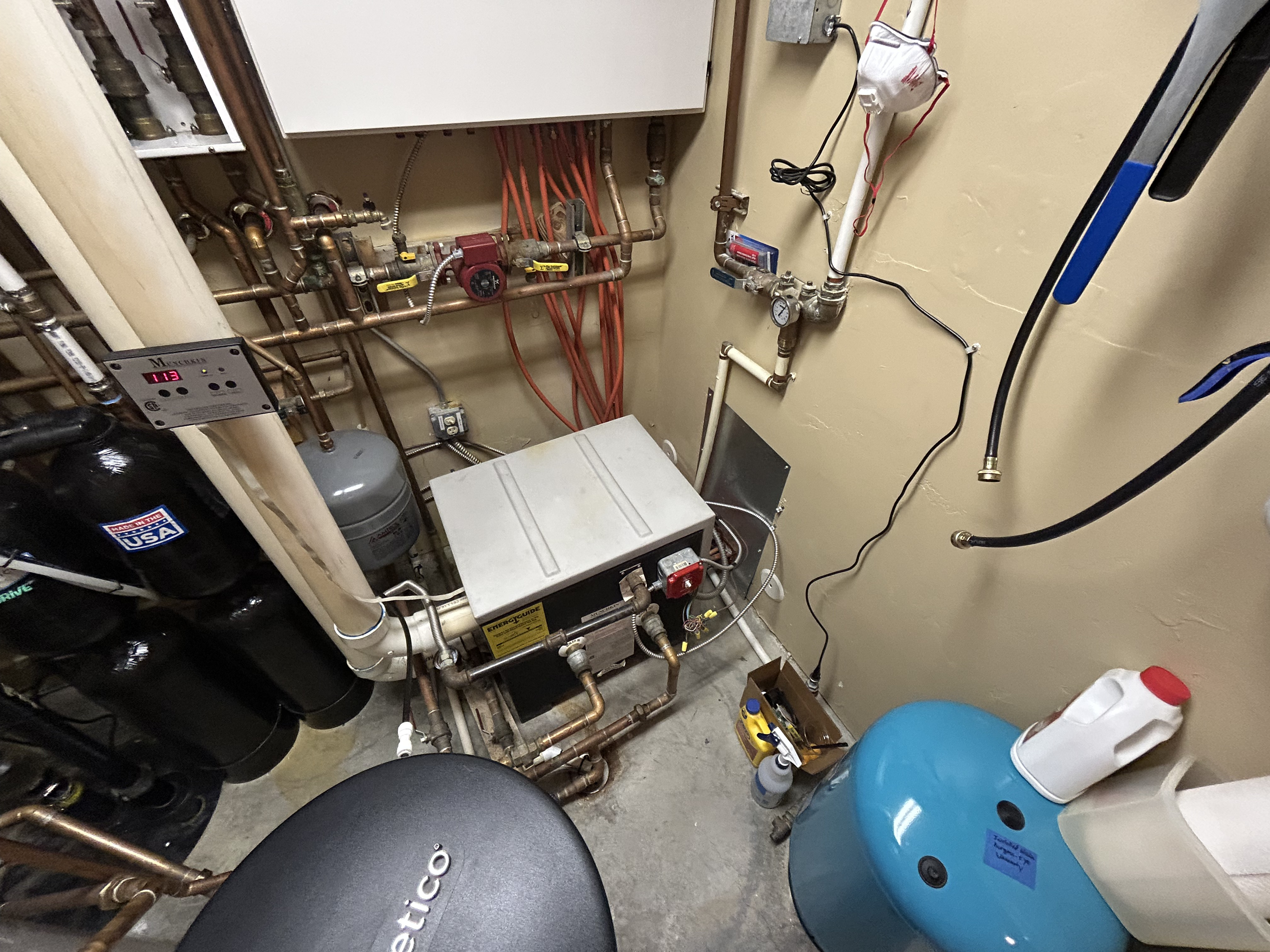

    Can you show the boiler piping? If its just a boiler swap, it shouldn't be difficult to adapt to the existing piping.. It being radiant has nothing to do with it.

  • Sure thing. I have attached some pics of the maintenance room. I would think a new wall mounted unit up on the wall to the right of the Munchkin on the floor as it sits would be a better location. So yes, lots of new piping and new venting.

    A small wall hung would clean up that room.

    A wall hung unit would make that room a grand hall! Okay, Idaho Falls (Magic Valley, Sun Valley Ski area) is 2.5 hours away from where I am (I'm 10 miles north of Boise) and if memory serves they do have more contractors in that area, but they don't service me. That's the problem. When people think of Idaho they think of cold and lots of snow and boilers and radiant heat is great. I'm in the one part of the state where that's not true (SW Treasure Valley, high desert valley..gets cold but not like other areas of the state).
