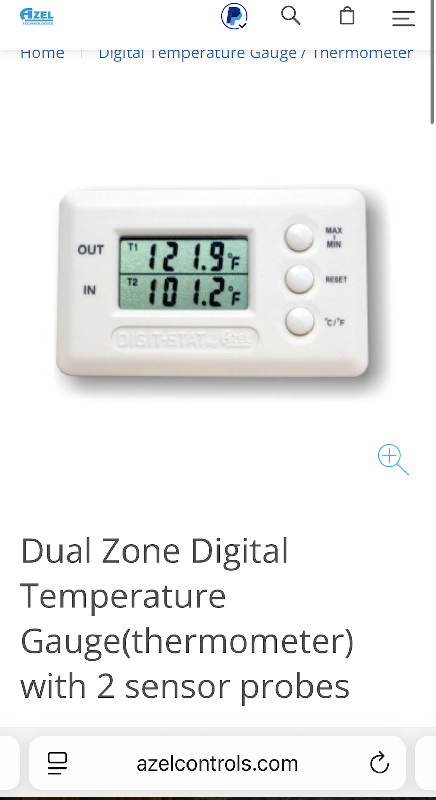

    hot_rod Member Posts: 28,011
    A zip tie, better yet a hose clamp is a simple way to connect any temperature sensor to a pipe. Insulation over it is critical for accurate readings. Tekmar sensors, on left, actually have a flat spot to clamp on pipes.
    This Azel is a handy temperature gauge, battery operated or 24VAC
    It reads supply and return to give you good info. Find them from various online sources.
