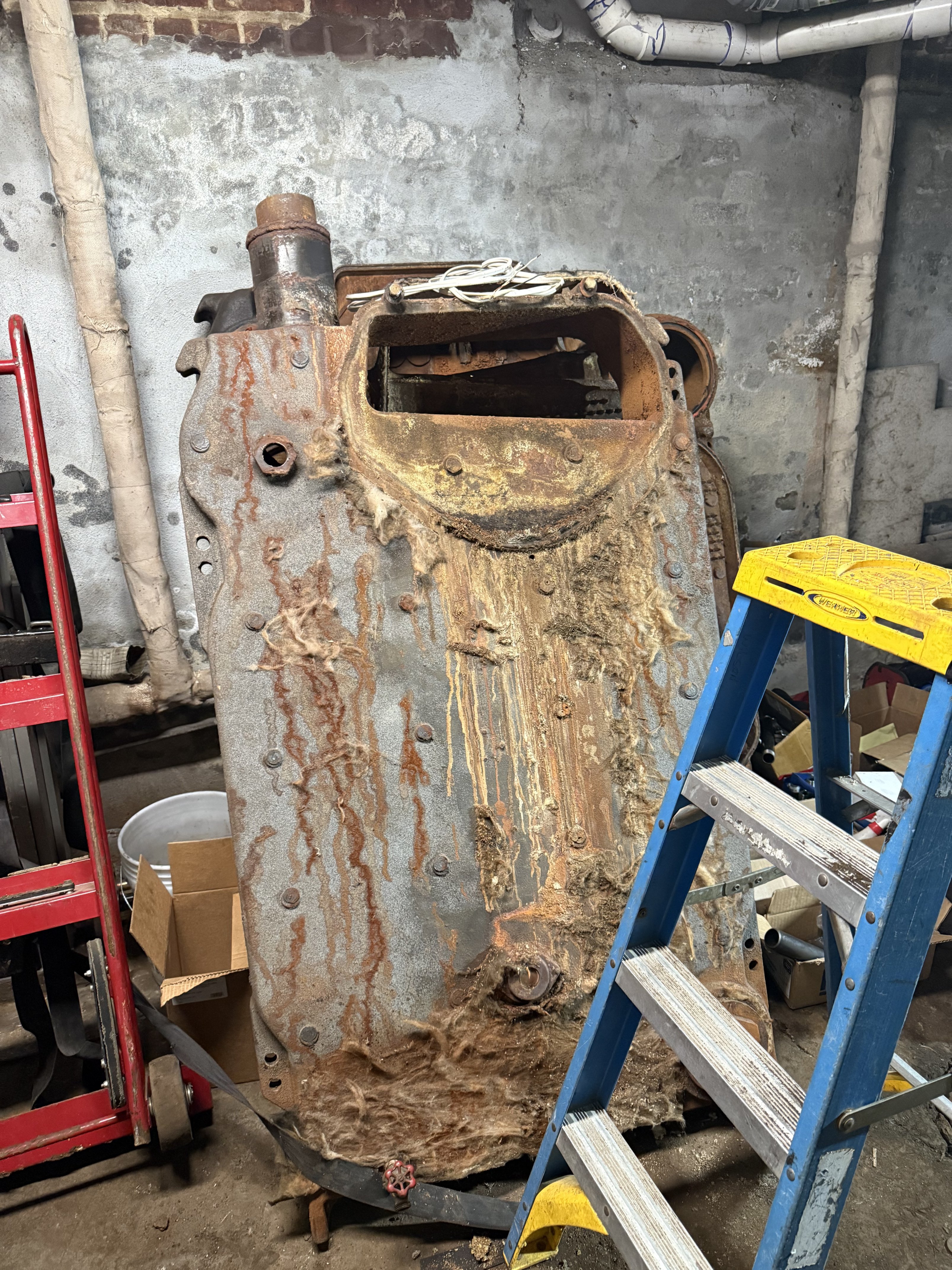

Getting rid of the old boiler sections
Help-

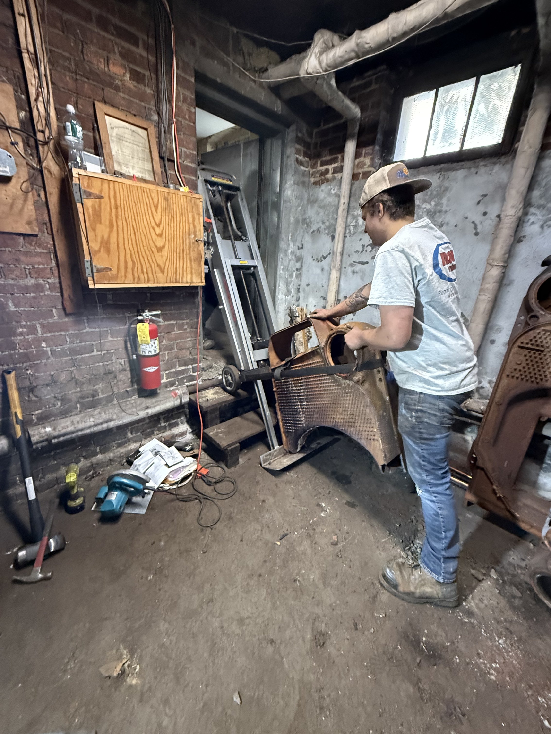

It’s at least a couple decades since I’ve removed one of these hogs.
59 inches tall 36 inches wide, very heavy. It’s not looking good to get them out unless we break them.
cutting torch the only way to do this or is anybody have any other ideas?

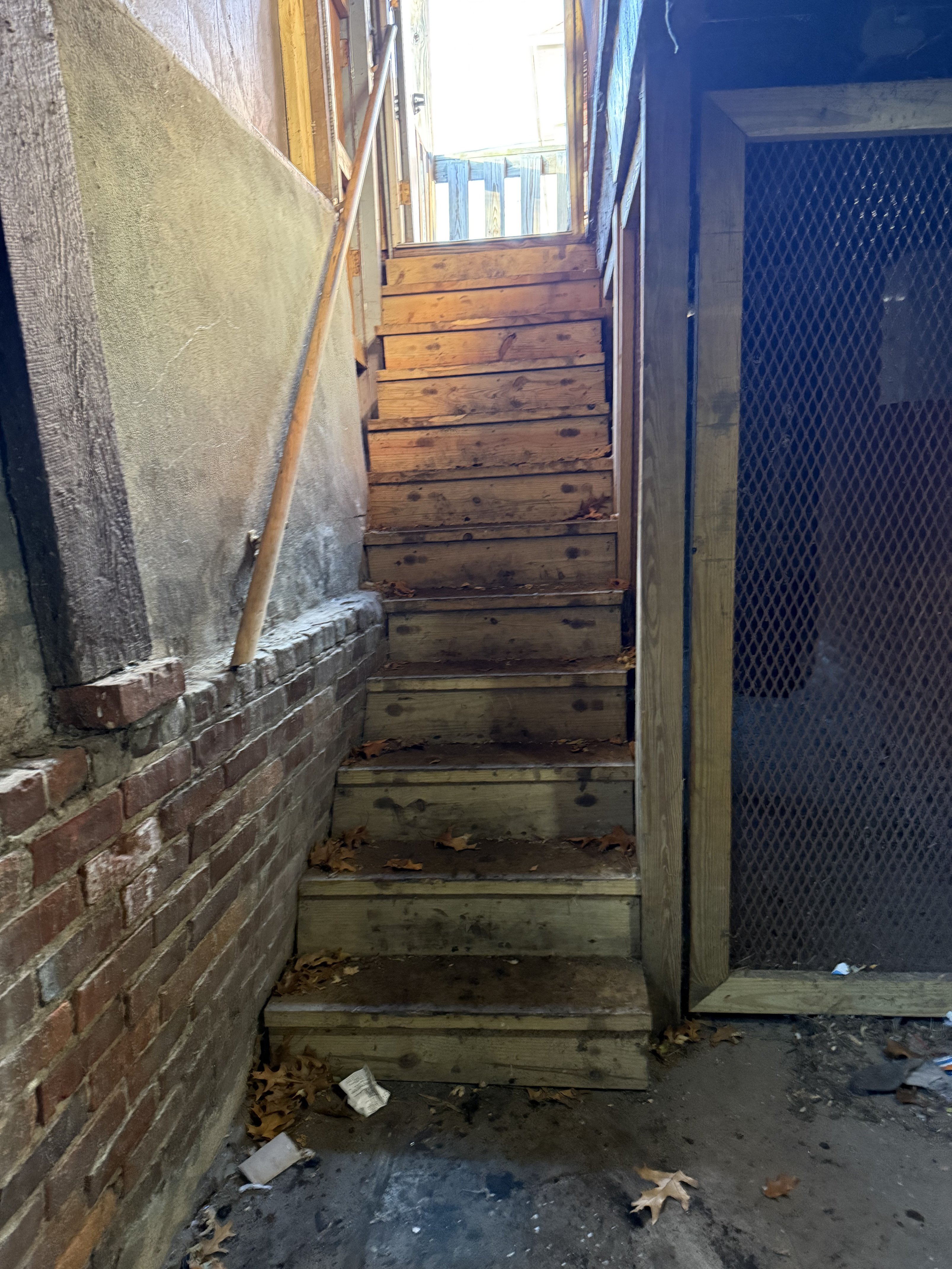

Unfortunately we have to go up a flight of (working) stairs

    Or a sledgehammer. Or hire movers to deal with it.
    GWethicalpaul
    HVACNUT Posts: 7,784
    Hand truck. 2 guys up top, 2 guys on the bottom.
    GWSTEAM DOCTORclammy
  • GW
    GW Posts: 5,259
    Hand Truck, it’s a little sketch because a little bit of movement in the section will flop to the the left, the front and rear section must be 500- 700 pounds. I’m guessing
    Gary Wilson
    Wilson Services, Inc
    Northampton, MA
    gary@wilsonph.com
    Hand truck and 4 guys. Or cut 1/2 way through with angle grinder the hit with a sledge hammer.
    Can you hang a chain fall at the top of the stairs. Cut a hole in the plaster or drywall. Drill a joist with an angle drill and push a piece of 3/8 wire rope through the hole and put wire rope clips on it.
    If the stairs are not too steep and the stairs are straight outside you can hook a come along or a winch to a truck. Make a trough of 2 x8s or 2 x10s and nail some sheet metal to the bottom with flat heat roofing nails and winch them out on edge.
    another way is to lay 2 x6s on stairs and lay the sections on them flat. Pull them up the sections will dig into the 2 x 6s and the whole works will slide out.
    I have done Smith 28s where the F & B sections are 800#. Those Burnhams are smaller probably 500# each
    Cutting torch is NG on cast iron won't work.
    GW
    Any turns on the stairs? Open underneath? Can you add 2x4 supports, Hand truck and rope it? I've had to split many boilers to get them out, but I've never had to smash the cast iron. I have however been in a few basements where the old behemoth was just moved into a corner.

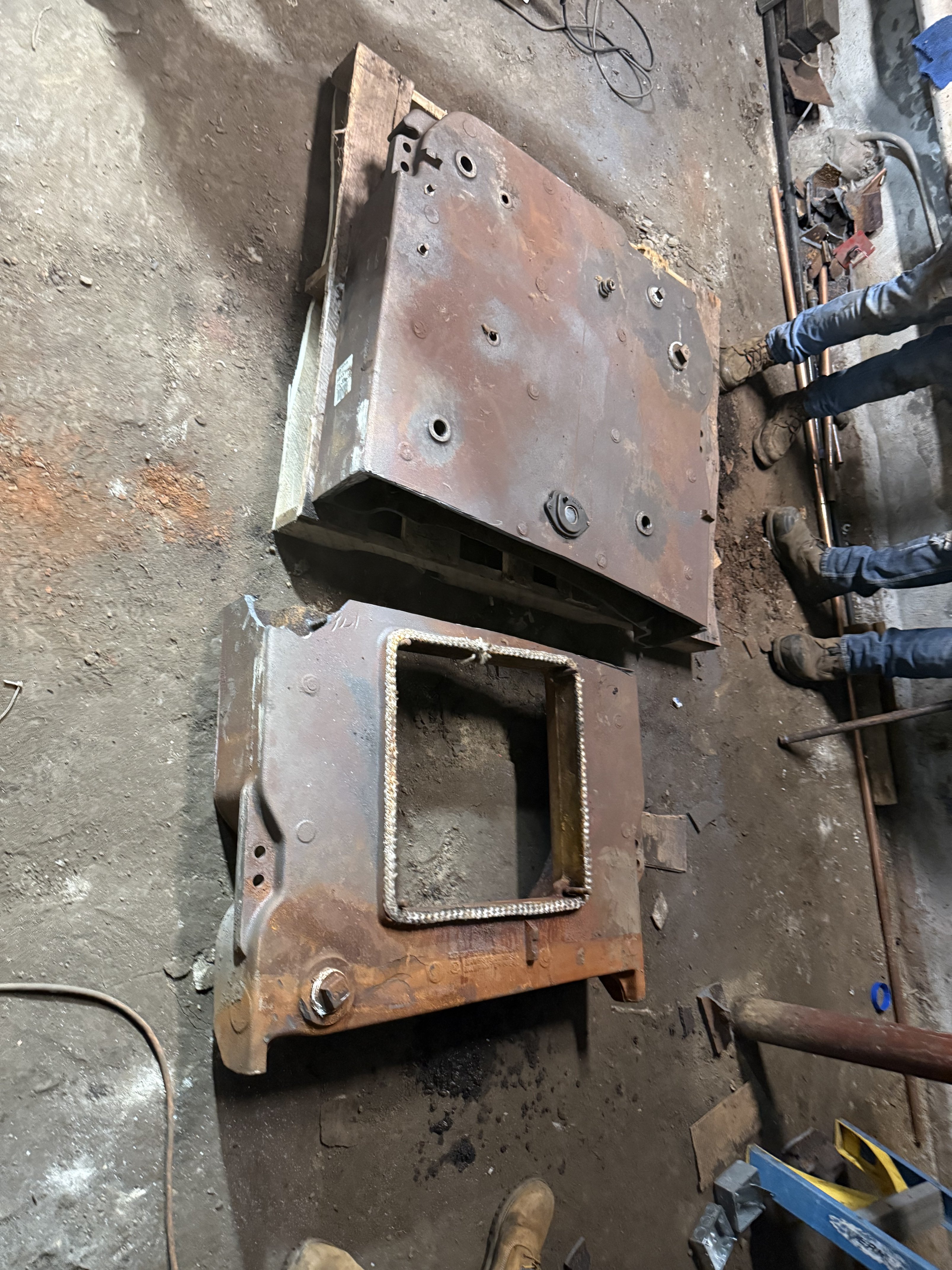

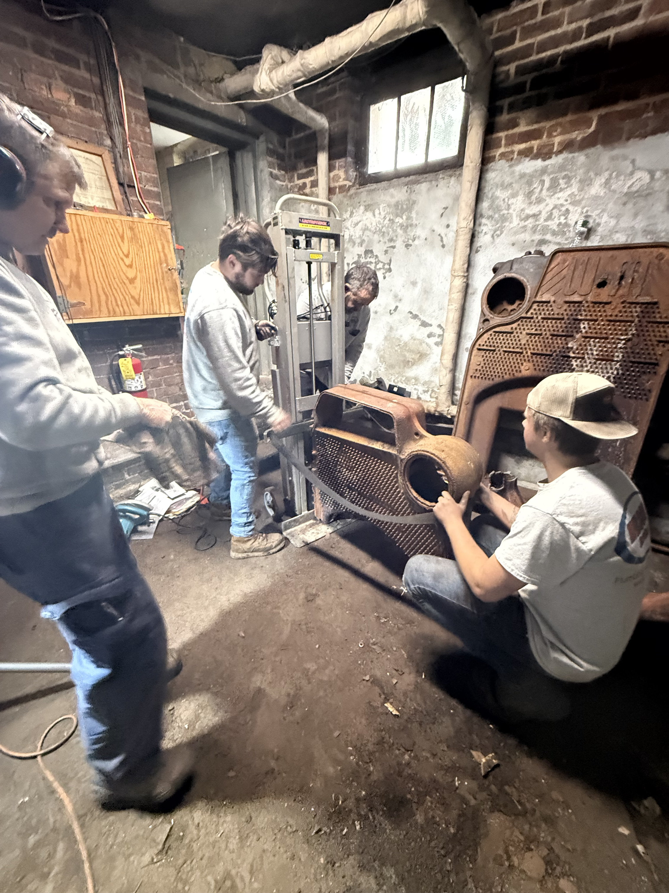

    old school labor, we got it all out. I’ll post some pictures once I clean the soot off my face and put some food in my head.

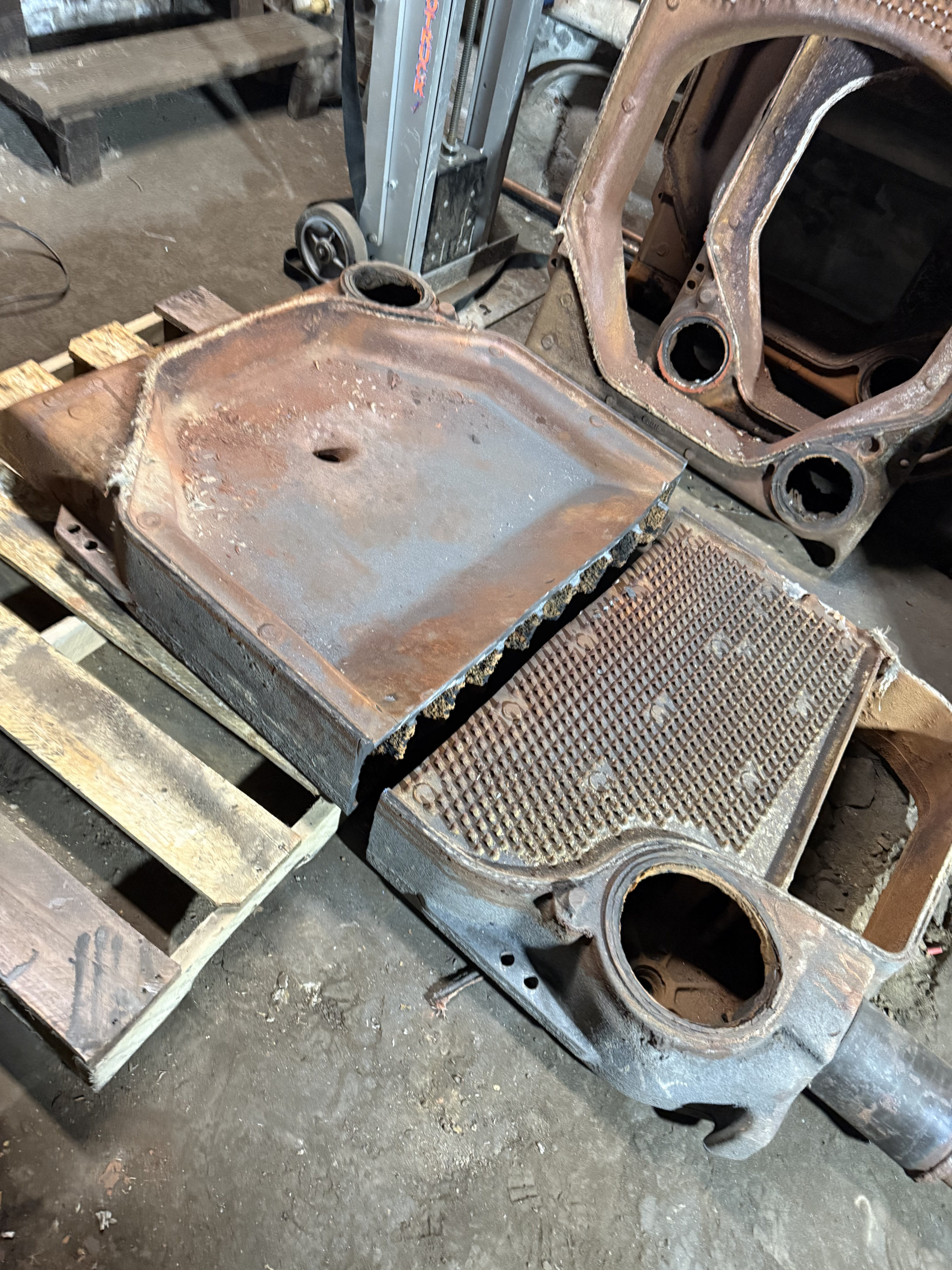

    GW Posts: 5,259

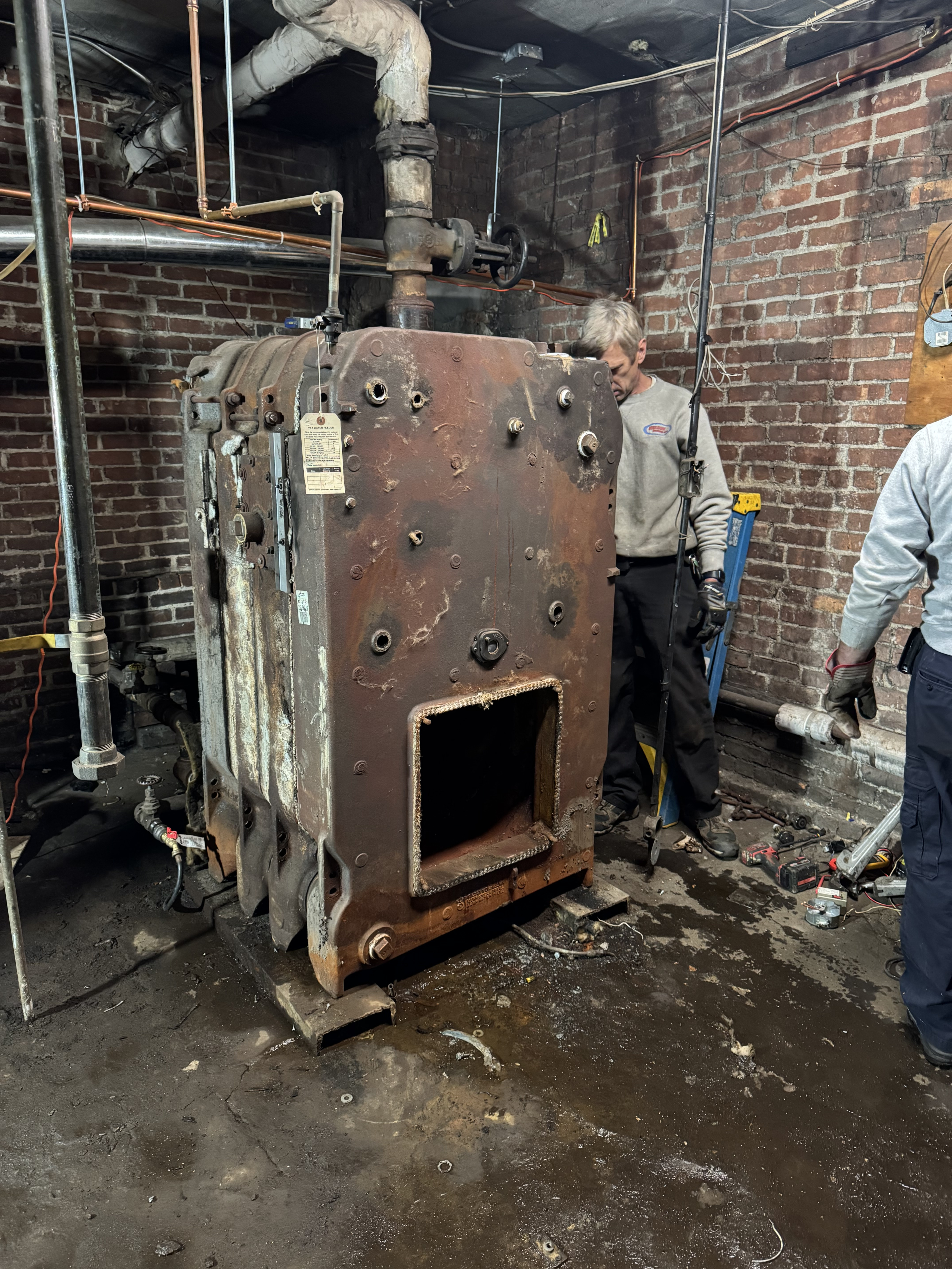

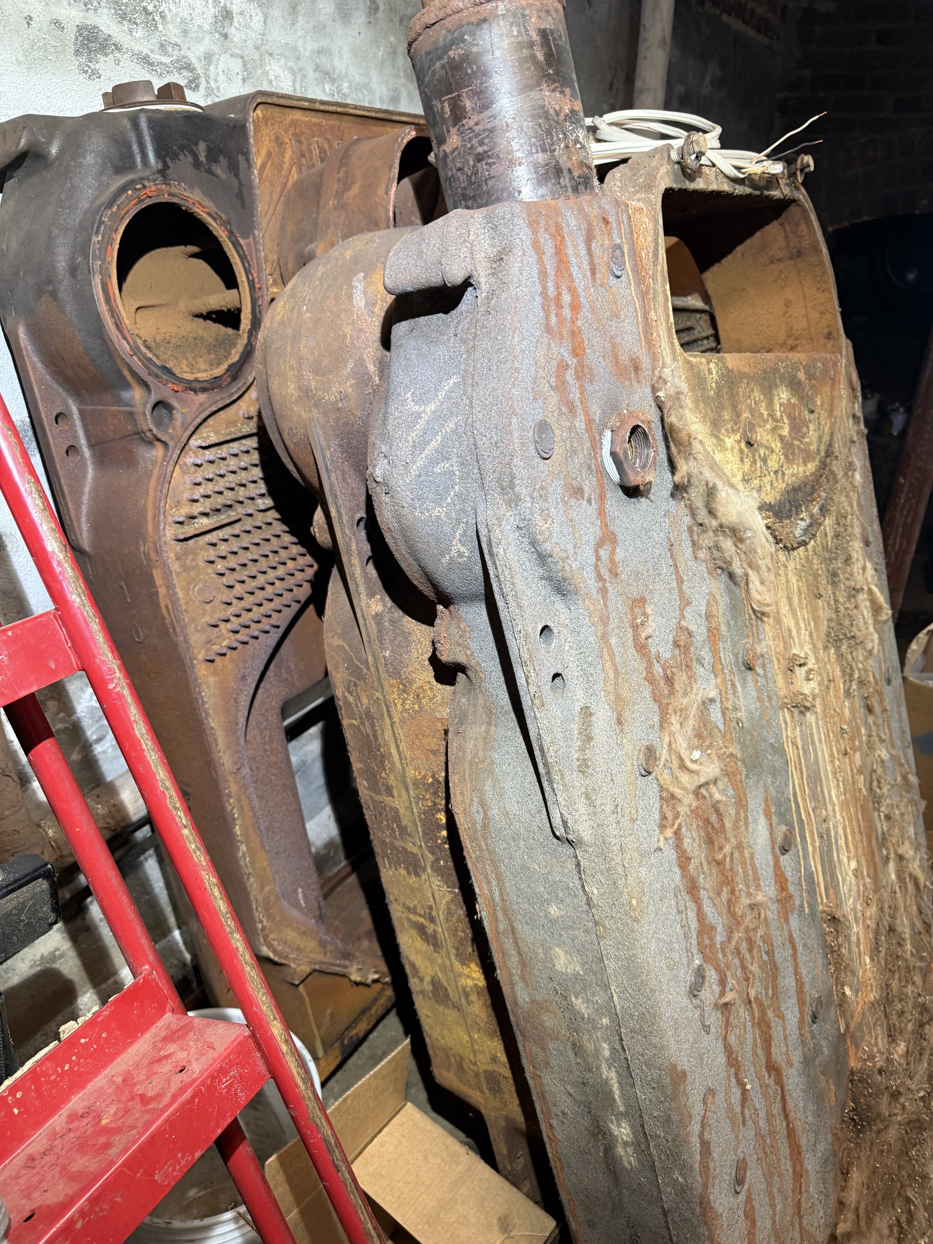

    IMG_1111.jpeg IMG_1121.jpeg IMG_1120.jpeg IMG_1122.jpeg IMG_1123.jpeg IMG_1124.jpeg
    a combination of cutting with the diamond wheel, a little sawzall action with the expensive Diablo blade, some old school sledgehammering.

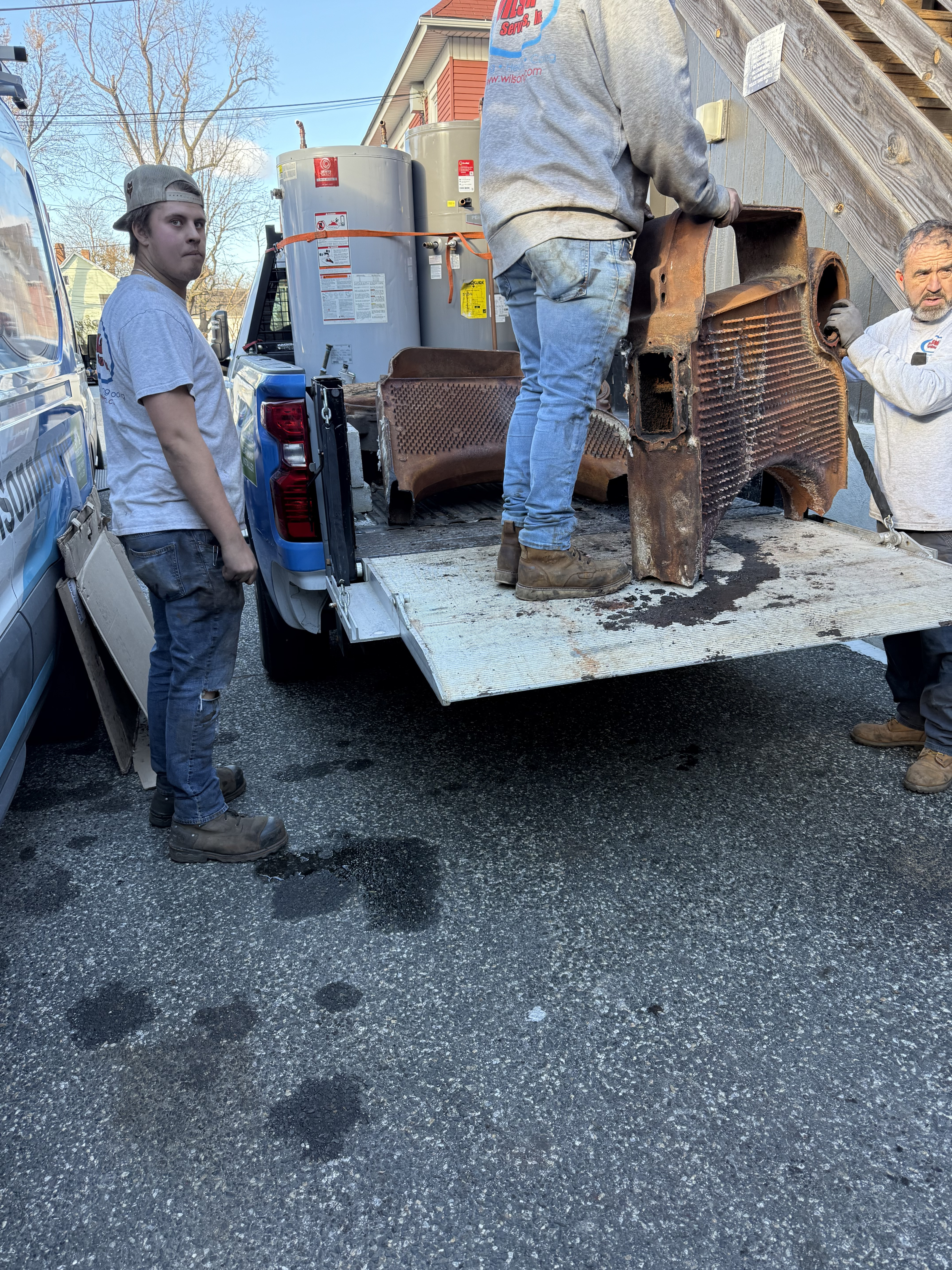

    GW Posts: 5,259
    @HVACNUT yes these sections were pretty big.
    we normally haul all the metal stuff back to our shop, and then hand it over to our Scrap guy.
    This was a unique situation, larger than average rip out for us.
    This job is going directly to the scrap yard. we don’t have time to hand it over to the Scrap guy, it’s coming off our truck just once- the Scrap guy will lead our help load it into his truck.
    Plus, I’m dying see what the weight is, I’m gonna guess 2200 pounds
    we packed everything in the pick up truck minus the front section. We did haul it outside, but the pick up truck was starting to sag. We probably should not have loaded those water heaters, oh well

    @GW
    LOL that's why I am in the shape I am in. Bad shoulders, bad neck.
    I think your 2200lbs is probably spot on
    Looks like you had a set of narrow nasty steps to deal with. They look solid though.
    or at least new. 50/50 on if they're solid
    Yeah that's a tough one.

    2400 lbs! We specifically dropped off the boiler by itself. Two trips. The front section was 700 lbs
    $168 for all that work😫
