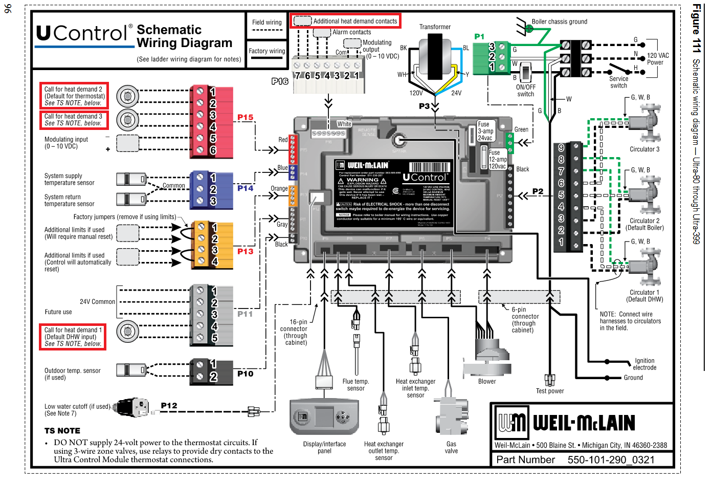

    109A_5 Member Posts: 4,068
    edited November 2025
    I'd start when it acts up (which seems consistent) that the thermostat voltage is present when expected and the power to the UControl module is normal also. You would need a multimeter and measure AC Volts.
    I believe the Red boxes I added to the image below are the 4 thermostat connections. Once it acts up I would verify for all 4 thermostats that the 24 VAC exists with no call for heat and the 4 inputs individually drop to 0 (zero) VAC during a call for heat. Also I would verify the 120 VAC at P1 and 120 VAC and 24 VAC at the transformer connector P3 when there is a call for heat and the boiler does not respond properly.

    Agree, need pics. You said only 2 zones being used for the second floor. The first floor and basement have mini splits, no radiators or baseboard. So how do 4 thermostats go back to the boiler? There must be at least 2 external circulators. One boiler circulator right on top of the boiler, and a system circulator for the second floor loop(s). Pics please.
    In the diagram @109A_5 posted, there should be wires at terminals 1 and 2 on the P15 block. Check the wires and block are secure. Then work your way back with the thermostat wire and tighten any connection or splice all the way back to the thermostat.
