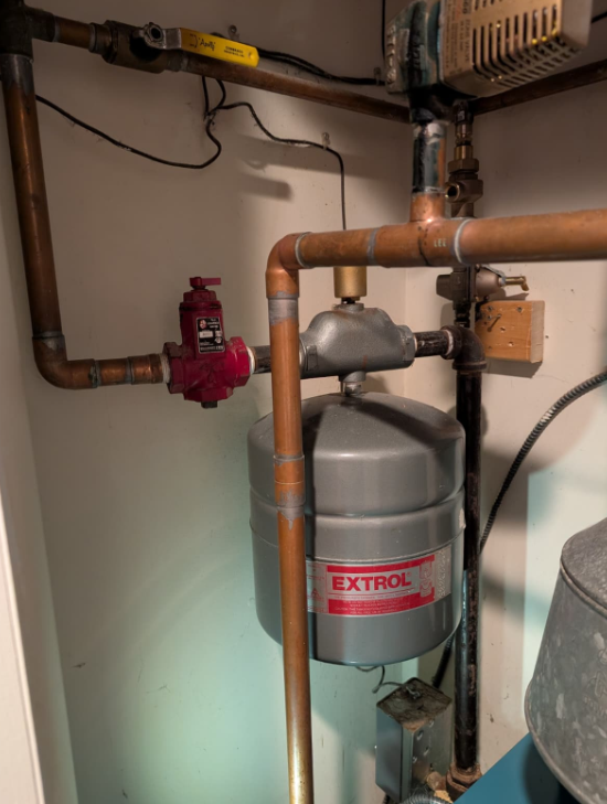

I noticed there is a red flow control valve near the expansion tank, what is the purpose of that valve and could that be a culprit? if not, what else could be causing the problem I'm describing?

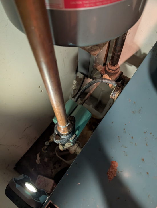

here is new pump:
This boiler is installed in a utility closet on first floor and extremely difficult to access…

    If you have zone valves then that red flow control valve serves no purpose at all. The circulator shouldn't be buzzing, it should be silent.

    Zone valves and a flow check should never be together on the same system. You can manually open the flow check by turning the lever on top and leaving it that way.
