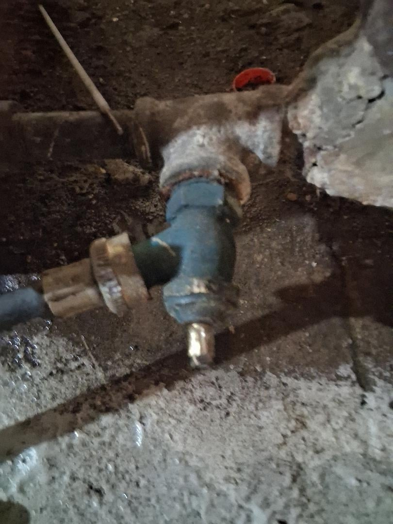

Anyone think i might be able to fine a washer maybe packing washer or stem for this valve? I don't want to try to remove the valve. It 100 years old. If something should break where it connects i am in deep do do. I am going to have to drain down the system to replace a gauge. the packing nut can be removed.

    hot_rod Member Posts: 28,078
    Why? A brass valve usually comes out of a galvanized tee easily.
    The stem looks pretty chewed, I doubt you will find a replacement without taking it out and shopping.
    Washer and also the seats go bad, not all seats are replaceable.

    scatgo Member Posts: 76
    I just might go for it. Ill soak it with some PB blaster for a few days. Thanks
    mattmia2 Member Posts: 17,905
    do you need the bib washer or the packing washer? the bib washer should be a standard size, the packing washer can be replaced with string packing. that boiler drain doesn't appear to be all that old relatively speaking.

    DanielDAY Member Posts: 42
    You could try opening it then getting some Teflon tape, twirl it up, pack it in, tighten everything back up, and see if it stops leaking. Not sure what’s wrong looking at the picture but maybe that will work.
    my guess the bib. when that first started tighing the packing nut did help
    where is it leaking, is it leaking from the packing or the spout?

    ScottSecor Member Posts: 1,053
    Do not waste your time trying to rebuild. It will come right out. As others have suggested, use two wrenches. Have new drain cock prepped and ready to install.
    if tightening the packing nut didn't stop that leak, while holding the valve closed, back off the packing nut, shove an inch to a couple inches of string packing in there and tighten it back down.

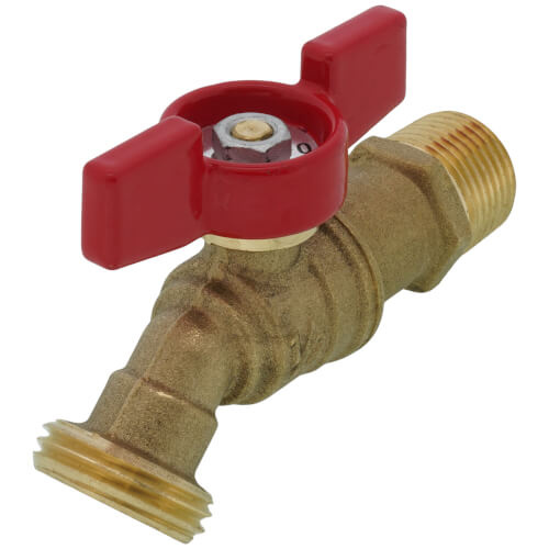

    Intplm. Member Posts: 3,131
    The stem appears damaged, and it's missing its handle. Replace it with one of these quarter-turn boiler drains. Doing so will eliminate any questions and future headaches.
    hot_rodscatgo
    Hit it with PB blaster a few times a day for a few days and it came out like it wanted to! Thanks for the help everyone.
