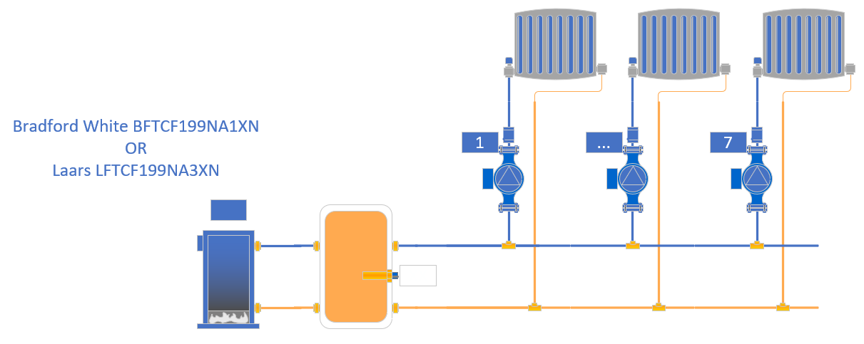

Decoupled buffer tank (four port)

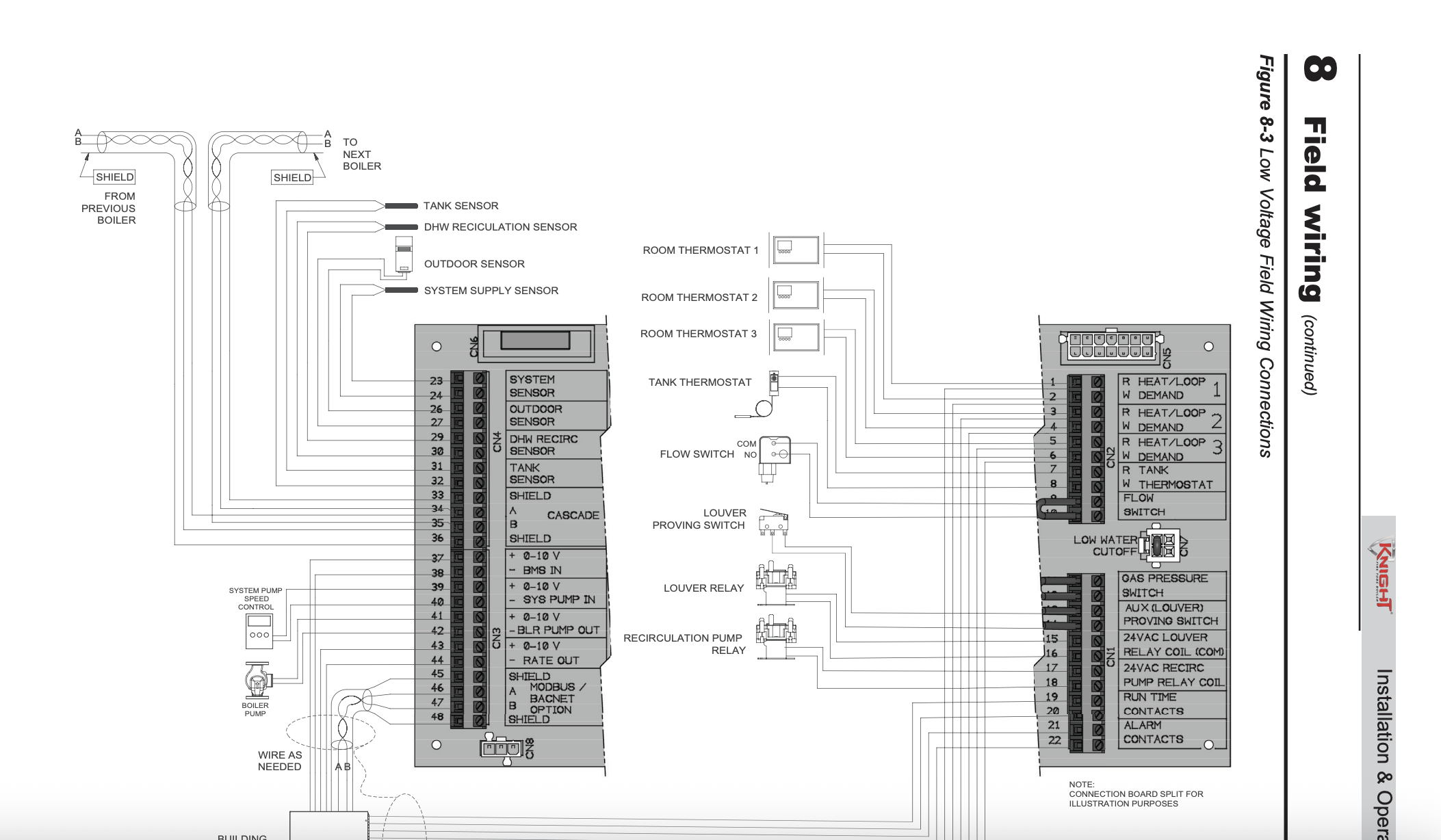

I'm trying to understand how controls work for a four-port buffer tank. The right side seems straightforward - thermostats and switching relay have zone circulators turn on and "call for heat" isn't needed since the water tank is always hot (goal is 140F-180F as panel radiators are designed for 160F at present).
How are the aquastats set up to maintain the buffer tank temperature? I feel like I'm missing something simple.

    As for control. Some boilers include an extra sensor the could be used as a system sensor. Manual indicates DHW sensor is optional;, maybe a boiler sensor also? It's probably the same sensor for either DHW or system. It just reads a temperature.
    That sensor goes in, or on the buffer tank, mid point. It tells the boiler to maintain the tank temperature.
    If you use ODR the tank will be held at a temperature based on the outdoor temperature.
    A basic relay box, ideally Caleffi ZSR :) for the 3 pumps,
    In this case the relay box does not fire the boiler, the boiler only sees the tank sensor as it's call for heat. Come warm weather the ODR should shut 'er down, tank goes cold.
    Here is the control wiring for the Laars, lower right shows the system sensor connection.

  • Nothing plumbed or ordered yet (except I ordered one panel radiator and some hePEX).
    I will read more into the 3-pipe option. I think the "DHW sensor" is for the DHW recirculator setup. Does the buffer tank aquastat get wired similar to an aquastat on an indirect tank?
    It's actually a 7-zone setup (I took a shortcut on the diagram) - perhaps overkill, but the house was originally set up as electric heat, so there's insulation in all the interior walls and between interior floors. Plus I was concerned that the fireplace insert would throw off a single-floor thermostat when used.

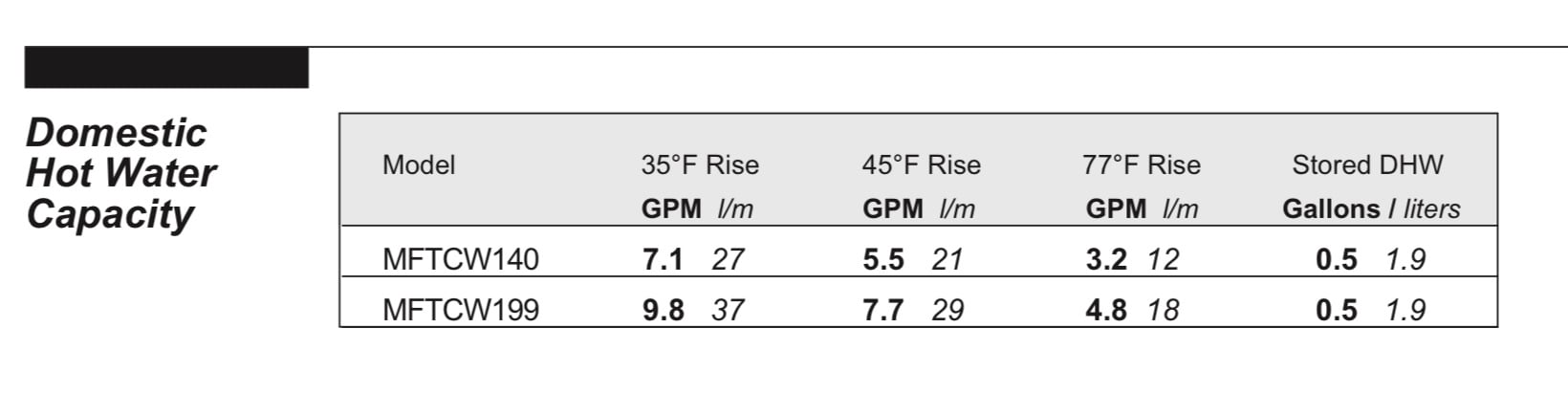

  • CoolCalc says ~51,000. That particular model only comes in that size plus I want the combi (limited space for indirect tank) and have well water. Smallest zone just under 3800.

    The boiler needs to size to the largest load. In some cases the DHW is the largest load.
    Once you define how much or how quickly you want hot water. I doubt most people think about that, until they don’t have enough hot water.
    The 199 could give you 4-5 gallons per minute based on 50-55 well water at a 77 rise. So itwould keep up with a standard 1/2 tub filler, or two showers running.
    You use hot water differently with a combi or tankless.
    With any tank type you fill a tub or run hw until it runs too cold, wait for it to recover. With a combi it just keeps providing as long as you want to feed it gas or lp.
    DHW production tends to taper off as the HX gets scaled, add the flush valves, knowing that you will be descaling based on water hardness and how many gallons pass through

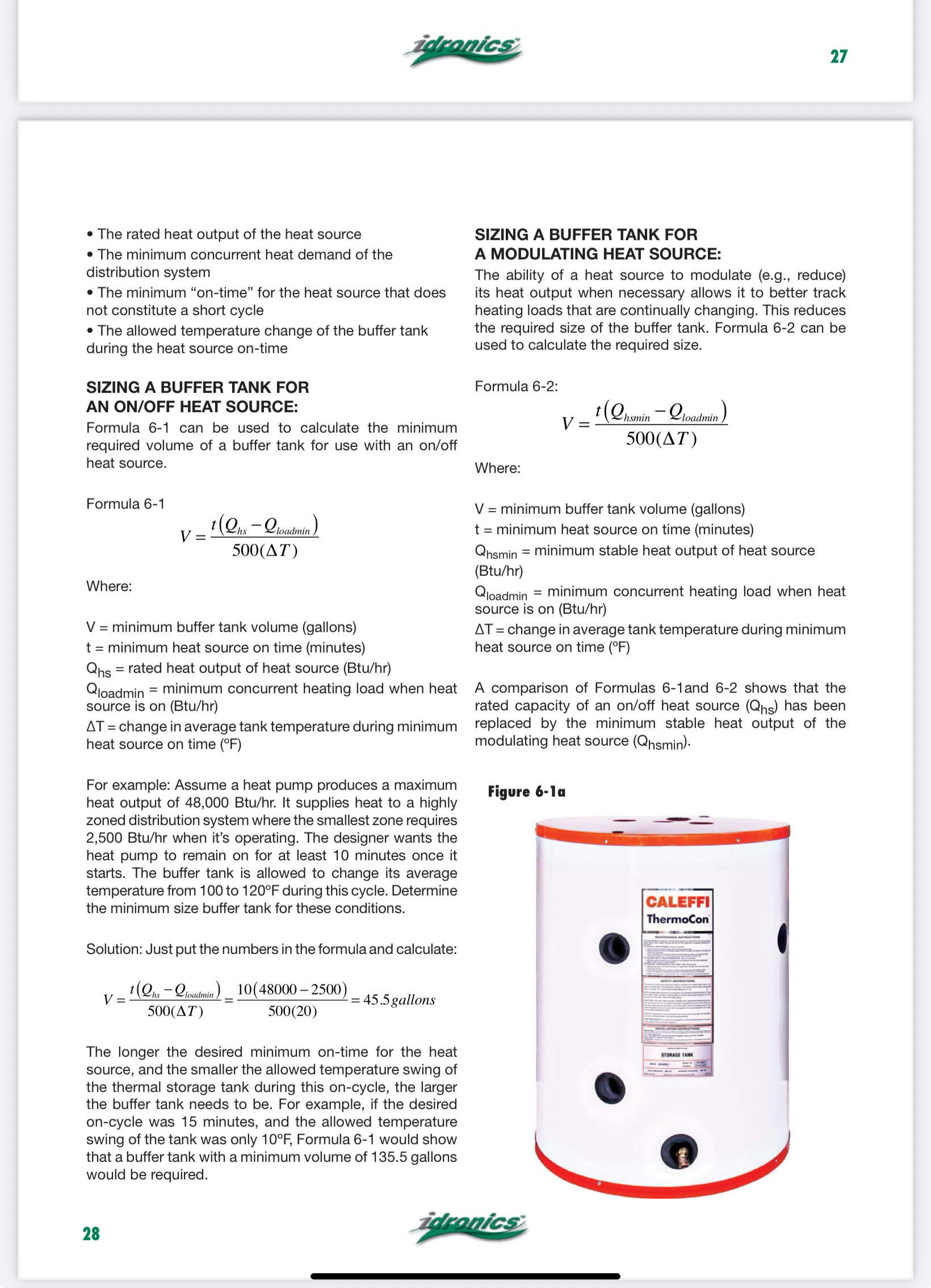

    Here is some sizing math.
    You will want a tank with 1-1/2 or 2” taps. Boiler Buddy, Lochinvar, Laars.

    Buffer tank calculation:
    t = 10 minutes
    Q_hs = 18,200 Btu/hr (lowest turn-down of boiler)
    Q_loadmin = 1500 Btu/hr (assume a future towel warmer)
    ∆T = 40°F (140°F - 180°F)

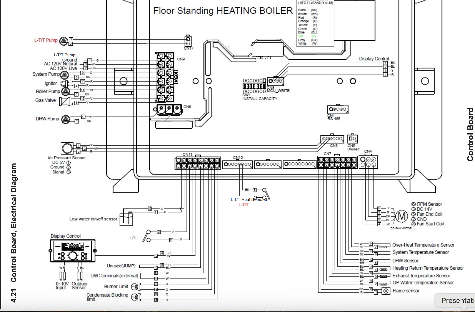

    I'm not seeing a system sensor input on the boiler I'm looking at. I see a thread for using a Tekmar 256 for dynamically setting buffer tank temperature, but I'm not following how that modulates the boiler, other than also having a boiler-connected outdoor reset.

    If you run ODR, the boiler just needs a call for heat and it will modulate. Just jumper TT connection on the boiler.
    I see the system sensor connection on the board, #6 & 13. Perhaps this is the sensor in the boiler. Or is it intended for an additional sensor?

    My first choice would be to let the boiler control run the tank temperature if the board allows that?
    I don't see Laars offering a separate sensor in their option kits, however.

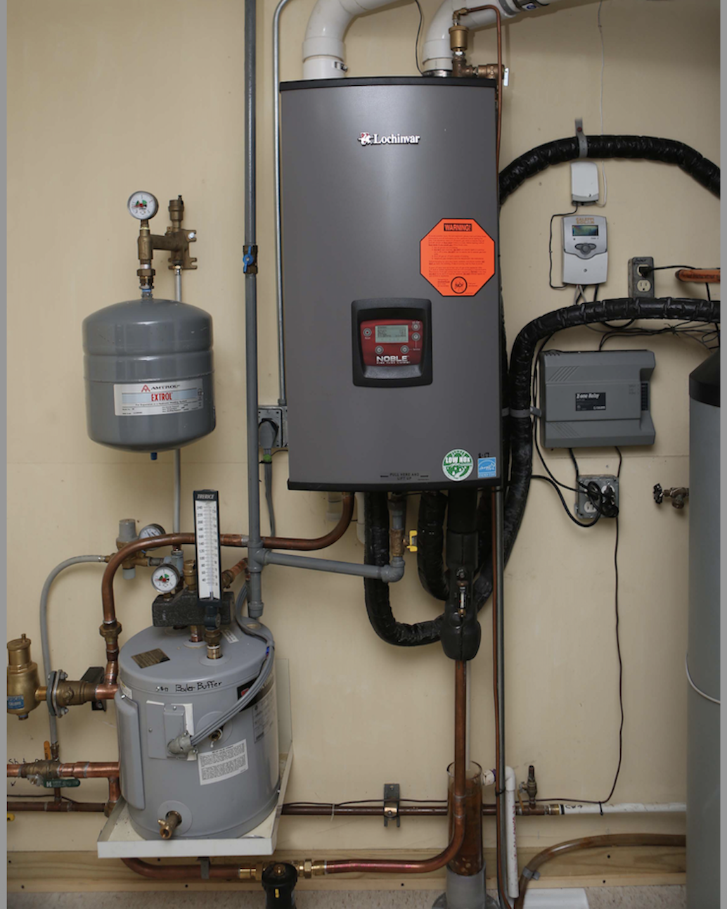

    Or buy a boiler like the Lochinvar Knight that give you a row of additional sensor connections. #23 & 24 is what I have in my buffer. You have connections for flow switches, LWC, three different heat calls, power for louvers, variable speed input. Most any option you can think of.
    Pretty much all the higher priced mod cons have a more robust control. More adjustments, more input options.
    My Lochinvar did come with a spare sensor. It is a universal sensor. The sensor can be placed anywhere, in a tank, on a pipe, it is just a thermistor. The only unique sensor is the ODR, it is in a weatherproof enclosure

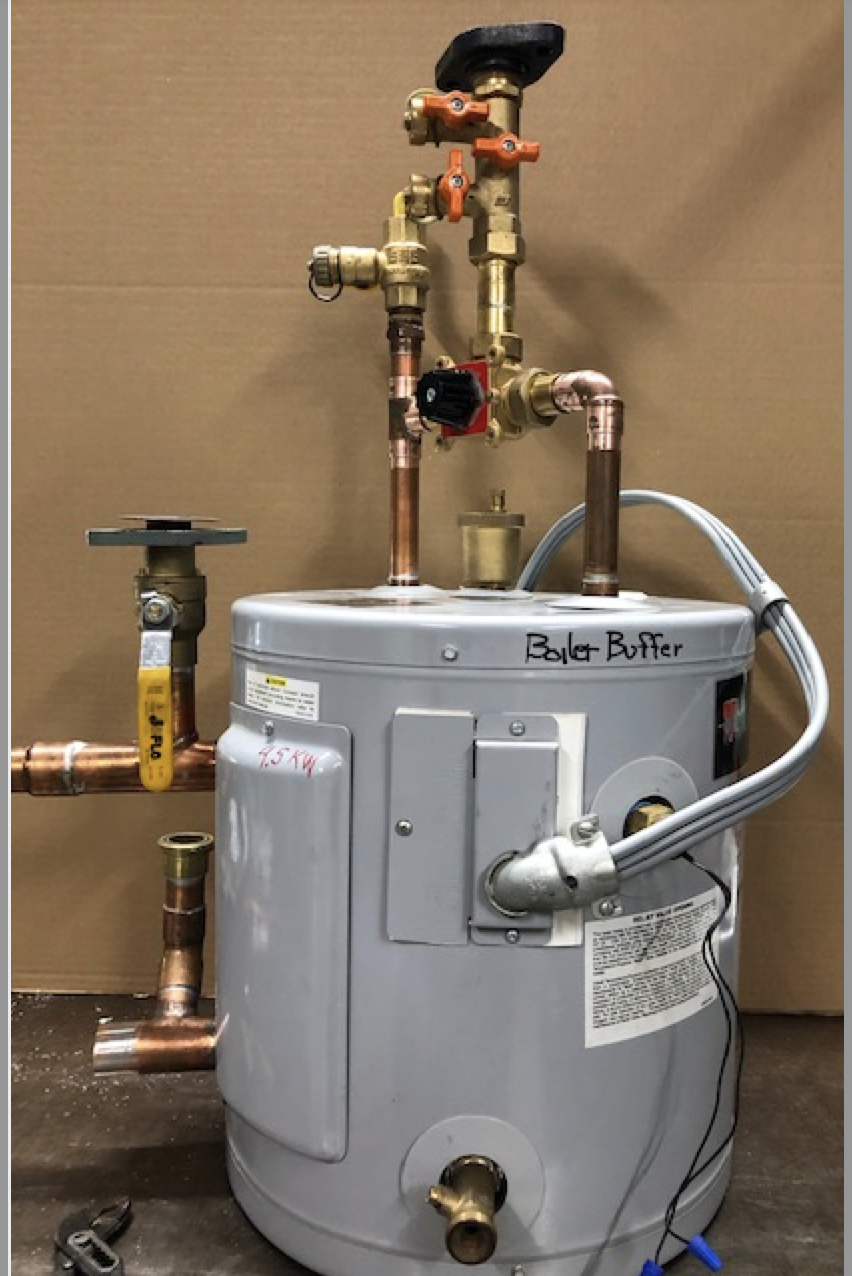

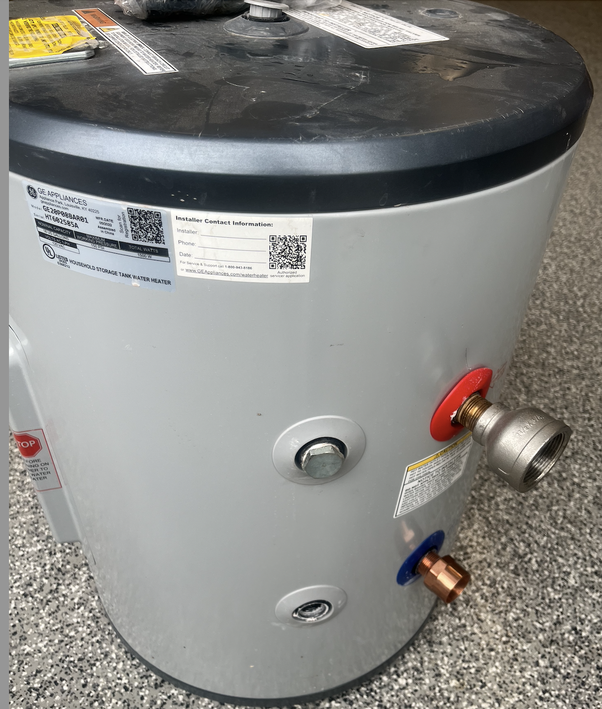

    I have done a number of small buffers with electric tanks, here is a 6 gallon and maybe a 12 or 20 gallon.
    I leave an element in for backup should the boiler go down I still have some heat.
    The small Lochinvar electric tanks have a bunch of ports you can use,
    3rd pic shows fittings to increase the 3/4 ports to 1-1/4 or 1-1/2"
    Screenshot 2025-11-16 at 2.28.32 PM.png Screenshot 2025-11-16 at 2.29.19 PM.png Screenshot 2025-11-16 at 2.30.05 PM.png

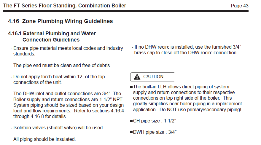

  • I wound up getting the Bradford White BFTCF199NA3XN (-1XN in earlier revisions) and a Zilmet ZBT-21 since going to 30-gallon did not seem necessary (21-gallon is likely too big). It came with 1-1/4" ports, not 1-1/2" ports like the other brands (I forgot that hot_rod recommended larger). The boiler is oversized on the heating size due to DHW load and lack of basement space pushed me to the combi (68,000 BTUH of panel radiators on a boiler that will modulate between ~19,900 and ~199,000).
    Flow to the panel radiators is small (<6 GPM) even with all running at once.

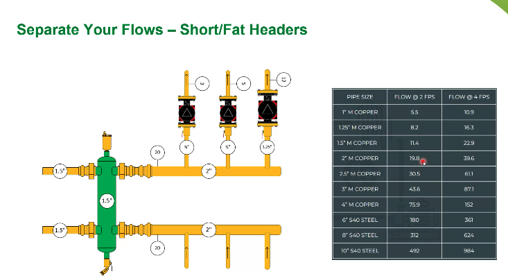

    I thought that I could go 1-1/4" boiler piping (8.2 - 16.3 GPM for 2-4 ft/s) to the buffer tank, especially with:
    GPM = BTU / (Delta T * 500) = 68000 / (20 * 500) —> 6.8 GPM (seems the max would be 163,000 BTUH)
    I just found this in the installation manual - I don't read this as a minimum 1-1/2" piping (at least in the left column, though "CH pipe size" is mentioned in the right column). Seems like 1-1/4" is fine for this design.

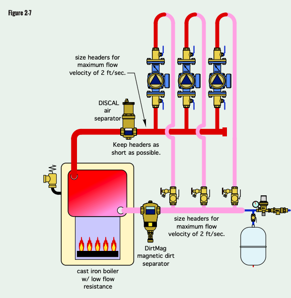

    Here are some guidelines, based on flow rates and velocity. It is not cast in stone if you are off by a few gpm, not a dealbreaker.
    This was for a 20 gpm flow on the B or distribution side.
    If your distribution is 6.8 gpm total, then 1-1/4' is plenty.
    Same concept for near boiler piping on zone pumped systems.
