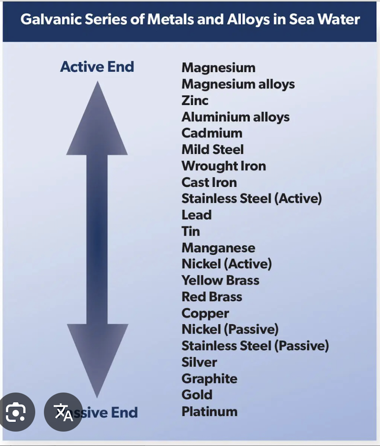

    The CDA talks about the relative area effect. The less ferrous metals the greater the corrosion of the less nobel.
    An example they used.
    A ship hull built of copper with iron rivets. The rivets would corrode quickly.
    Where as a iron hull with copper rivets, the hull would not see the rapid corrosion.
    My thought is a hydronic system all non ferrous except maybe a steel expansion tank. All the potential corrosion happens in the tank.
    But for the cost and simplicity of an inhibitor, what do you have to lose?
    I think todays systems with so many different metals makes this a more critical issue.
    We see steel, iron, brass and alloys, stainless, maybe multiple grades, aluminum alloys in some case, zinc, and copper. These all fall on different locations on the galvanic series tables. Aluminum and copper for example.

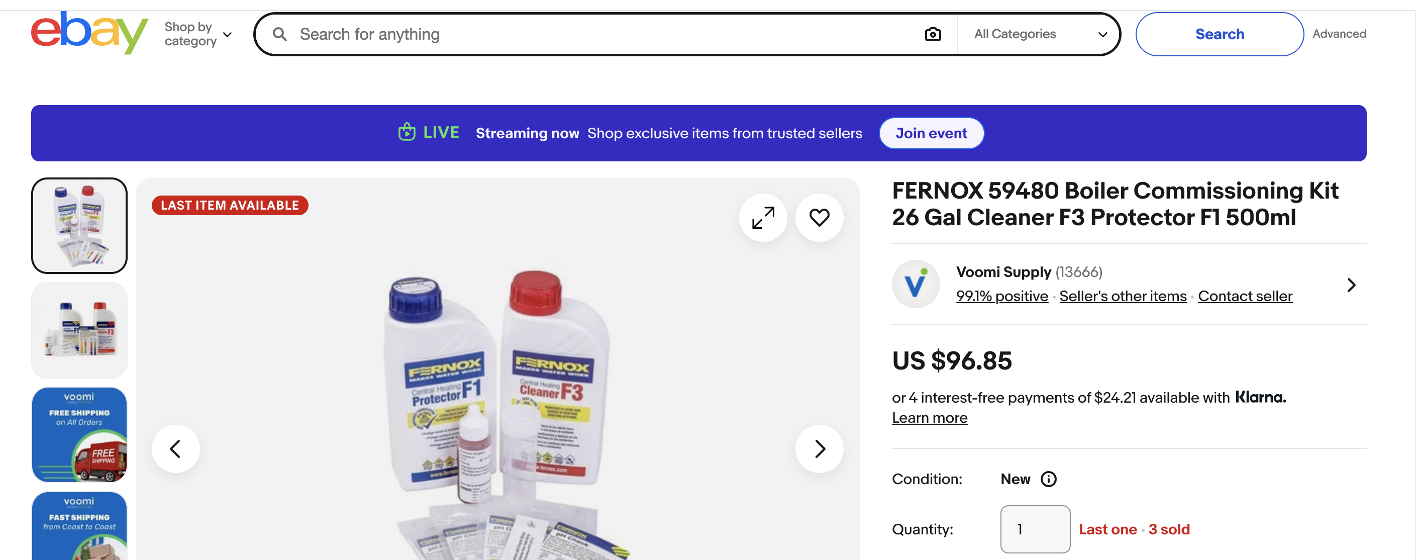

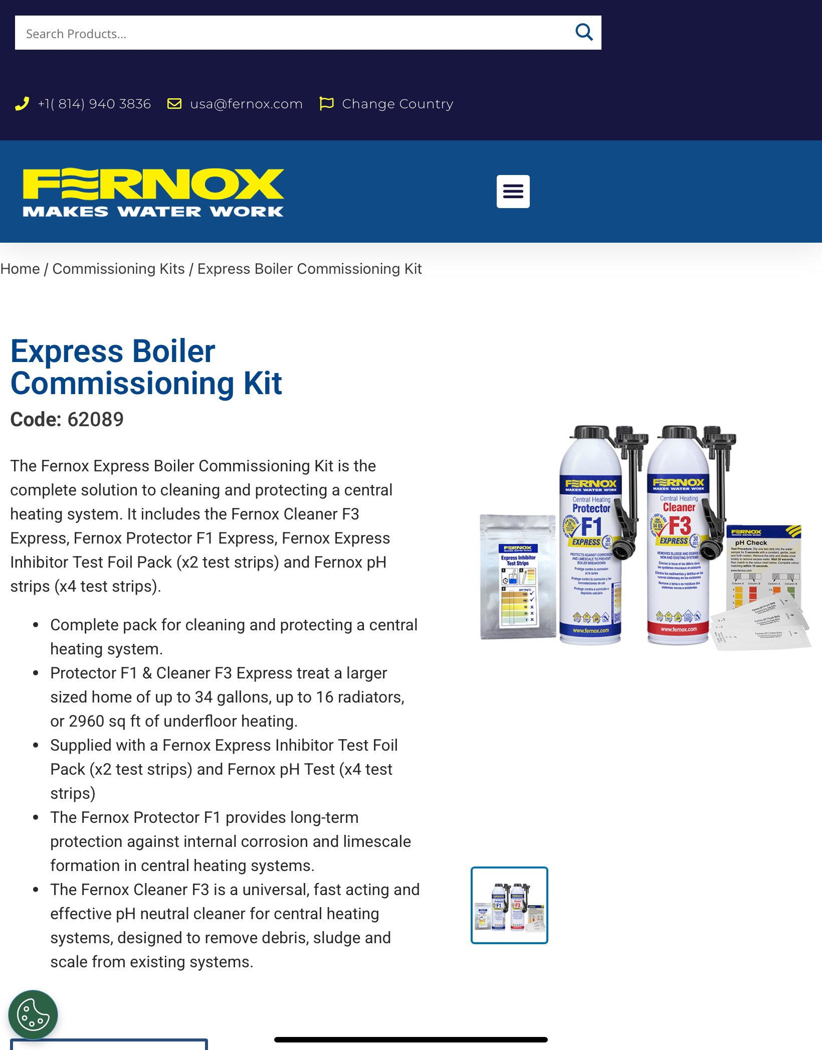

    Do you know of a product that is similar but not hard to find? That seems to not really be available. They have a Fernox F1 Protector, 500ml bottle that is about $70, ship time about 1 month, on Amazon.
    A few options for wood boiler protector that will ship. Like Pro Tech 300. a gallon is $70, would get it in 4 days.
    I might be able to source something at Homes Depot or Lowes.
  • nate379
    nate379 Posts: 185
    edited November 2025
    Trying to quote the Fernox info, but it's not working…

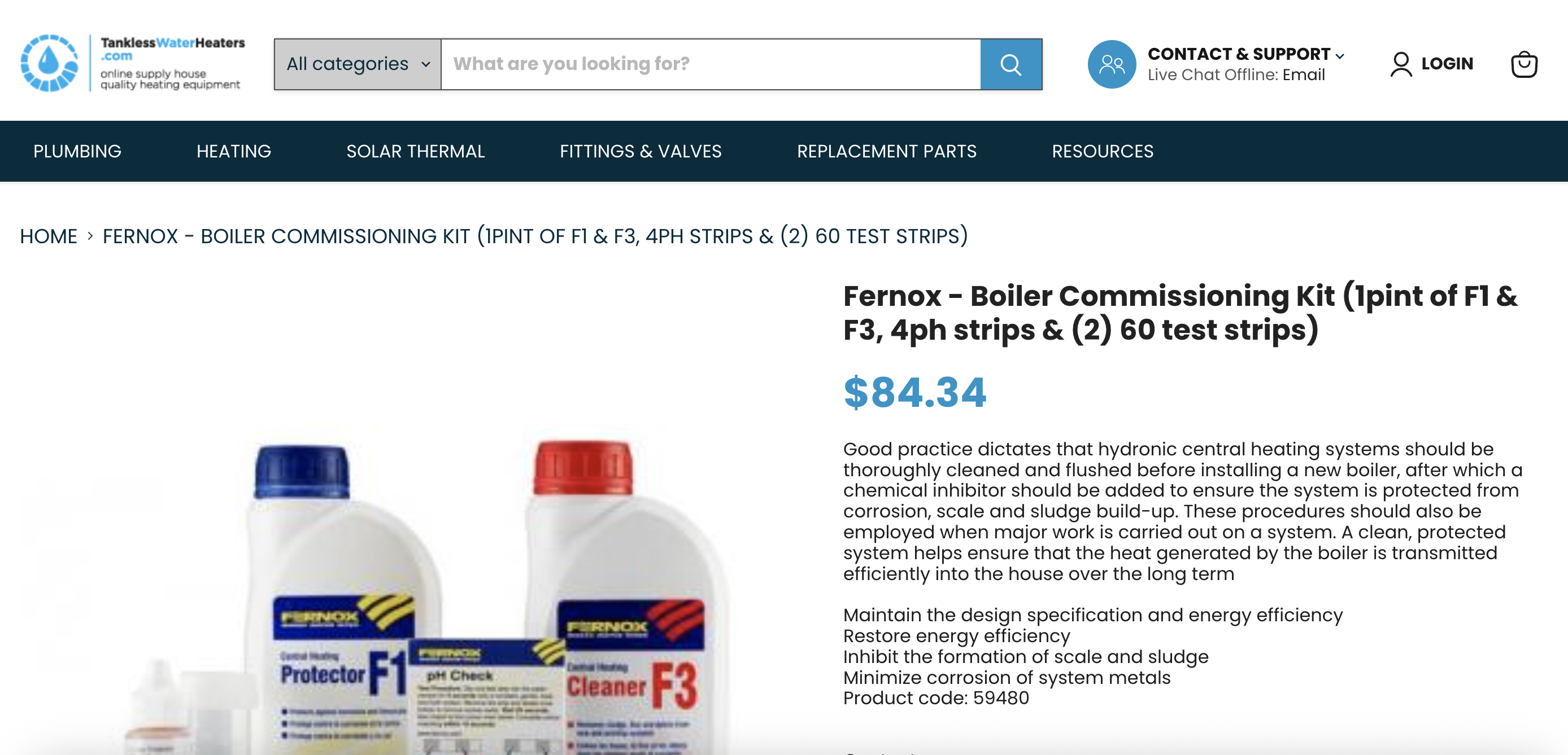

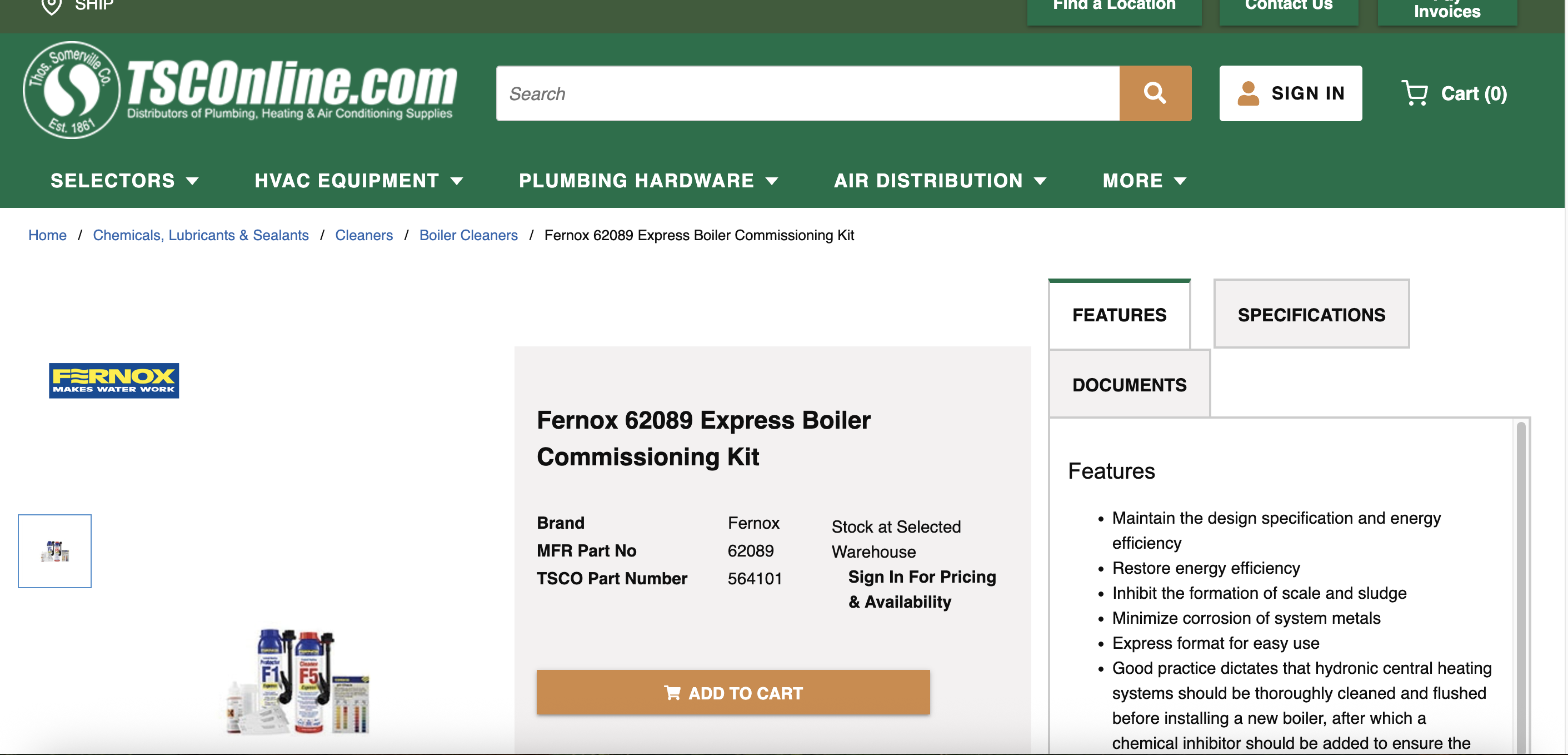

    hot_rod Posts: 28,705
    Where you at?
    Low Energy (taklesswaterheaters.com) is in Denver
    Thomas Sommerville back east
    E-bay everywhere.

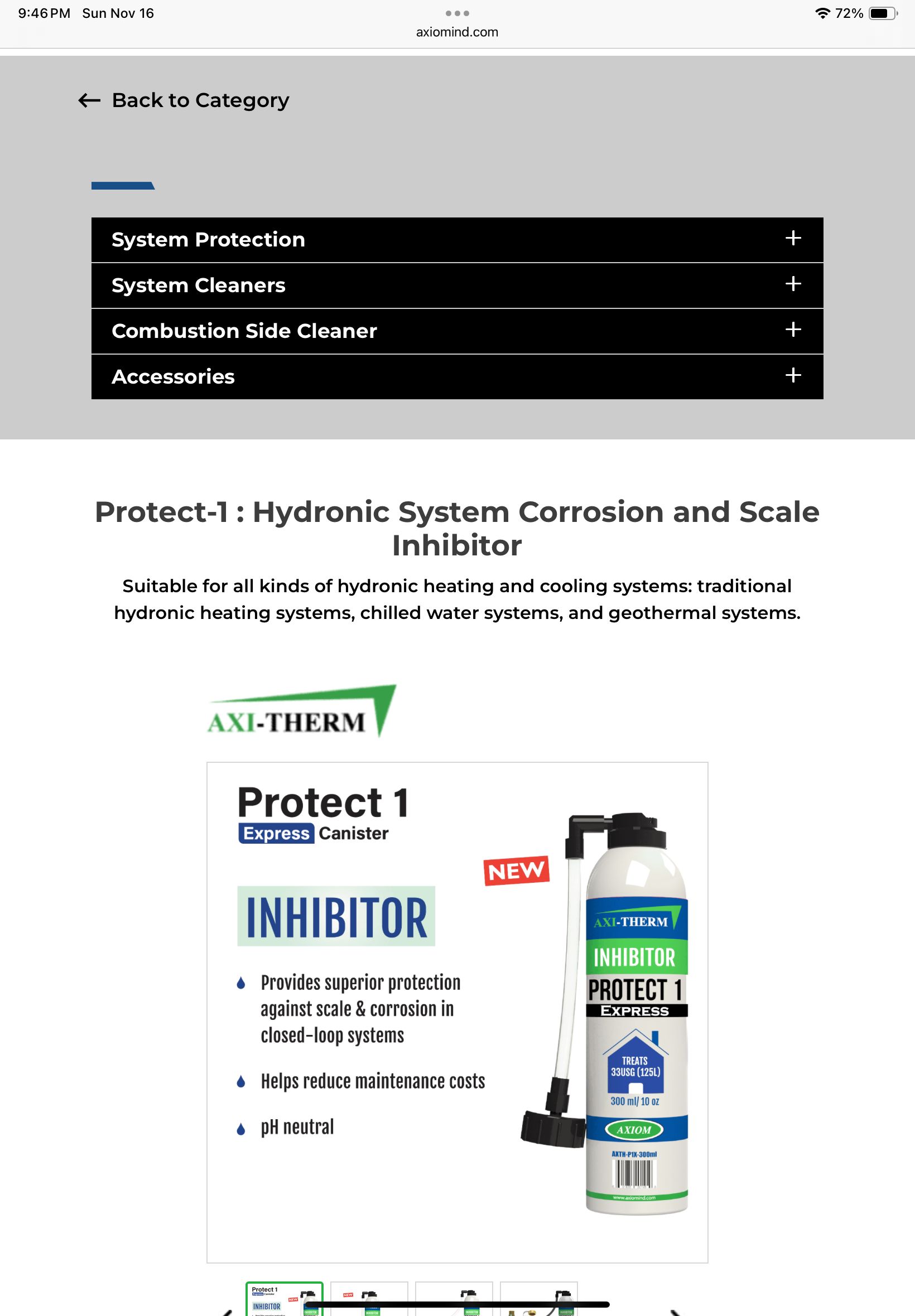

    Rhomar, Axiom, Adey have similar kits
    Screenshot 2025-11-16 at 11.53.42 AM.png Screenshot 2025-11-16 at 11.53.08 AM.png Screenshot 2025-11-16 at 11.51.47 AM.png

    Axiom is another brand.

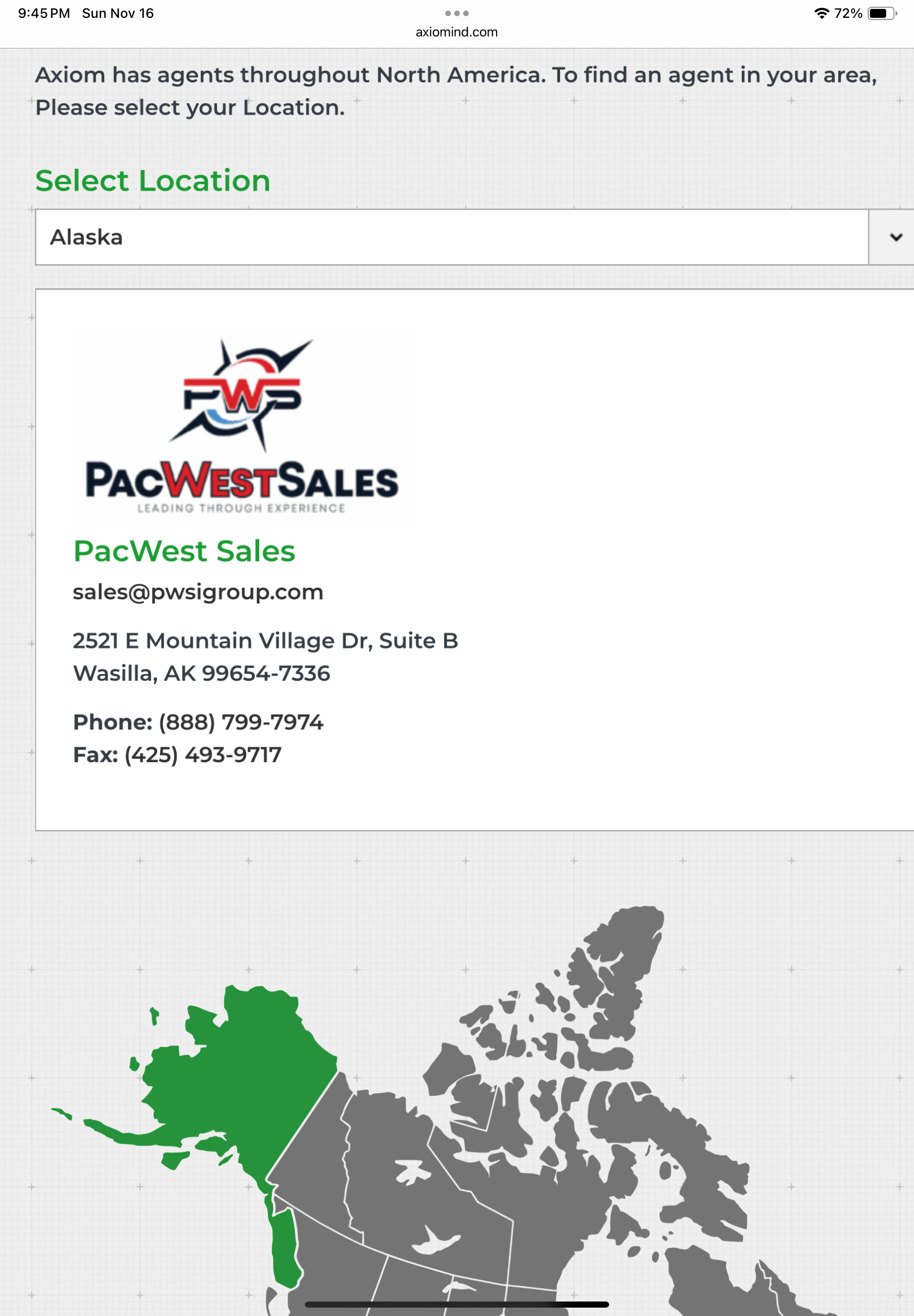

    It’s rep is Pac-West, they have several people in Alaska, I believe Mitch is in Wasilla. They have quite a few hydronic lines including Caleffi. He would know where to find it in Alaska
    Axiom is in Western Canada.

    That address is the UPS store next to Lowes. There's definitely no HVAC place in that building. I'm just going to get a gallon of wood boiler inhibitor off the Amazon for $70, done chasing down special "elixirs" that I need to go through all sorts of headaches to try and buy.

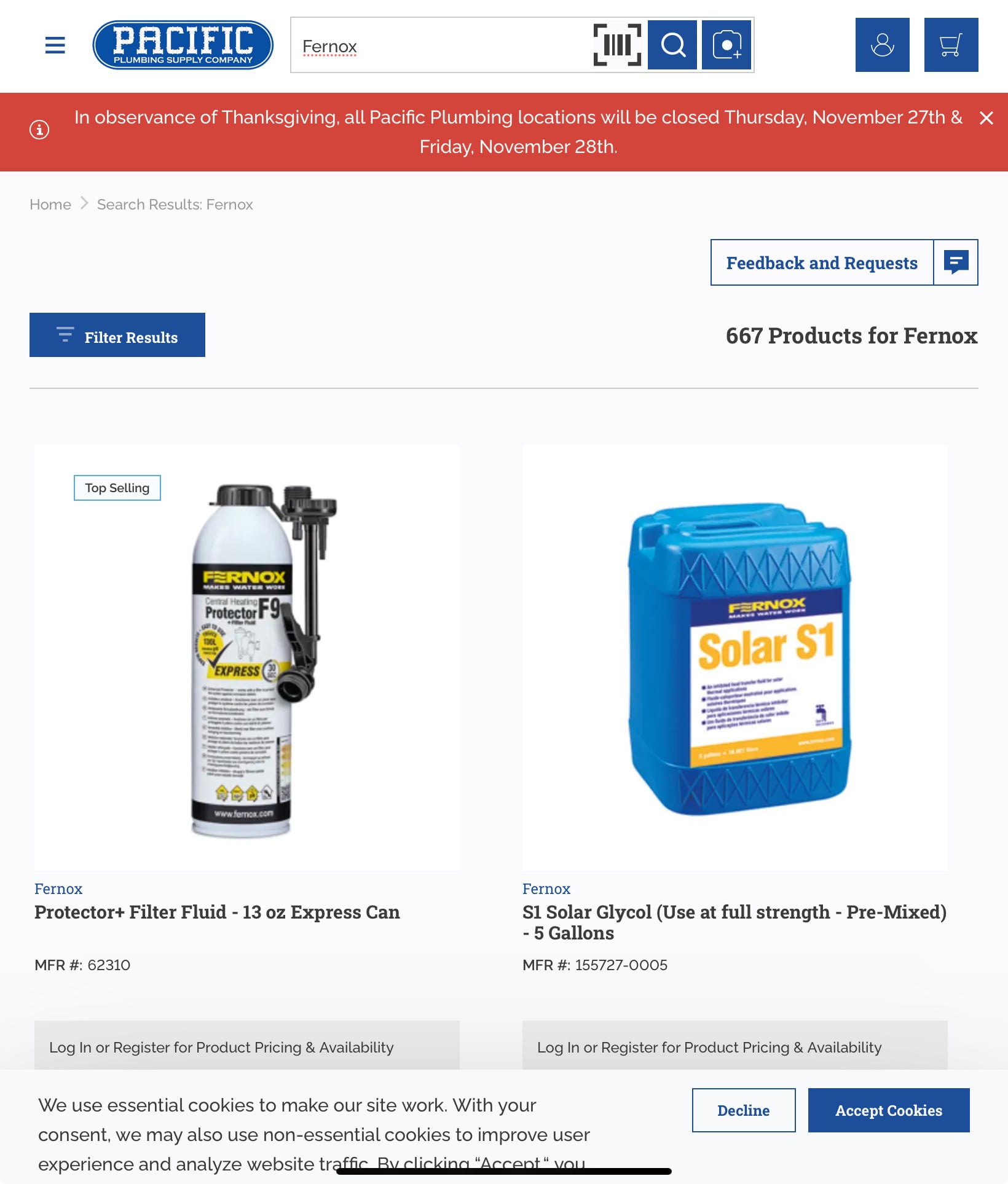

    Odd that Pacific Plumbing, Wasilla shows it on their website.
    My Fernox contact, national sales manager, tells me Keller, Pacific and Ferguson have inventory in Alaska.
    Fernox US is in Pennsylvania by the way.

    Do they allow regular people in at those places even? Pacific makes me have a commercial account, which makes no sense when I'd maybe go there 1 time.
    I bought a culvert at Ferguson about 15 years ago, had to buy it under a friend's work account.
    Either way, the stuff off the Amazon, Pro Tech 300, is due in on Wednesday or Thrudsay.
    I've never seen a wholesaler that would not do a cash sale to anyone that walked in?
    But it could be their policy that they only sell if you have an account.
    Most of the big name wholesalers have online sales, I don't know that you need an account to buy online?
    Many suppliers, and some manufacturers have online, E-bay, and Amazon accounts these days.
    The address and phone number I sent you was for the Fernox rep not a wholesaler. I'm pretty sure he would have hooked you up.

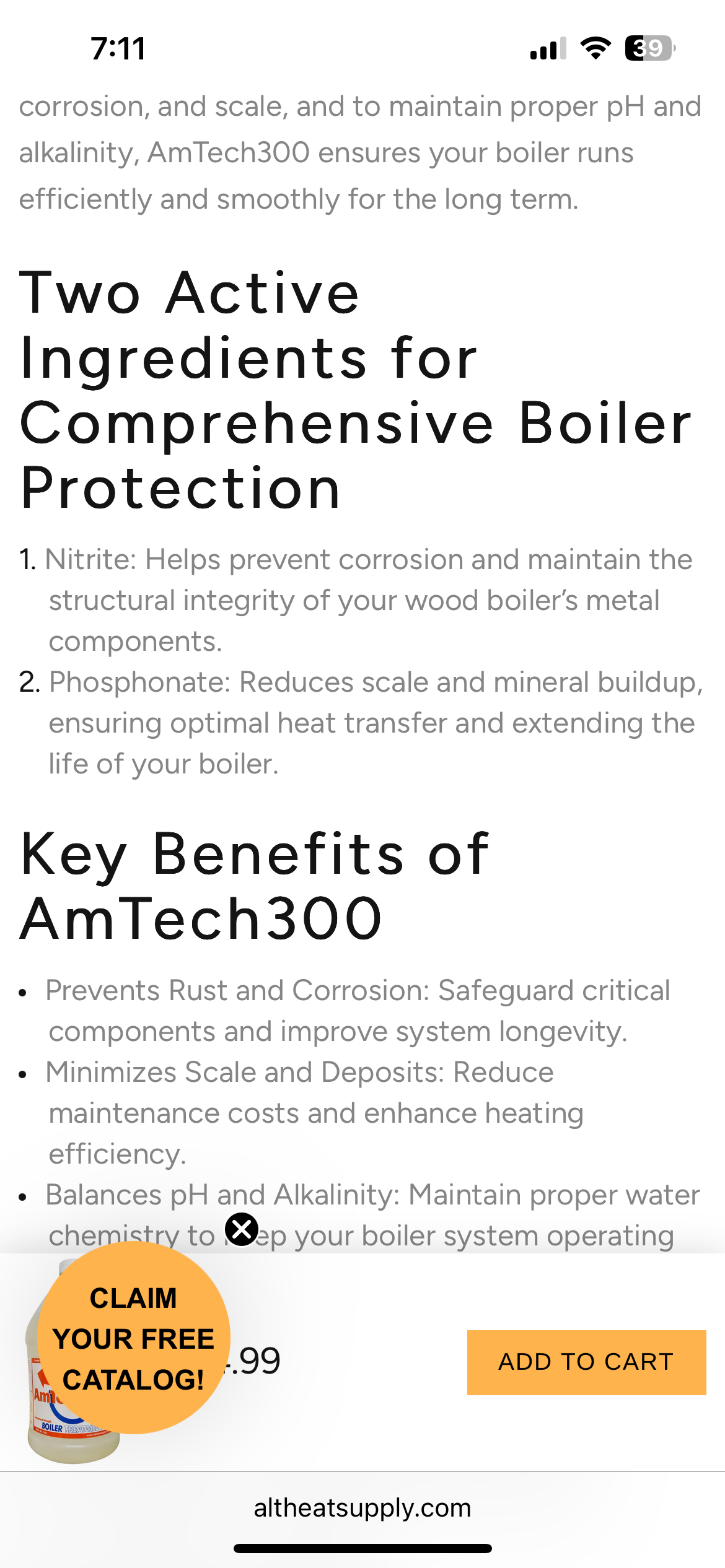

    The Pro Tech 300 claims for all wood boilers (open or closed) and has
    1. Nitrite
    2. Phosphonate
    3. Anodic inhibitor
  • psb75

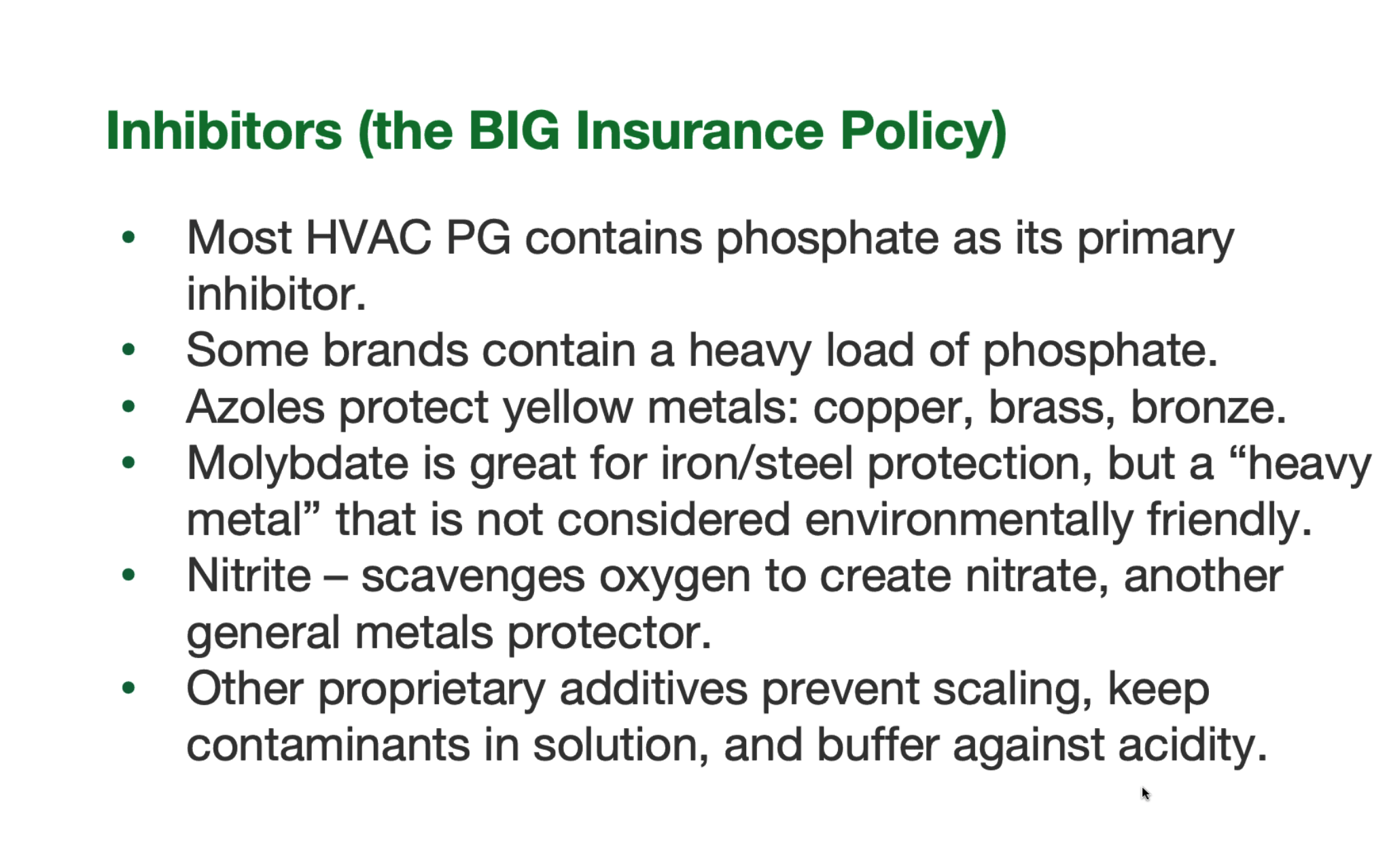

    Modern hydronics can have steel, stainless, aluminum, multiple brass alloys, copper, composites. So the conditioner needs to be blended to protect all the materials, more ingredients are used.
    Still difference of opinions on what blends are best. It varies from brand to brand, some still blend in Molys, and if the system has a potable water component, the chemicals need to be safe should you get a cross over from a failed HX or tank.
    Hydronic conditioners and hydronic glycols share many of the same ingredients
