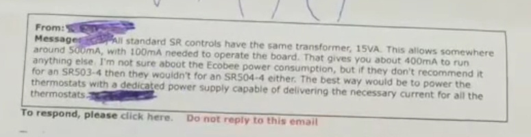

I have two installed on the old style Taco SR503 switching relay control with the 15va transformer, before installing I bench tested them with a 24vac power adapter and learned they only draw about 50 milliamps so no need to upgrade the transformer to 40va.
According to Taco the SR503 is rated for 15va or .625 amps the board consumes around 100ma that leaves .525 amps to play with, I would keep things at 200 ma or less to be on the safe side.
I found and old email from Taco that shows the rating of the SR503 control - see attached.

@pjg when wiring a tstat that needs a com to these older controls, you need to wire the W from the tstat to the right T and R wired to the left T. Then take you com wire to the com side of the 24vac/com two pin connection to the left of the board. Between R-Com is always 24v on our controls. If the others are just two wires, doesn’t matter where you land them at the tstat TT connection. Hope this helps.
Thanks Steve,
I found that out on his site before I did the install, I ended up running new thermostat wires (18/5) for each zone to connect the C-wire. Then moved the thermostat wire that was located in an unheated hall on the 2nd floor which was causing the master bedroom to overheat, even with baseboard dampers closed. The 2nd floor thermostat is now in the master bedroom and heat is much more even in each bedroom. The other nice feature of these thermostats, I can see and program them from the touch screen or web browser. The old HoneyWell T5's that were replaced were hard for me to see even with the backlight on.
